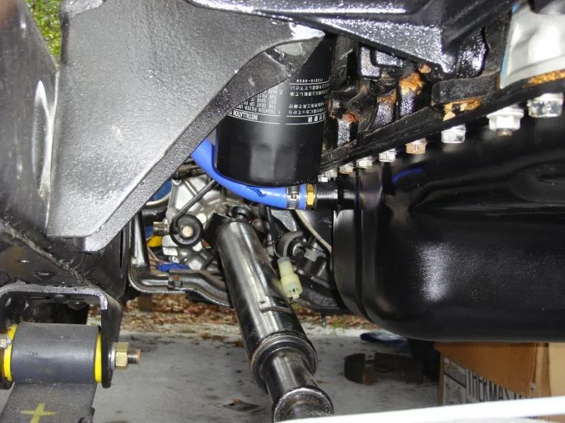

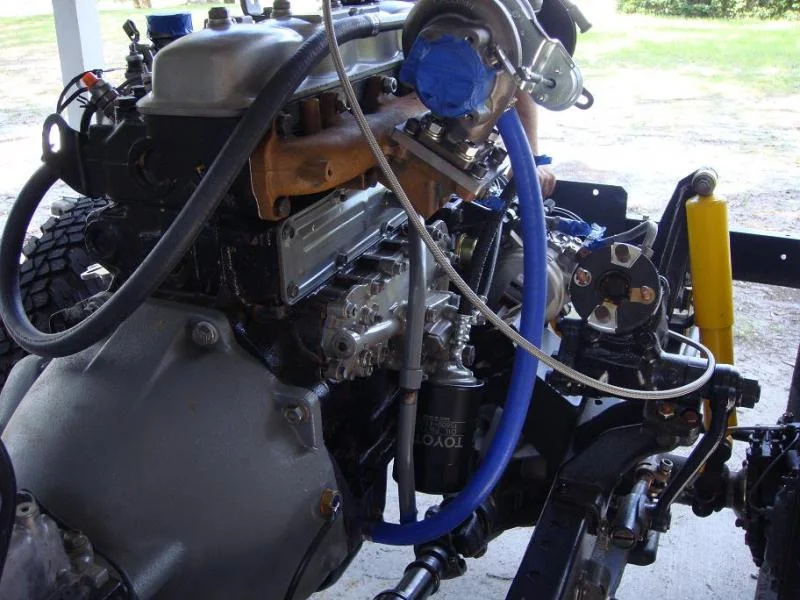

here they go, is the drain ok at this degree or do I need more? I cant really go more down, and if I rotate turbo to face other side more horizontal then my drain will be directly horizontal as well, would that be ok to hav eit horizontal and then radius it downwards into oil pan? We are drilling hole tomorrow in pan and then have welded.

Nice job so far. I don't think you'll have an issue with the oil drain line at that angle. You sound be able to rotate the inlet side more all on its own though and the oil gallery should be able to rotate down more too. I don't know the garrett turbos at all so I'm just speculating.

you should be able to clock both the exhaust and compressor. I can't really see how much it's it's not vertical. It would probably be ok but you could have some oil pool in the housing since it's not vertical.

Your drain will probably be okay on that angle, but I would rotate it down to vertical if you can. The compressor housing will then loosen and rotate to the angle needed. You can shift the wastegate actuator bracket to another position and it's got an adjustable rod so you can just put it where it works and adjust later.

You should loosen the bolts on the exhaust housing to centre section and rotate so the drain is as close to the bottom as practical. Then do those ones back up and loosen the clamp bolts holding the compressor housing on.
It should rotate, but not freely. If it won't turn with hand pressure then try to take the housing off to see if it's pinned (they usually aren't, just in case).
Once it's off, just reinstall at the angle you want.

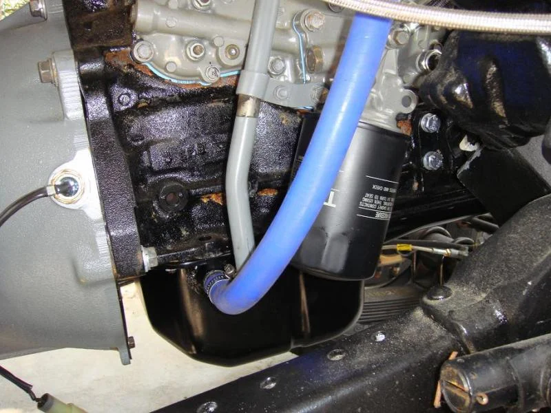

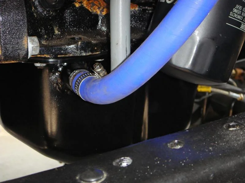

thanks fellas, I rotated housing just as u said and worked great, I have as far as I can go before it bumps against mount, I had turbo drain brazed on to oil pan today after my father and I tried with no luck, the guy did a great job for $5 and then prepped and cleaned and painted pan and mounted, then put on drain tube, and then filled engine with oil. got all the new oil lines installed, prepping and painting the radiator bracket tomorrow, touching up the engine and bolts with paint since my machine shop who rebuilt waited until after he put everything back on to paint? who does that? so he did he best he could? the exhaust manifold looks like cr** but I am just going to say whatever? so is this turbo going to get hurt when I go to crank 1st time since going to take a few to get oil going???? how do you do this? also water in block? do I need to fill block up first or just fill radiator until cycles and then fill up again? oh, also, i cant find my 2 small hoses that go from the venturi to the injector pump so can I just use heater hose or is there a reason it is clear hose?

Take the turbo oil feed line off and slowly pour oil in before the first start.
This stops it from starting up dry.
thanks Dougal, and looking at my pics where do I tap into for oil feed, these are the only parts I have left from my turbo oil feed and drain kit? and how much oil should I pour into it? how long does it take before oil pump starts feeding ol to all?

for the oil feed. just use the #1 port on the block in front of the oil sensors. No need to T off anything. Plus you'll get oil first, not that it really matters. pull the oil feed line at the turbo and put in a little rotate the wheel a bit so it's primed.
