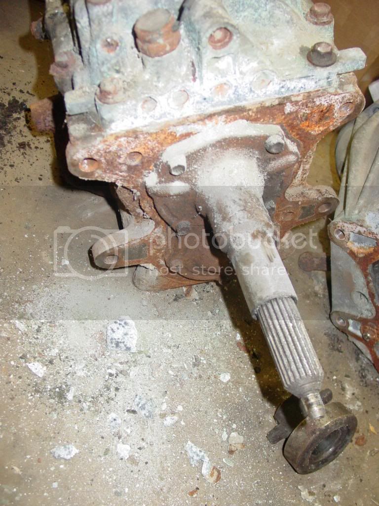

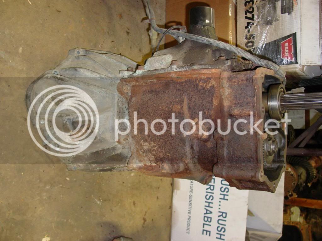

Here's some initial work on the H55. As mentioned earlier, the BJ70 donor was a total rustbucket, so it's no surprise that the tranny was covered in heavy rust.
It was even worse between the AL bellhousing and iron transmission. :eek:
But the input spline and pilot bearing snout are in excellent shape.:bounce:
Here can be seen the heavy rust on the outside, but the decent condition inside and perfect splines for the transfer main drive gear.:bounce: This is a common wear problem on high mileage H55s, and they are usually very high mileage by the time they get to the USA.

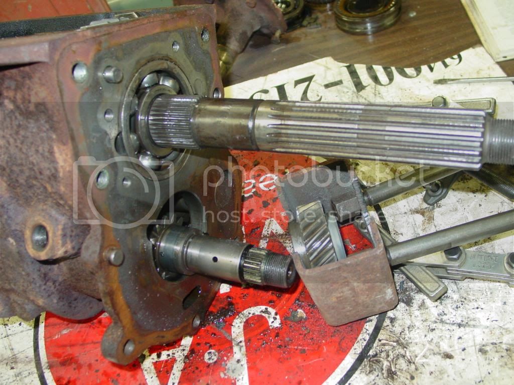

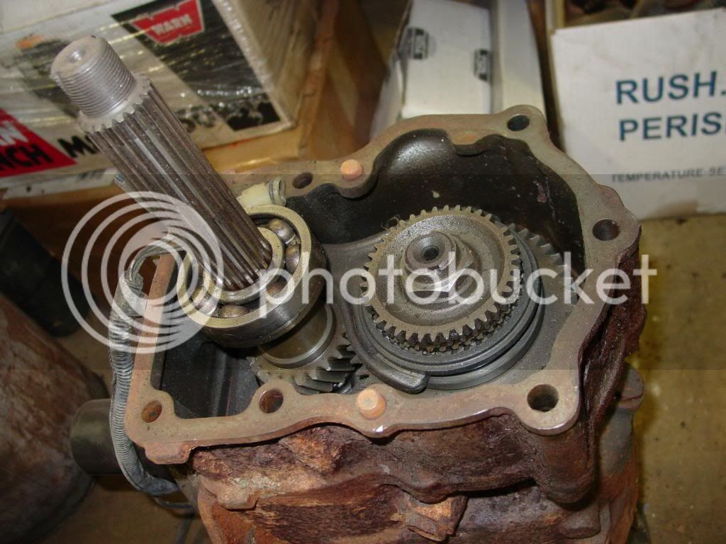

Remove top cover and 5th gear housing. Pull rear bearing.
Remove 5th gear. Note that all of the splines and bearing races at rear of trans are good.:bounce:

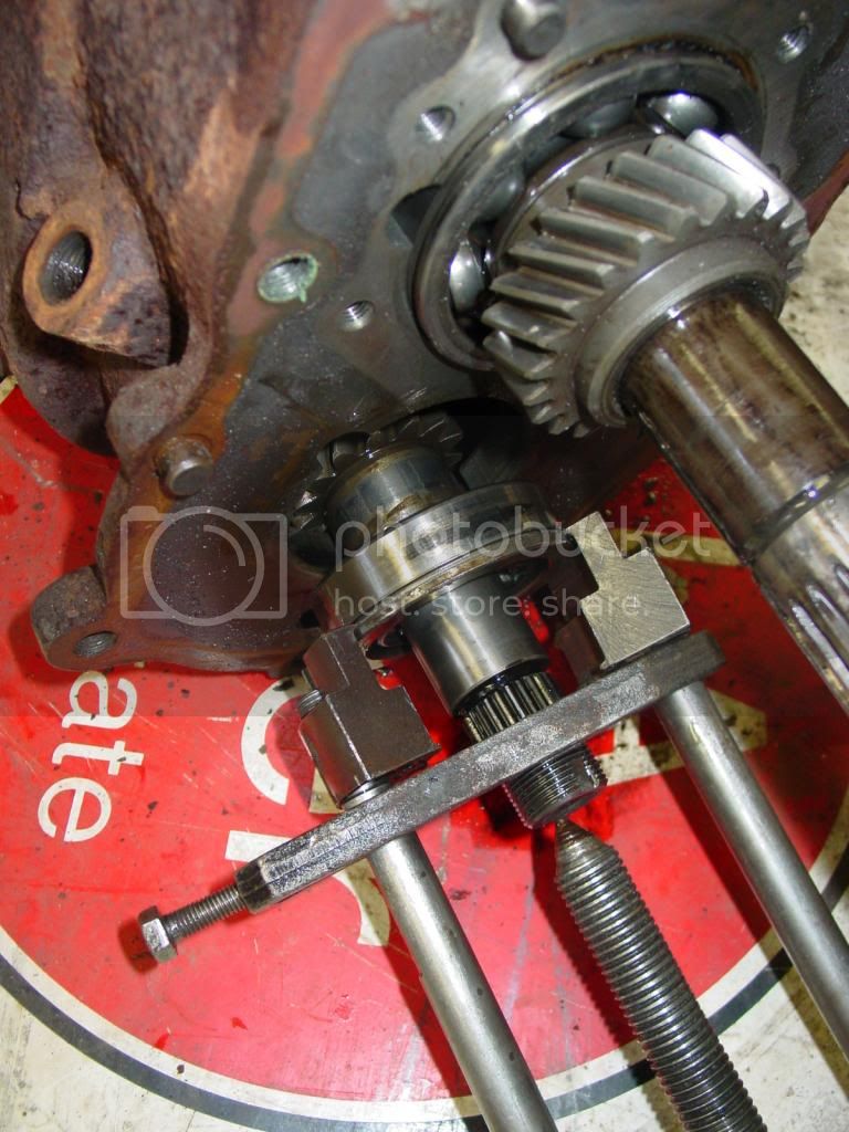

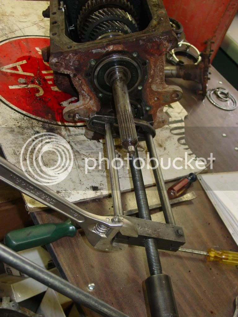

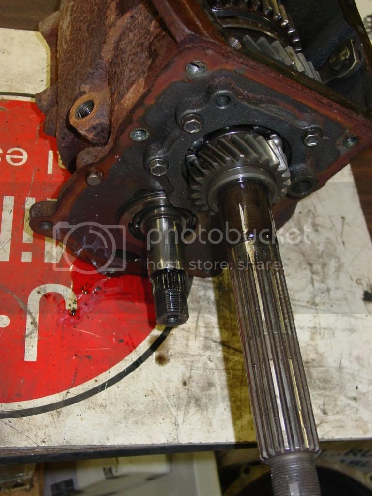

Next is yank the bearings off the countershaft.
Rear:
Front:

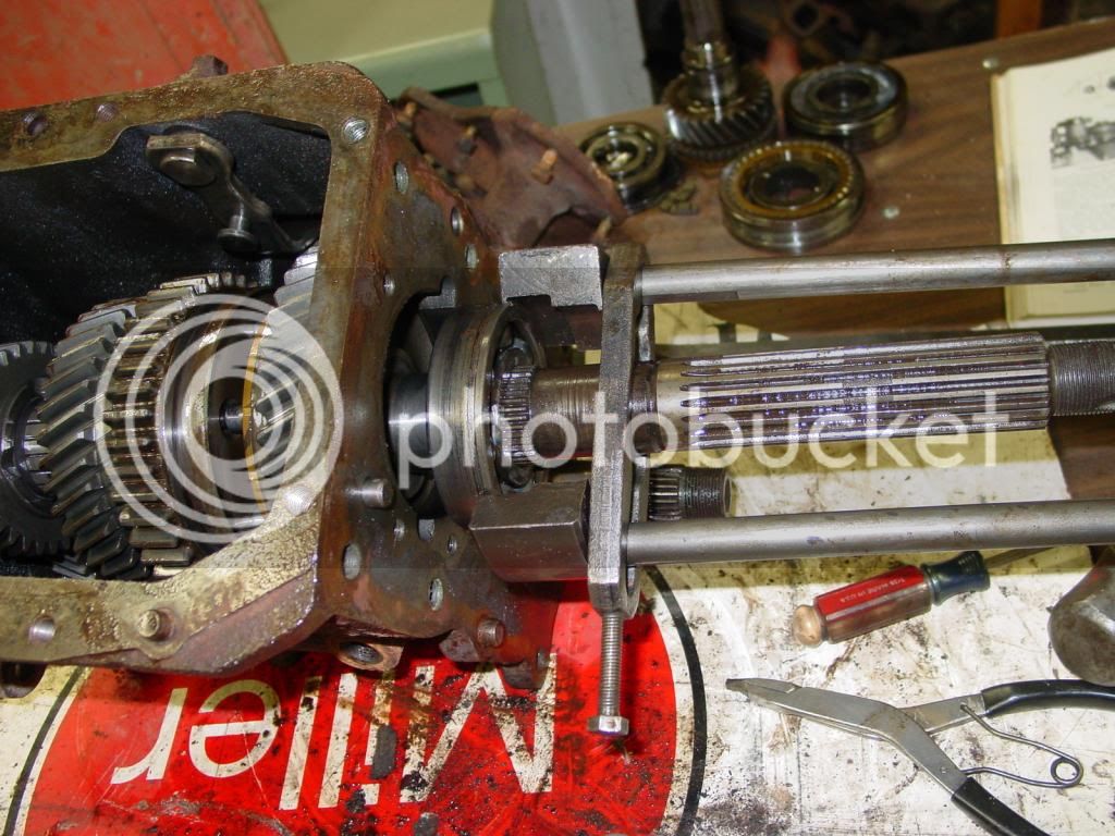

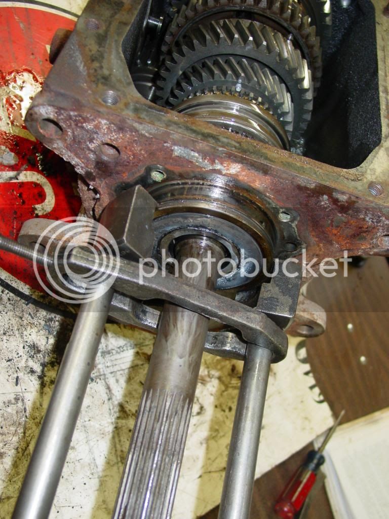

Since we're looking at the front of the trans and the countergear is laying in the bottom, might as well pull the input bearing.
Uh-oh, it does not want to do as it's told.
What happens to inner races that are stuck?
That's right, they get warmed up a little with the OA torch. That explains the scorching in this pic:
And then the input gear is free of the case:

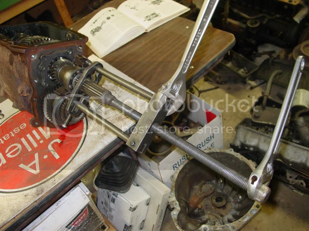

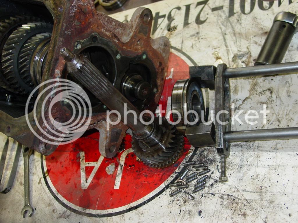

Returning to the rear, the 5th driven gear is still pressed on the shaft. The homemade puller attachment makes quick work of it.
Then pull the rear output bearing:

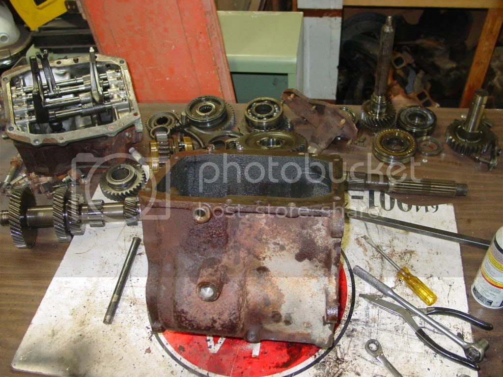

And lift out the gears, exposing an empty case that needs some serious cleaning inside and out.
