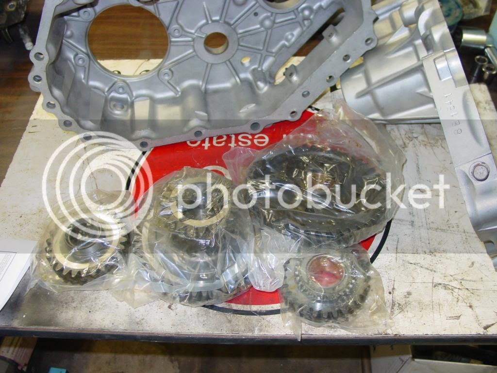

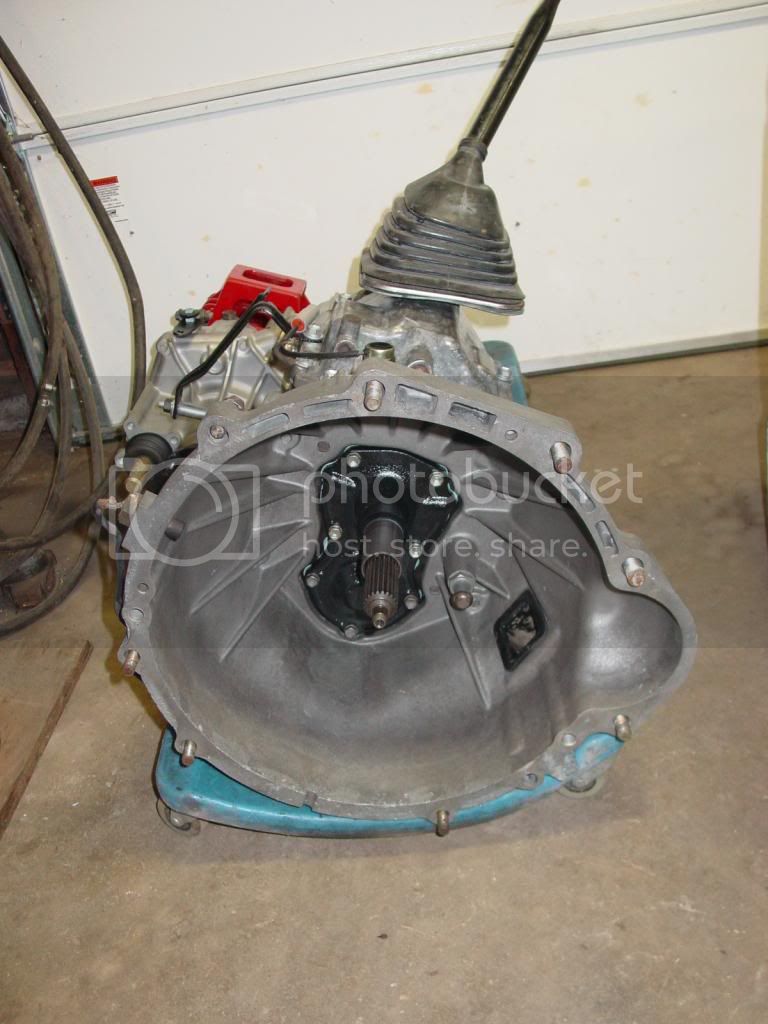

Mechanically, the only thing "wrong" with this transmission is that all the endplay measurements are loose. No surprise as every selective fit snap ring is the thinnest available. So correct lock rings are ordered from toyota, to go along with the rebuild kits and sync rings Alberto has already provided.

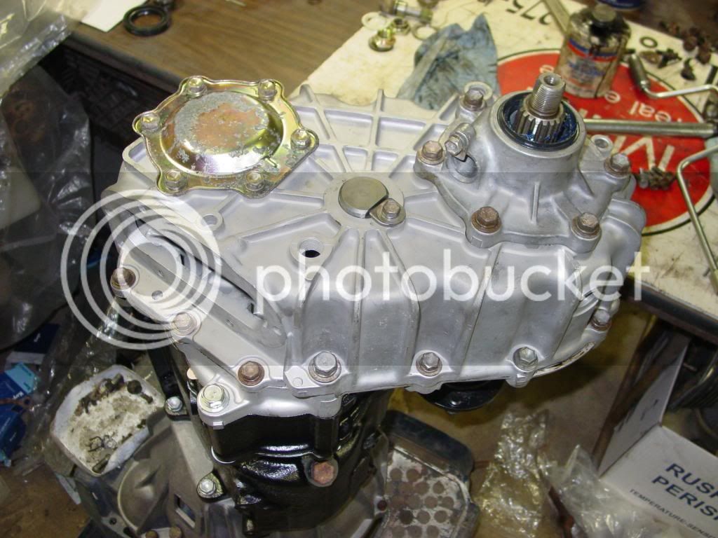

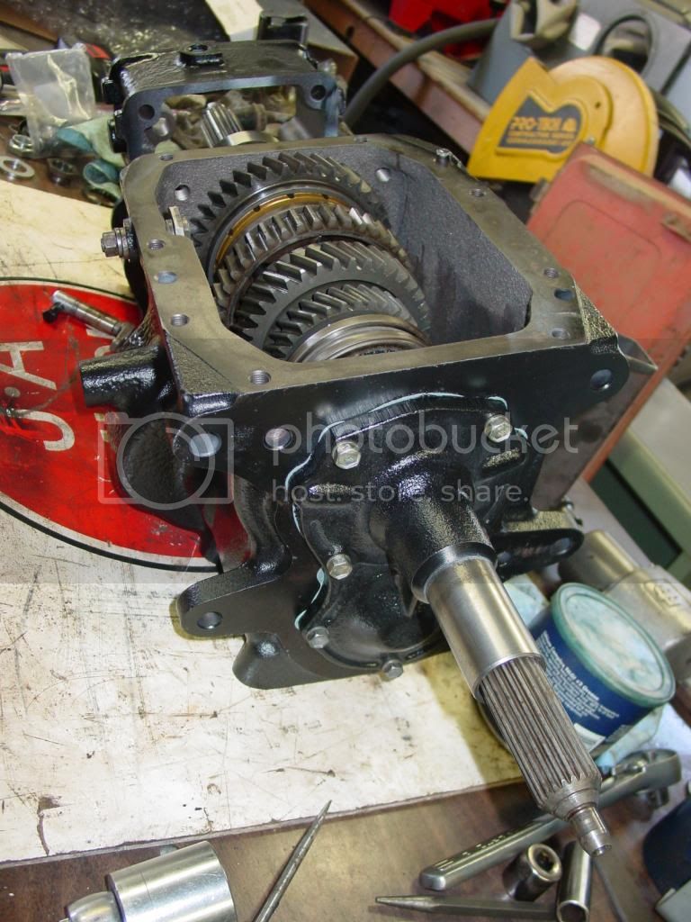

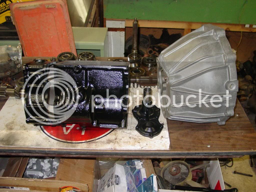

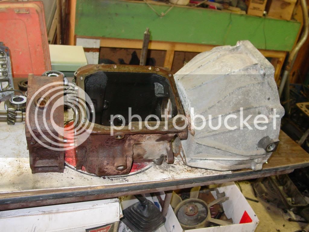

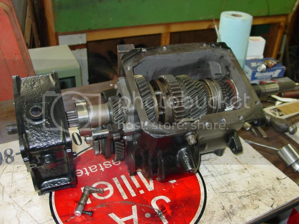

We're left with this cosmetic mess. Wire cup brush in the die grinder is brought to bear on the outside of these parts, but with no real effect.
So these parts are delivered to the machine shop to go through the dishwashing machine, followed by the oven and then the big-azz tumbler.
Sadly, no pic of the clean bare metal parts. They were already starting to flashrust when I got them back to the shop. So they were wire brushed and wiped off, then primed & painted.

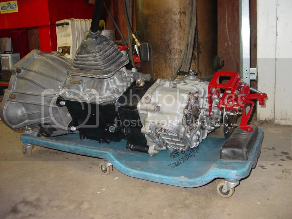

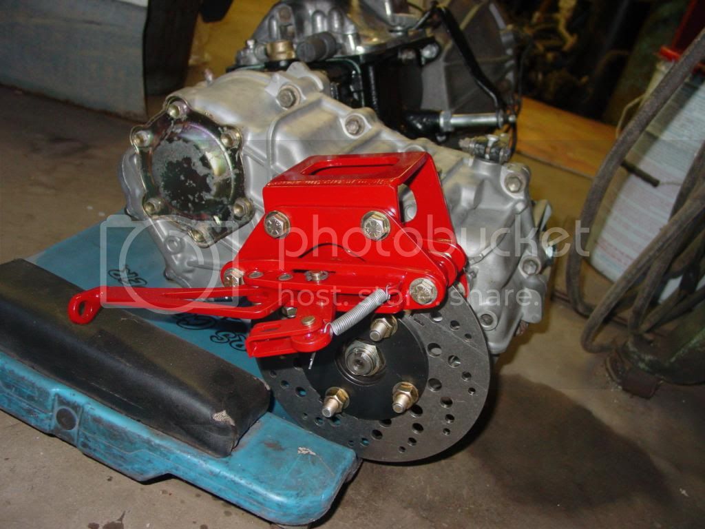

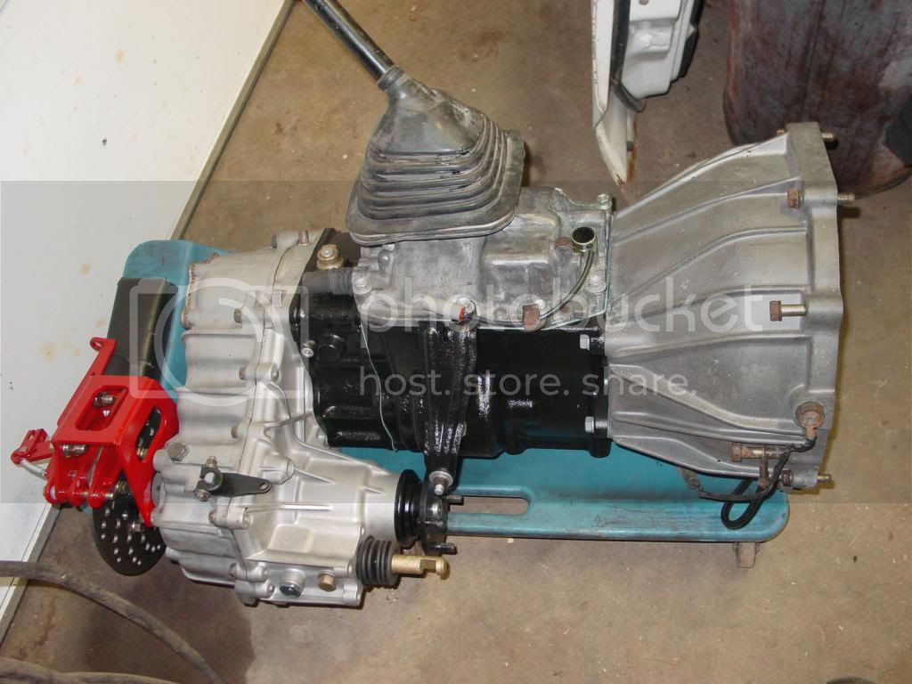

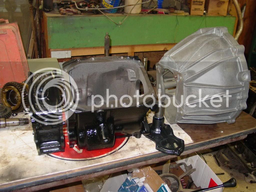

Ta-da:

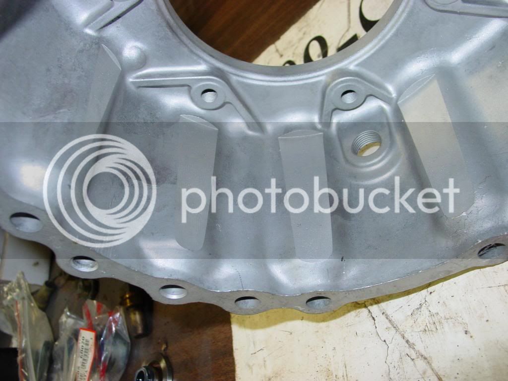

Actually, the BH is still in bare aluminum.
The end (for now).
