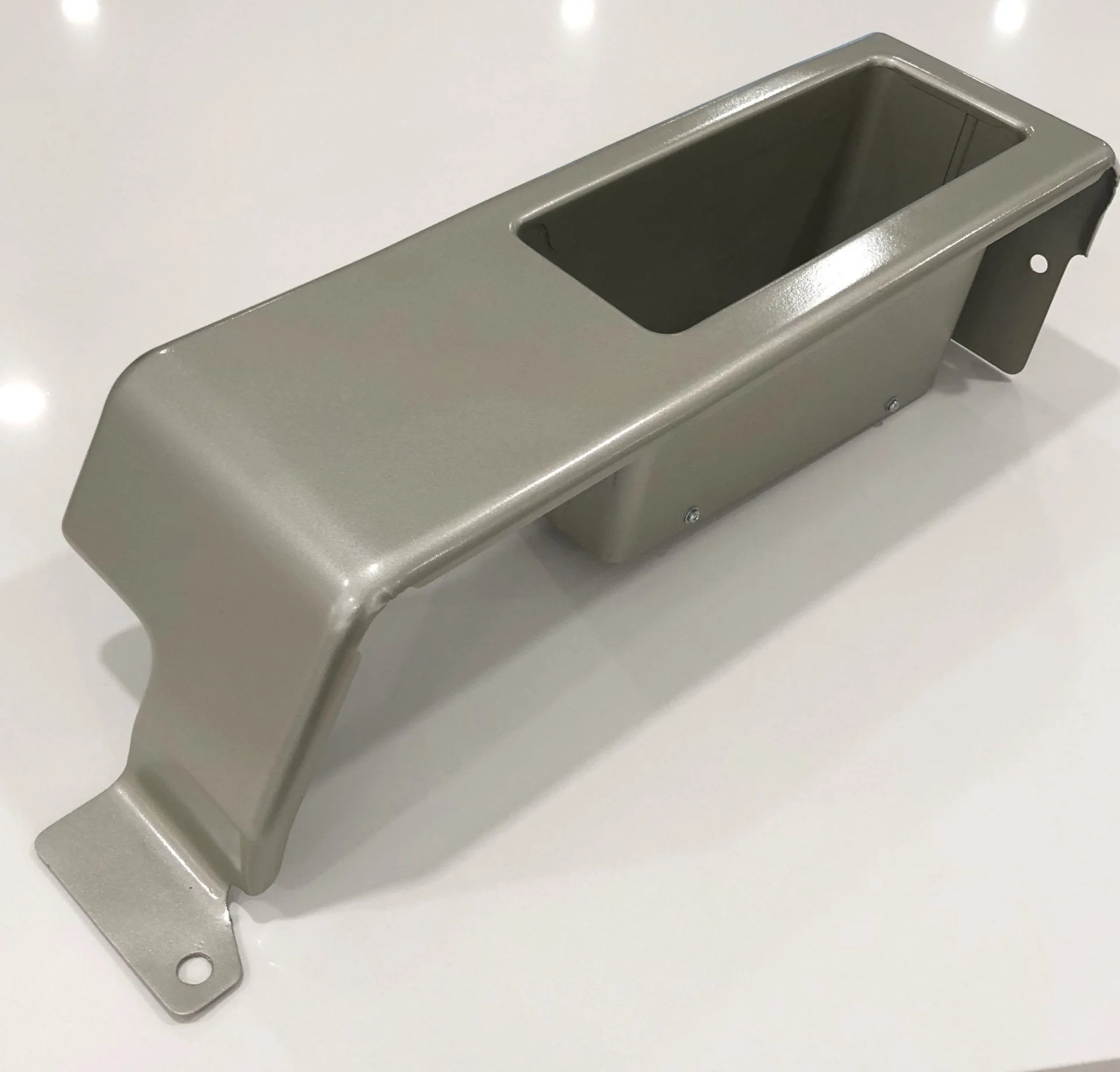

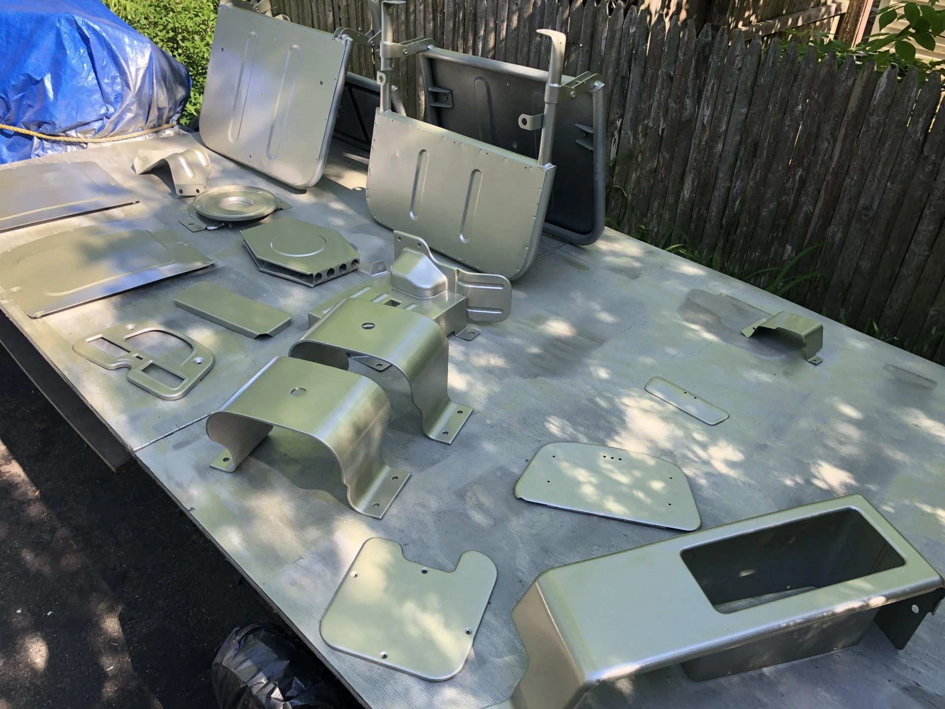

I have had a devil of a time spraying the pewter paint - a very difficult metallic. I finally found the sweet spot, YMMV.
I am spraying this Pewter from Cool Cruisers.
Ambient Temp, 78F, surface temp 88F. DeVillbiss HVLP with 1.3 tip @ 40psi, light coat/mist first, followed by rather quick medium coats (3).
If you use a bigger tip, or go too heavy, it will mull or whatever that metallic pooling is called. You also risk a fish-eye/swirly effect similar to the rattle can "hammered" which sprays a heavy metallic.
Anyway, the pewter has turned out beautifully (I think) and I love the cool cruisers pewter, it is a spot on match, especially when holding it up to an oem part. Highly recommended (with patience and control). Thank you Manny.

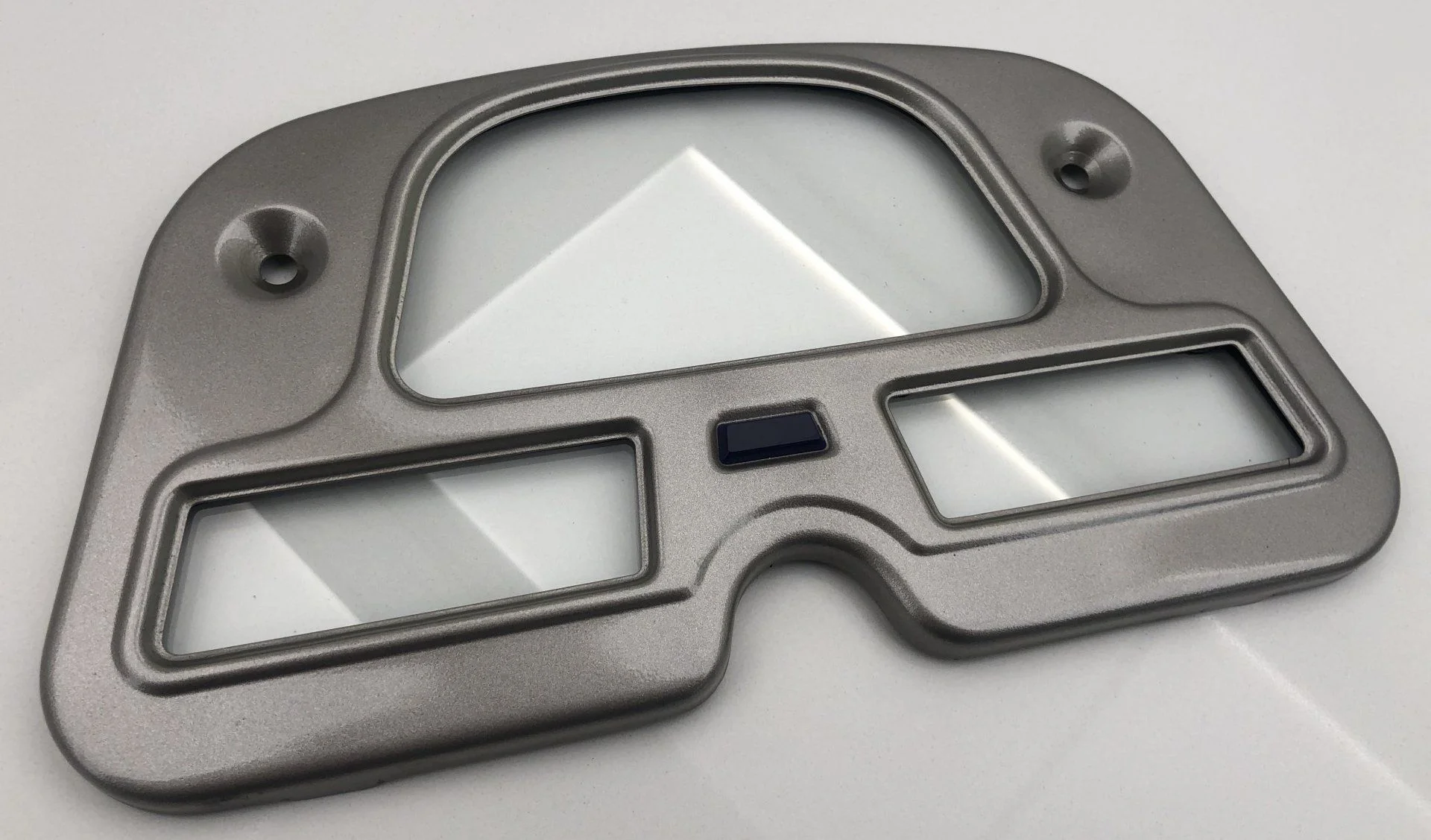

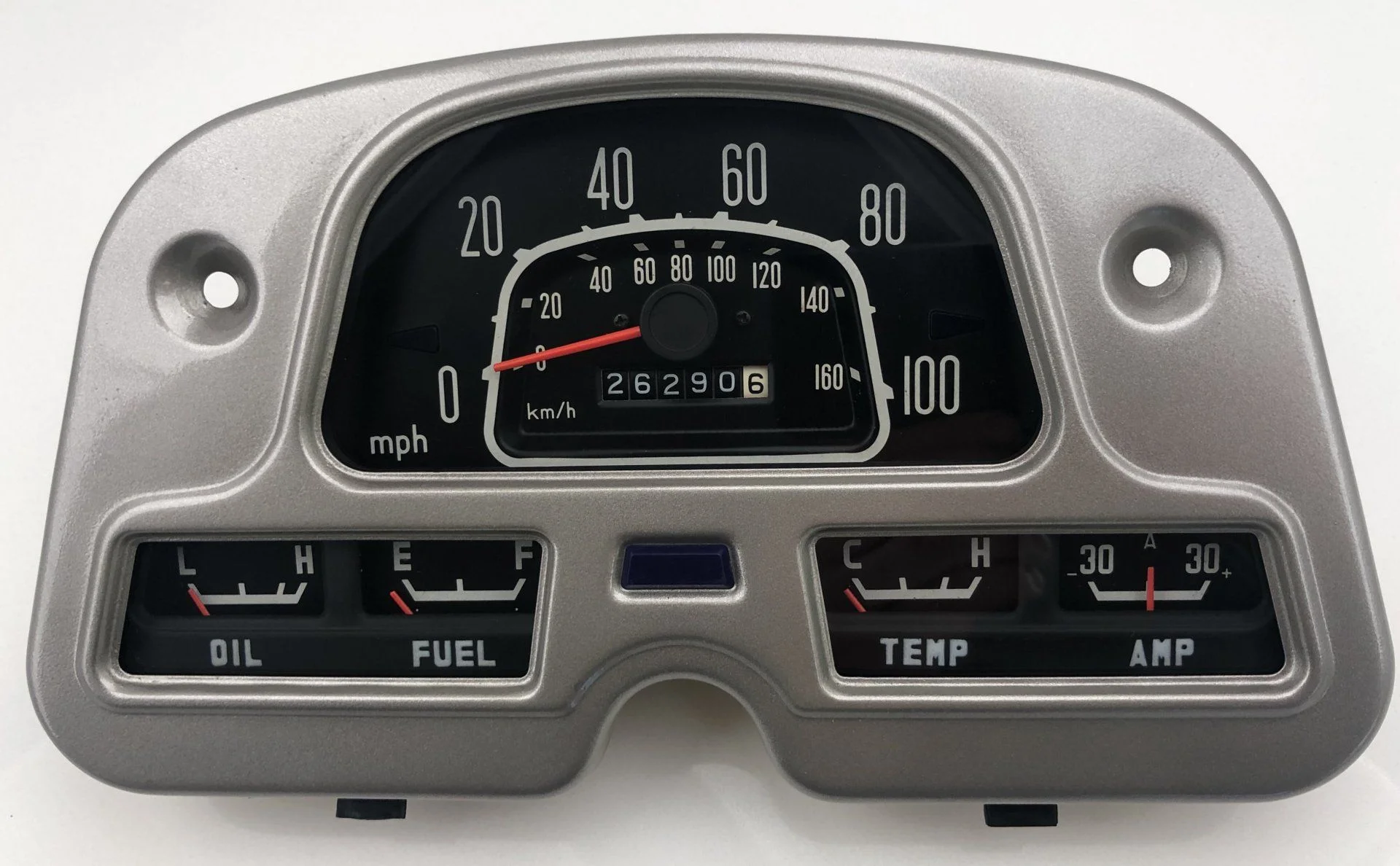

I purchased a gauge cluster along with my gauge cluster in hopes I can install it as is. However I ended up restoring both to my level of pickiness, which has been a great learning experience.

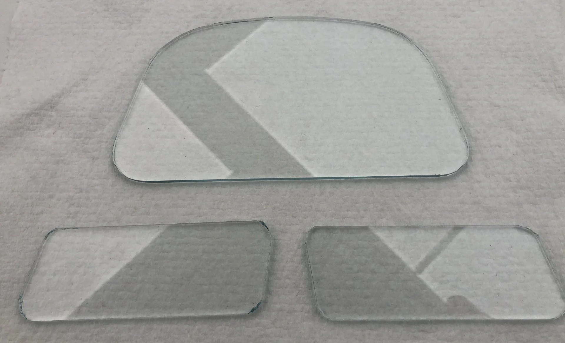

Something I noticed straight away was no matter the cluster, the glass is not perfectly cut with some corners a bit jagged. Here I am cleaning up the glass on one of the units:
Note the rough edges on the lower left piece. I polished with steel wool and cleaned best I could.

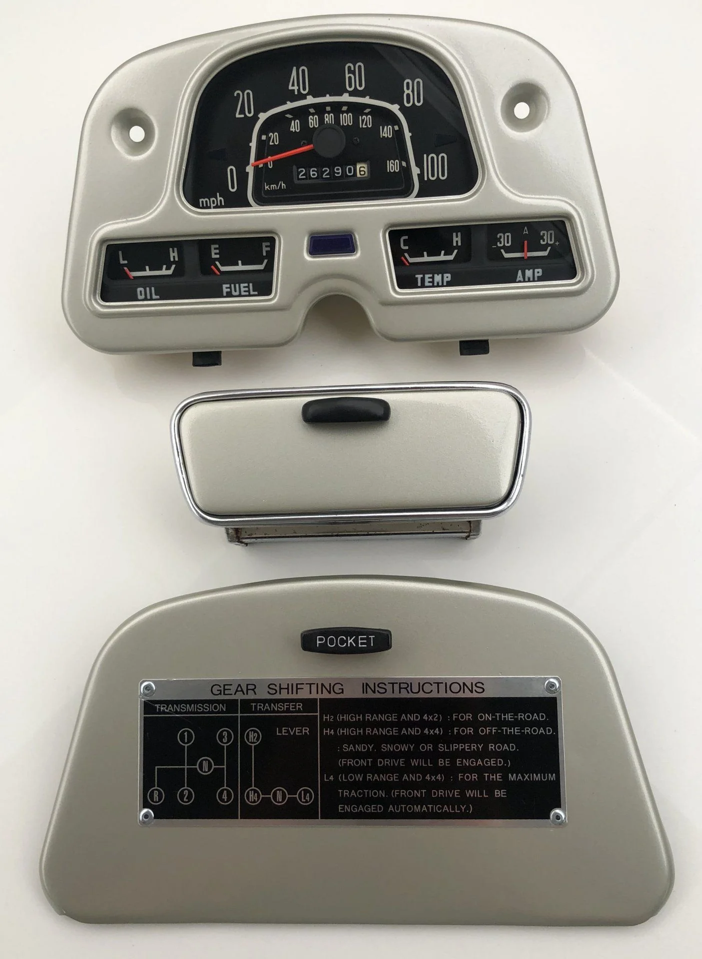

While this looks very silver-ish, almost slate gray, it is pewter and quite yellow-ish. Here, I have re-installed the glass into the bezel, along with cleaning the high-beam plastic piece:

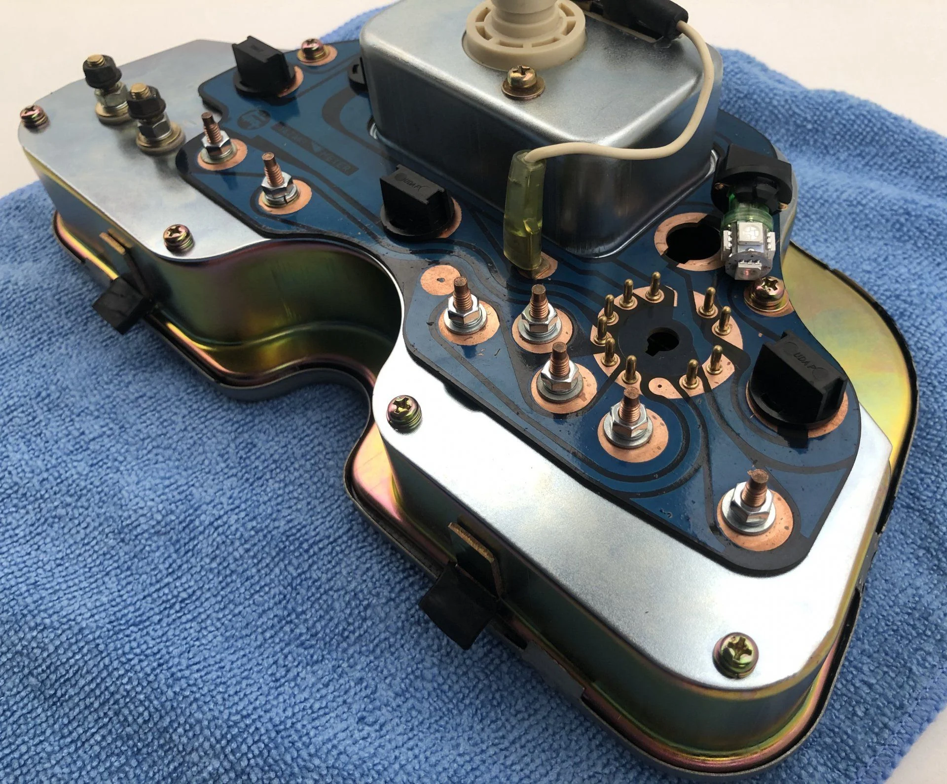

With a close attention to detail, I also fitted the unit with LED lights, with no modification to the housing.
Two green, one blue and two natural (not bright white) to give it an OEM look:
Here is the finished product:

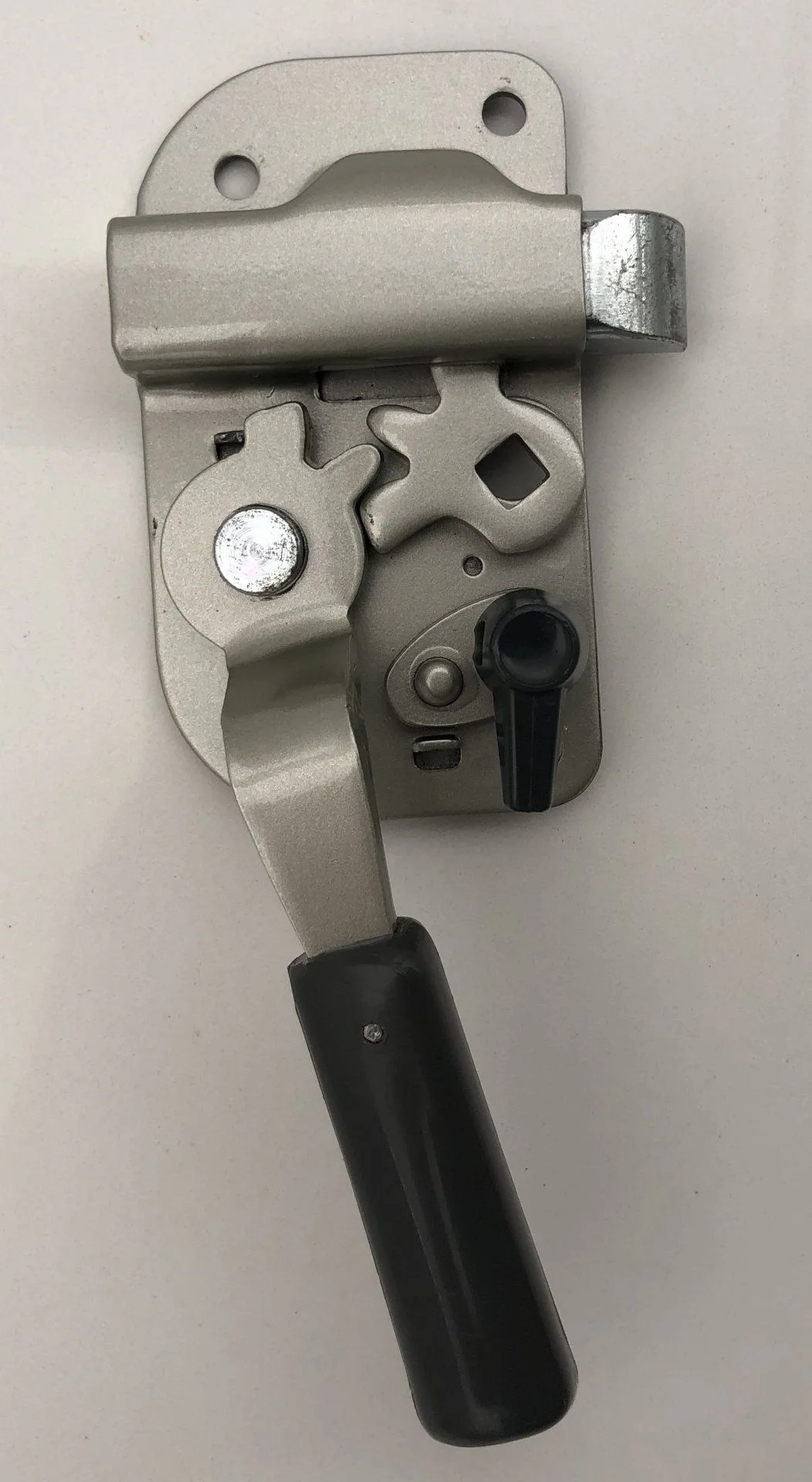

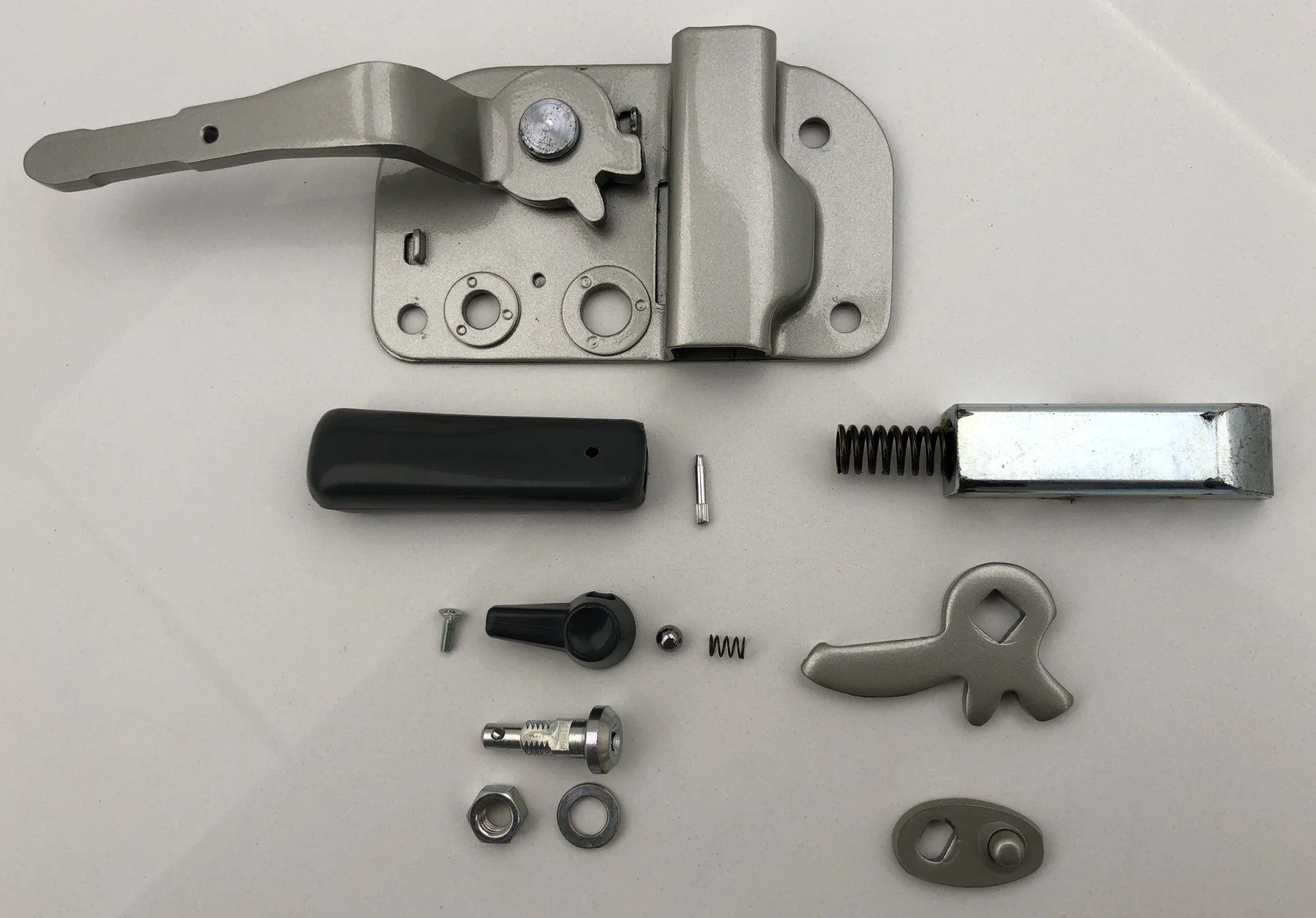

Rear door handle. Of the handles I had to restore this was the best to begin with. However, In all of them, there is a considerable amount of play in the main handle. I think this would be resolved by adding a brass "c-clip" in between the handle and pin. Does anyone have experience with this?
Lubed and assembled:

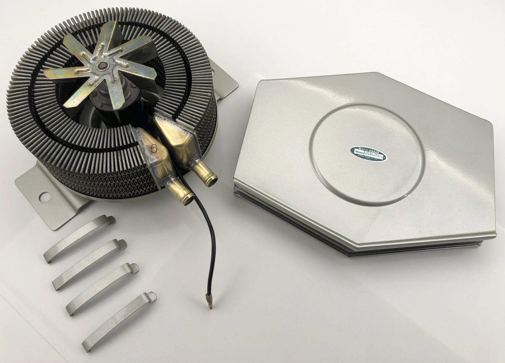

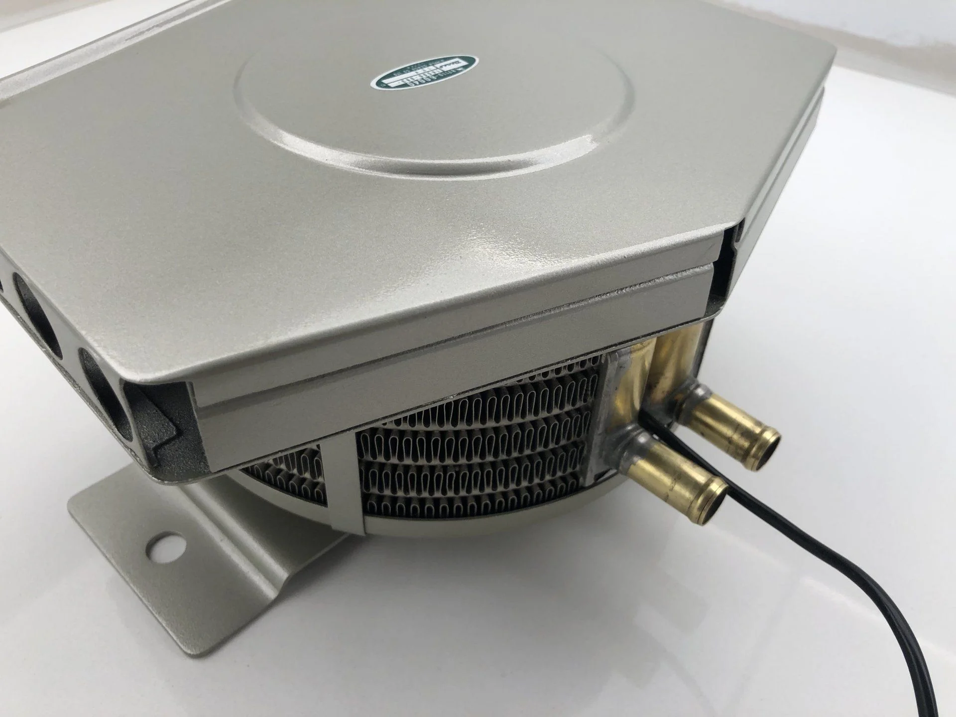

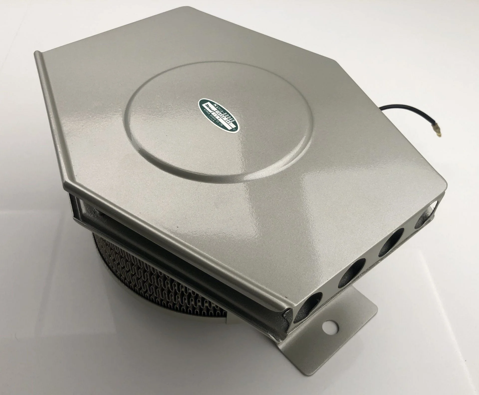

Rear heater work:

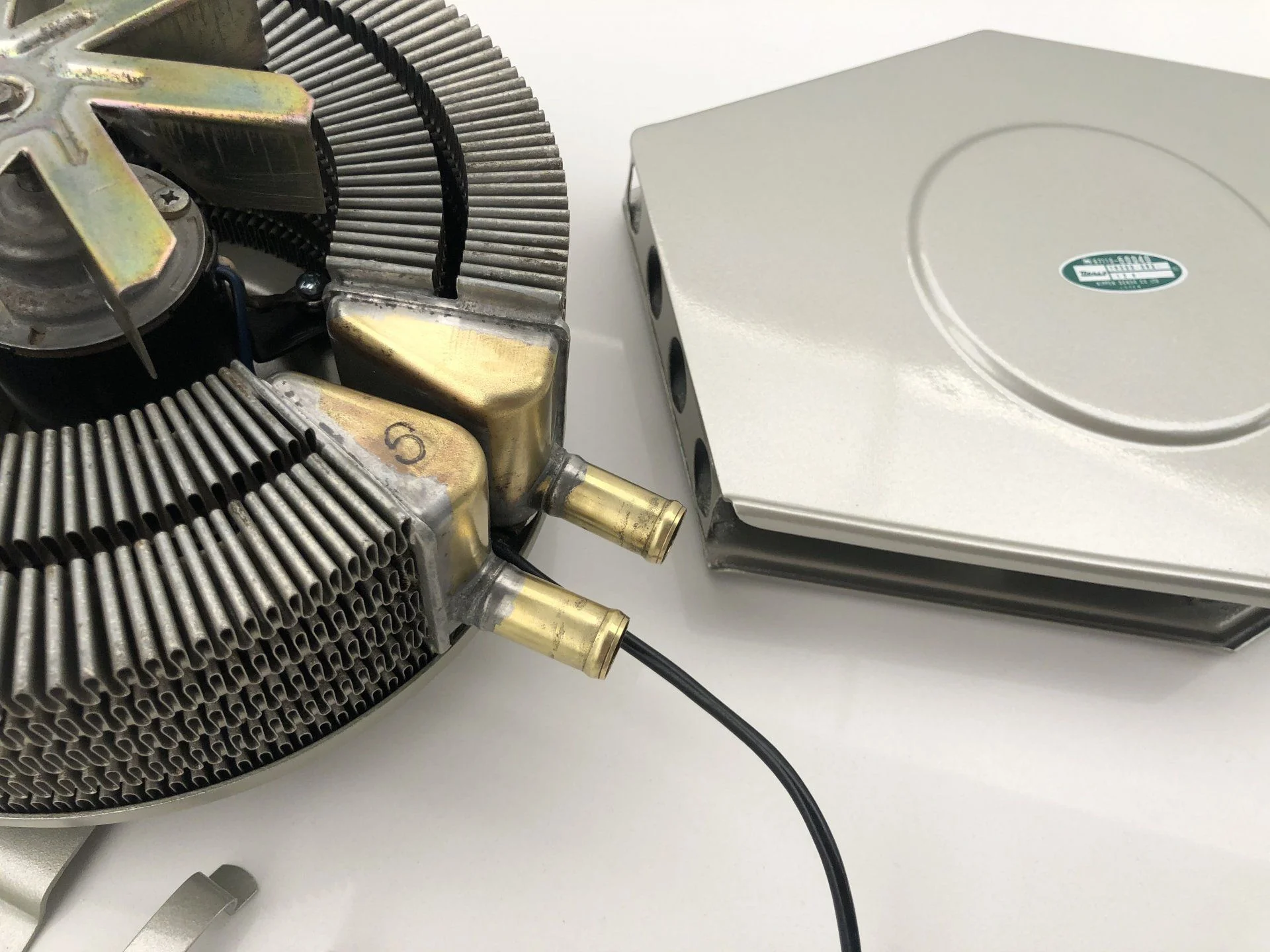

I'm not sure what this "6" is from. Appears to be stock.
Assembled:
Difficult, even with cleaning/sanding, etc.. to get a perfect paint job on the rear heater. I stripped and repainted a couple of times until I was happy with the results. The inside of the lid is a bear!

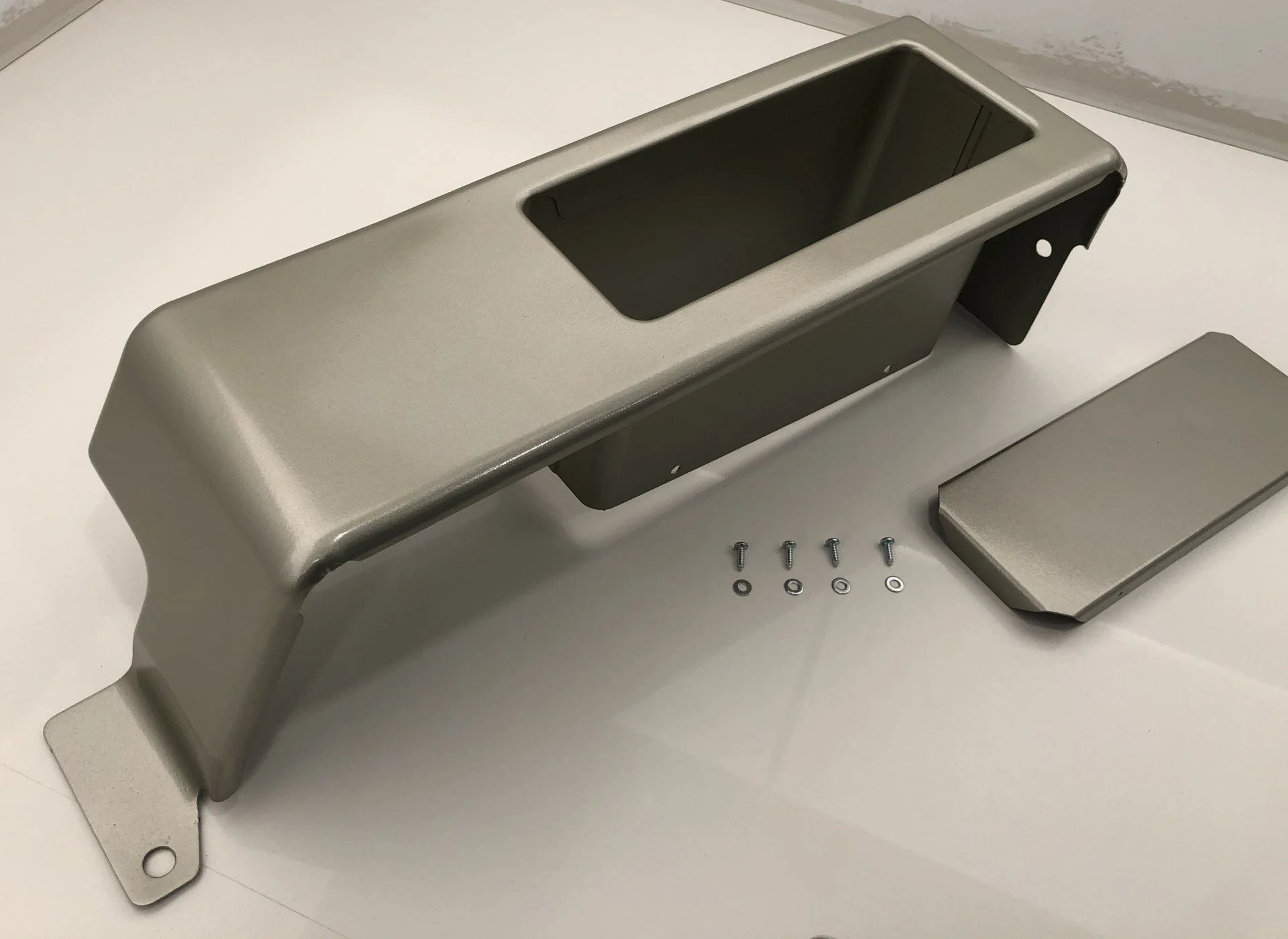

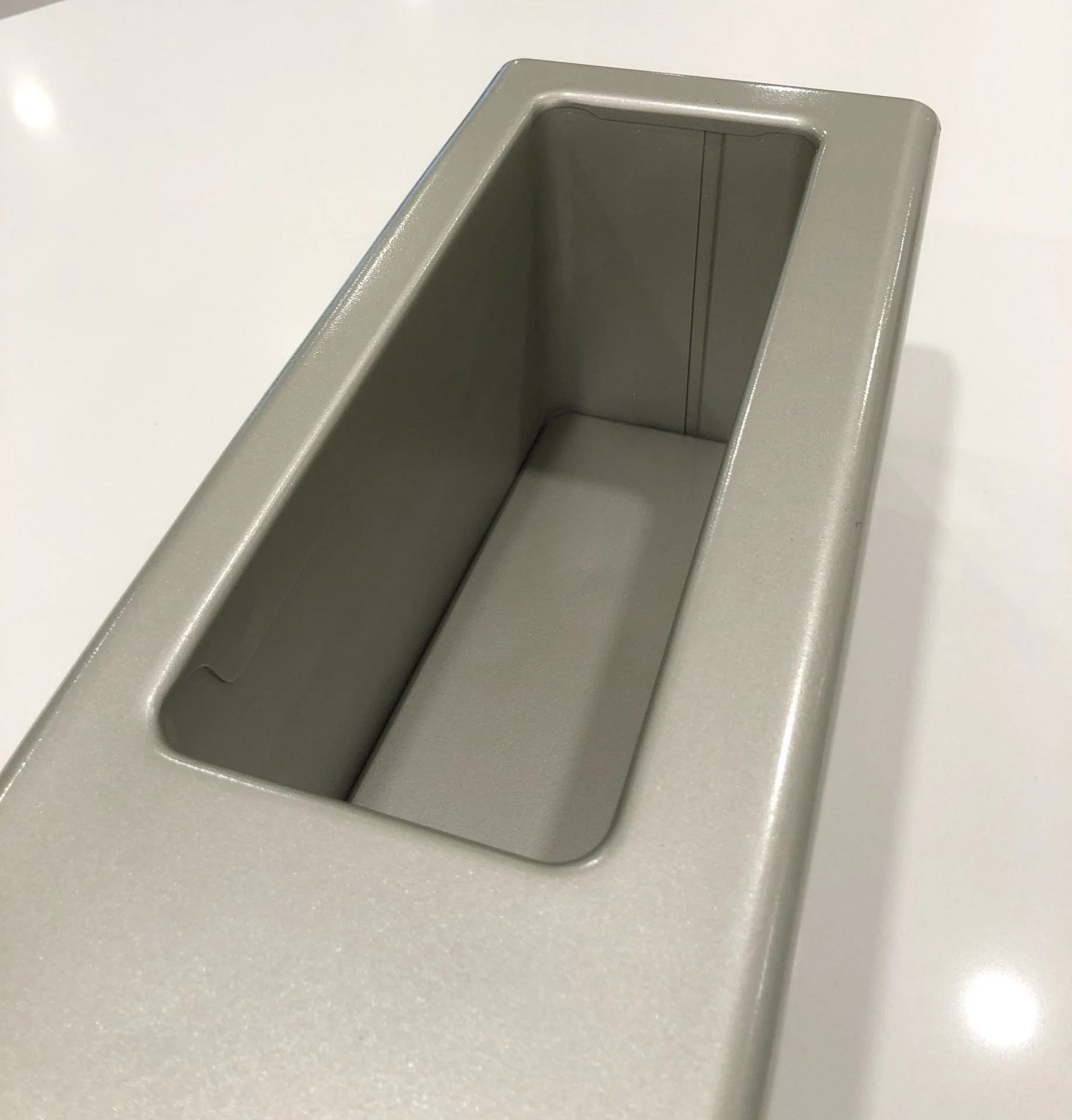

Oh, and the dash trio. I stripped and repainted these, too. Why? I used Cruiser Corps pewter rattle can, which is much more slate/gray than the stock pewter color. I'll mention again, that while incredibly difficult to spray, the pewter from CCOT is an exact match. A hassle to disassemble it all and repaint, but now all pewter is the correct OEM pewter color! There is a scratch in my "Pocket" through the "TR" of transmission on the top left. Ugh. I noticed this AFTER riveting two in. What a bummer.
