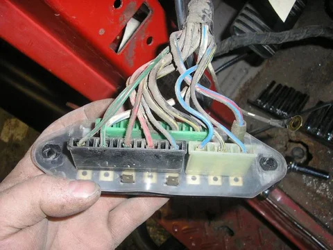

Finished tagging and pulling the harness out. The plan is to get supplies from Coolerman when the time comes and build a custom harness from scratch using this one as a template/ starting point. I plan to upgrade the headlight circuit and add in stuff like Ham radio, alarm, fog lights and anything else like webasto, house battery, OBA control etc, etc
What are the two bare spades for on the back of the fuse block? They were bare and unconnected as you see here - and live.

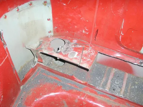

After seeing the "miker method" solution to the cage rear hoop anchoring in his thread I have decided to make a reasonable facsimile of his work. That means the "bench" across the back of the cab has to go.
Here is the start
And after attacking it with a few tools I found there is quite a lot of connection points in there. I started with the spot weld cutter but soon switched to the cutoff disc on the grinder to get the majority of material out of the way.
Some progress - pretty awkward area to grind in without damaging the rear wall

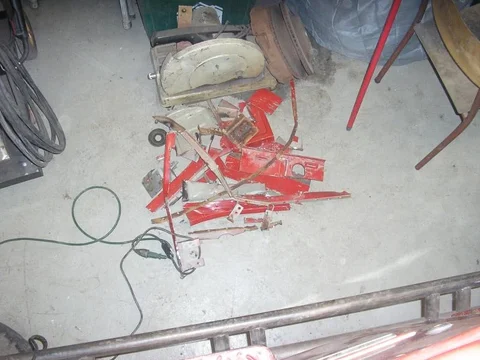

This is the pile at the end of Sunday - worked on it some more tonight and made the scrap pile twice as big. Still not quite done
This looks remarkably familiar. :D
I tried to carefully take mine apart and then became more and more impatient and agressive until I ended up with a pile of scrap metal just like that.

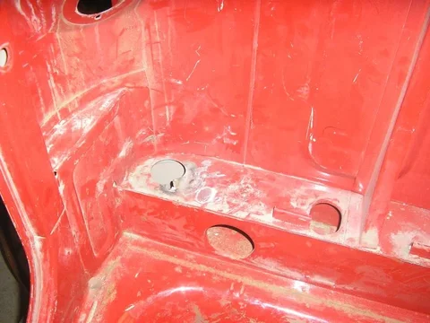

Yours looks very clean and rust free behind the shelf. :)
I definitely scored when it comes to rust on my truck. I have to cut out a bit under the pedals by the drain hole on the drivers side. Otherwise it looks solid. I'll know for sure after blasting in the spring.
Save that pile for people that may need factory bends and curve to do their own repairs. :D
I know just the guy - ;)
Yes, I could. Wouldn't be cheap though. Lots of welding and bit of machining involved in the one I made.
Wow, that cab is in great shape.
I can't wait to see what you come up with at the end of this little adventure. Keep up the great work.:cheers:
It's got a couple holes but I'm not complaining.
I found a new one at the rear cab mount - above the x-brace
I got the rest of the bench removed - just gotta grind off the buttons from the spot weld cutter and a few factory weld beads. Then I can begin the "miker method" cage mount install
