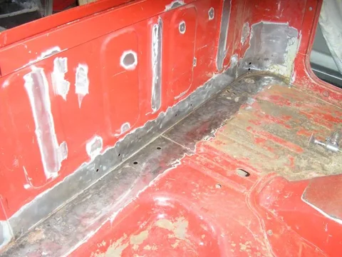

Yes, for sure. Once the "bench" is removed the back 6 or 8" of the floor is quite wobbly as well as the rear wall without the vertical stiffeners. If you go and see miker's handiwork in the link I gave several posts above you will see what I plan to do.
There will be a rectangular structural tube under the floor after I remove the factory X brace cab mounting brackets. I will also run a ≈5" wide piece of 1/4" plate across the top side of the floor and add new vertical stiffeners and corner bracing.

To that end, I have finished cleaning up the spot weld buttons and misc factory welds today. Miker had his all blasted and in primer and so was able to weld up his base plate permanently. I will be blasting the cab later and will not be welding the plate down just yet or fixing the rust holes. That means my next step is to fab up a base plate to take the place of the bench and give me anchor points for the cage.

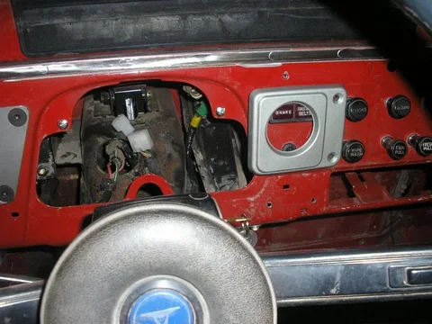

I got myself a tach bezel from HJ47

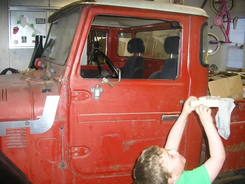

Seats are comfortable and have a good support, perfect for a DD... have still a Recaro seat mounted in my 43
Take care of your 45, Kevin. ;)
Have seen in one of your pics, that your foreman ;)
can reach the door lock....:D
