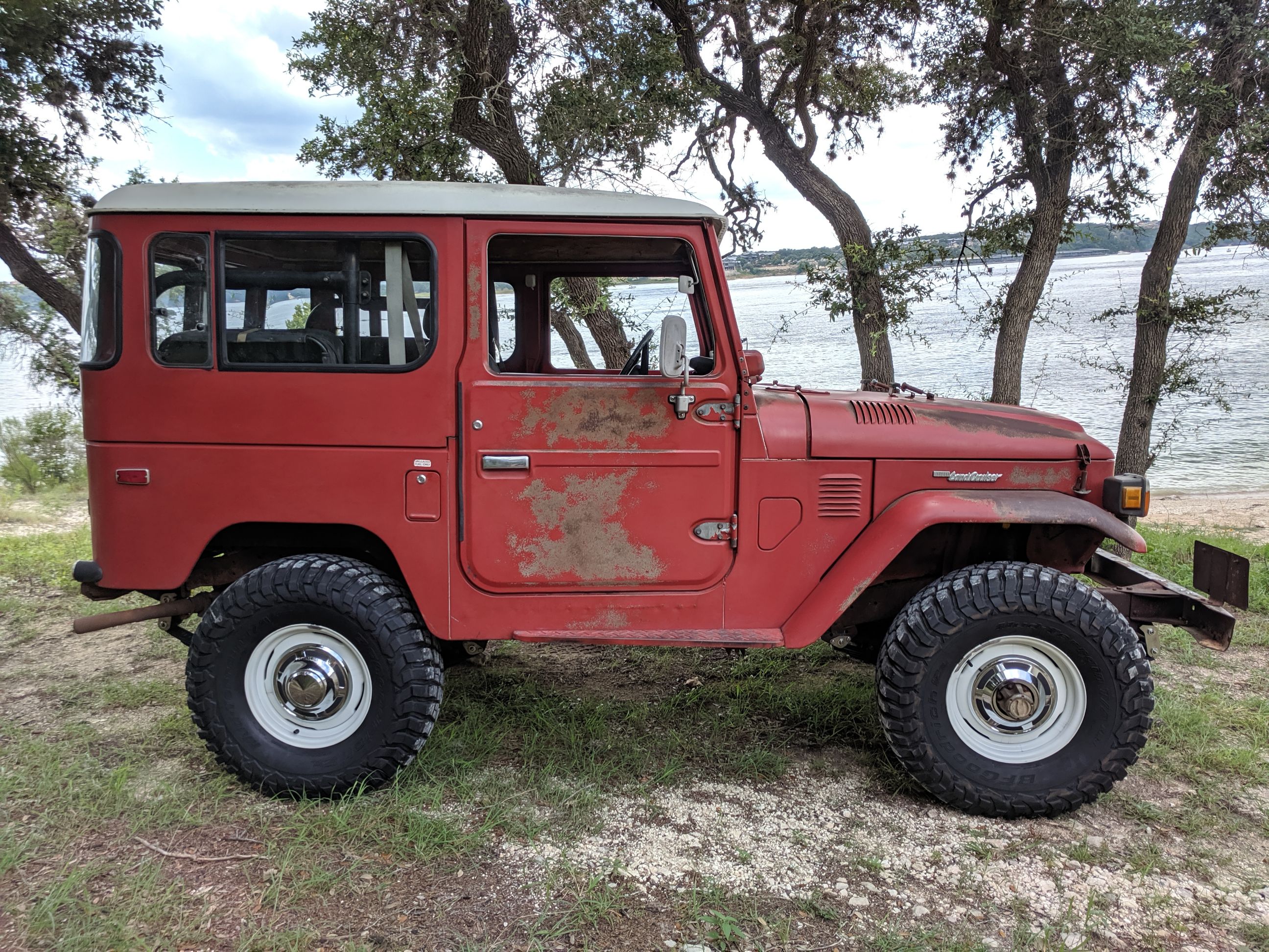

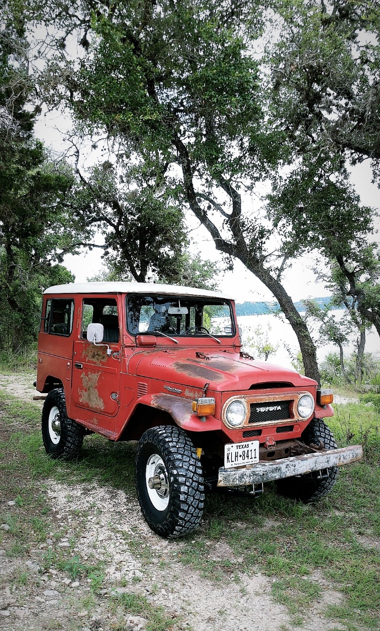

Here are a few photos from when I finished the lift install and took the truck to the lake.

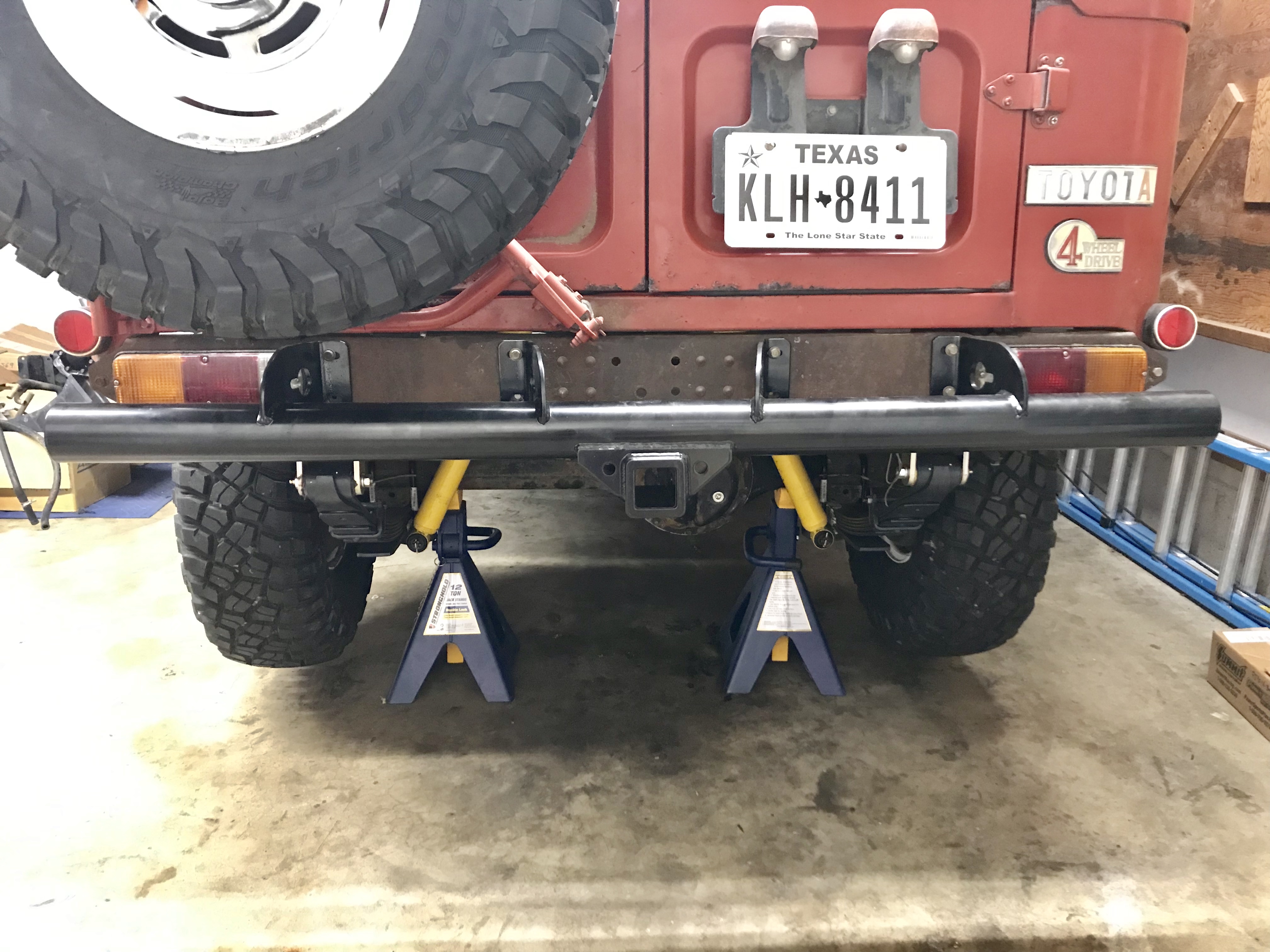

I still need to finish the rear axle air locker before I can start on resealing the motor and reassembly.
Looks great!
yeah.^^ The white wheels and bigger shoes made a heck of a difference.

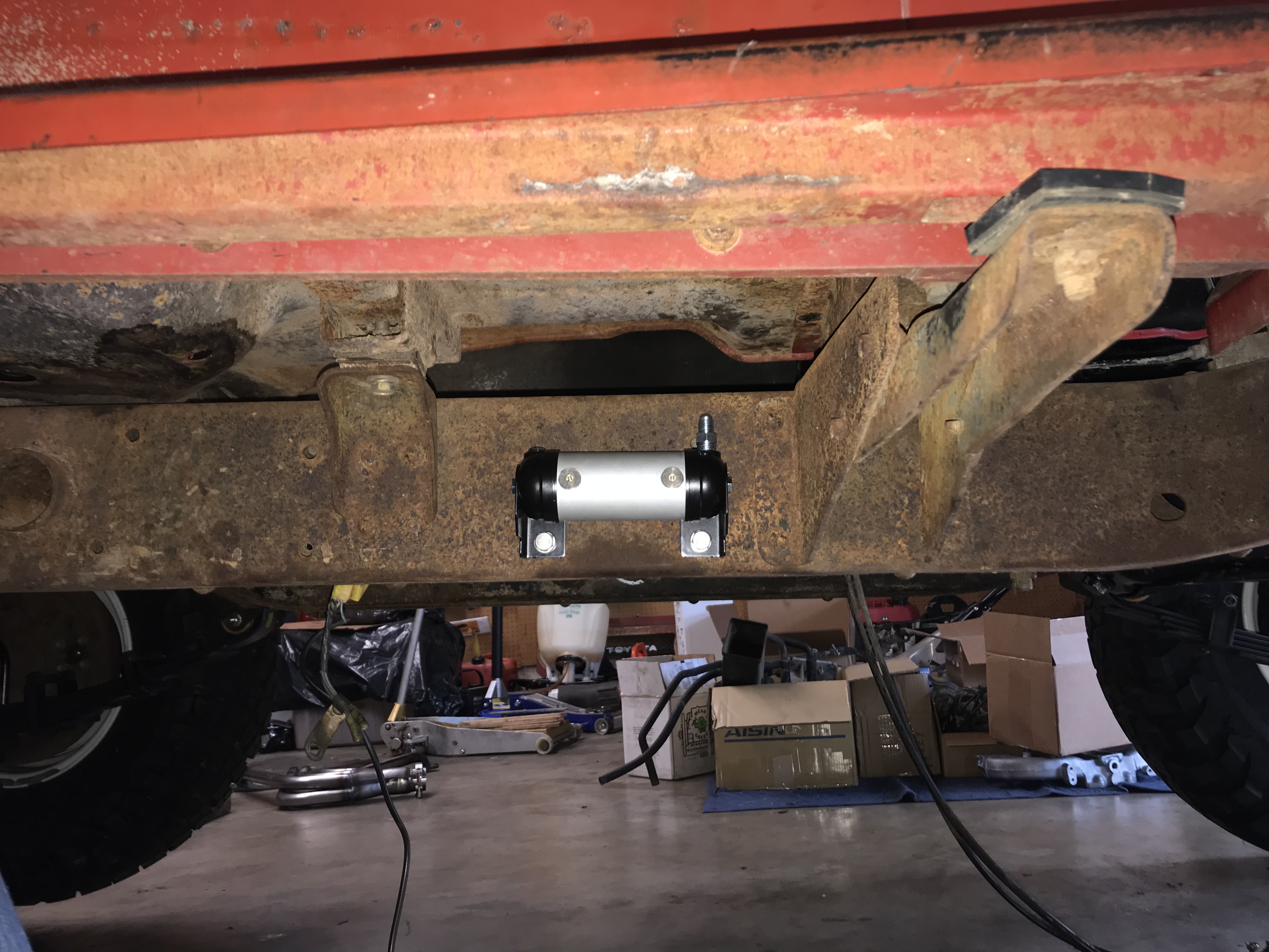

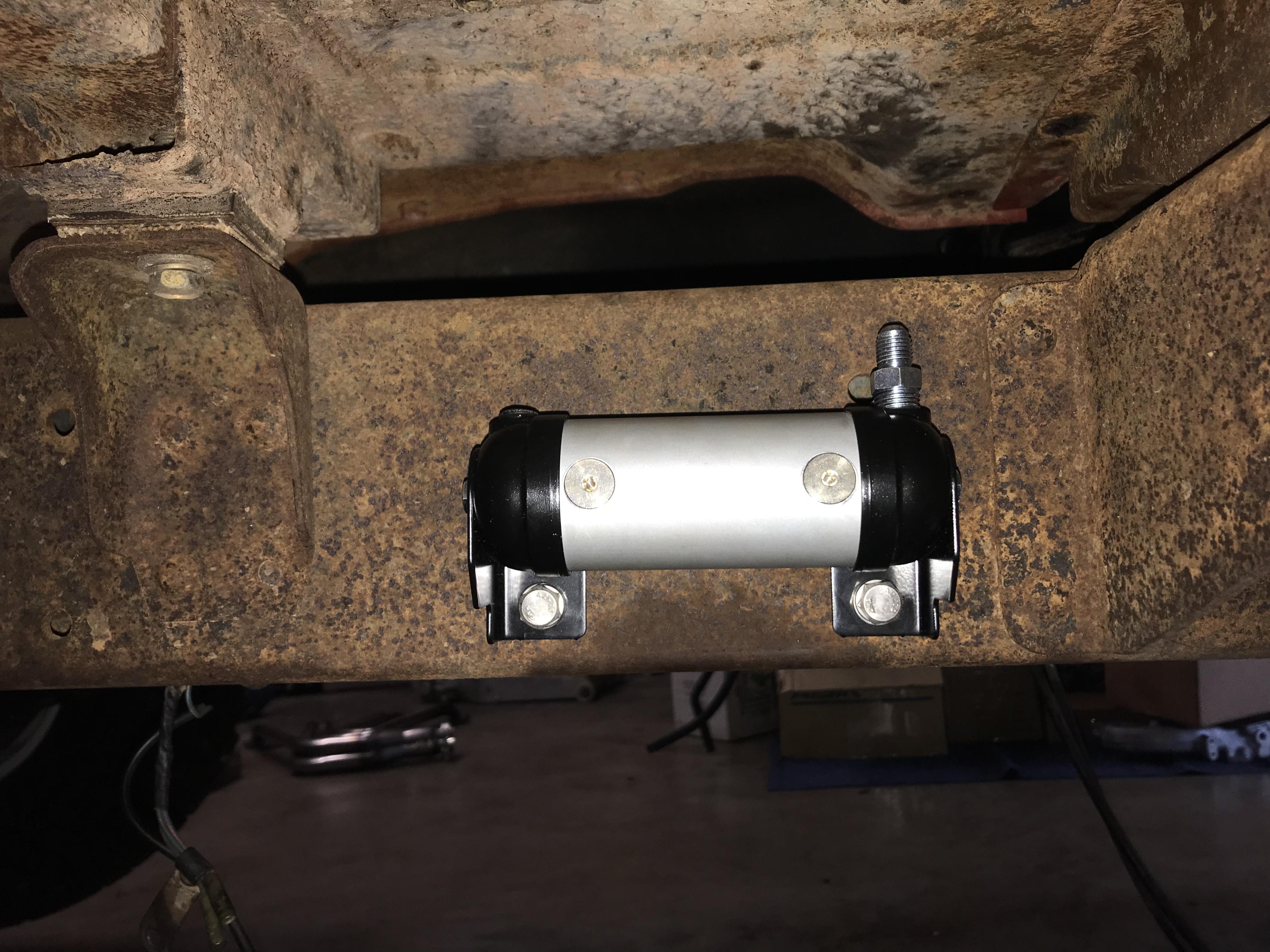

I had a couple hours this afternoon to clean the garage and wrench on the Cruiser. I was able to get the ARB mini air tank mounted on the passenger-side frame rail. I still need to run the air lines. I used a set of stainless steel M8 rivnuts. I was able to take advantage of an existing hole in the frame, so I only had to drill the second hole in the frame for the other rivnut.
I still want to convert my rear tube bumper into another air tank for filling tires, but the mini tank needed to be mounted either way.
That's all for now.
Sweet cruiser! This is the beautiful thing about these rigs, you can turn them into whatever suits your style/use/application.
Looks awesome by the lake! My personal taste (purist) is what it originally looked like, gray factory color on wheels, stock height, ready for war.
Great pics!
