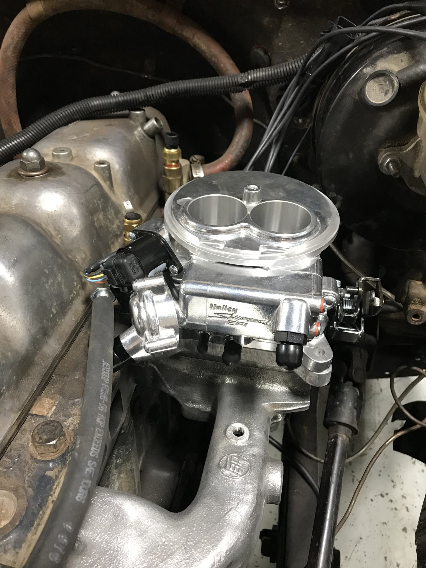

I'm also looking at a Holley Sniper EFI conversion.

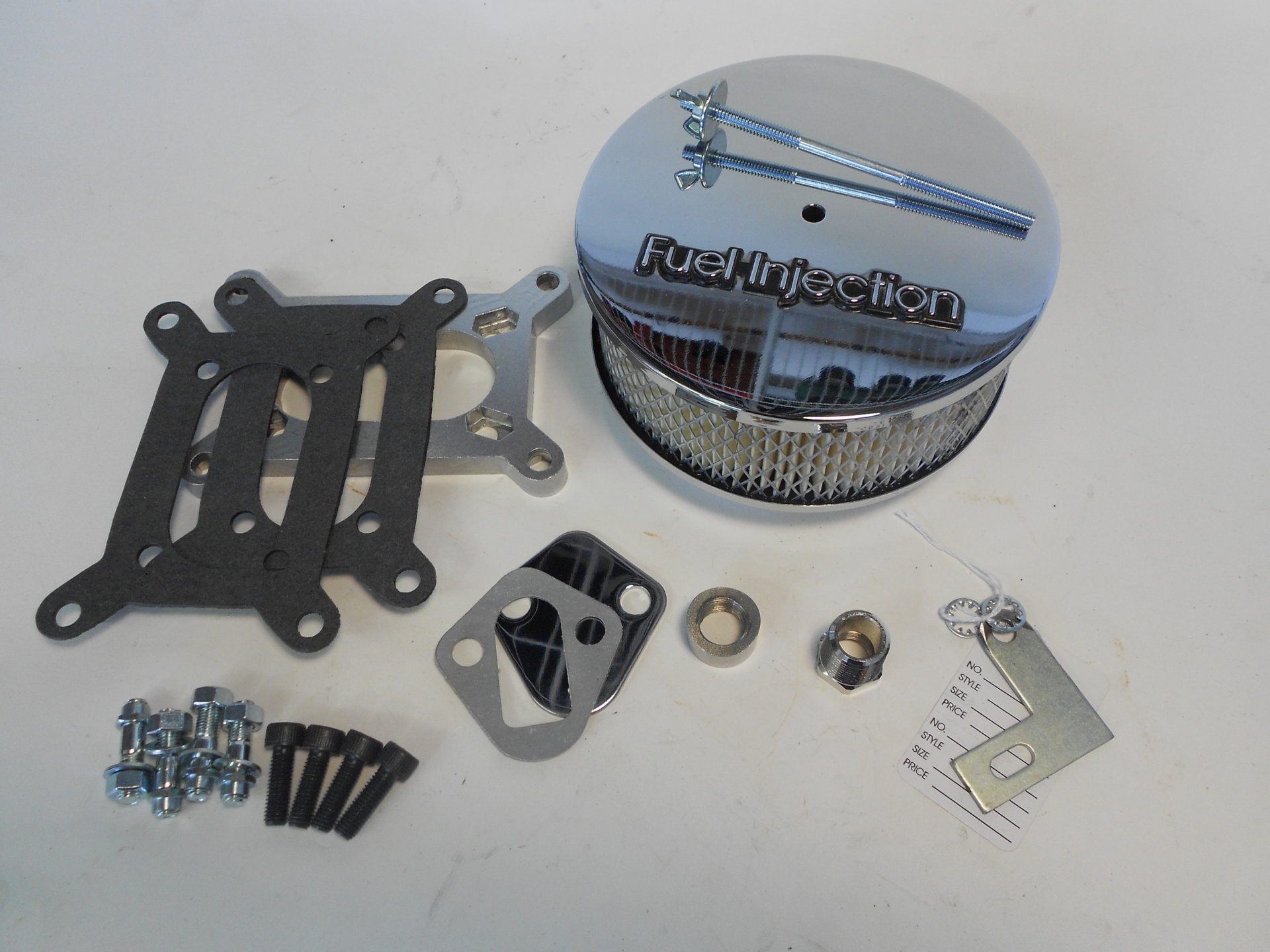

I just PM'd member @Downey to hopefully get ahold of one of his install kits that includes an adapter plate and throttle linkage!

There is also this option
I saw that kit as well, but didn’t see much feedback about it. Is it better than Holley Sniper Kit?
Sorry sent the wrong link. I will be going with the Holley sniper kit as well. Meant to forward this link.
Thanks for the heads-up on this kit. I ended up purchasing over the weekend. Cam was great to deal with. Lots of updates coming soon!
