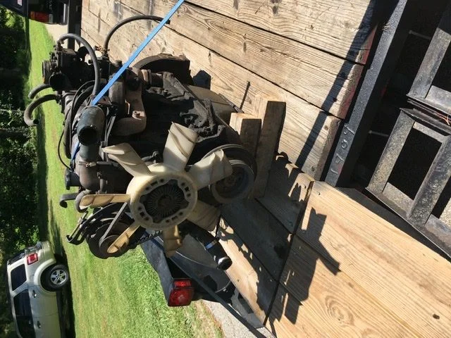

I need advice. My son says don’t swap the engines. It’ll be a pain, but the clutch is worn and here are the compression numbers. The clutch would need replacing in a year if it was a daily driver, but I’ll only drive maybe 1/2 the time. What do you all think? I’ve got a new aisan clutch ready to go, the cherry picker, and the donor engine.
Dads 85, 85, 90, 85, 90, 85
Parts 137, 135, 130, 135, 120, 132

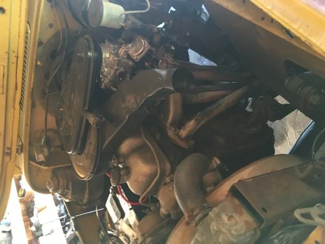

I think your son may have some points. I know the intakes changed over the years as Toyota was trying to comply w/ EPA specs. Finally in '79 they went to a cat converter (Put cats in, get dogs out).
You may have a lot of monkey business switching intakes and exhausts and EGRs to get the swap "right".

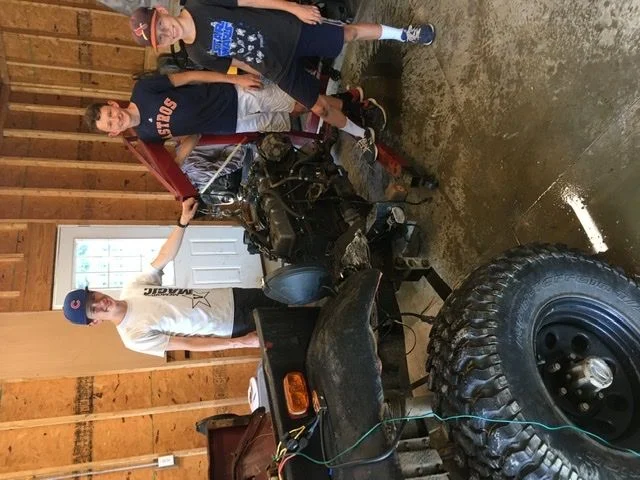

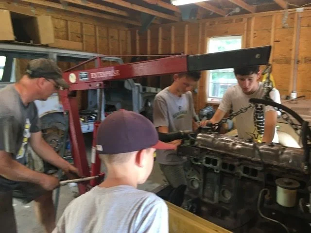

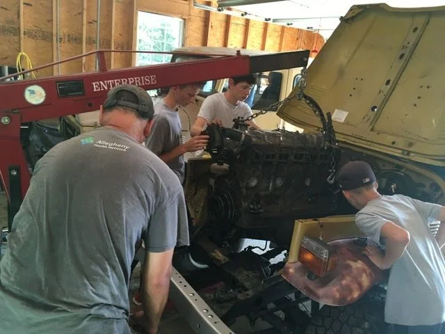

We'll see, you and Nate might be right. Maybe tomorrow we try and install new engine??? Didn't get a whole lot done today since yesterday kinda wore us all out!
In the midst of it! Whose idea was this??? @PabloCruise ??? @RUSH55 ???
Only managed to bolt in 4 bolts in 4 hours. They were the 4 connecting the tranny to the engine though! Did @RUSH55 say this would be easy? Had to our in smaller bolts through the holes to bellhousing and ease them together 1/8 of a turn at a time. I tried and tried different angles and heights waiting for the to just kiss. No such luck though. Oh well, it’s in!
