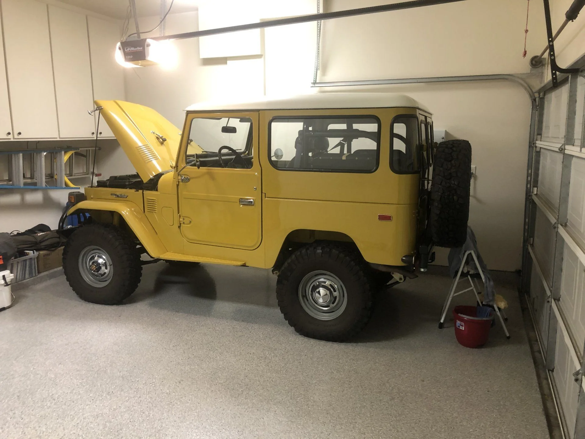

Looking forward to taking care of this 76 FJ40. Very clean AZ truck. Driver and getting it ready for the family and use locally and in CO. Got the plates yesterday and 30 miles so far today. Working on the first and always tank of ethanol free.

Love the stance...is that a 2” lift? 33s? I’m collecting photos for my near future (very near) rig.

yes 33’s with a 2-2.5” lift.

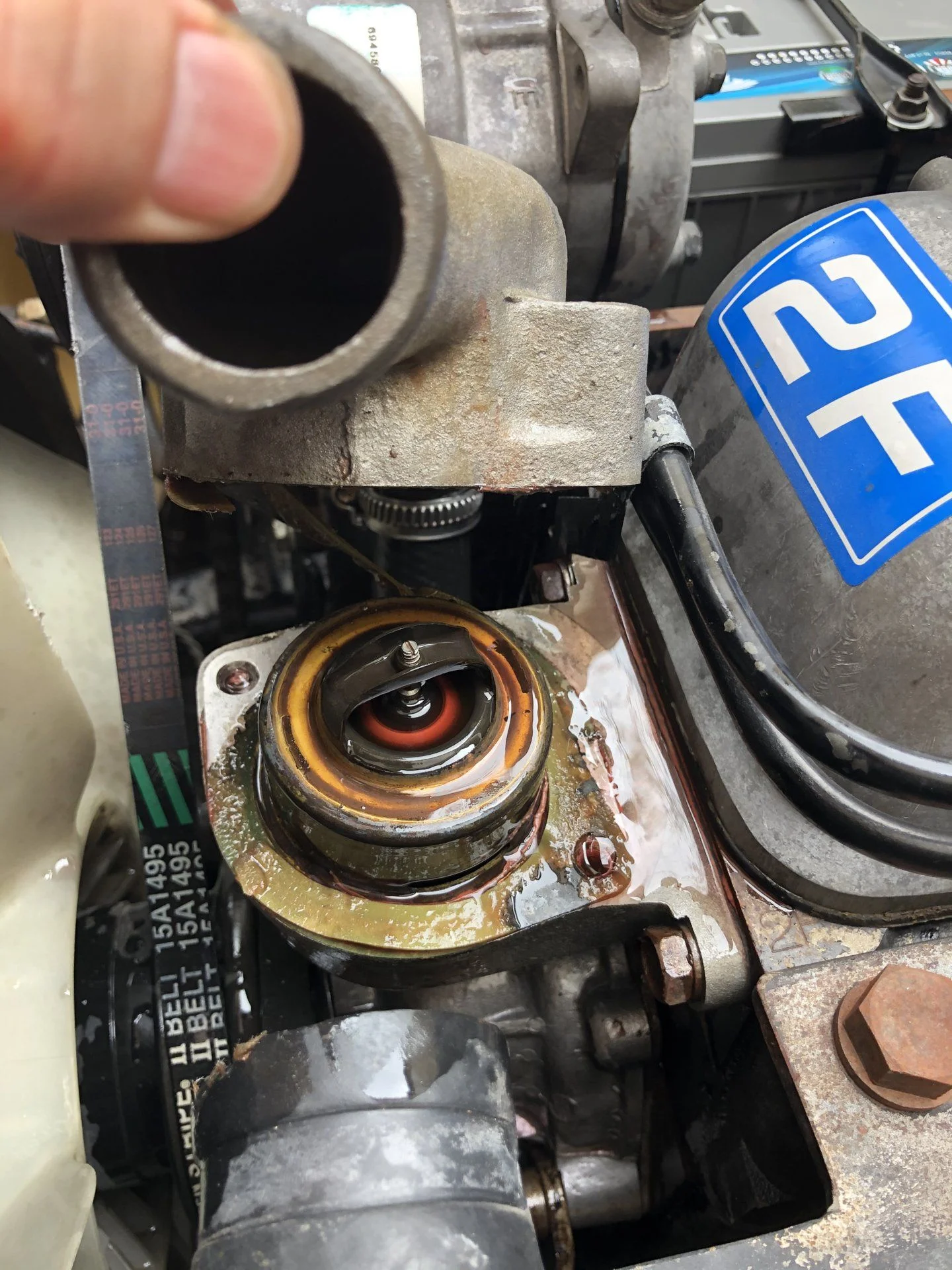

Over the weekend I put a few more miles on her. Changed filters, air and fuel. New thermostat, rubber has been in there for quite some time. Got the heat to work with the old vintage air, will need a bit more work to it working without holding an elect switch with hand.
Adjusted most doors to stop rattles and squeaks need to tighten up the air tank today and continue on carb adjustments.
Big job next, reseal the cowl to windshield. Will be a delicate job so I don’t mess things up to much, but I get a glovebox full of water when I wash her.

Very nice rig! At what point was it re-geared, the ‘76 came with 4:11’s. Great looking 40. My brothers is destined for this.
Beautiful truck. Regarding your leak, I'd start with the hood hinge bolts. A dab of silicone under the bolt heads and some rubber gaskets between the hinges and the cowl will do the trick. Next culprit would be the windshield hinges.
when the PO installed lockers front and rear. These gears are perfect for HOUSTON. May not like them in CO so much!
