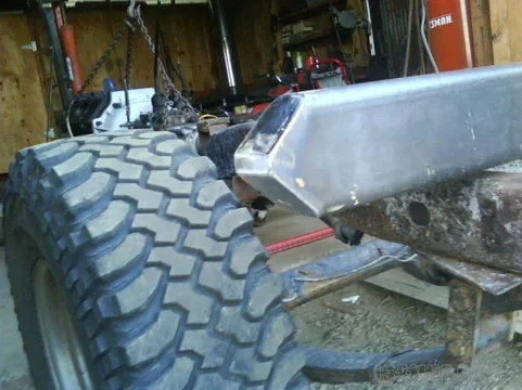

This is a pic of how I wanted it to end up and I basically mimiced the factory rear bumper end curves only I used 2x4x3/16 tubing front and rear. I simply cut the rivots and removed the factory bumper including torching the rear angle frame to bumper brackets with a simple guess.... They pivot so as long as you use a t - square or straight edge they will pivot into your bumper nicely. You will have to fold the bottom of the corner up with a hammer prior to welding - no problem though.

I just simply used some 1.5x1/4 inch strap to box it in with (this pic is obviously the front bumper which is 40" total long

However I choked when i made my bumper slightly longer than factory to tighten up the gap. My rear bumper is 5' and a 1/2 inch and it should have been closer to 4' 10" if I wanted to keep those bends which I really liked.

Now I had to hack it quickly in order to get the tub to sit down. Now I plan to lift the tub back up a foot or so in the back, throw a welding blanket on it and cut about an inch or slightly more back off that ugly sucker and put back the curve, flat end, and then curve. The curves will not be the same now and it will never look as good as it would have but I plan to cap it back off with some thicker metal than before that allows me to cheat a bit and with the help of my trusty grinder put the steeper angle back in it as i wanted! My friends think i should section a piece of tube and lay it upside down to put a similar curve into the bumper as the tub but I like square angles......:meh:

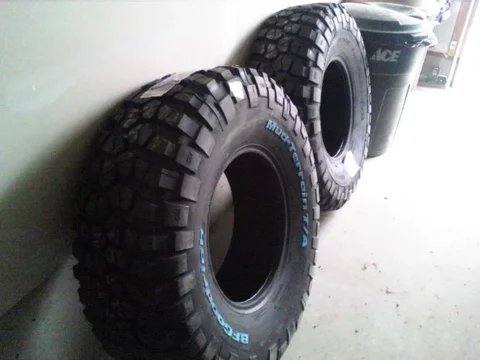

Ok now that I even annoyed myself with my inability to make a decision on tires I finally pulled it together and ordered today:
Order Details:
Quantity: 4
Make/Model: BFGoodrich Mud Terrain T/A KM2
Prodcode: 02707
Price: $290
Subtotal: $1160
Shipping: $141.08
Shipping Method: Fed Ex Ground
Final Total: $1301.08
I really really really wanted the recentered hummer wheels but :meh: there were just to many things that didnt work out such as pressed centers and they were very heavy. Dang they were sweet though!!!!
Now for rims... Just kidding I dont really have any options I am going to go with Camcruisers thoughts with the cragar smoothies that you can have your backspacing set at whatever you want. The problem with my BFG's is that I had no choice but 17's or larger and most 17's have a 4.5 backspacing or greater..... I am sure since they are 17's they would probably clear with whatever backspacing but I want 2.5"-3". I do want to mix them up a bit so I might either simply weld rock rings on them and then cheaply spray them with hammerite or suck it up and lock them since it wouldnt be that much more $$ and it isnt like I am going to be going 80 mph so I think I could play with them enough that I could get them close to balanced.... I said close :D

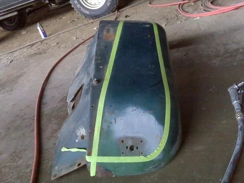

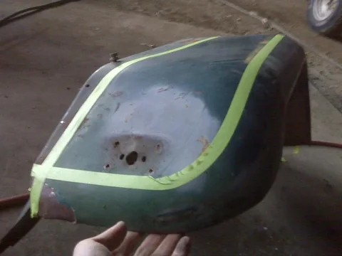

Now for the new fun. I headed back out to the shop today to sit there and scratch my head about my fenders...... I can:
A - put a lot of time into the fenders welding up the cracks and making them nice or
B - Cut them off just shy of sticking out past the upper fender aprons allowing me to put the entire cruiser back together.... then later cut the fenders at the outside tape line and slide them inbetween the apron and inside skirts, drill new holes to rebolt, then using them as a guide build tube fenders and tack them to the tube making for free skirts..... Of course with my trusty welding blanket protecting the paint at ALL times. And heaven for bid I did screw something up we painted it once we can paint it again right??? :D
Oh crap you got to be kidding me I erased the pics trying to get them off my cell. :bang:
Well hopefully it makes atleast some sense... Since you cant see the tape in the pics I would cut about two inches off the outside of the front fenders and that would also help with the way they drop so far in the front. I know my stock running boards wouldnt fit any longer because I would purposely be narrowing up the fender by a total of about 2" but I could whip something up for rock sliders/steps

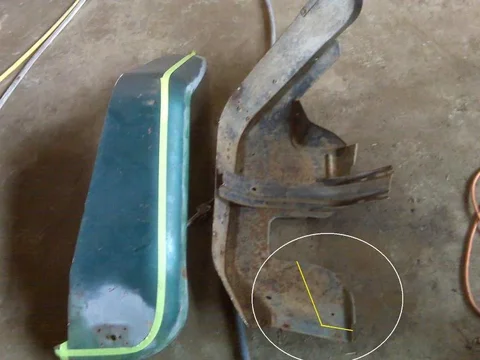

Ok I took pics of what I accidently deleted the other night however the other night I was looking for opinions on weither I should do it. Tonight it is too late!! :D
The good thing is I can blast them and paint them and get the cruiser on the road minus front fenders and then fab somthing up! I need to cut out the drivers side to clear the scout box but wow their will not be much left other than a strip for the front grill to hook to. I may need to plate it in order to reinforce it a bit. I will be cutting a W shaped piece of 1/4 inch strap to kind of box the inner brace back into the sheet metal to reinforce that at minimum.

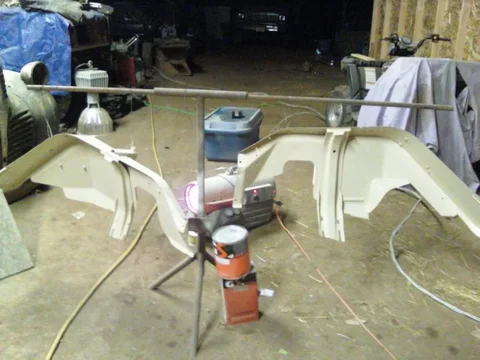

Here are a few pics of my inners and the one pic shows my attempt to reinforce the fender where I removed the brace. There is going to be so little weight on it and everything ties together so it probably didnt matter but what the heck. Also you can see the material I had to remove to clear the box. Now to weld them up and shoot them with sealer, paint, and clear. I think I will hold off on the undercoating on them until they get all chipped up and then bring it on!!

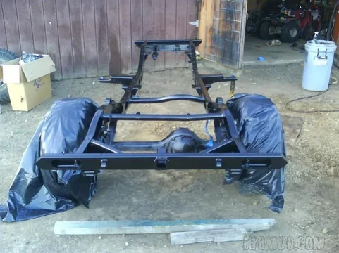

Tires showed up today and I welded my fender supports in last night so now I am off to shoot the inners tonight. I stared at my wiring harness last night for about 10 minutes scratching my head.... It is so crazy some of the little things you tell yourself no need to take notes a monkey could put it back together and you forget it will be a year or more later.....:eek: Well one thing about it I was right a monkey will put it back together :censor:
Here is tonights progress as claimed....
I sprayed them myself so if they suck blame me ;p I got kicked out of the paint booth for a Wicked Dodge Dart!! :-)
This is sealed and I forgot to get after clear coat pics because it was late but they are grey and cleared also along with we reshot the gas door because of a nasty little clear coat run that I couldnt get out.
