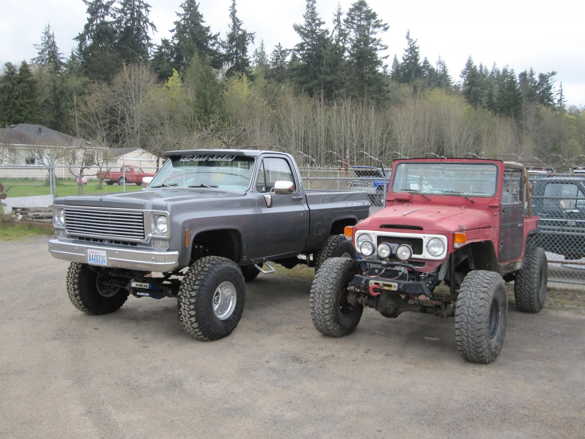

@4x4 Station Wagon This is a beautiful 40! Planning to install the fenders or leave them off for that aggressive look? I restored a '75 chevy in high school, did all the body work and paint myself. It was the same color. Seeing your build really makes me miss that old truck! The crappy part of doing all the work yourself, is you know all of the little imperfections and also know you are to blame. It got to the point where I couldn't enjoy the truck because of all the small things that bothered me so I just offed it. Sold this thing in 2015 for $4500 :bigtears::bigtears::bigtears:
Thanks for sharing your build, I admire the persistance as it looks like it's been a long road! Look forward to seeing you enjoy the fruits of your labor soon.
Nice rigs! Yes on knowing every imperfection!! I too first restored a 78 ford 1/2 ton short box but when I inherited the FJ40 I knew I couldnt have two yard ornaments. I am back and forth on the fenders. I saved the running boards and the cut fenders and have always planned to bend some tube fenders up but that will be a project after I finish the top!

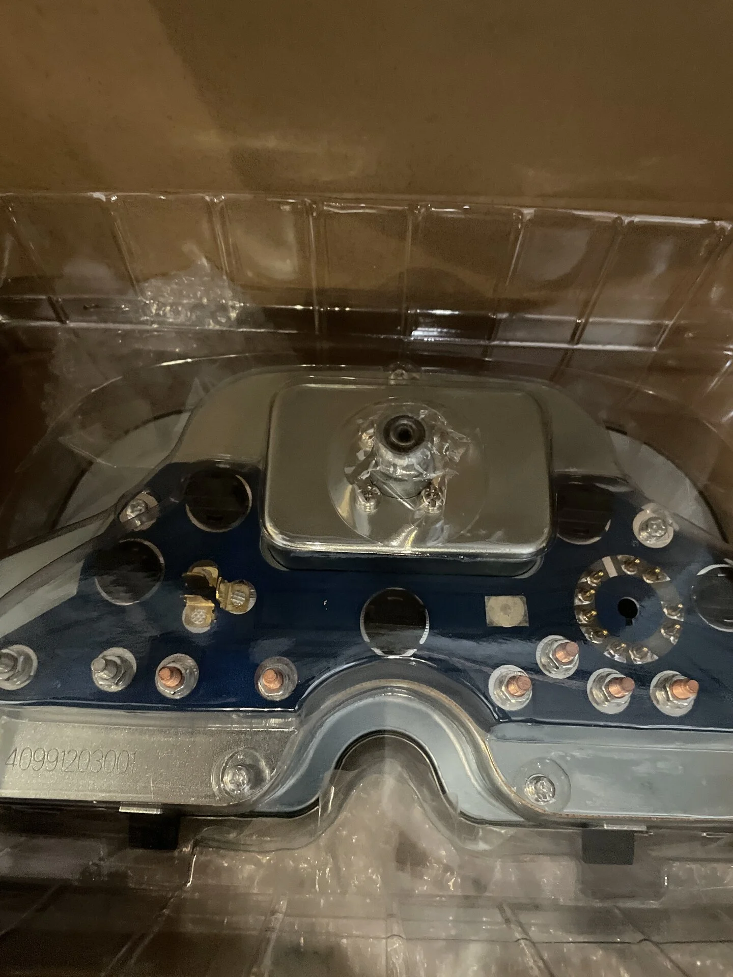

I have exhausted (pun) way too much time on trying to figure out how to make the new gauge cluster work. I am specifically on the existing 30 amp gauge and now the 50 amp non internal shunt gauge. I have read a ton and fully understand how the white wire takes all of the current to the dash and through the 30 amp gauge and how the new 50 is not intended to take that load and will fry. I have seen all of the remove the white wire or add a fusible link at battery etc etc but. Why will purchasing a 50 amp shunt 50 or 75 mh or mz i forget which not work to simply hook up at the white wires where they used to connect to the 30 amp cluster gauge and then run wires off of the shunt to the new 50 amp gauge??? I know I am missing something as it seems to simple. I understand that the load would still come into the cab to the dash as it has for over 40 years. Any help is appreciated thanks
