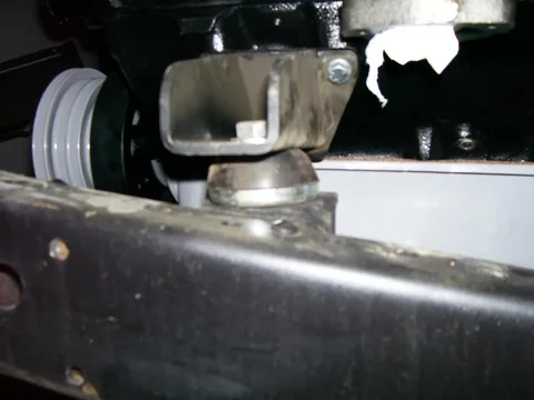

This pic you can see it touching my floor
This pic you can (i never noticed before) see the head of the bolt actually touching my tub... Holy crap huh I placed the L bracket level with the top of the frame
And here you can see my engine placement height which I placed level also exactly like it said to do which I could actually place it higher according to the instructions
Oh man I think I have as good as can be news!!! I got in a hurry and put the crossmember in upside down and never noticed!! This is going to lower my transmission a lot! It doesnt help my bolt touching my tub but it may give me a chance at the rest of my issues. I used the tub bolt holes and frame tub mounting holes and mocked up where I thought the engine should sit counting the radiator and all and I didnt think I could get that stinking far off but :meh: So for right now I look like :hillbilly: and by tomorrow I hope to be :clap:

As for my crossmember being upside down for the guys going :rolleyes: you were right it only bolts one way so.... I removed the bushings that are about 1.5-2" thick and lowered my t-case that much for now and there is no two ifs about it my motor is to far forward. However I have a plan IF my clearance to the radiator is enough... Bret is your radiator moved forward an inch? Do you have short or long water pump? I don't have a dang fan handy to set on there to varify clearance but I think I would be good.

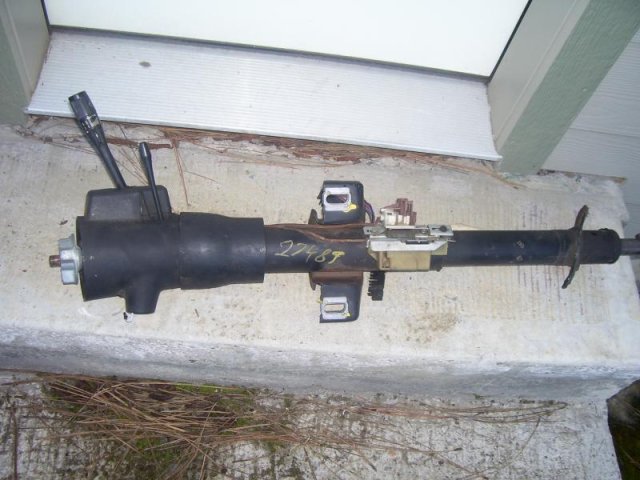

I scored a steering column for a decent price today out of a newer iroc.... Hoping it works I am a little nervous about the fact it had antitheft device at the key....... I ofcourse do not have the factory key so I will have to disable that if possible. I also got the project moving forward again with my set back of engine position. Once I move the radiator an inch forward I will have two inches between the mechanical clutch fan, with more at the fan blades to the radiator. I have lots of room around my firewall and distrubutor, and probably the most custom ya custom that's the word shifter on this site!! Ok honestly it is very very embarrasing but it works :rolleyes:

Well I wasted the night staring at the steering column with no worries of modifying the arrows but after test fitting I am going to have some issues with the electronics clearing the entire brake/clutch pedal assembly when I copy Rockcods theory and move the column back and up with new mounts. With this said I am planning to remove the electronics for now loosing the dimmer and turn signals and FOR ONCE rather coming with problems come with a solution. But first I need to get this thing on the road.... I thought about just putting the stock column in for now but the time I spent modifying the steering shaft to later redo it all I might as well put the gm column in minus the electronics. You can see the switches are ran by linkage so I could put them anywhere under the dash using some creativity.

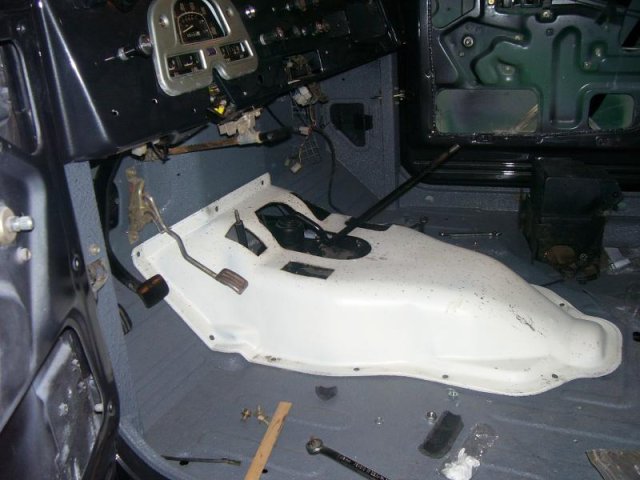

Well I am going to have to show it some time so here is a pic of my current shifter scenario......:rolleyes: It all clears the heater box fine now but it is sure going to be interesting getting shifter boots. I obviosly plan to sheet in the old openings and make the main shifter opening smaller.
As far as my crossmember problem I flipped the bushings on the advanced adapters crossmember and that lowered my transfercase perfectly. The only problem is I had to lift the back of the tub about a foot to give me enough clearance to wrap the tub with a welding blanket and fix the bumper...... Do you think I remembered to put the crossmember to mount bolts back in at that point OHH NO not me I like to do things two some times three times!! :grinpimp:

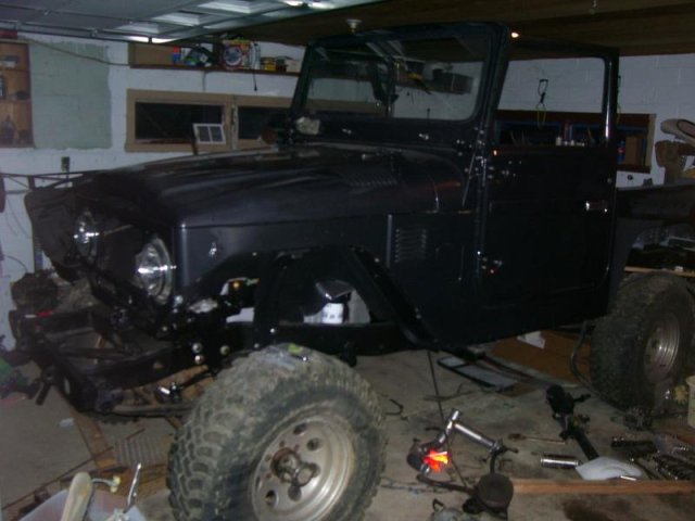

And last but not least I have been playing with the alignment of the fenders, tub, aprons, hood, etc. It was fairly simple to pull it off with one line that is :mad: however it took a lot of time to get them all close. (close being the key word) In order to get my hood to sit flush with the front grille I had to sacrifice a bit of hood sticking out on both sides (about an 1/8") :meh: What the heck am I talking about I dont have any fenders.......
I need to order the custom backspaced wheels but it is hard since I couldnt put them on even if i had them because it wouldnt make it out of the garage with the 37's it barely makes it in there with the 32's. Now that the weather is getting better it might be time to move it out into the new shop where I actually have room.:cheers:
EDIT - LOL What a mess!!! You dont realize what kind of a disaster you create untill you look back at your own picture........ I think I will get it out into the shop for sure tomorrow and maybe even clean the garage!!! The pics inside the garage look like crap anyway because you get so many reflections off of everything near by.

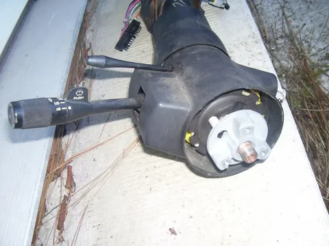

I decided to get off my butt for the cruisers sake and throw down on the steering collumn. I started off with the easy way which you will see in the first picture but it just didnt leave the collumn where I thought it should be. It was too far forward and too low.
The pictures that I took of the final scenario didnt save but a couple others did. I simply reused the factory firewall bracket that I removed from the factory collumn. (hogged the hole out of-course)
I had to screw with it for a long time tack it, put it back in to check, break the tacks, grind them off, and try it again over and over again until I was finally happy with the placement of the collumn in regards to the dash.
The only draw backs I have right now is that I need to remove the headlight dimmer sensor off the side of the collumn to make room for my brake pedal. Everything else cleared perfectly. The dang steering shaft that I got from the IROC is the perfect length!!! However the steering box end is too dang small to fit on the scout box.....
The pic makes it look all out of wack but it looks great in person. One could cut the dash up to get a better fit but then you are going to run into other issues with clearance. Atleast that is my opinion based off of my experience. Not saying it could not be done because I am sure it has but it will require more work and possibly having to remove the electric switch off of the top of the collumn plus at least in my case it would have been a fairly harsh angle at the collumn vs. the steering shaft.

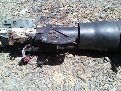

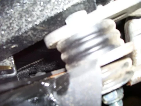

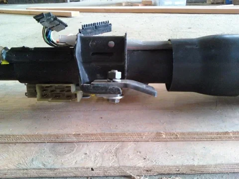

I was bummed because I thought I had lost my pics of the mods I had done to make the steering collumn fit. I found them and I thought I would go ahead and post. Not because I did a good job but more because I hadn't found a ton of info in regards to doing it and I hope this will help others. With that said I realize that every collumn is different when you take into consideration the model and year of the vehicle but this is how i went about it.

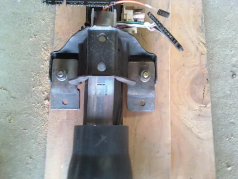

You can see the first picture I posted is where I tried to cheat and simply make a couple brackets spaced accordingly which would have allowed me to reuse the safety feature built into the mounts even though it wouldnt work that well because you weld it solid at the bottom of the collumn.
That method would have worked but the collumn was about an inch lower than I wanted it to set. I couldnt cheat and shim because the head of the bolt you see hit the factory FJ dash supports. It was made out of 2" by like 1/4 flat bar that was cut 3.5 inches long and I heated and bent a slight angle to better fit the factory dash mounting holes. This method allows for adjustment in and out due to the bolts but no up and down.
In the following pics I unbolted the home made brackets and simply trimmed the factory bracketry on the Iroc collumn to allow me to move the brackets down an inch. At that point I tacked them up to pre-fit. you have to be a lot more precise with this method to ensure your front dash holes are 5.25 inches apart prior to welding. Once I got it I burnt them down and torched off the excess upper factory collumn bracketry. I also bent a small piece of 1/2 by 3/16 flat bar and placed a few bends in it to reinforce from bracket to bracket.
My pics suck as usual but hopefully they will help someone someday. For the record this method did away with the safety feature that GM had placed in the collumn and I would be wearing the collumn as a necklace if I ever tried to whip its but in a wreck.... Just thought I should throw that out there so if you try it you are aware.
this pic is upside down
The splatter is actually spray bedliner that I wasnt patient enough to wait until it cooled down all the way and it made the bedliner bead up like that?????
I had to narrow the passenger side bracket to better clear the e-brake brackets. Look on the bright side it is under the dash so it wont be seen!! LOL
