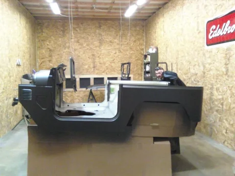

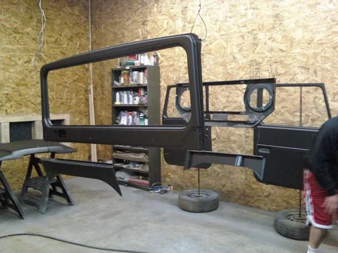

I havent posted for a while but I have still been putting a lot of time in on it! I just got home from working on it as usual and it is 11pm and i have to get up at 5am BUT we got the tub wet sanded and I finished the doors and hood this weekend so i am off to pick up the paint and clear tomorrow 420.00 more gone!!:bang: Oh well we are shooting it on Saturday and I plan to give it a few days to cure and then spray the inside of the tub with the gray durabak!! After that it is back on the frame!!!!! :clap:
Screw it I am tired of typing here are some pics :)
I am kinda disapointed at myself you can see in this last picture I have a small high spot on the driver side. It wont be very noticeable at all especially where it is but I just dont know how I missed it!! Oh well it is kinda like the first dent so i hopefully won't have to put one in there to get it over with!!

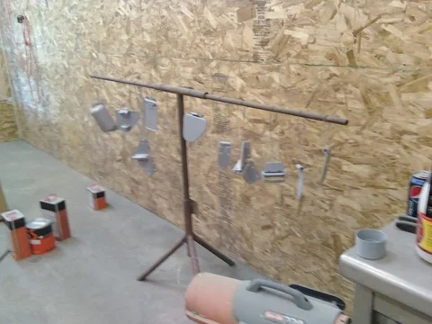

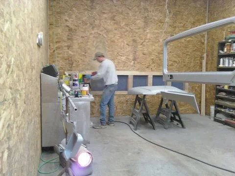

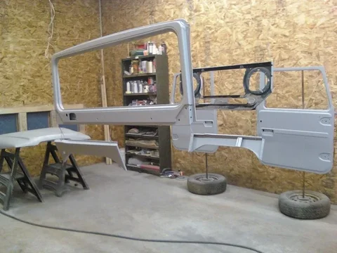

Man o man I dont know about this painting thing................ Just simply cleaning up, masking it off, hanging the parts, last minute scuffing, degreasing, sealing, painting, and clearing took from 9am to 9:30pm. :frown: Well that batch of parts are done at least! :) Here are some right before it was go time and just after they were sealed

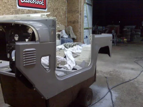

Here are a couple after the base coats were applied. They look brown in the picture but they looked dull dark dark dark grey standing there. At first I was like :hhmm: but then we had to do a little color sanding on the hood and when we sprayed the degreaser on it I was like :D
Here it is after clear! We ended up perfect up until the clear where we earned our selves a couple runs and sags so guess what i will be doing today........ :rolleyes: I will try and get some pictures in the sun with a real camera so that you can see the color because again it looks brown. :meh: It is actually a really really dark gray that has a lot of real fine metalic in it so it looks smokey. When the sun hits it you see a red pearl. I know that is so not a factory color nor is metalic but I like it :D

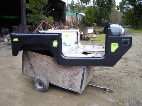

Here are some pictures of the gray durabak in the tub. One gallon is not enough if you spray it! I got the cover for the gas tank but ran out and have a couple light spots plus the tunnel still to do. In the sputz gun i used you had to open it up a bit so it was hard to apply thin coats but if you necked it down it would clog.

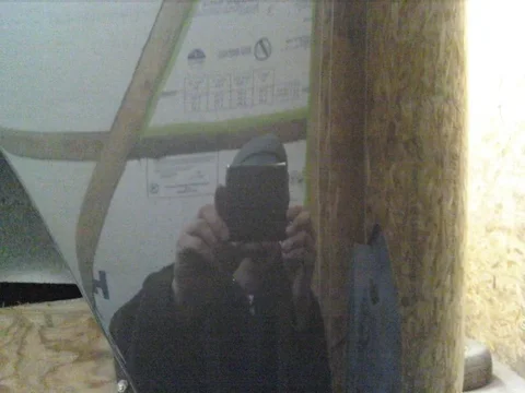

We overlapped all the edges by about a half inch (first body line) with undercoating so that if i scratch or wear it off in the future i can touch it up. Since the pictures suck so bad i took the one above to show my reflection and how undistorted it is. I am very very very pleased with everything so far and am getting more excited by the day.

LOL!! It honestly would take a while! I have been basically one to two FULL days on the weekend and about two to three after work days for about 3 months. I couldnt have done this kind of work on my own though I had a painter friend keeping me straight and wacking me every time I even thought about cutting a corner!!
