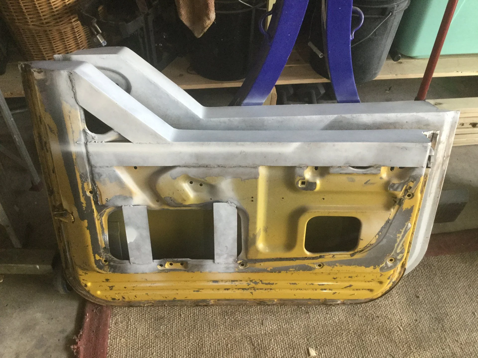

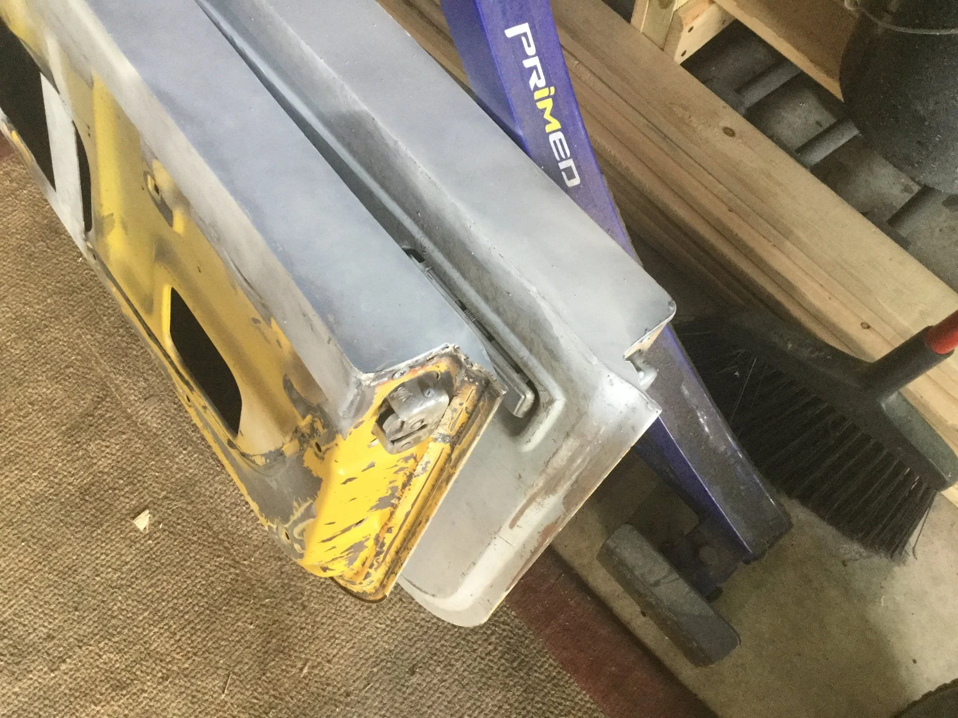

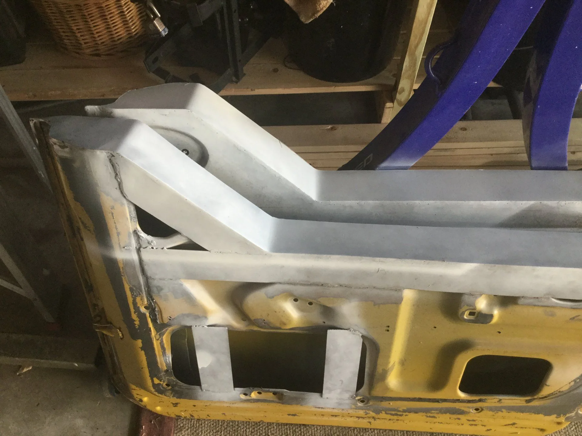

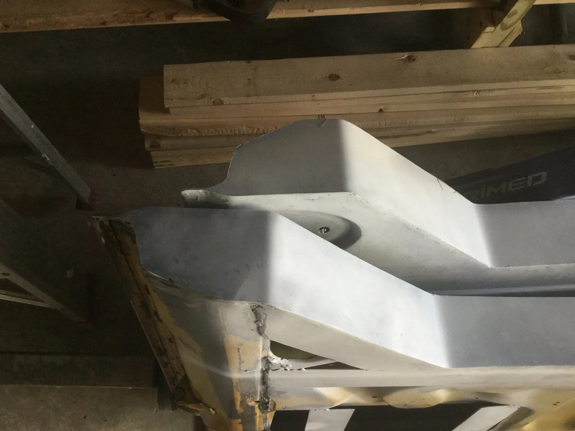

Finally had time to start welding the top strip on. 16gauge 3” wide strip.
Very hard welding. Especially for a rookie. Basically it’s tack, move over cpl inches, tack, repeat 1000 times. 😂

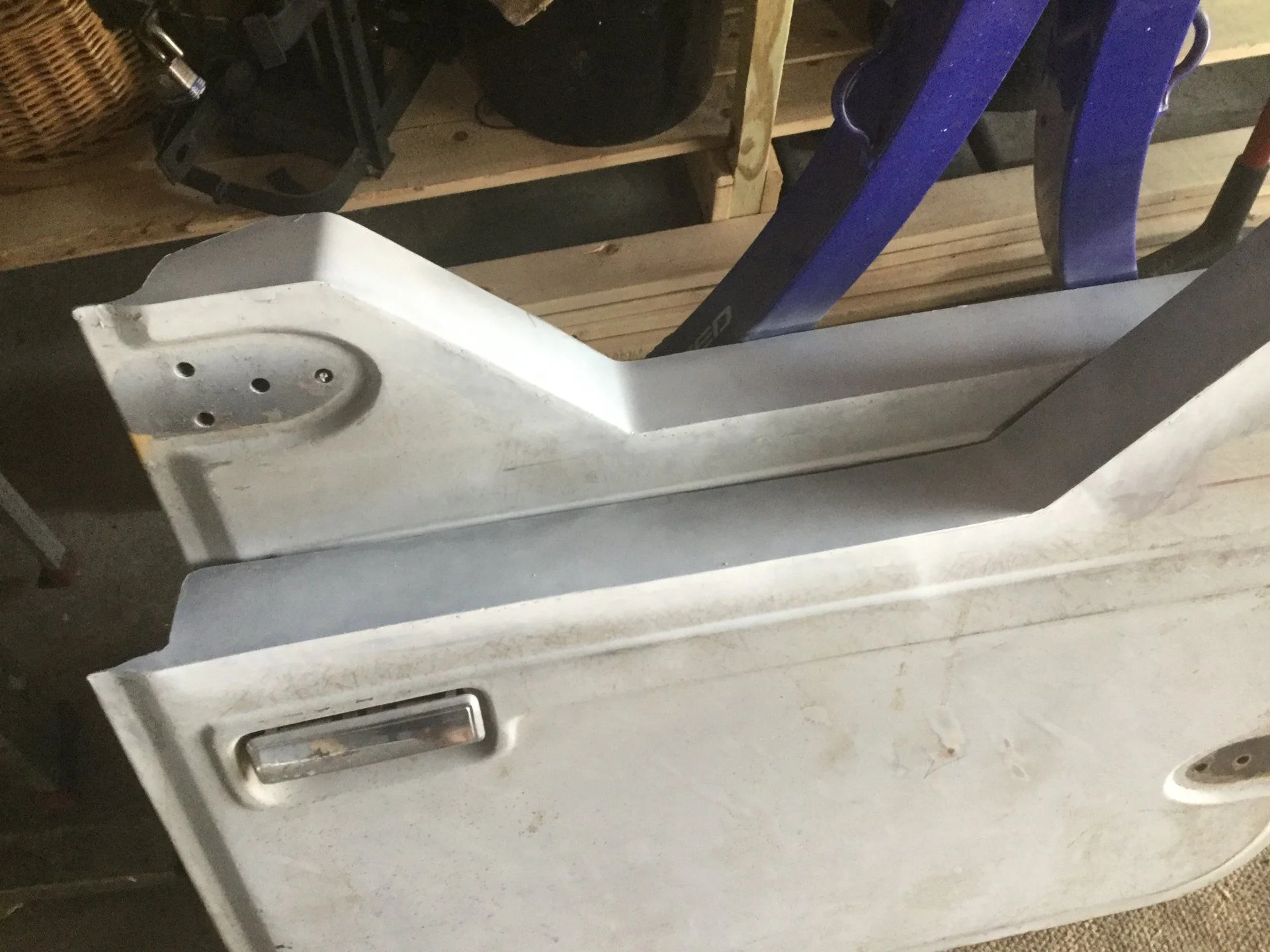

Well, finished the doors as far as building. Still have a few minor places to sand/smooth out. Shot some prime on it temporarily so no surface rust would set in.
Now it’s time to sandblast, prime and paint.
Really happy with the final results.
Also waiting on my vinyl samples to figure what I am going to do with panels.

Body work is a learning experience..usually painful for us novices! ;) The doors came our fantastic in my opinion,
who needs show quality in a Cruiser anyway??? You got it to play with right!! It will get scratched and dinged sooner
or later....
Cheers!
My $.02... if you're anything like me, you're going to notice the imperfections every time you look at your cruiser in the future. You want your cruiser to bring you joy, not a feeling of regret. And the rest of your truck is so nice. So my vote is to strip it down and do it over. Yes, it's work. but it's a learning experience, and you want to feel proud of your work.
Skimming through your thread, it doesn't look like you've had to do much body work so far (lucky you!!). but I apologize if I'm telling you something you already know: you'll want to use a "guide coat" to identify low points in your body filler. It's basically a "must" if you want a nice flat panel. You just dust the surface with a little black primer (or 3M makes a dry powder guide coat- which i like better personally), let it dry, and then sand the body filler in a criss-cross pattern using a long sanding board. The guide coat will remain in low spots, which means you either need to keep sanding, or you need to add more filler. That's really the only way to know whether you're ready for primer and paint.
Clear coat jobs are shiny, so they will reveal imperfections more than single stage. So you really need to get the panel right before moving on.
Good luck. Beautiful truck!!
Thanks for the paint/body work tip. This was my first try at body work. So yea, I’m striping it down. This was really a test for me and I wanted to do it on something small and easy to redo.
