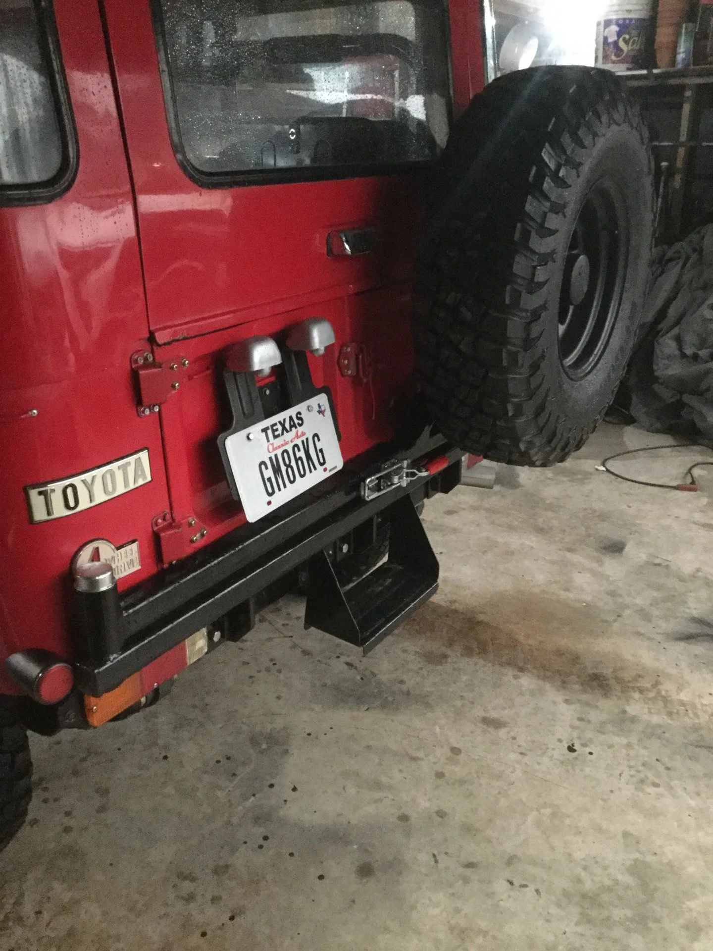

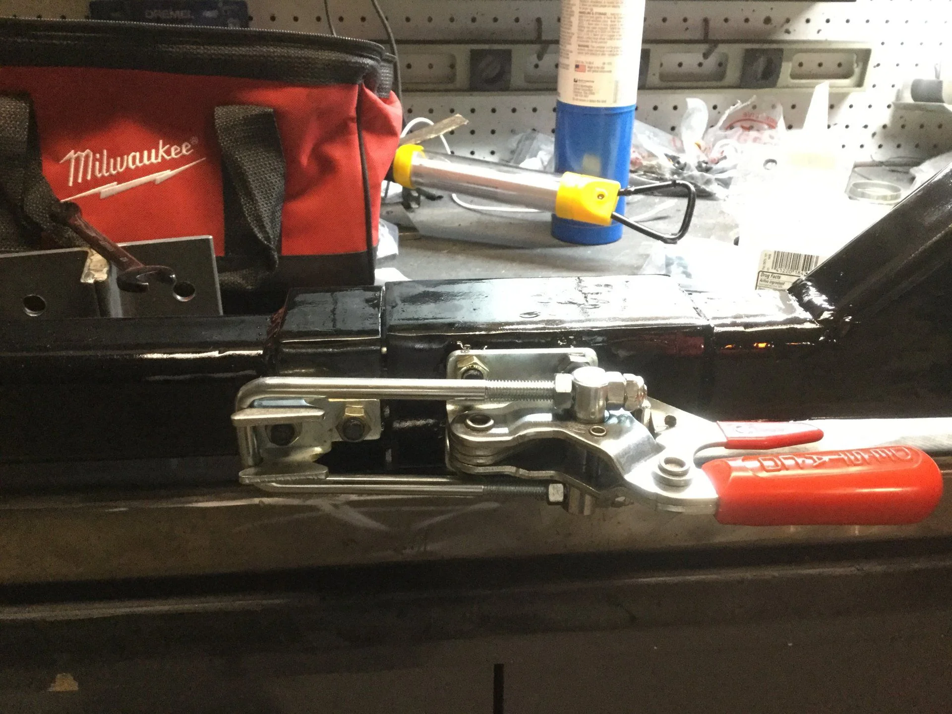

I think your latch, the red handle side, is facing the wrong direction. Need to flip it 180 so that when you close the handle, the pivot point of the red handle is against the bumper. And, I think the hook piece should be on the same plane as the face of the latch mechanism (face of the bumper).

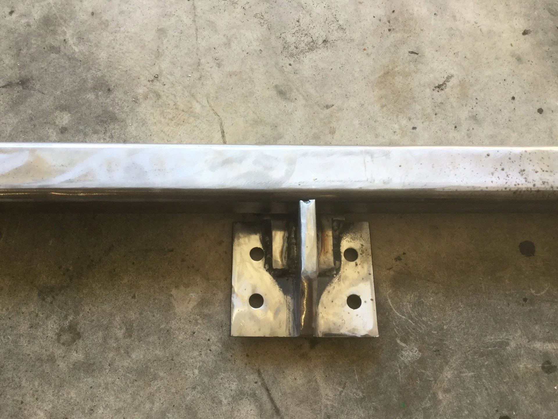

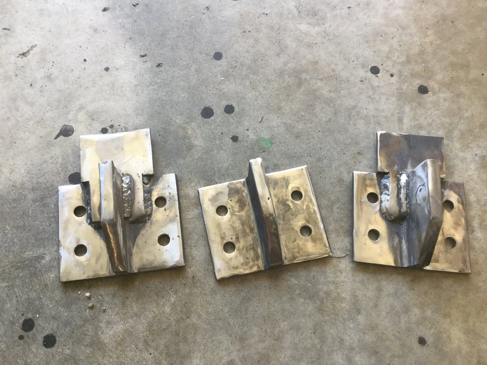

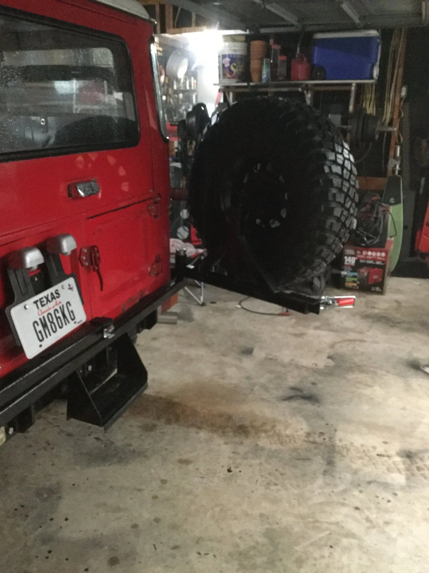

Got the top all buttoned up. Painted with SEM top coat. Tomorrow I will Mock up the brackets that bolt up to the rear frame cross member, tack them to the bottom and weld up. Paint the bottom and get it installed.
I will get a better pic tomorrow.. got dark on me.

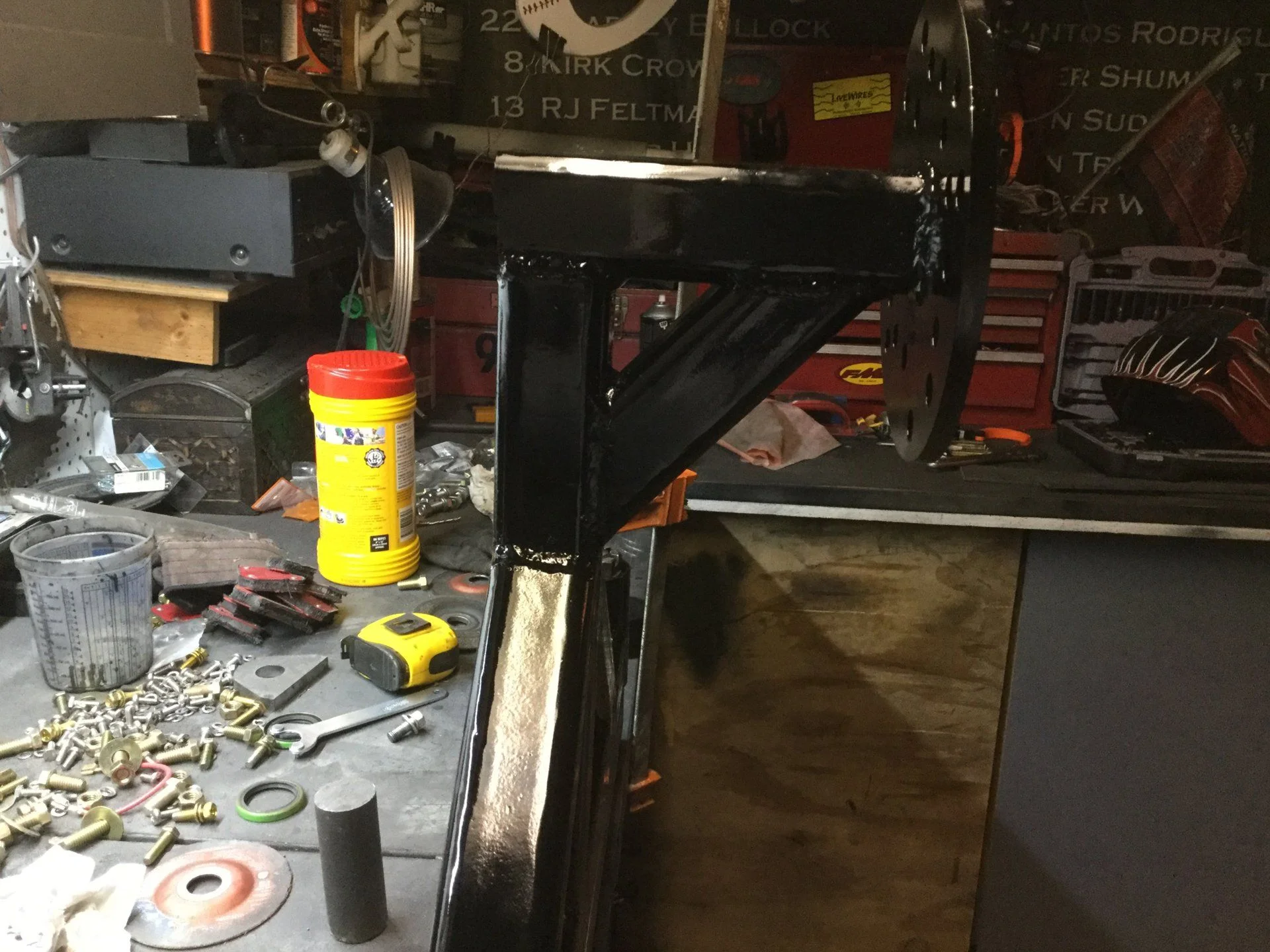

Got the brackets all welded up. Added the piece on the back to be able to weld the back of the bottom 2x2. Figured I would need that extra support. Looks pretty good after I sanded it down and got it painted.

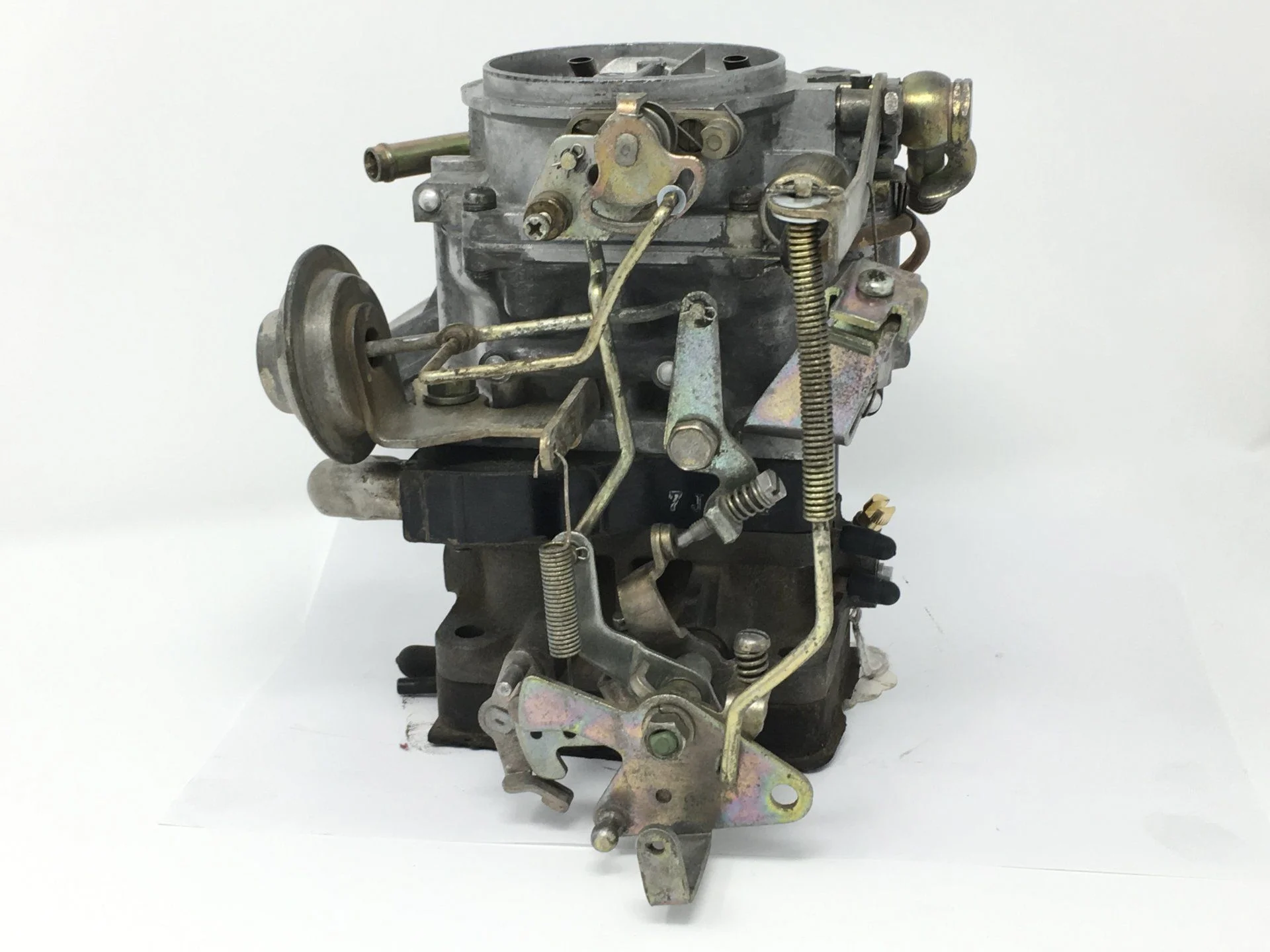

Your carburetor is done. Should ship Wednesday.

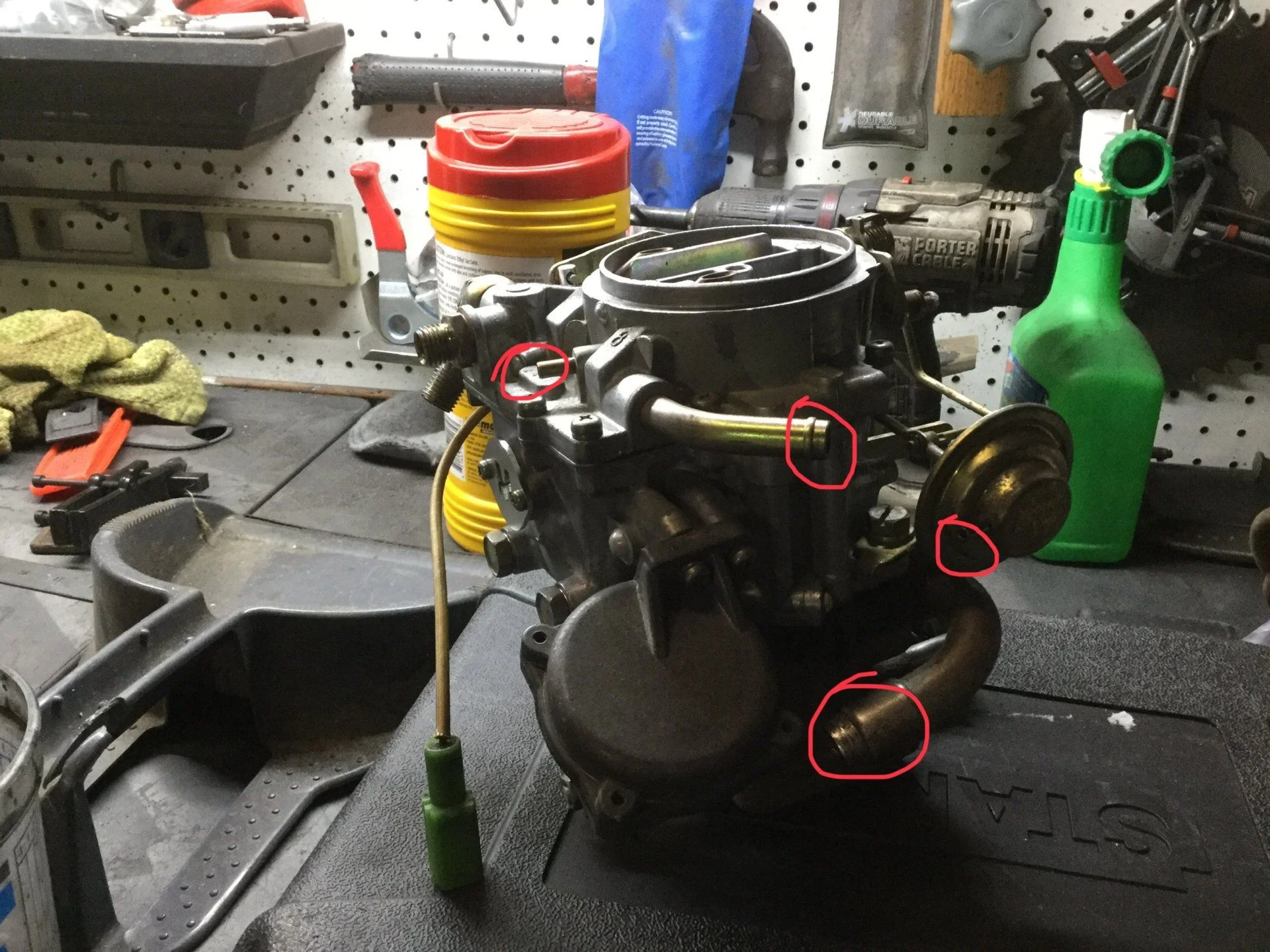

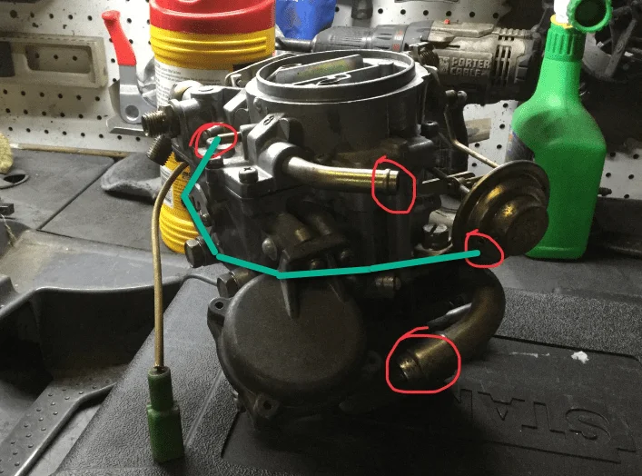

Can you tell me if I can plug these items in red, or connect to what? Currently I only have the one line from the distributor. Please advise. Thanks.
Also, the temp sending unit adapter didn’t make the trip.
Yes, they can all be plugged Tommy. The one above the fat tube [EGR] is the throttle positioner. It is marginally useful during start up. To use it, it needs to be plugged into a small vacuum fitting on the intake manifold so that it has vacuum the moment the engine starts to turn over. Otherwise, just back off the screw that would hold the throttle part way open during start up and it is effectively decommissioned.

I did see I a few pics a line running in this config. Or was that there way to plug it? lol
No worries on the Temp adapter.
Thanks for he help!

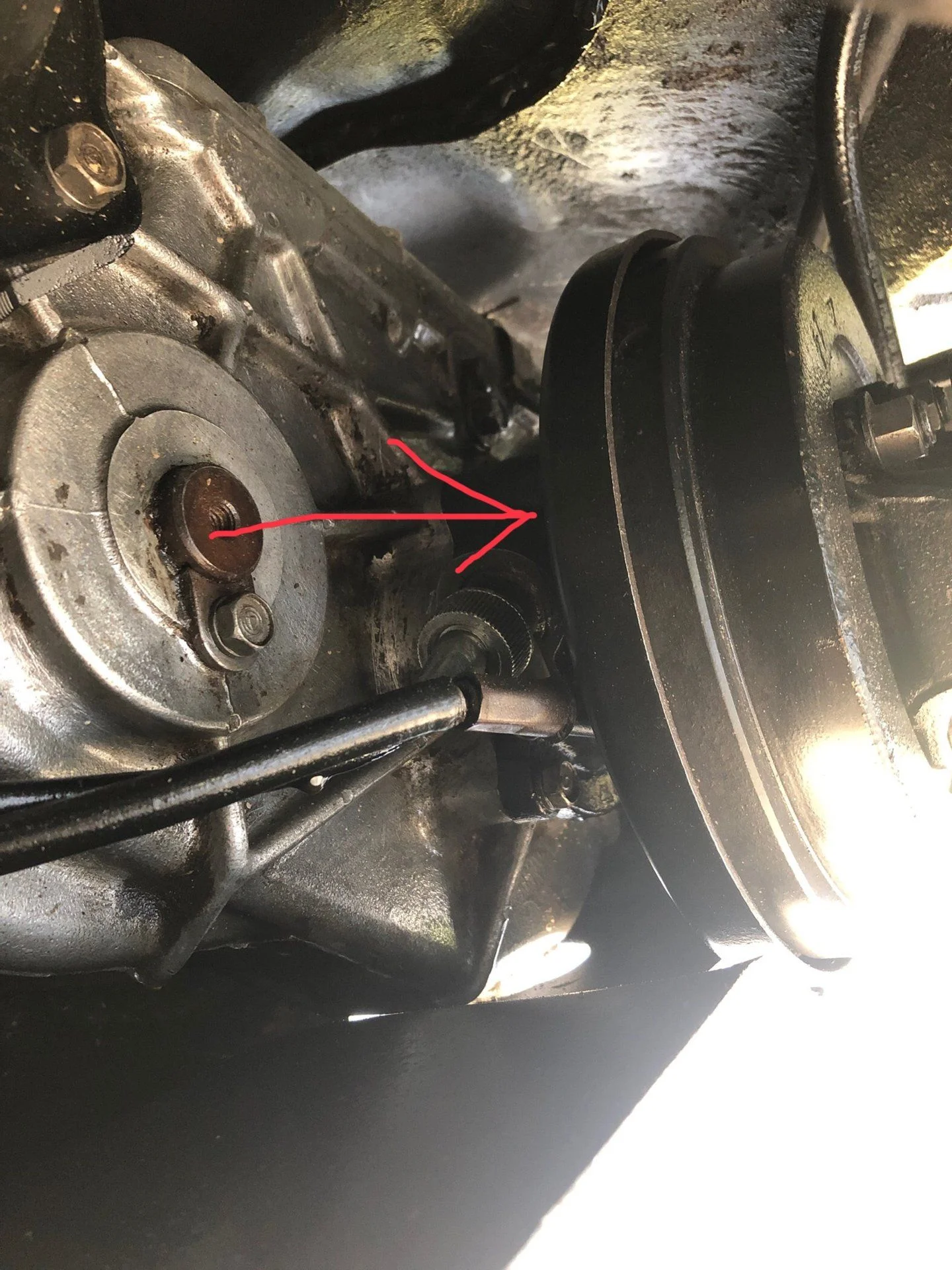

So I had a small leak of tranny fluid coming out of the bottom of the emergency brake.
I replaced the seal that is between it.
It is still leaking....🤪 any ideas?
Did you notice any grooves on the outside of the drum housing shaft that rides inside the seal? That's a pretty common problem, and from what I've researched (opinions vary) synthetic gear oil is more prone to leaking past that seal no matter how good the surfaces are. There are speedi-sleeves that you can find the part number for in older postings on here readily available at the local parts store if there's enough of a groove for a fingernail to feel. If not, you might try draining and switching to non-synthetic GL-4 first.
Edit: Also slather a little gear oil resistant permatex around the output shaft splines and washer before torquing the stake nut on.

Honestly I didn’t pay attention to the outside of it... damn.
I am using synthetic, so I will try that first! If that doesn’t work, well crap. Off with the assembly.
Thanks for the reply.
First, you need to try pushing up and pulling down in the driveshaft at the drum. If there is any play, no seal will last. The preload on the main output bearings is out of spec.
If there is no freeplay, you should still consider the dual seal upgrade. Plenty of threads on the subject. I’ve made it a standard procedure in all my rebuilds and services for the last 15 years. Not had one complaint.
