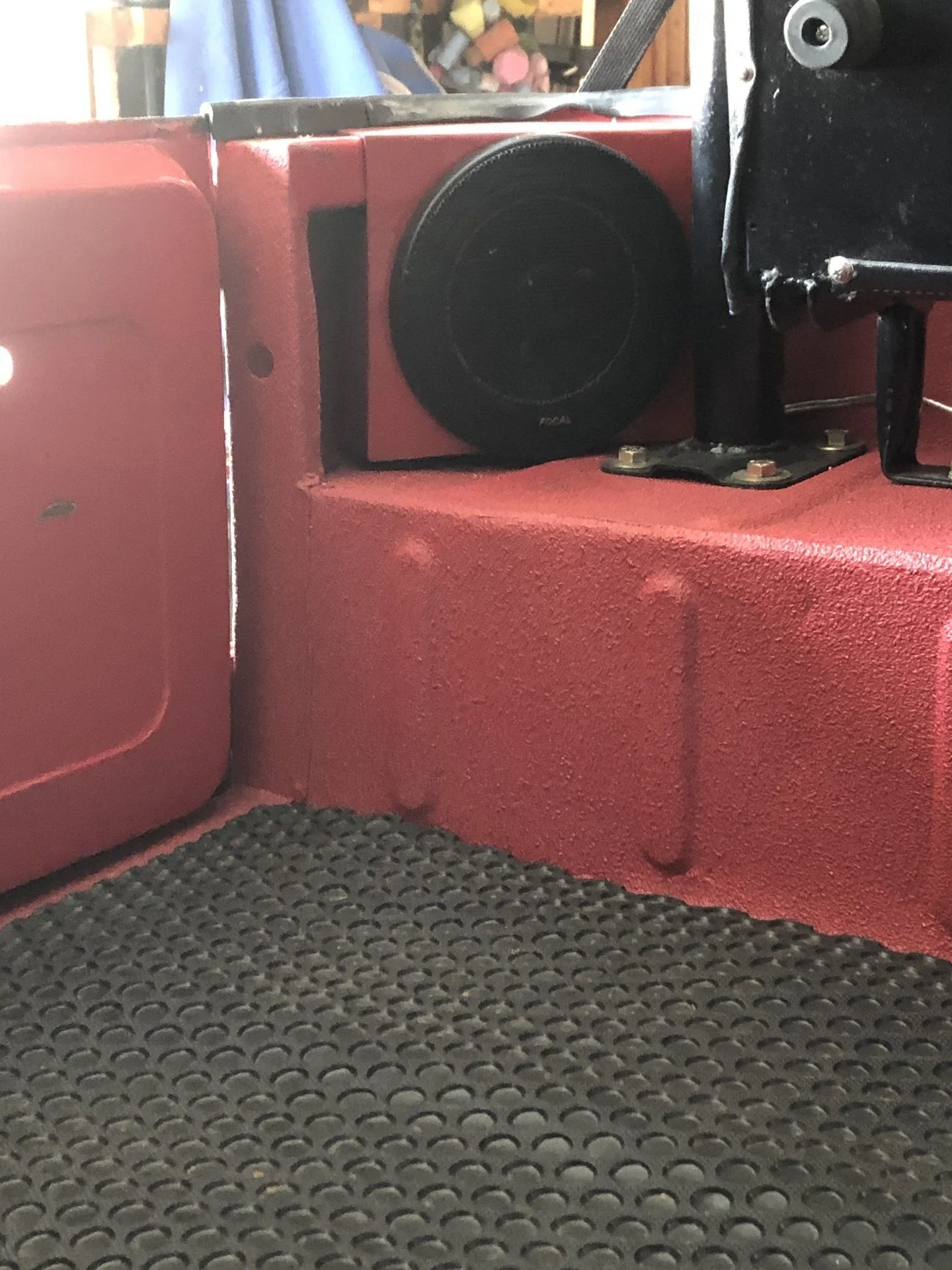

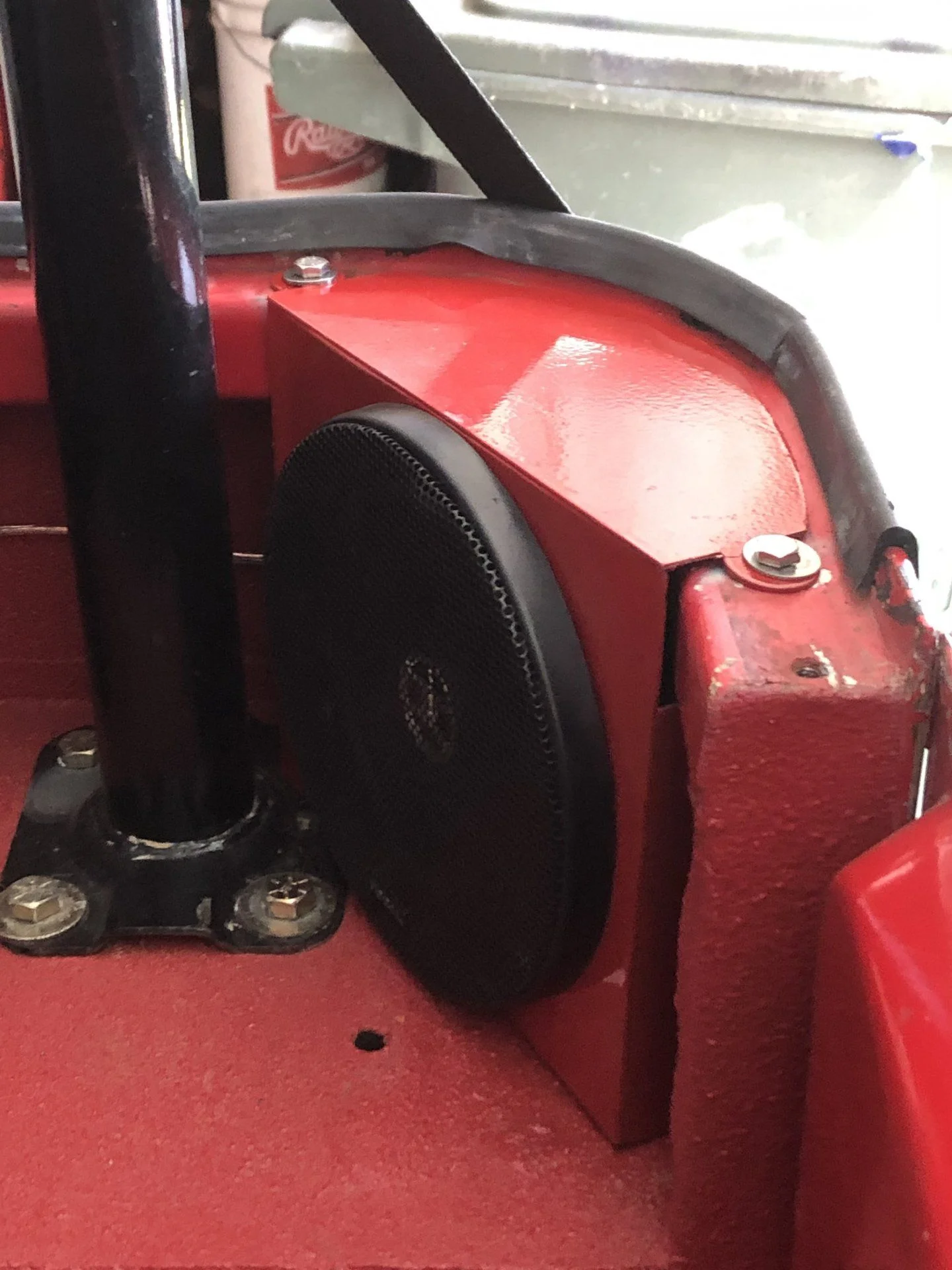

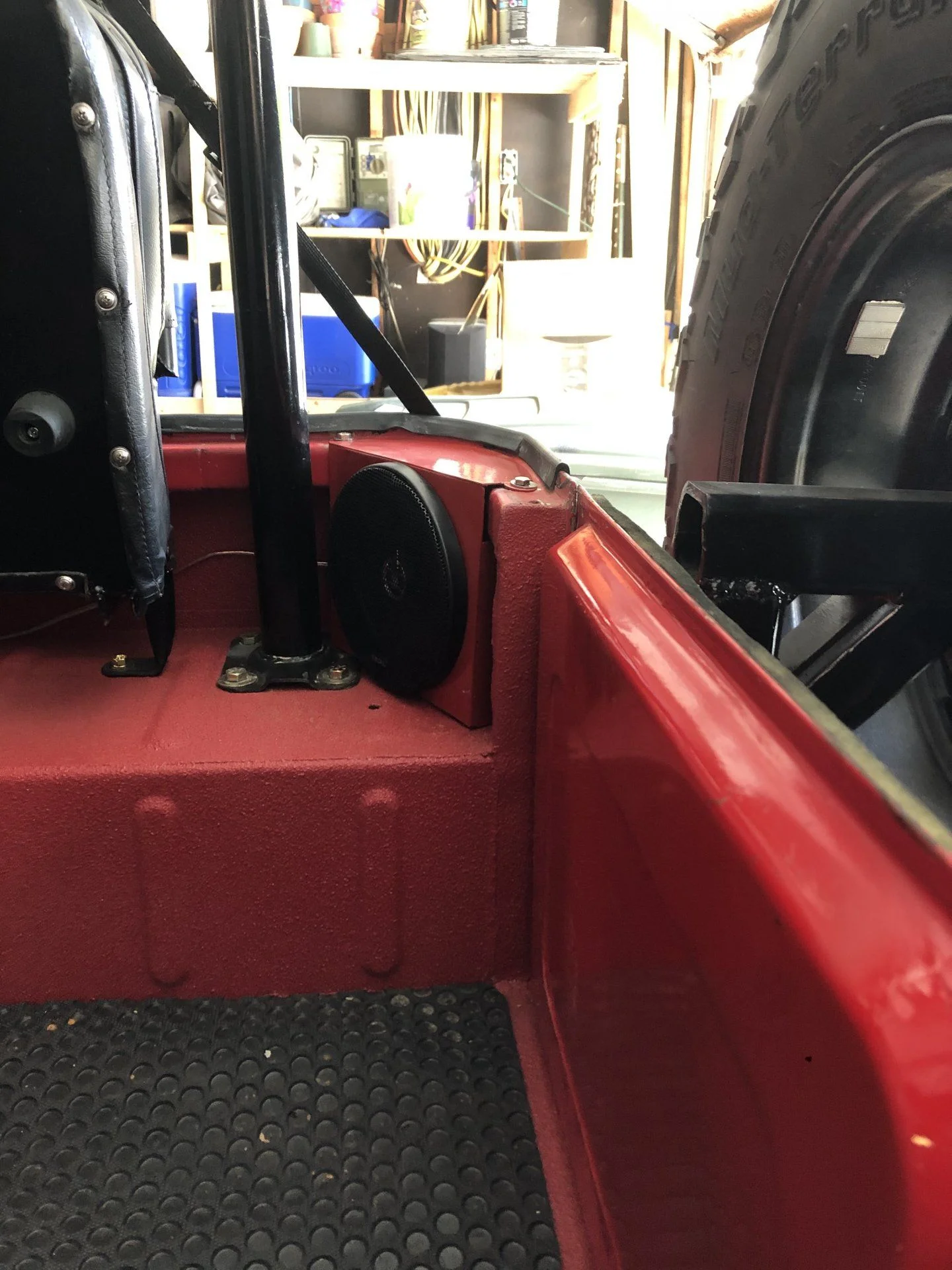

Installed the speakers over the weekend. The top is still of in this cold weather. LOL

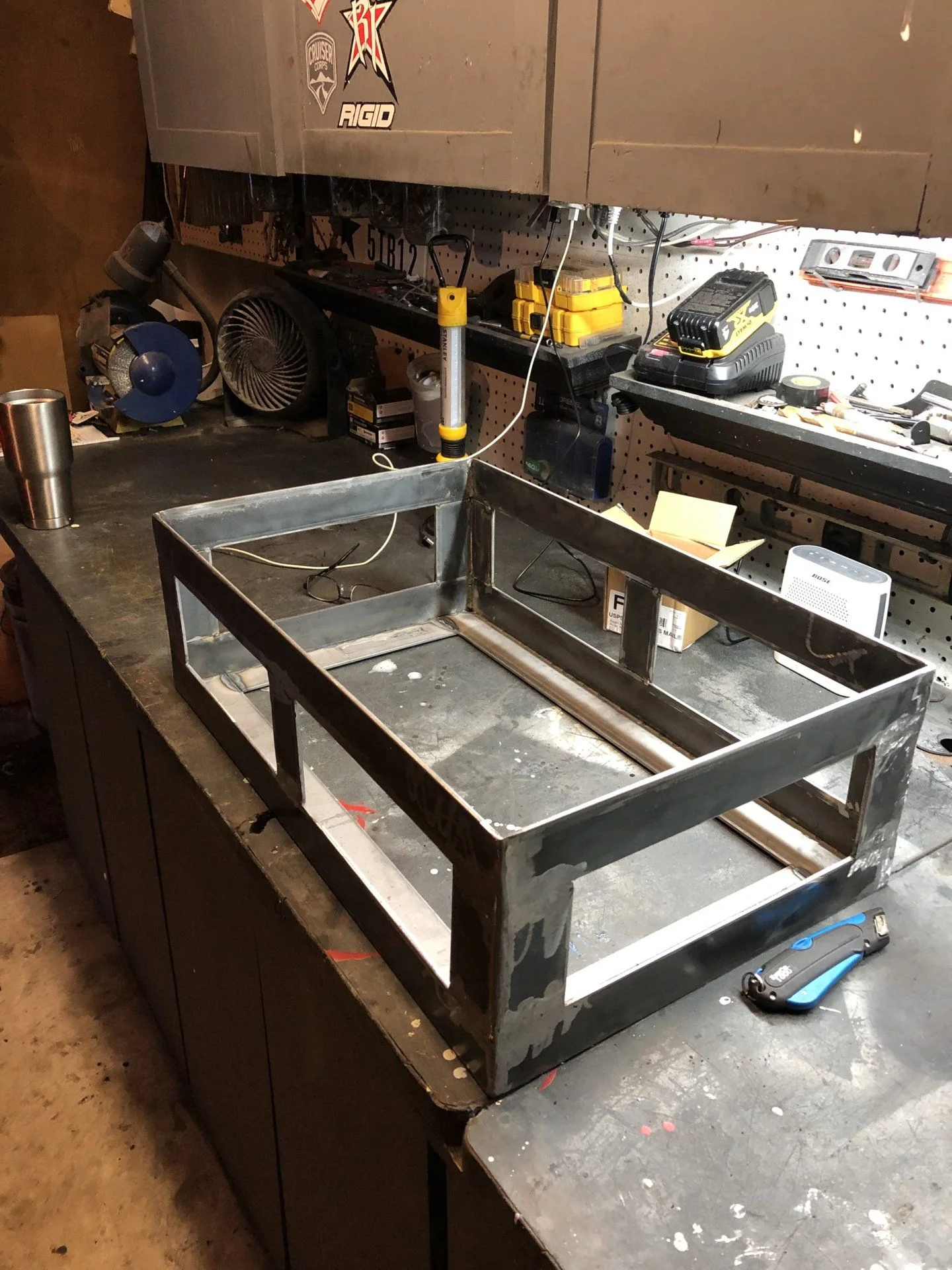

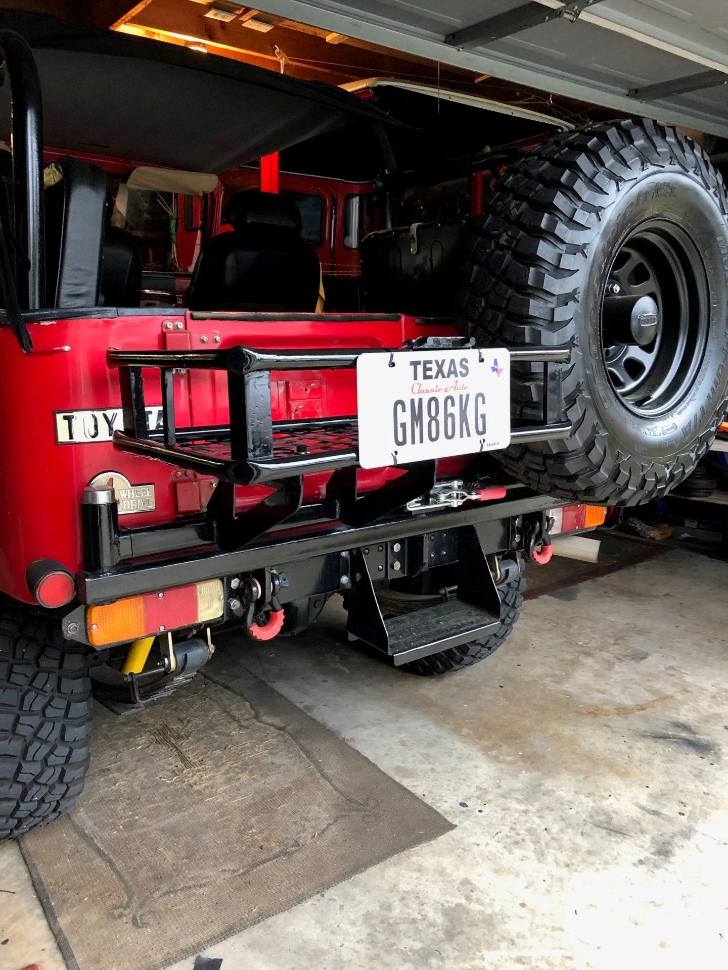

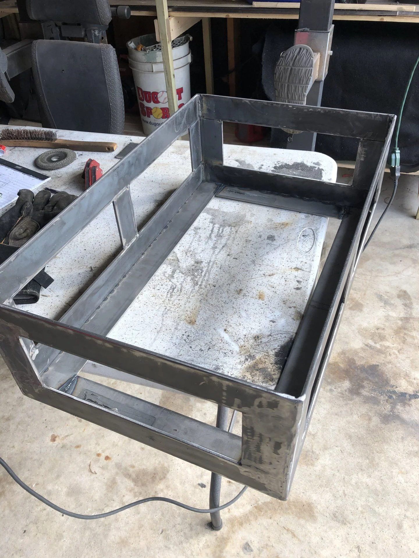

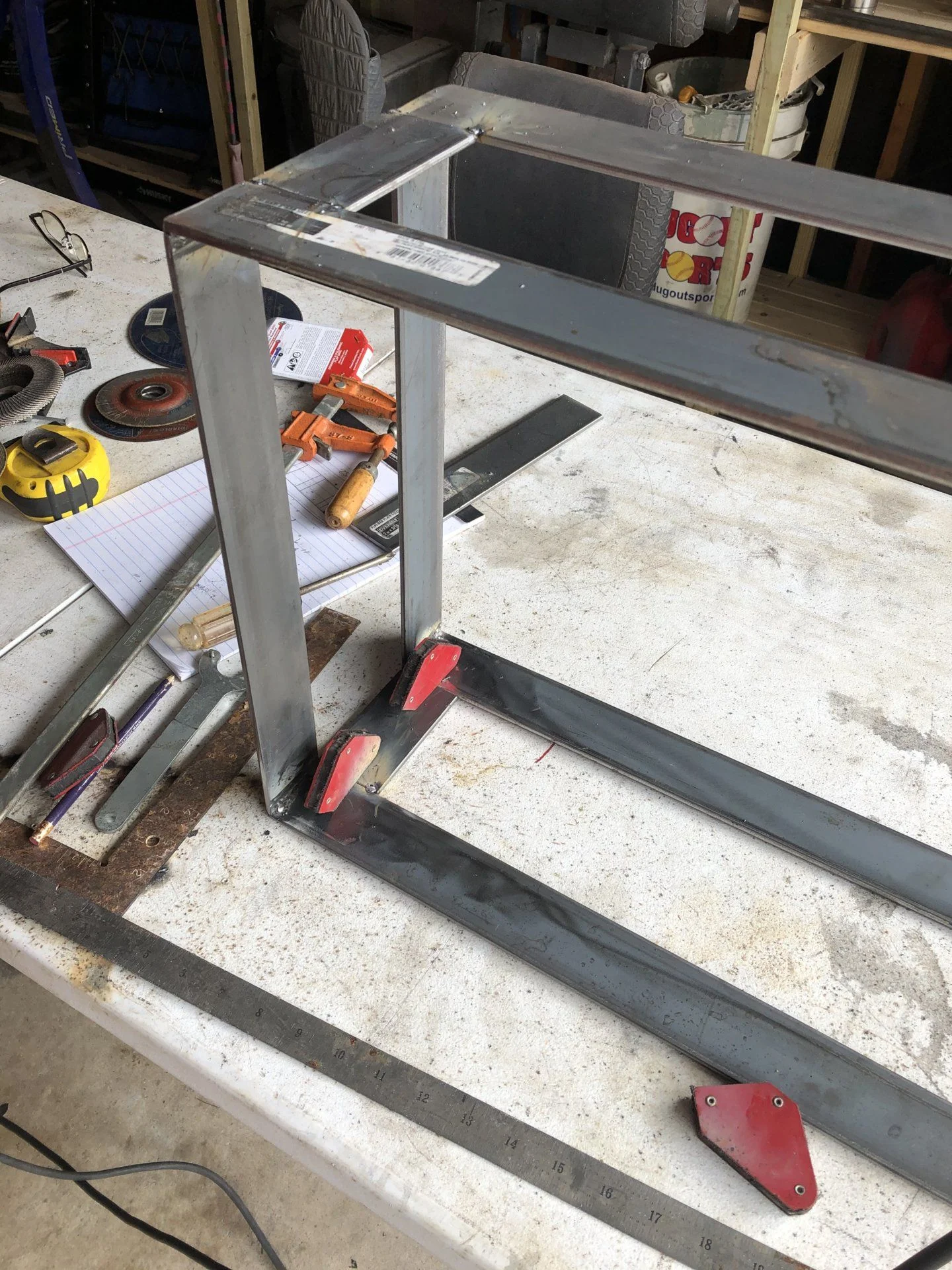

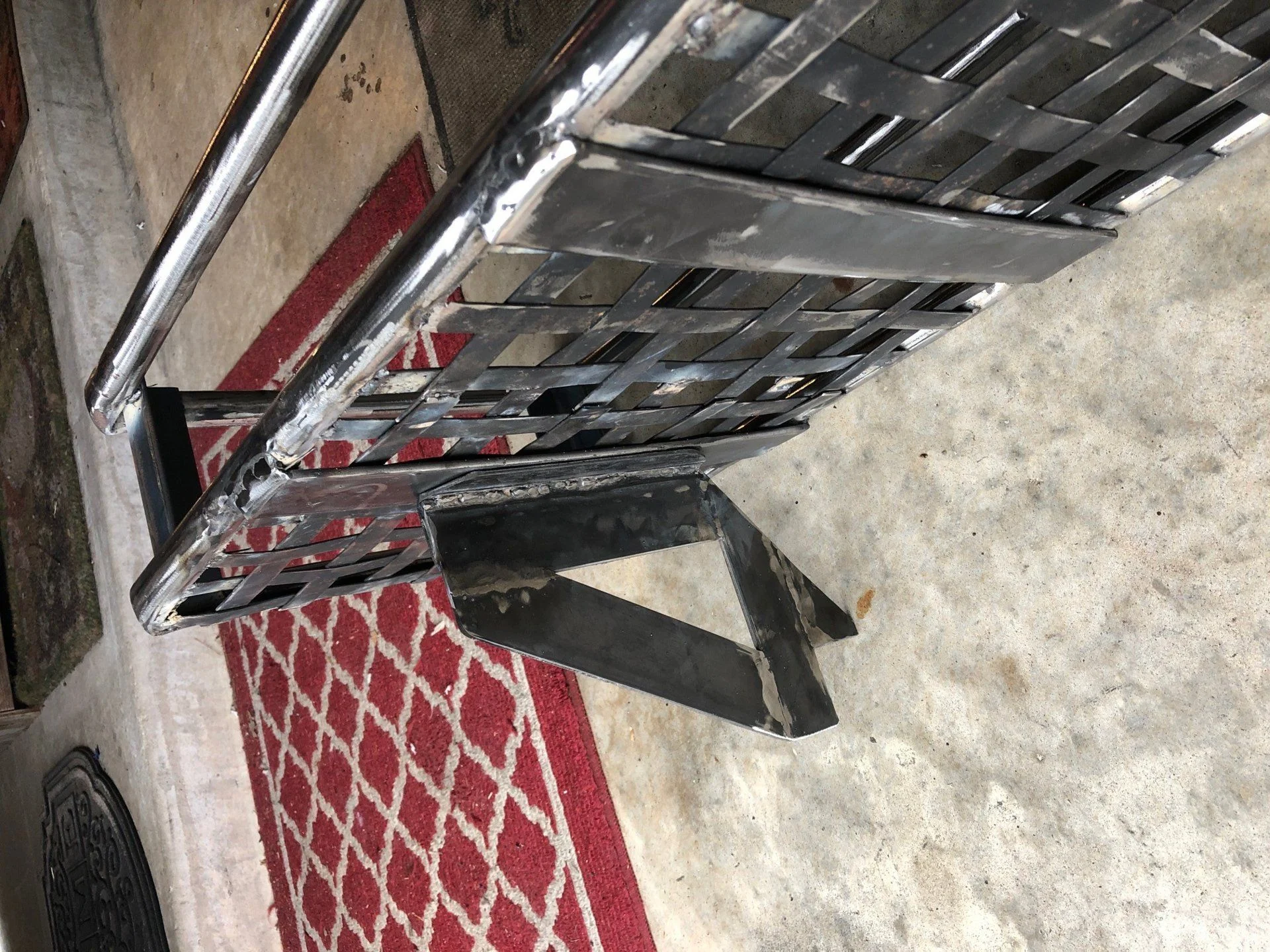

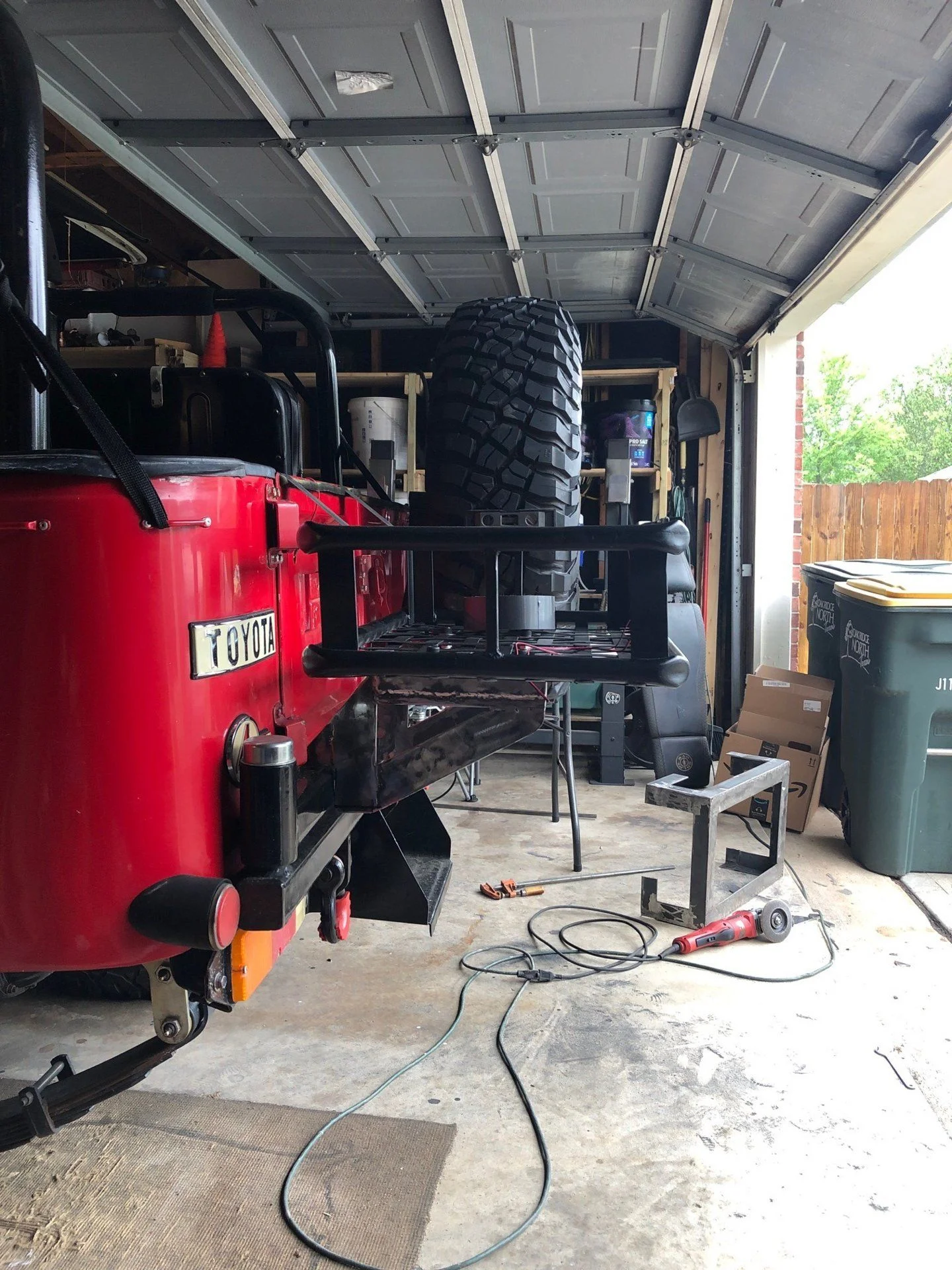

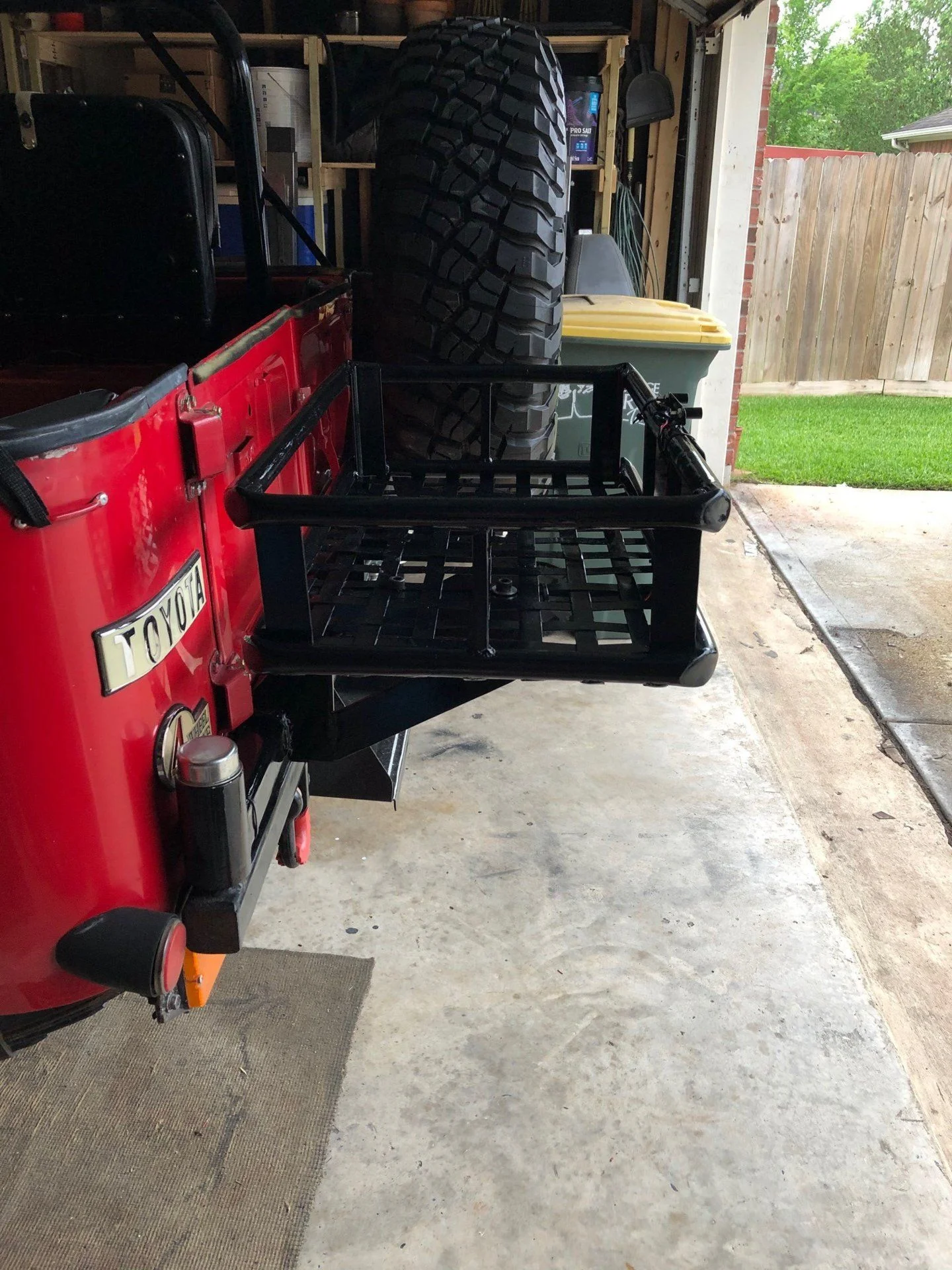

Finally got around to redoing my gas/cooler basket. I actually had some old bar stools I was trying to sell and cut them apart and used the steel tube and basket weave. I did my best at heating tube to bend, could have turned out better. oh well. Looks good enough I think. I also bought some small LED lights off amazon for the license plate. Now I need a cooler and 2 more gas cans. lol

I was bored so I built some speaker cases for the back. I think they turned out clean. When I install the top, the bolts are removed and top bolts go in.

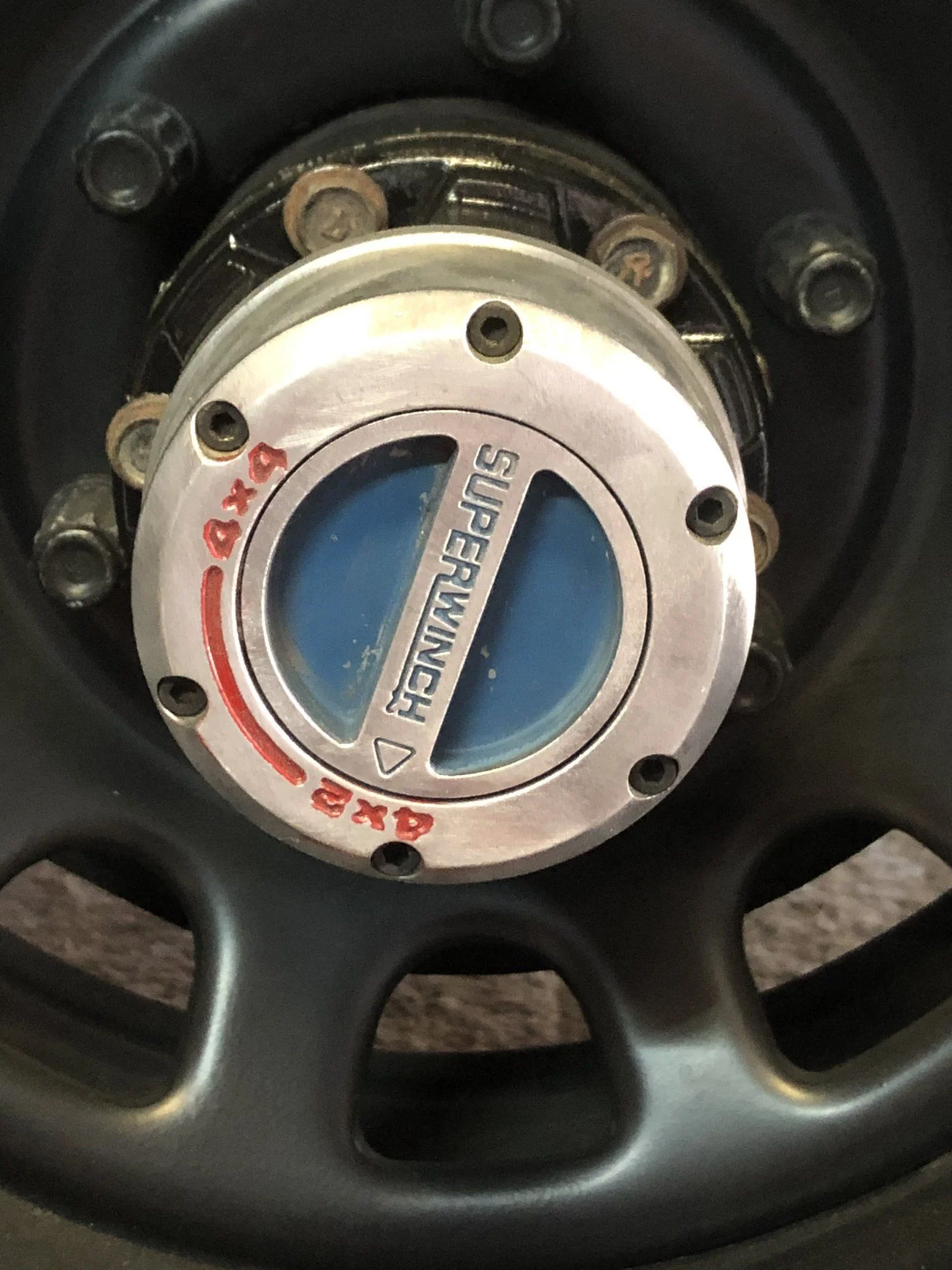

also rebuilt my hubs and painted them.
Nice detail on the hubs. People always appreciate attention to detail .

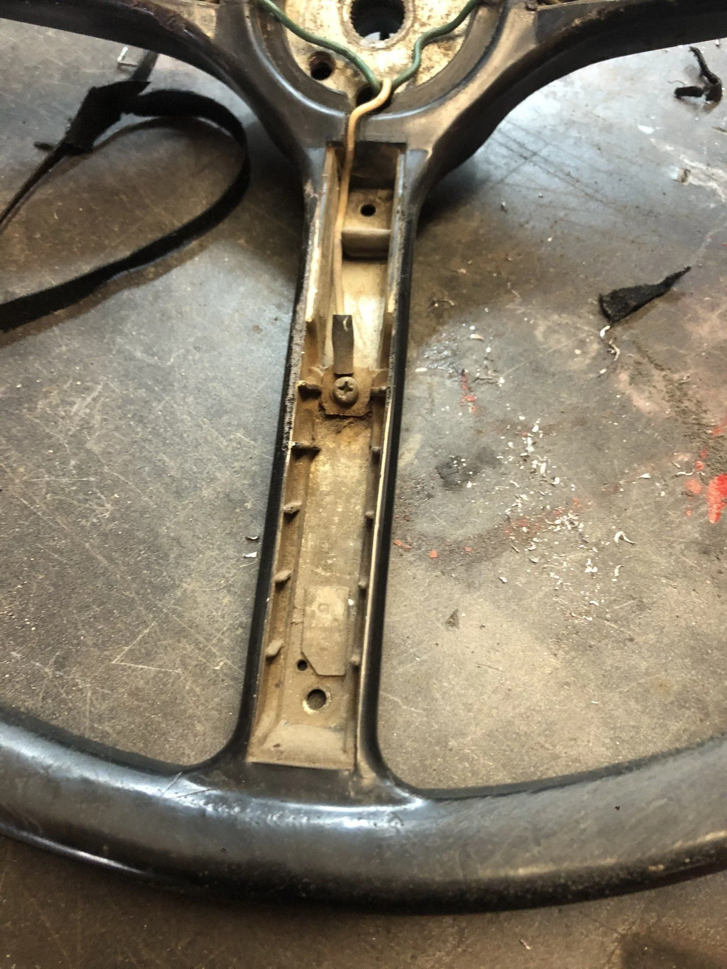

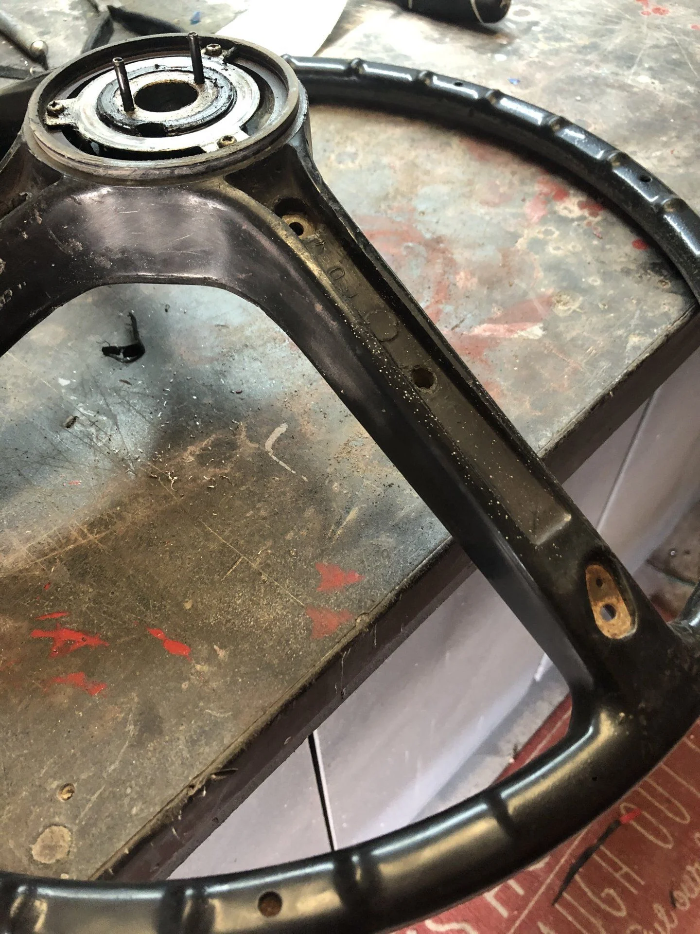

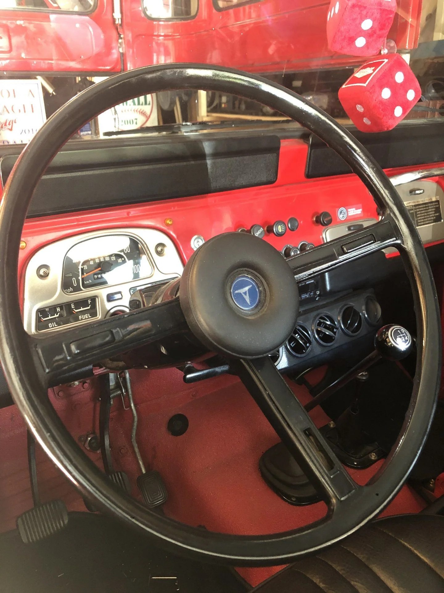

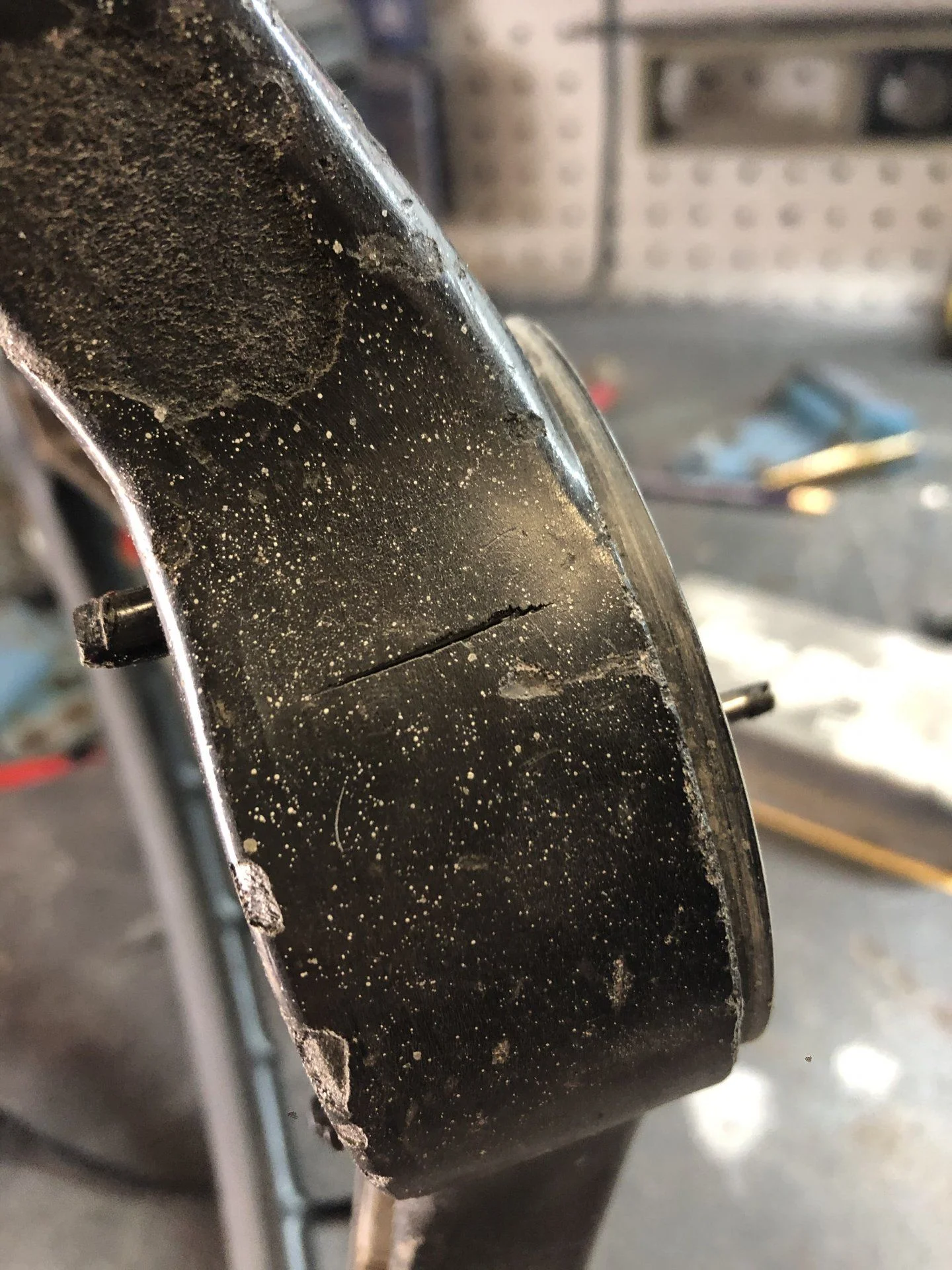

Pulled my steering wheel off tonight, needs to be shinned up. One small crack I need to fix.
sanding down and repaint. It was pretty rough. But glad no big cracks.
Those are nice looking welds. I like the look of the basket too, well done!

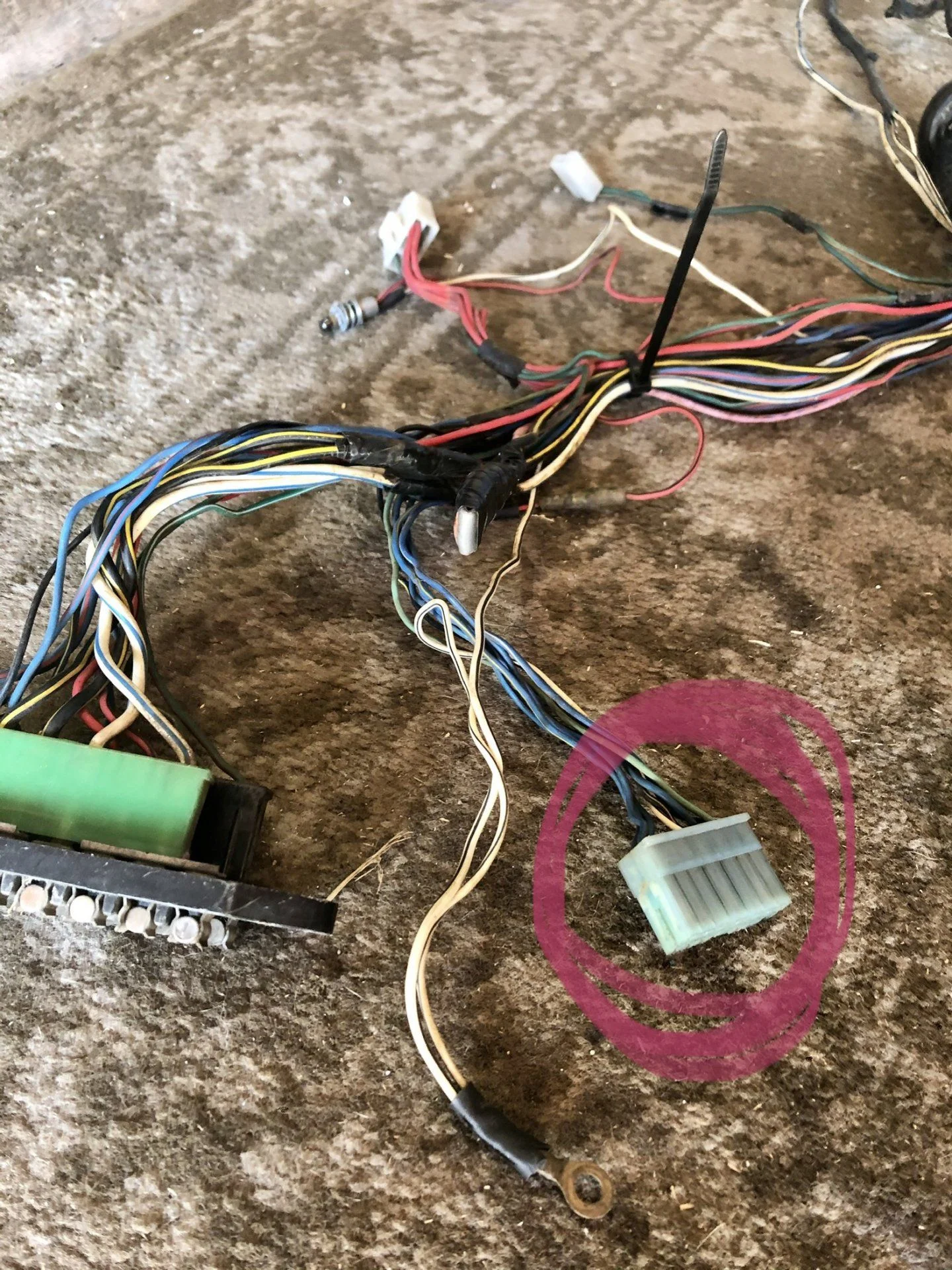

I have a solid 1978 wiring harness that I am rehabbing. There are a few items in the harness like the emissions computer connection.
Should I just leave it? Or can I remove it without having any issue? Any trick I need to know about? Or is it just a simple remove all wires that go to that connection?

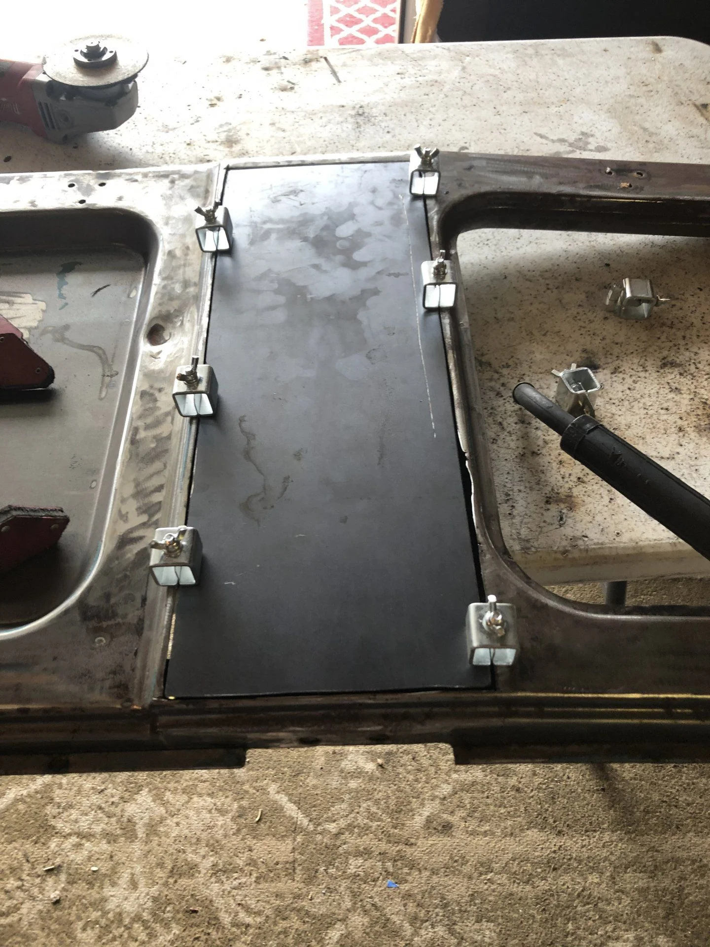

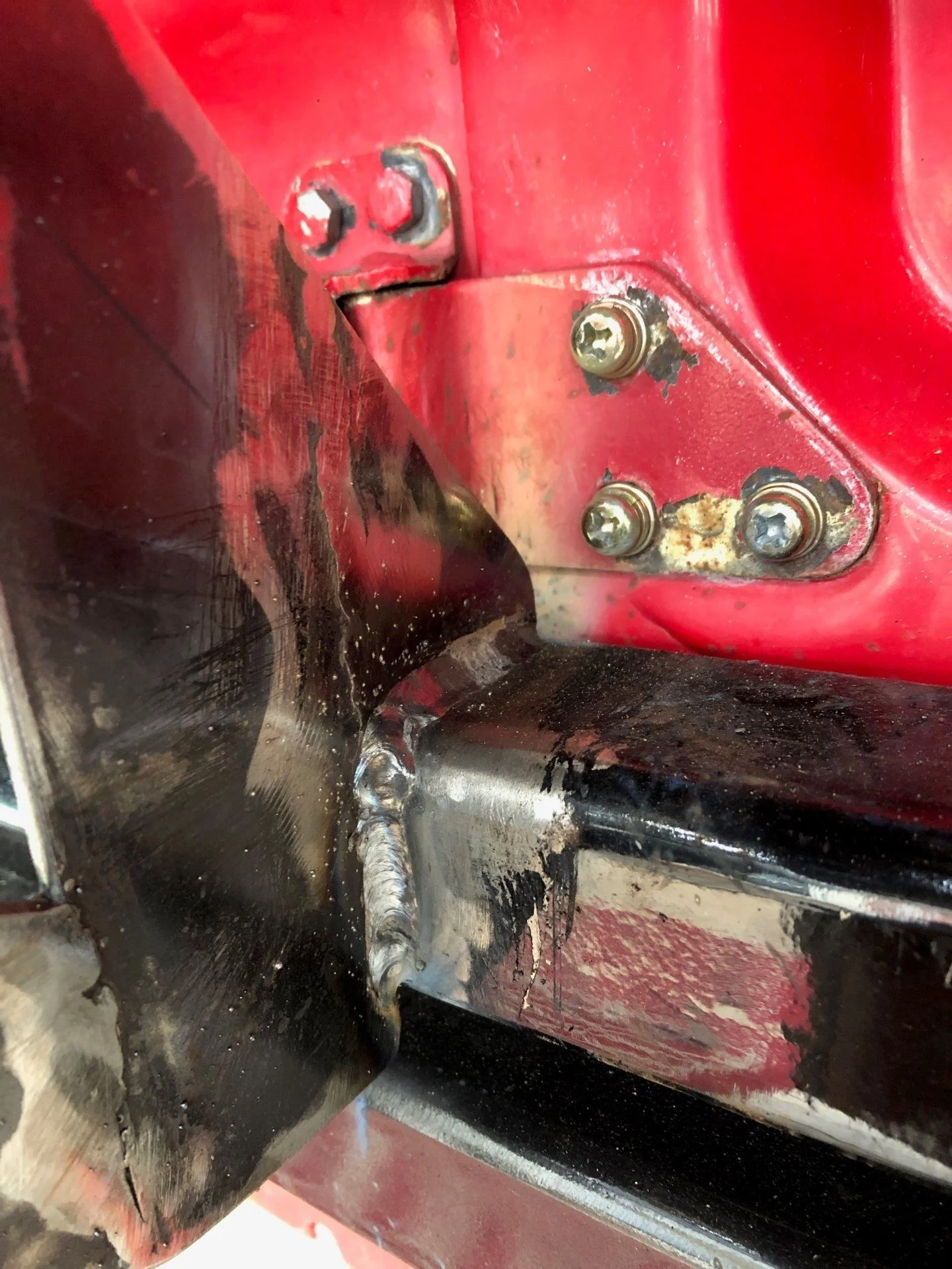

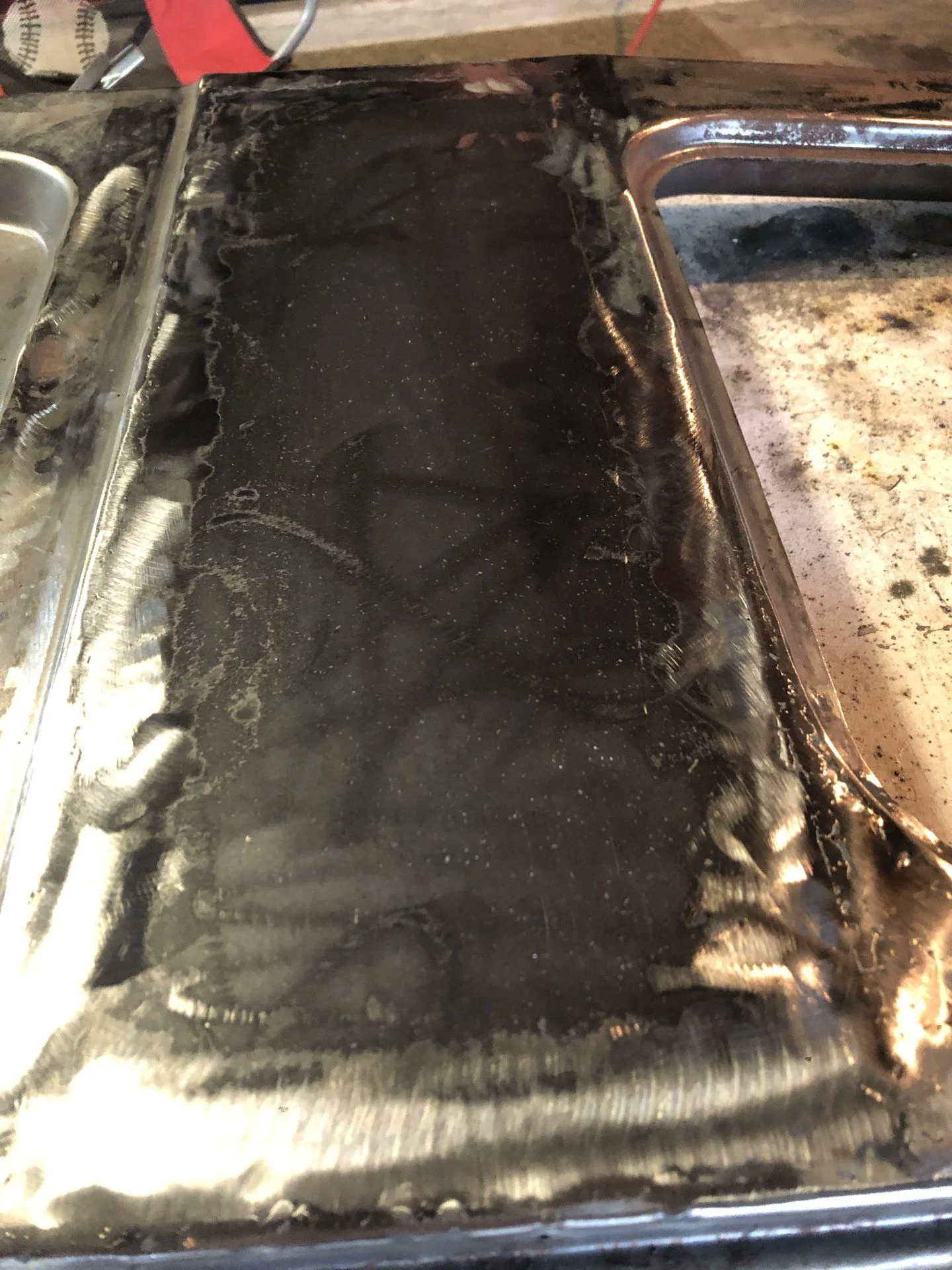

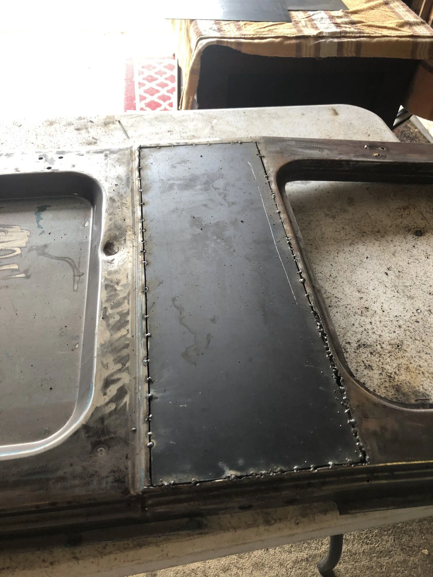

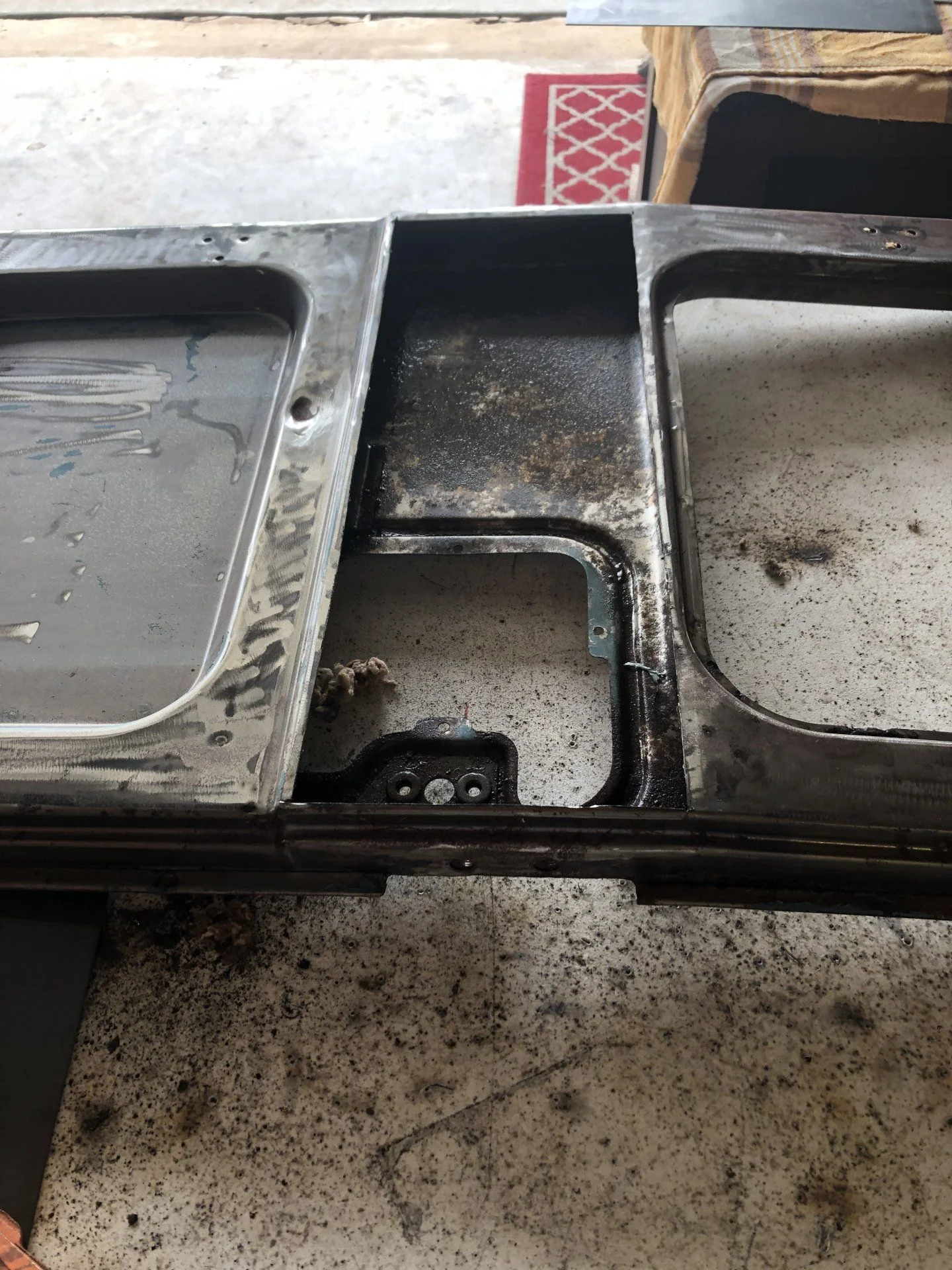

Started working on the Ambulance door, dang. So and stead wins the race. Take forever to spot weld.
Getting there. Few more small spots to fix, then it’s on the some more areas.

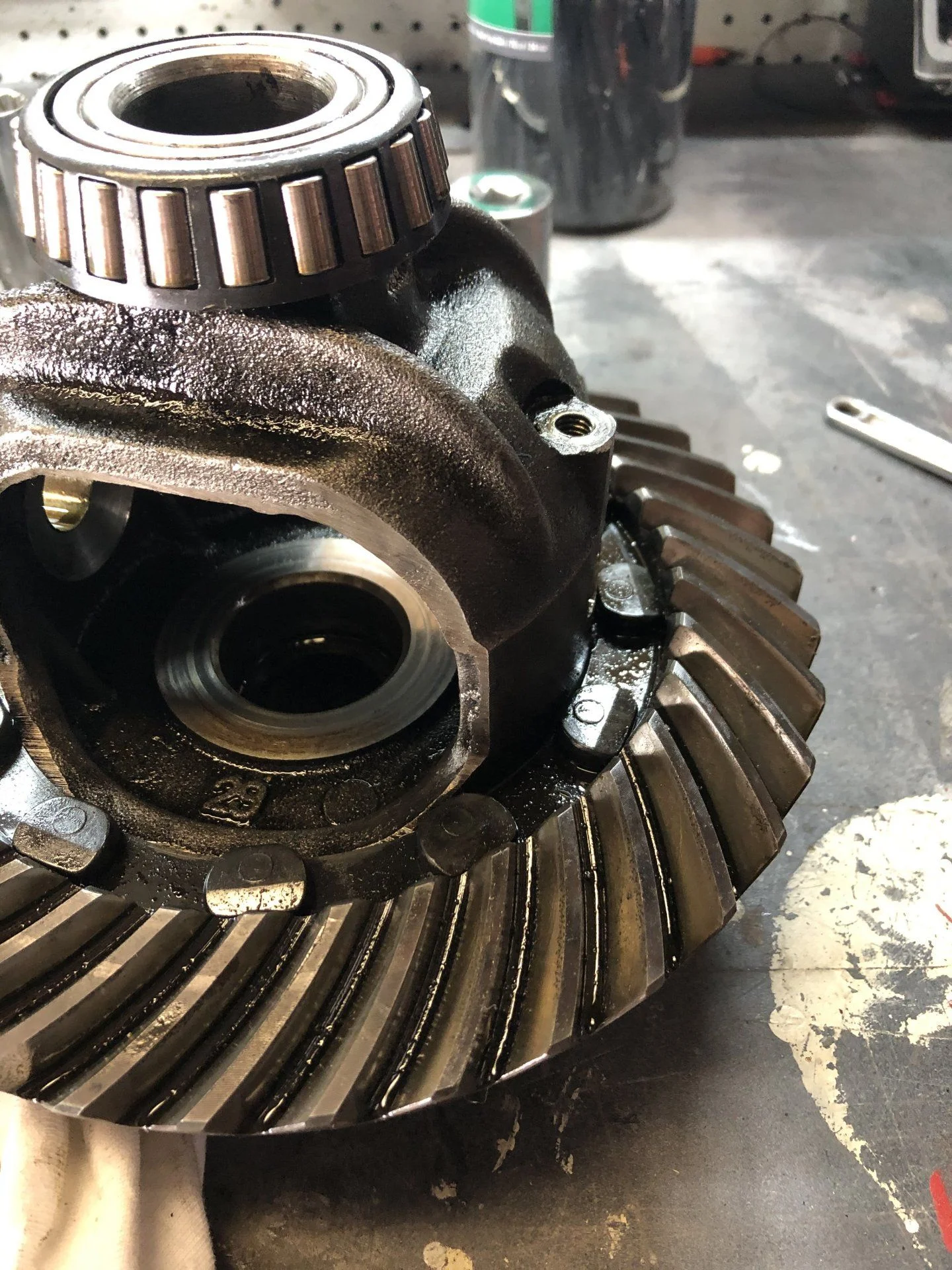

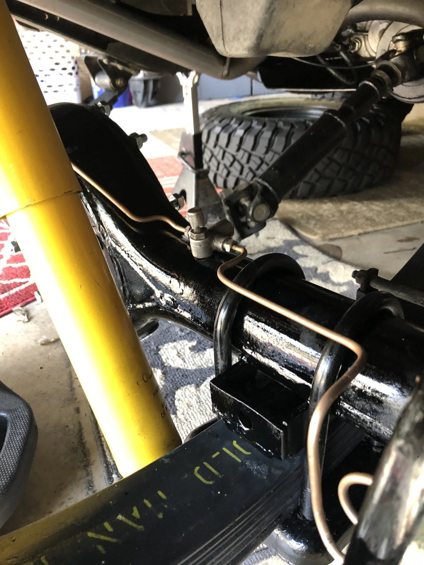

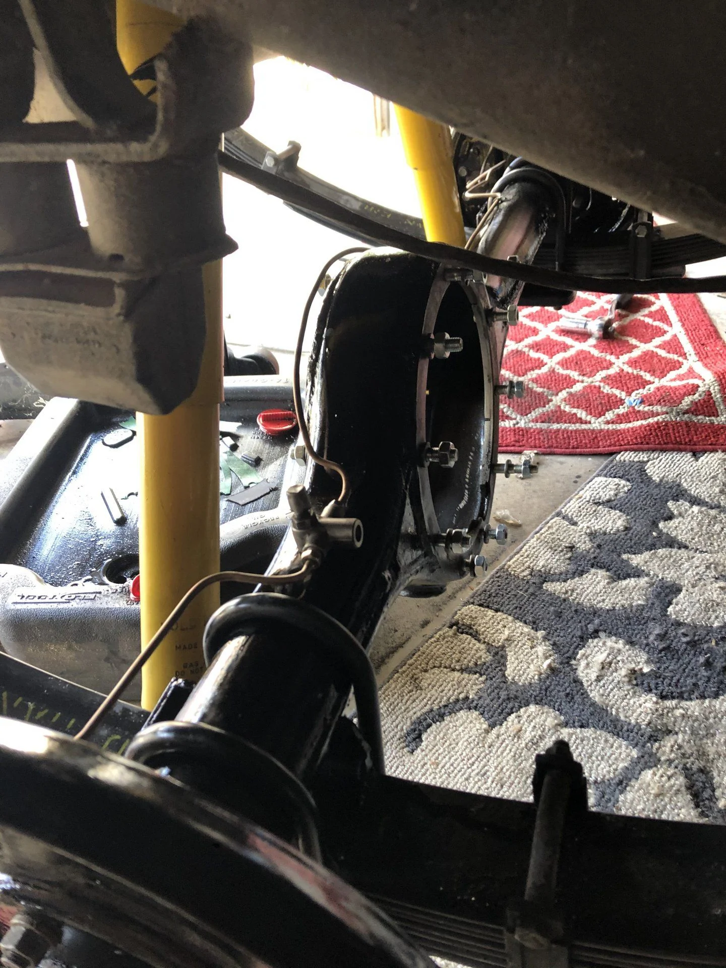

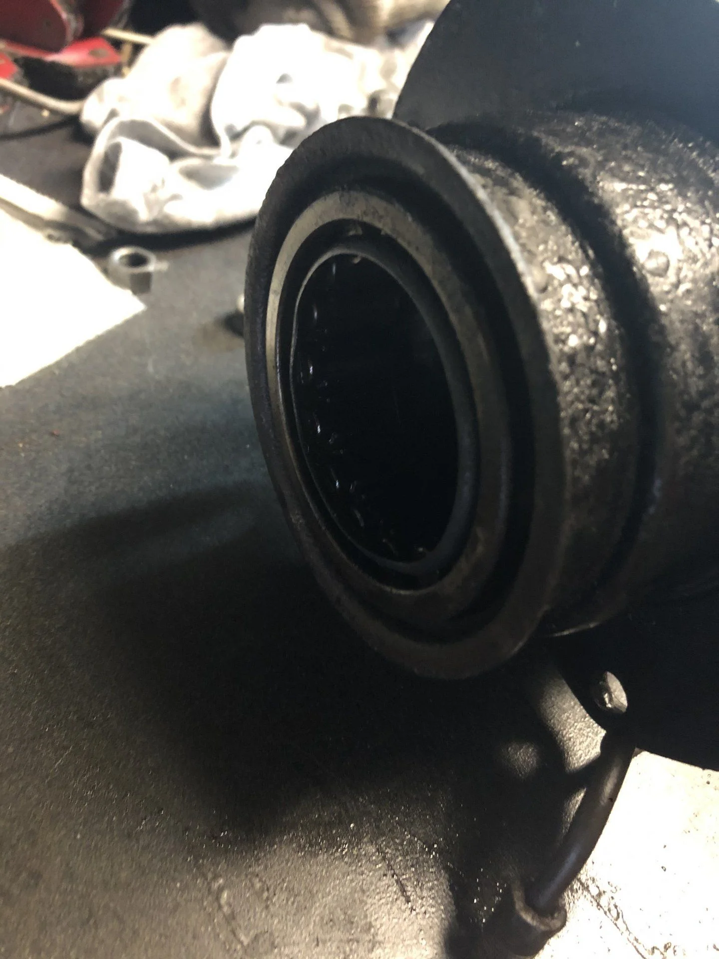

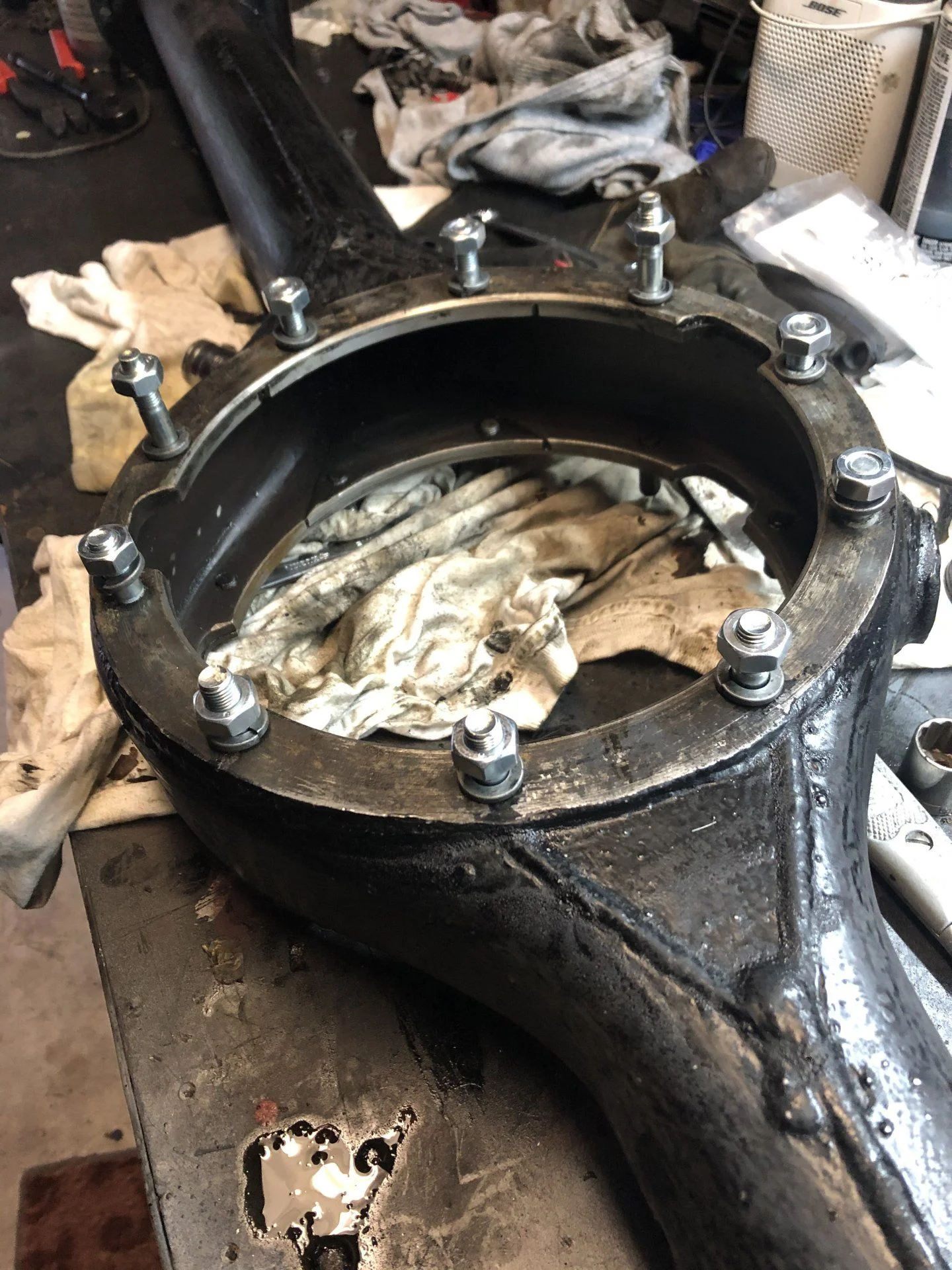

Well I got the axle put back in with the new bearings (pain) and my new brake lines built.
Painted backing plates and axel with shop line after 2 coats of chassis saver.
I hope to get the 3rd member back in Next week. Weather getting to nice to sit in garage.
