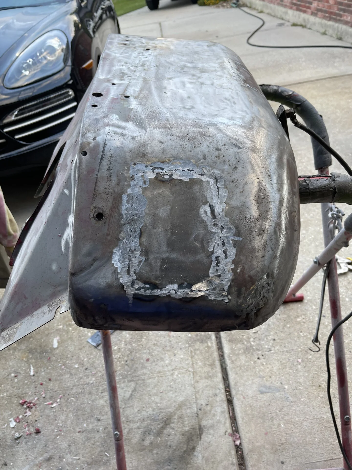

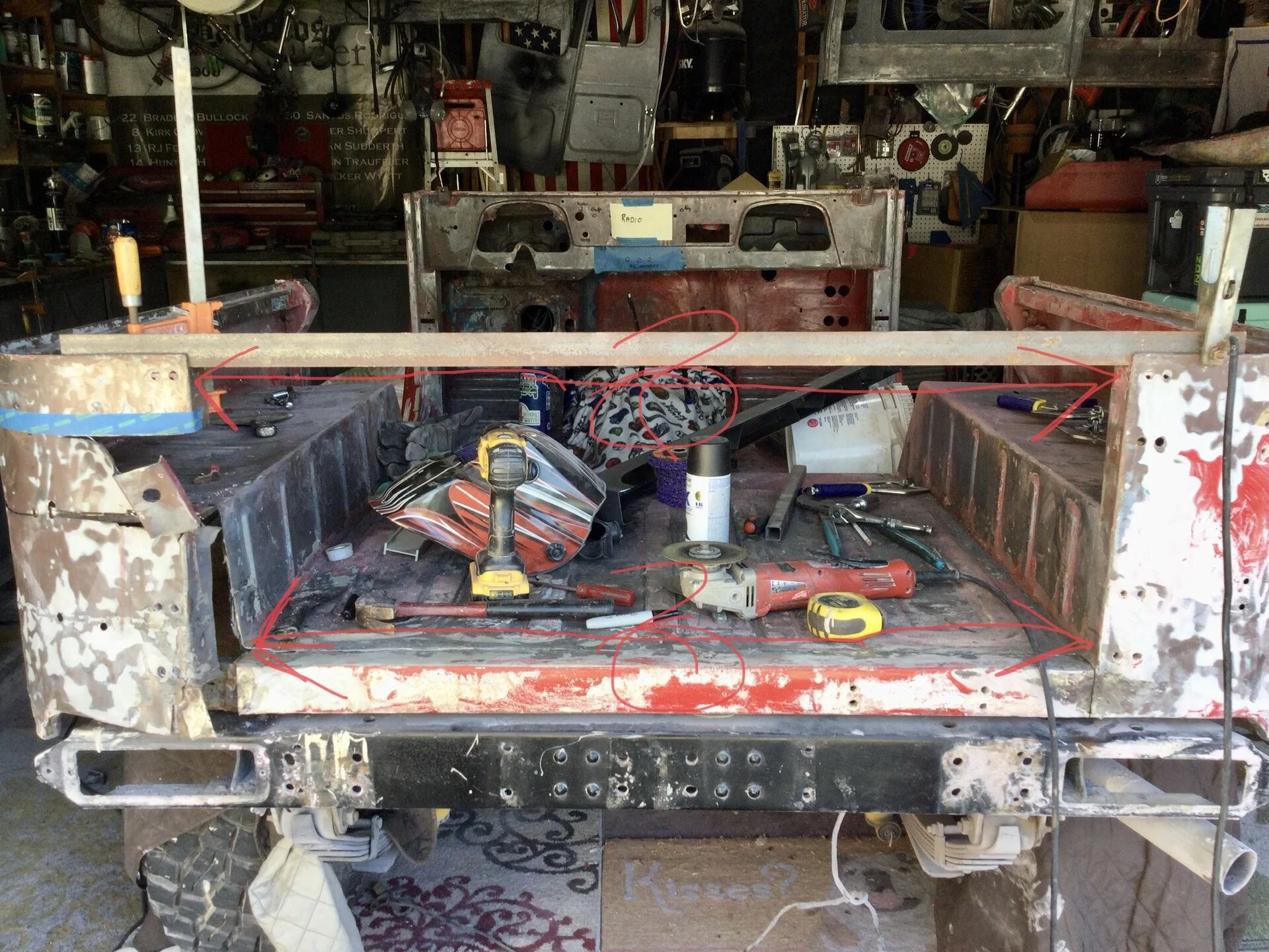

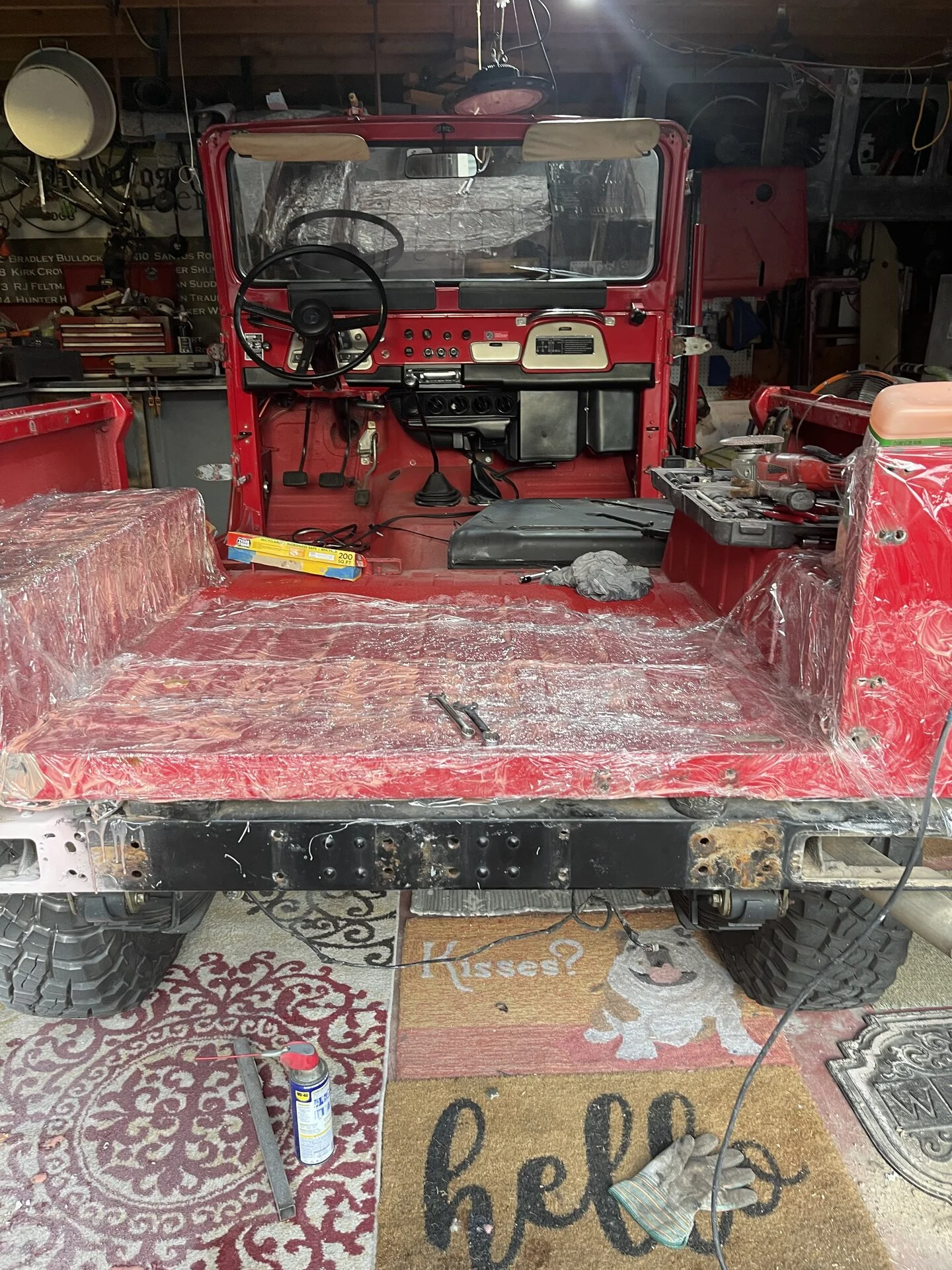

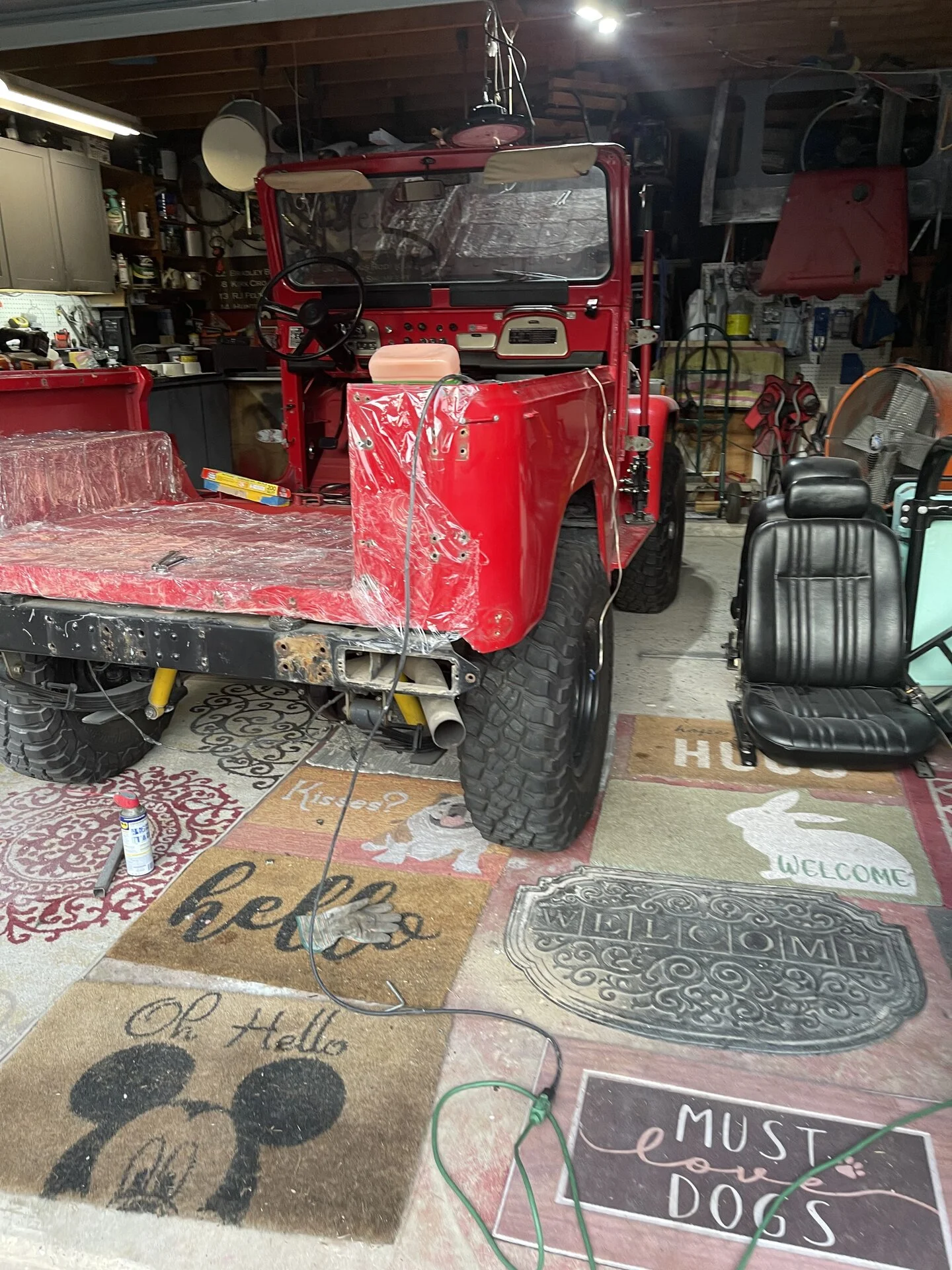

And so it begins! Testing the removal of raptor liner. We will see how that goes.

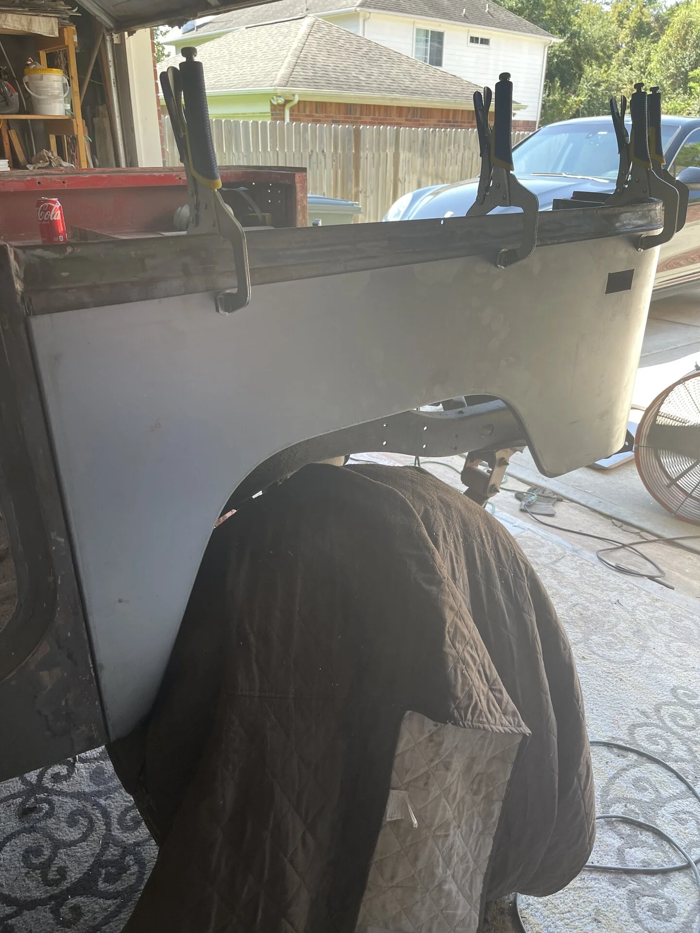

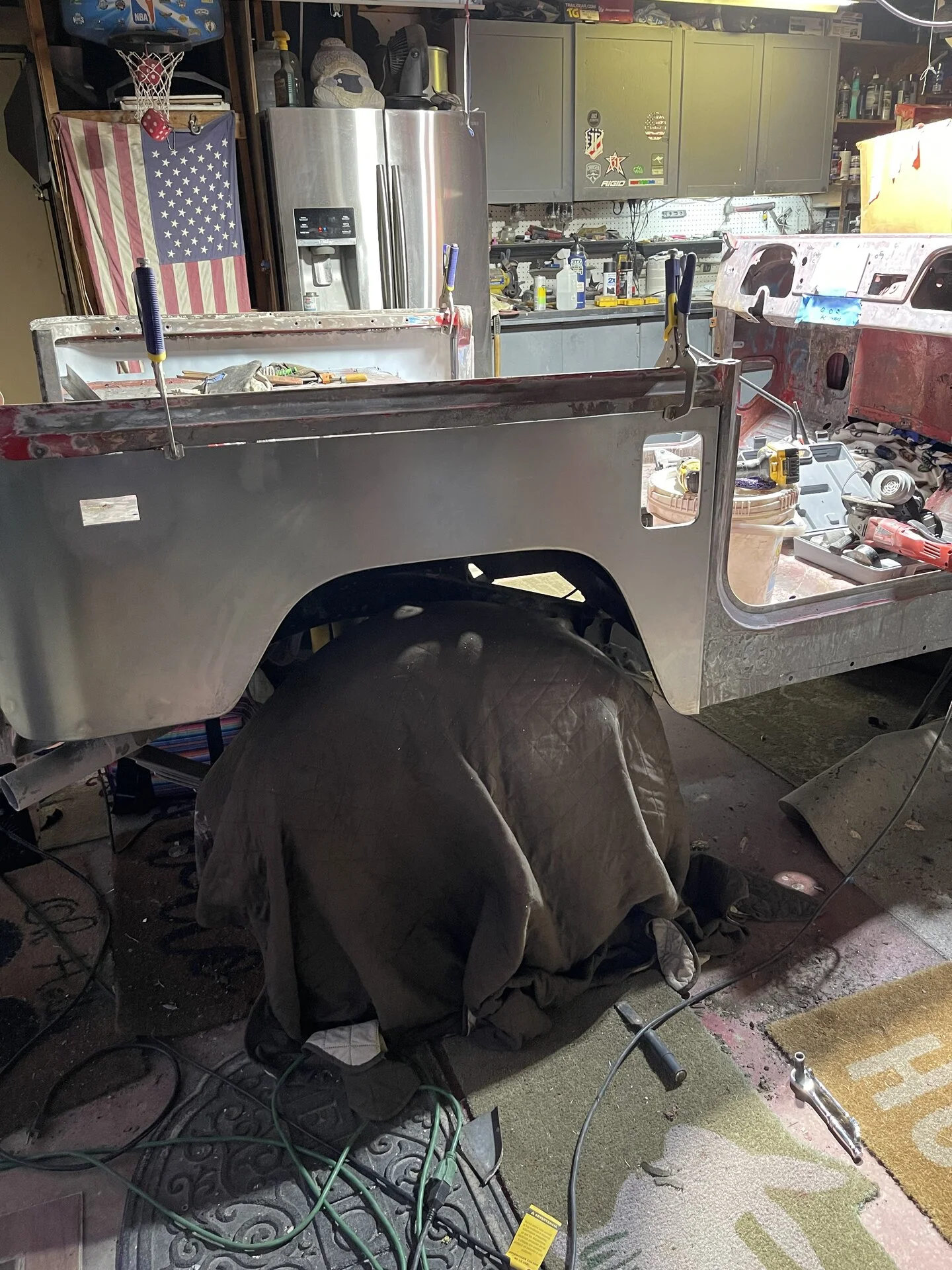

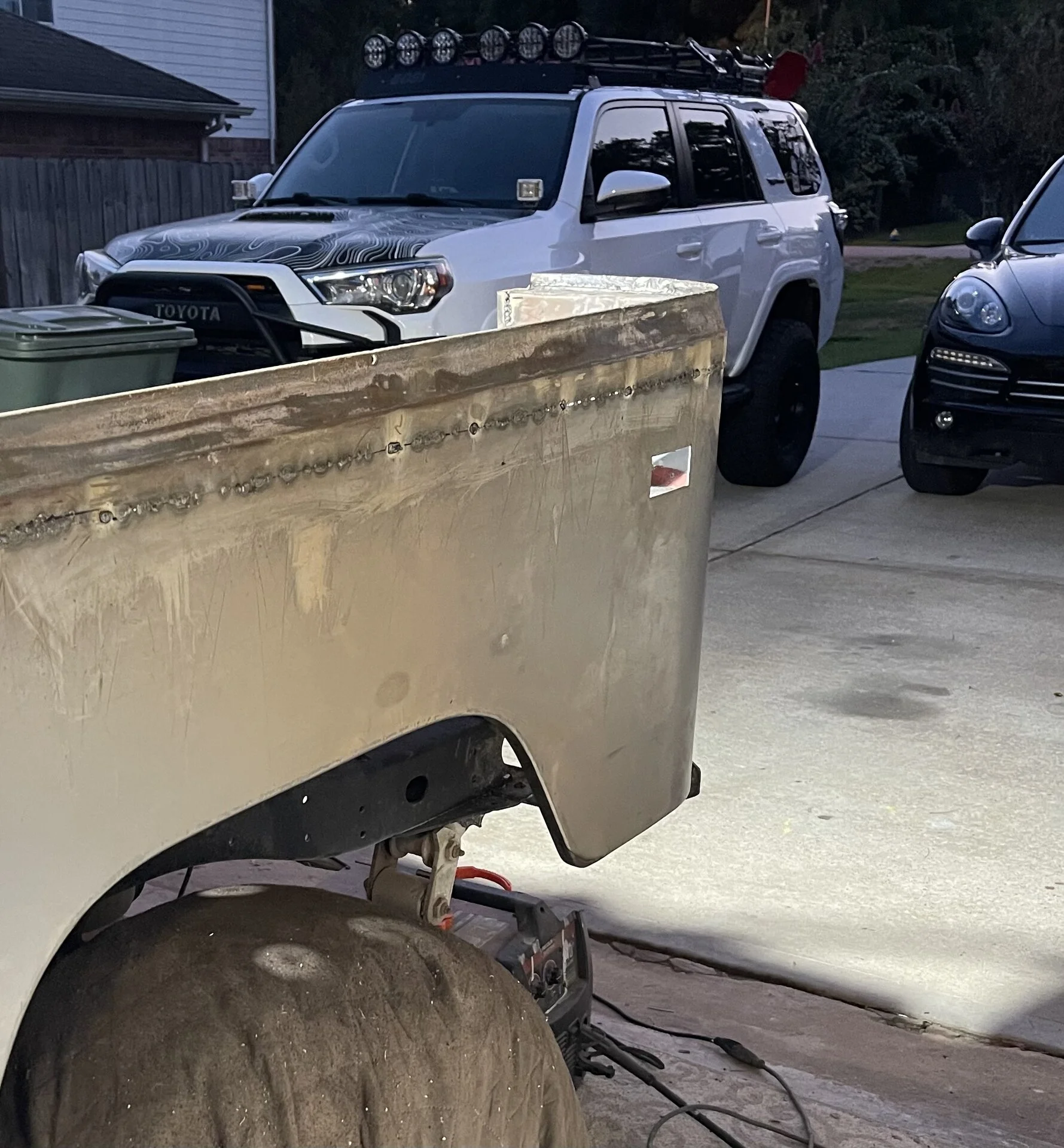

I know I am going to replace the rear quarters, is real steel the best replacement panels?
It looks to me like you used some kind of stripper to remove the raptor liner? I've got an 80 series that was raptor lined half way up by the PO that needs to come off to address rust issues. Was paint stripper the best method you found? Thanks
yes, citristrip was the best one. Slop it on thick and put Saran Wrap over the entire area. The next day it scrapes right up. It was surprisingly easy

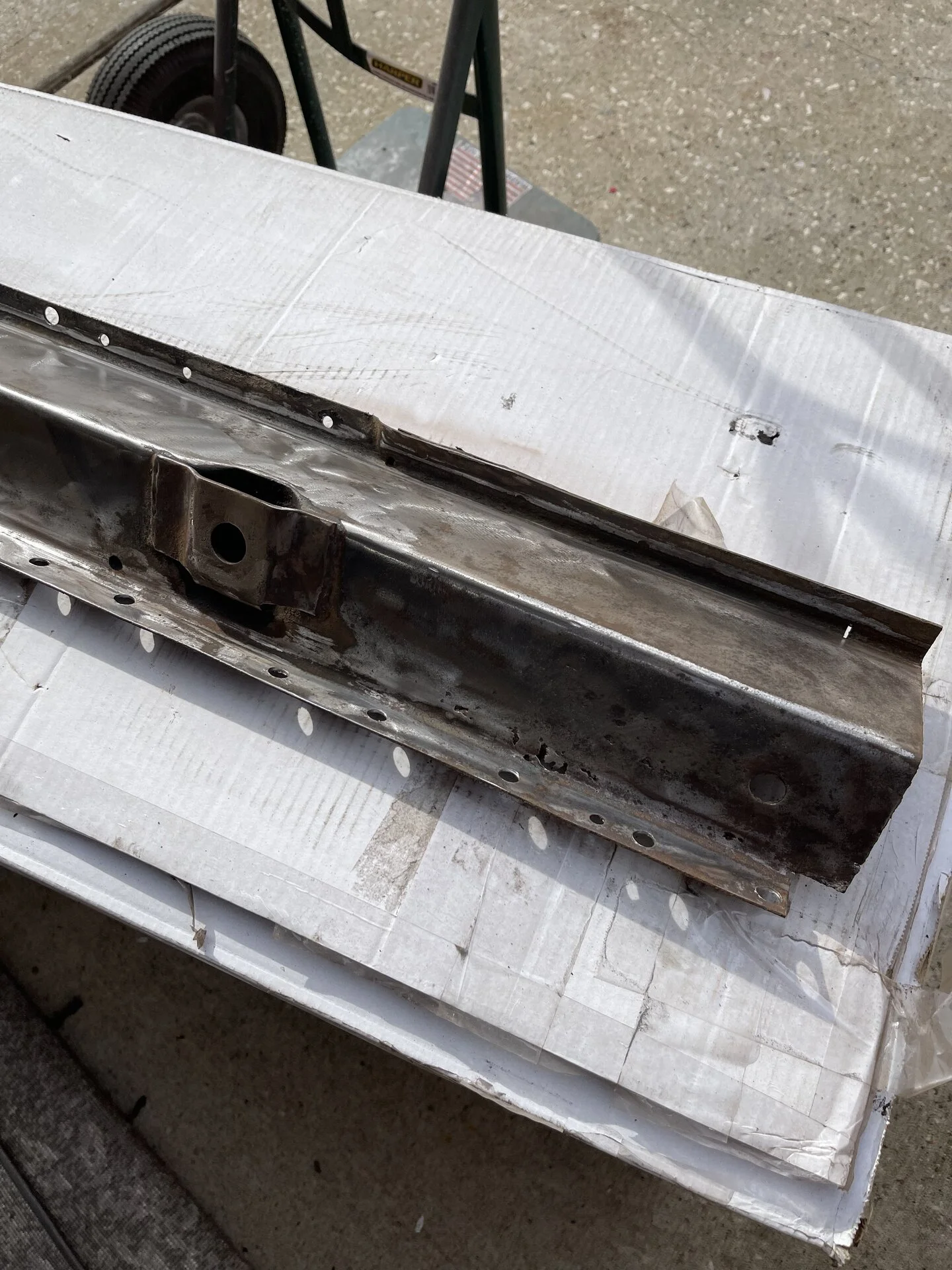

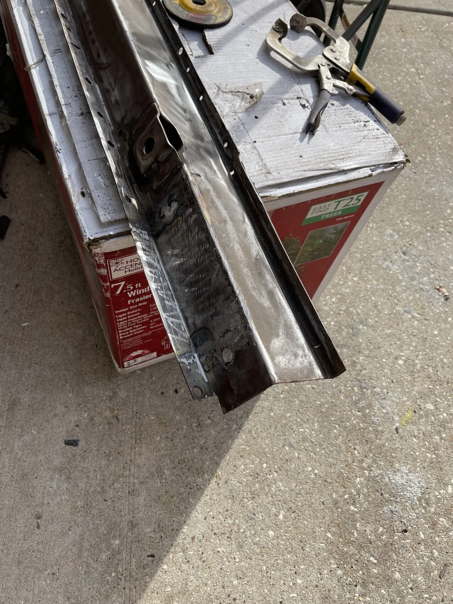

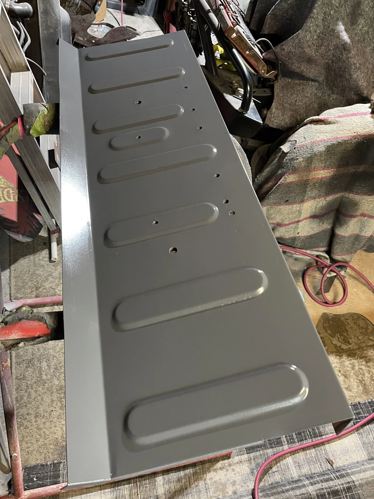

cut out the mid section and the beam underneath didn’t look too bad. Cleaned, rust encapsulated, POR15. Waiting on the new part to arrive. It’s gonna be a PIA to replace. Pinched between floor and cross beam.

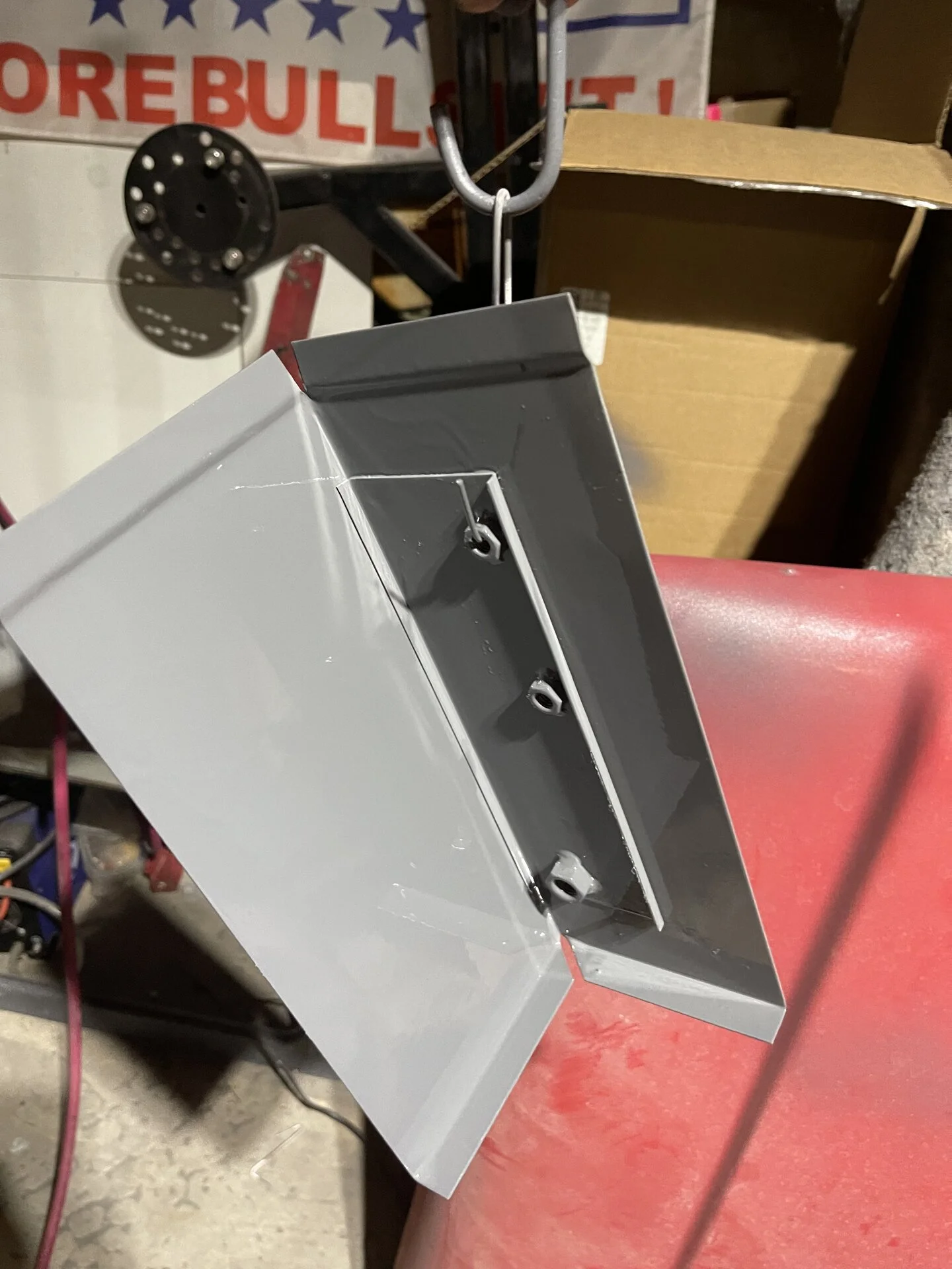

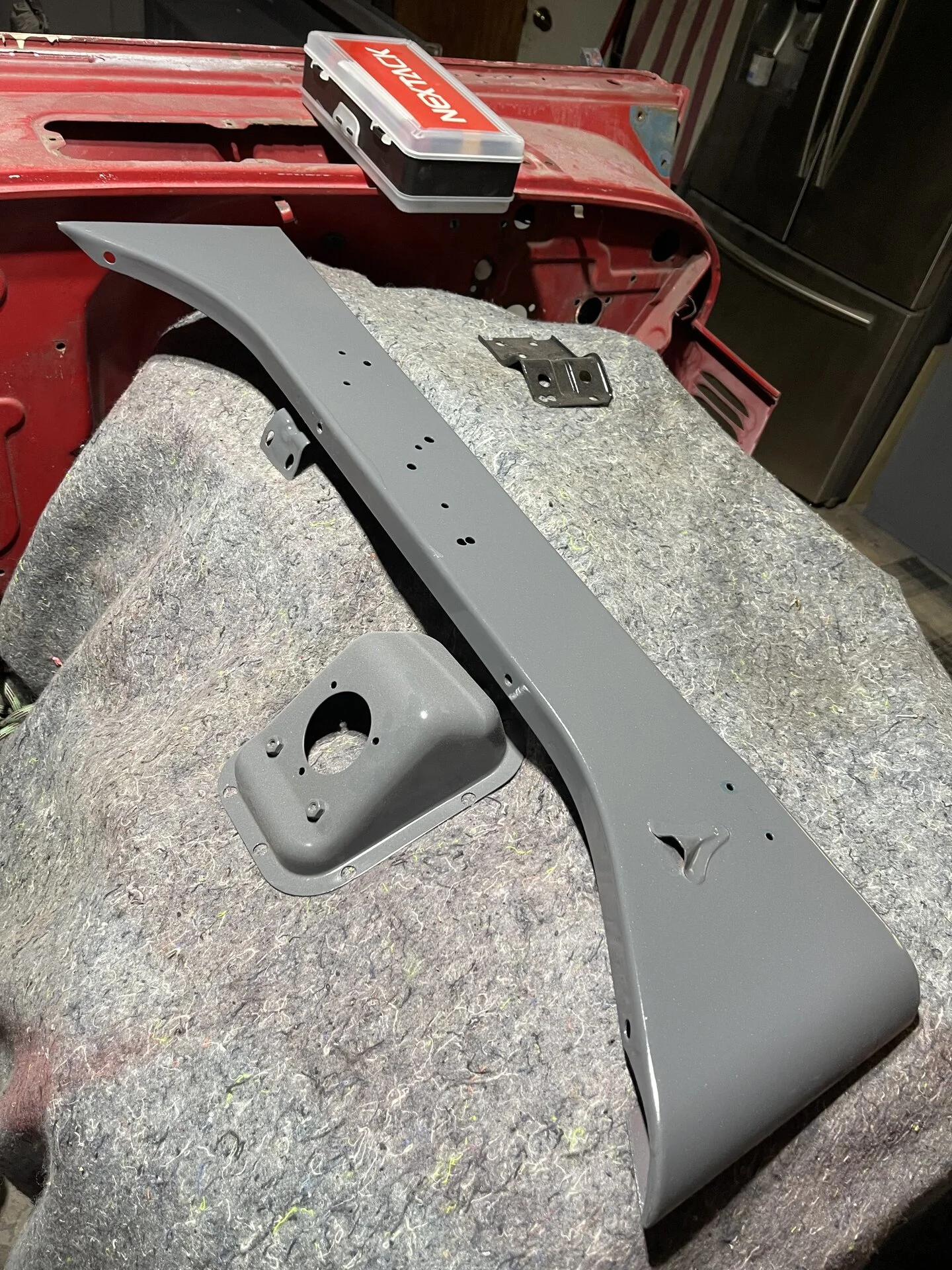

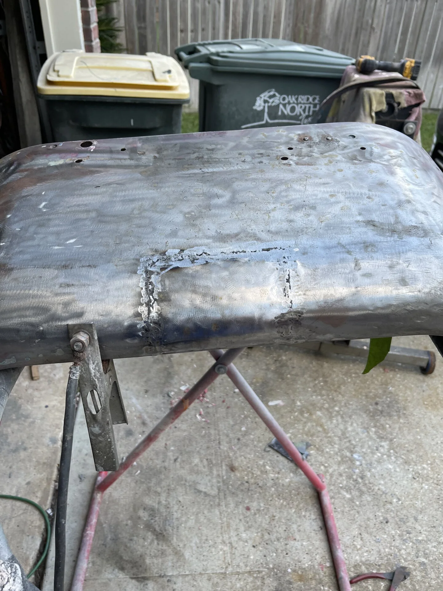

Using Eastwood epoxy primer on bare metal. Will do the finish/ filler work on top of that. When I first sprayed the bed I was using a 1.4 tip, I changed to 1.8 tip and it’s a big difference. Really smooth.

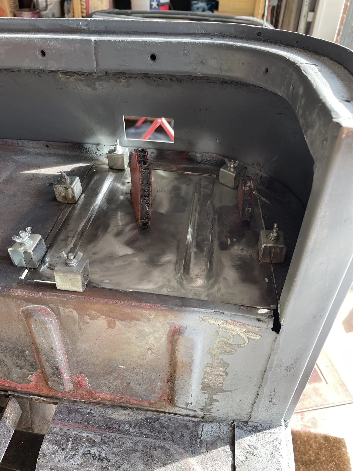

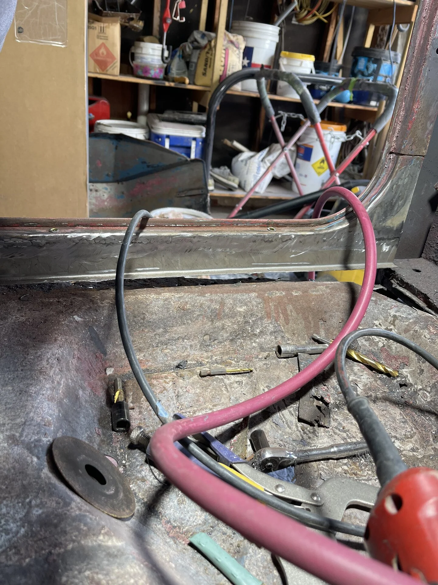

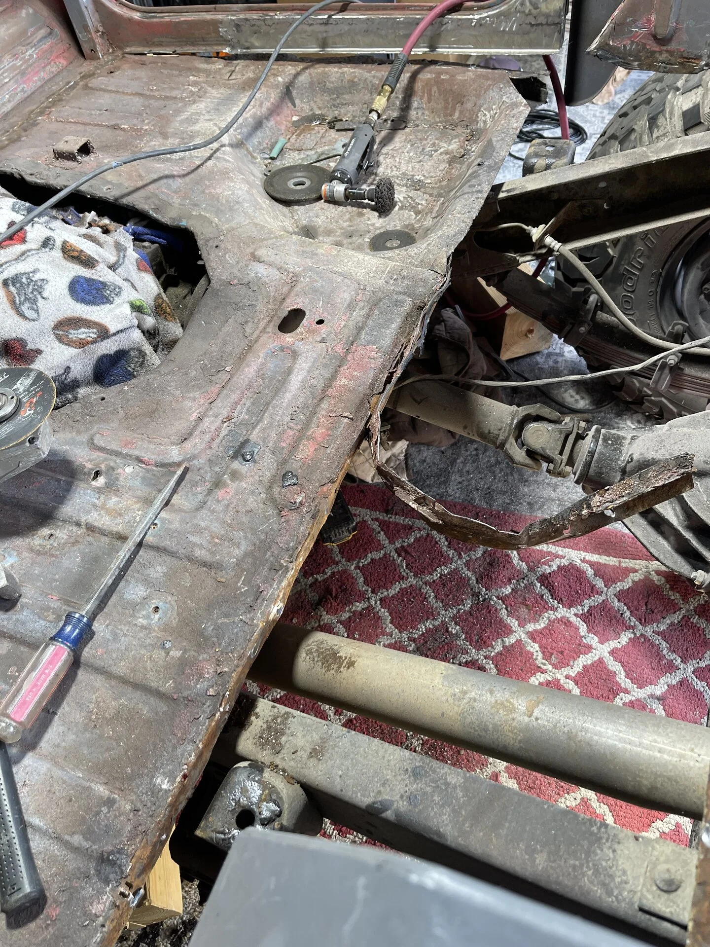

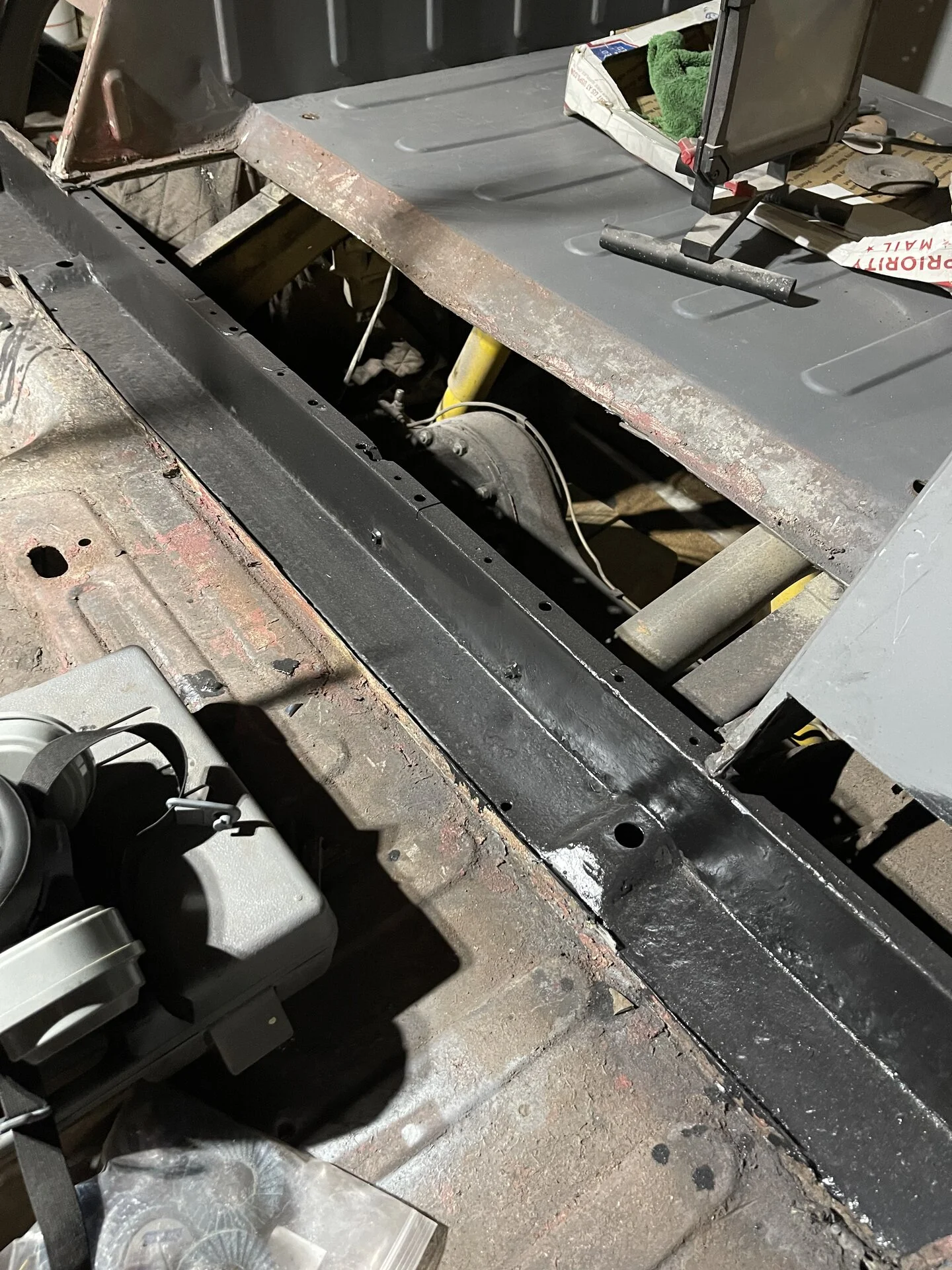

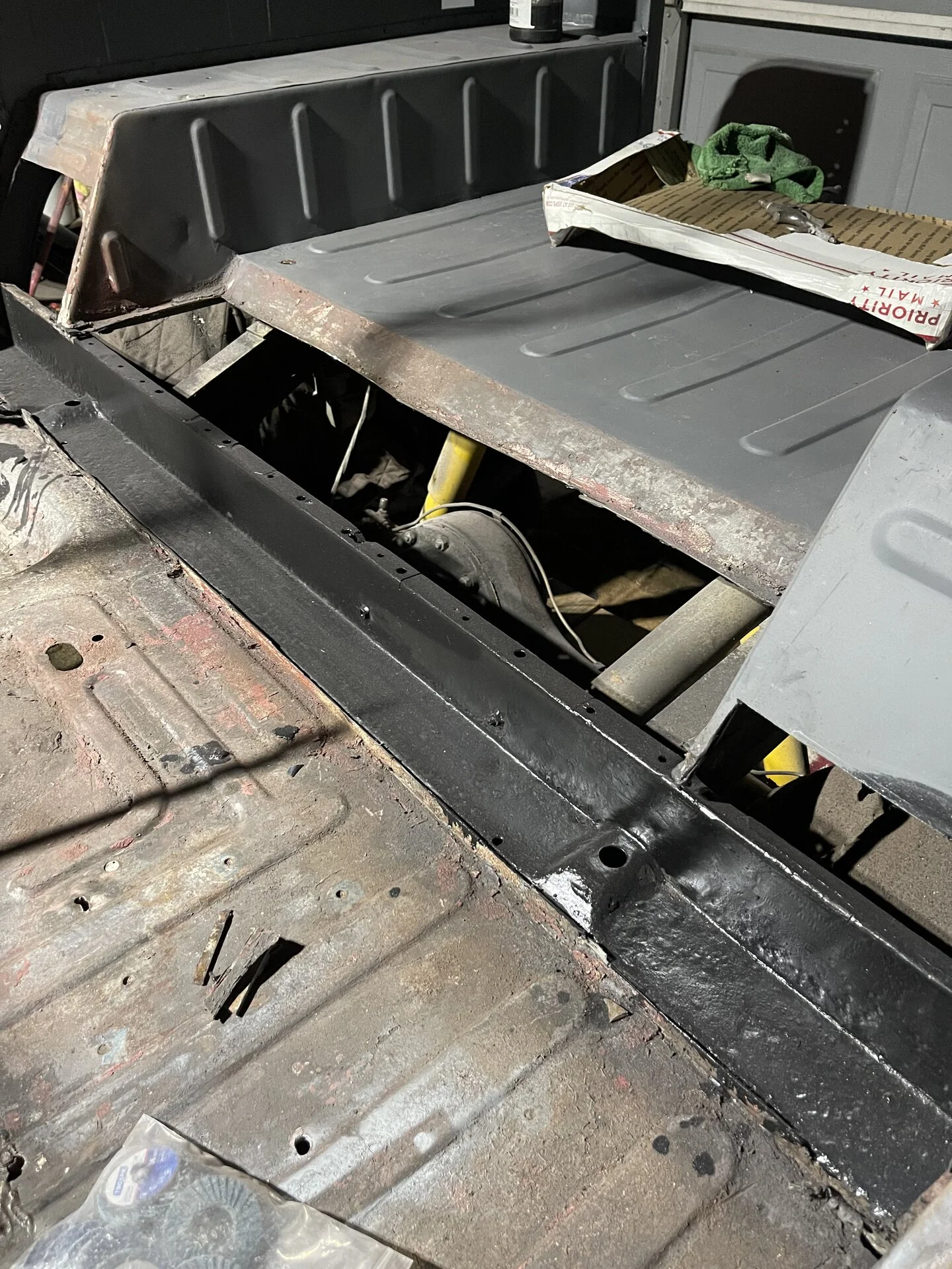

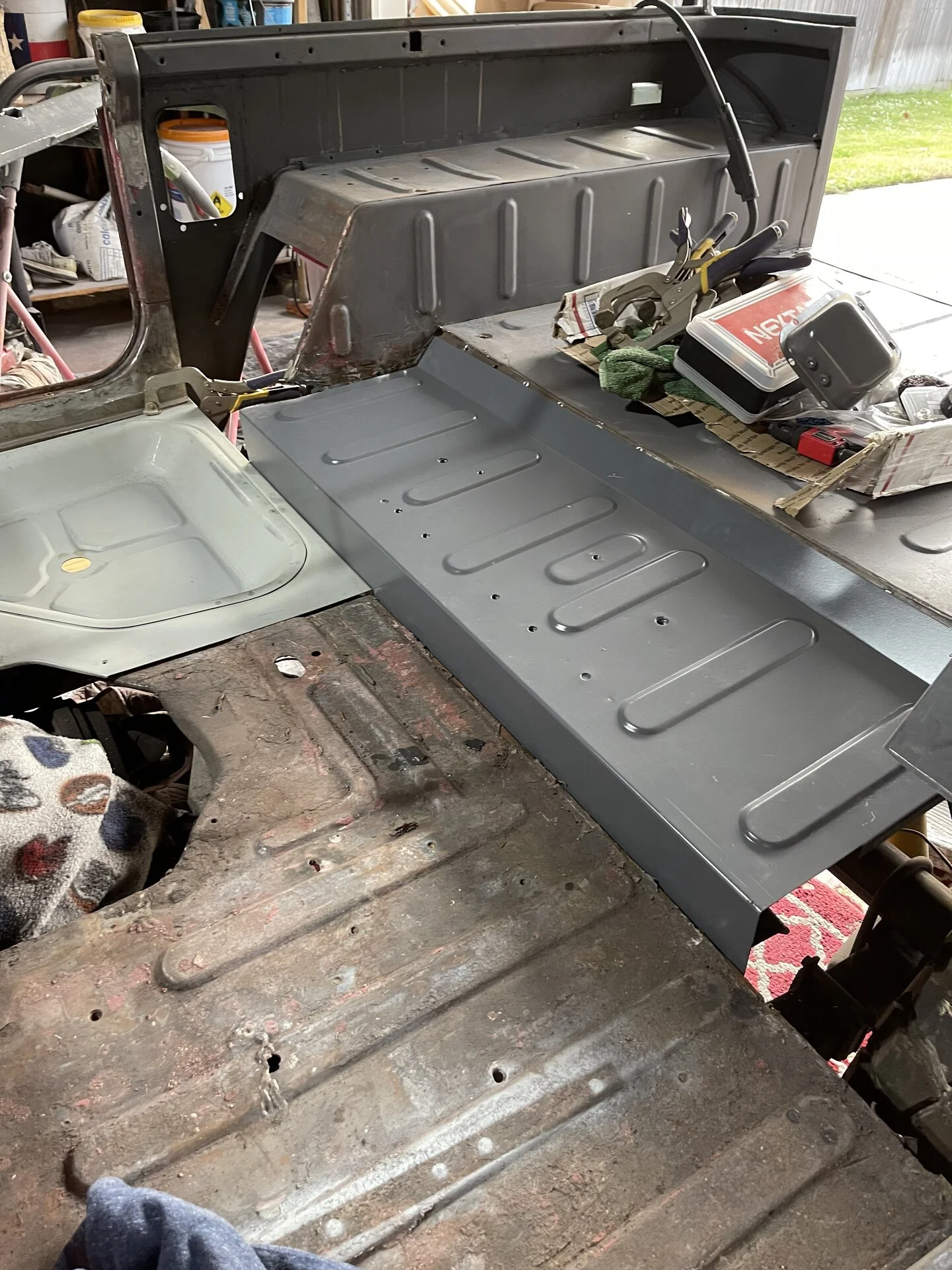

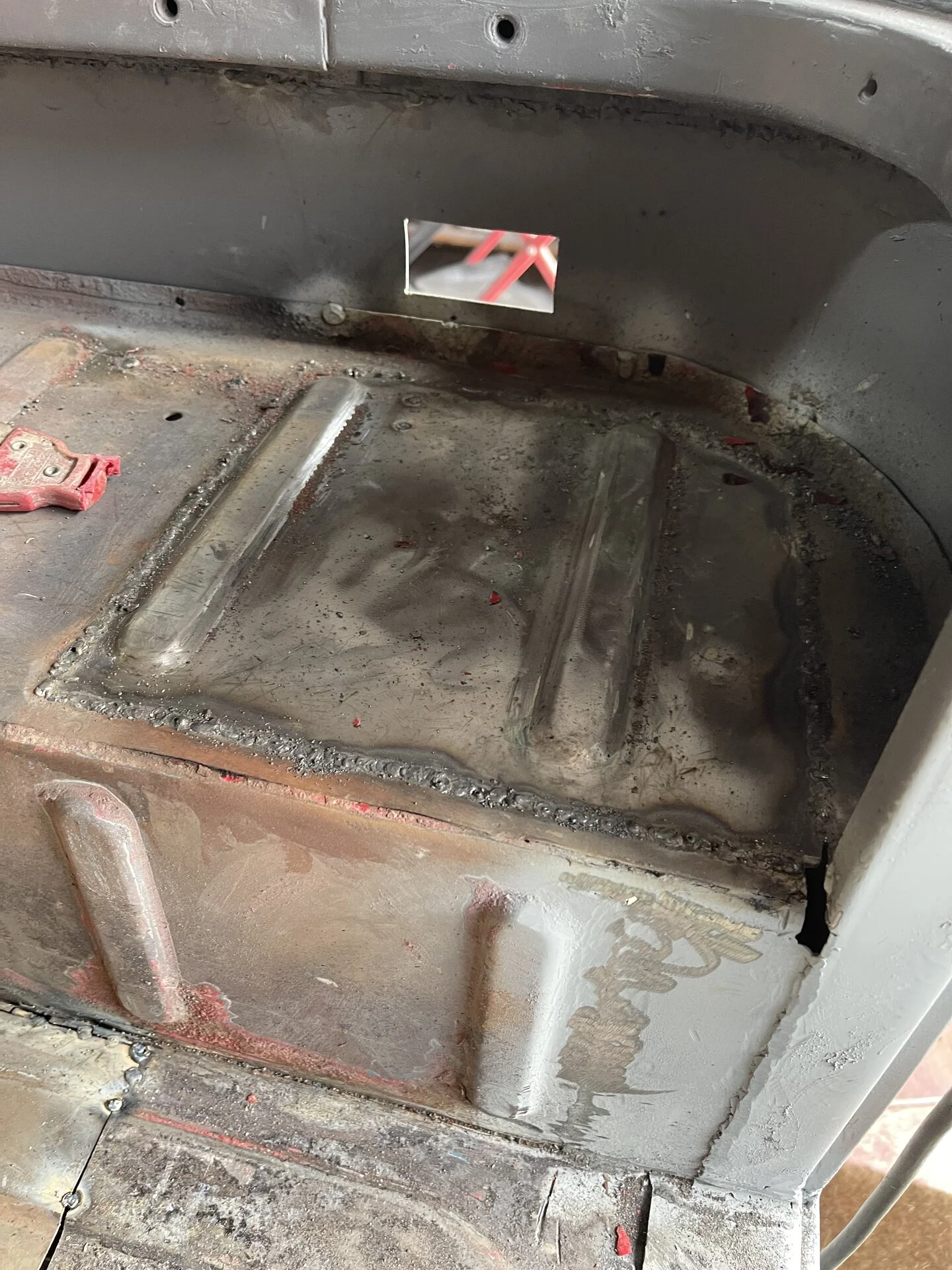

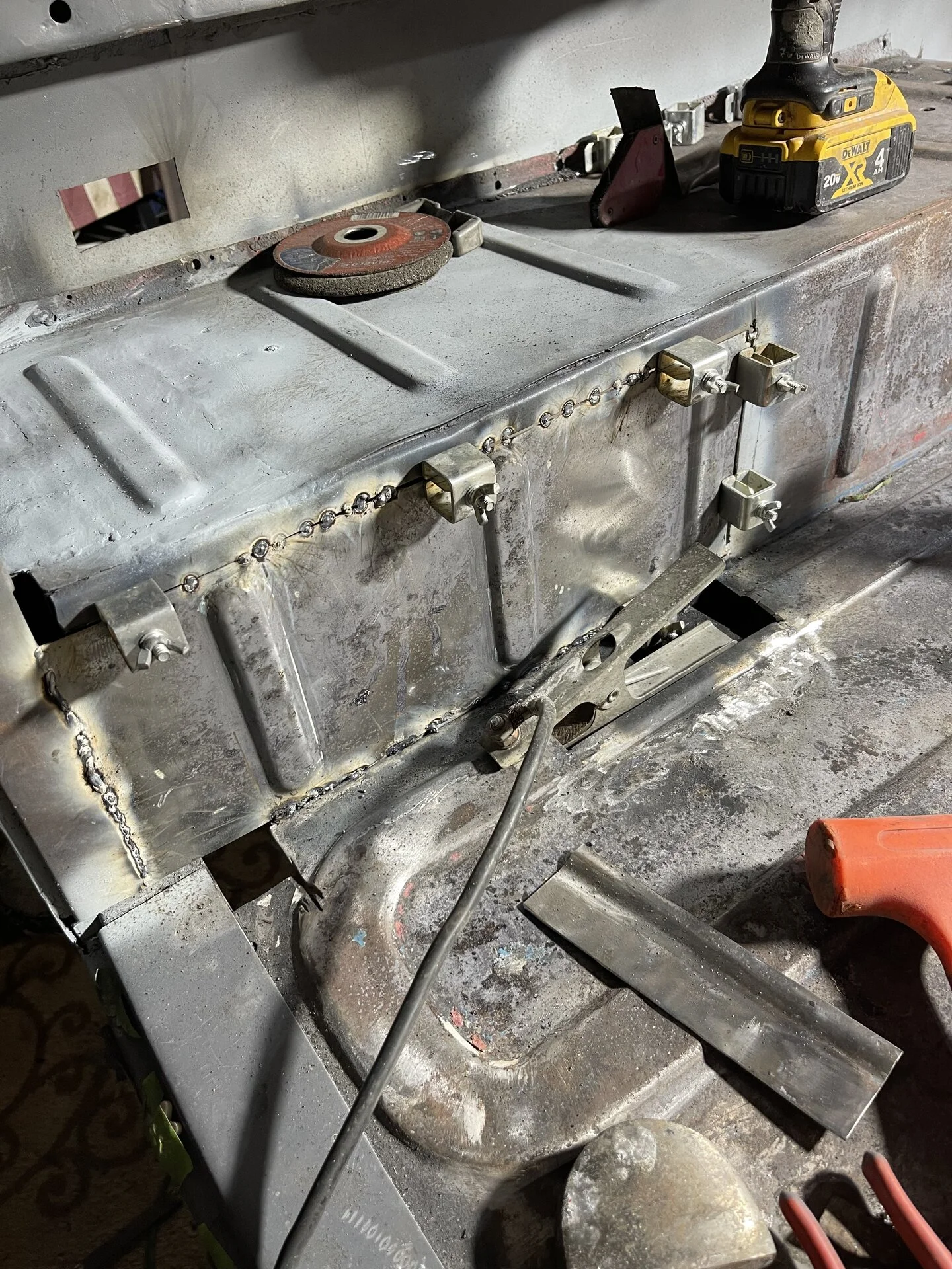

Finally making some headway. Removing the mid floor support is a PIA. Had some rust to replace at the end section. Also removed the passenger floor section. I have no flipping clue what I am doing, but I doing it. lol. I just hope everything lines back up. Guess I’m gonna put the doors and sides back on to make sure. Ugh.
Learn by doing!
For someone who says they don't know what they are doing, this is VERY impressive work.
