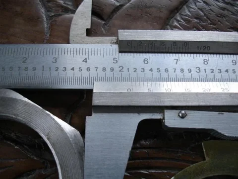

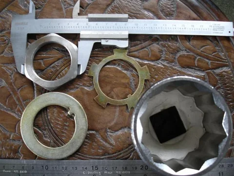

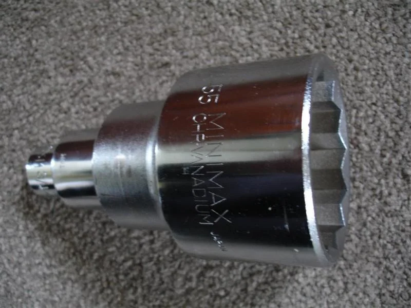

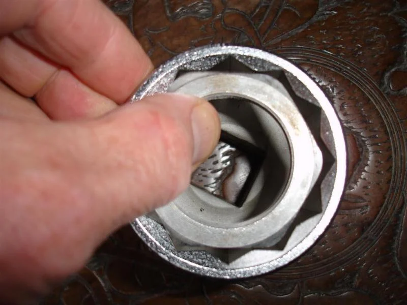

Anyway, before reading your post Claudia, I took my pics so I might as well post them to eliminate any future arguments about socket size for nuts used on fine-spline axles:
The first proves my 55mm socket is a bit too large:
:beer:

The more cattle prodding of the gravy-trainers the better... so here´s a pic of my nuts in their nutbag with some of their friends along with proof that your nuts are in fact slightly bigger than mine.
