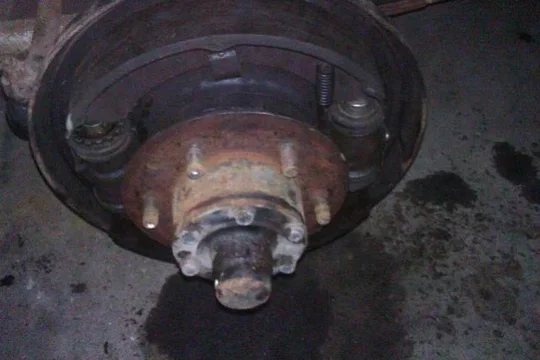

Nice to see another BJ40. I have one ´75 too but it´s in much worse condition than yours. (Thanks to road salt and nordic climate)
Is your BJ build between 1/75-9/75? You seem to have those weird looking free wheeling hubs too so I´m pretty sure our Cruisers are about the same age.
Oh and don´t loose the BJ40. The 1974-75 BJ40´s are the most rarest... well a ´76 HJ45 is rare too..sooo .. keep the BOTH :D
Anyway I will be watchin this topic very closely!
Front hub. Doesn't seem to be unlockable. Looks same as on the pickup. Troopy front hubs can freewheel.

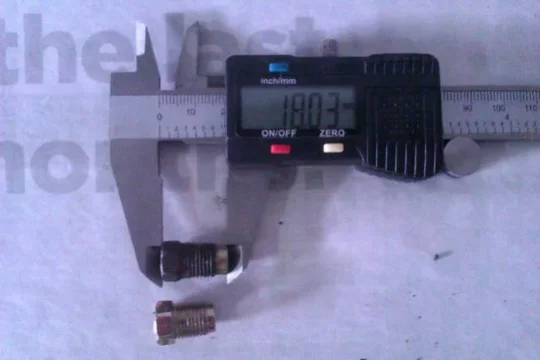

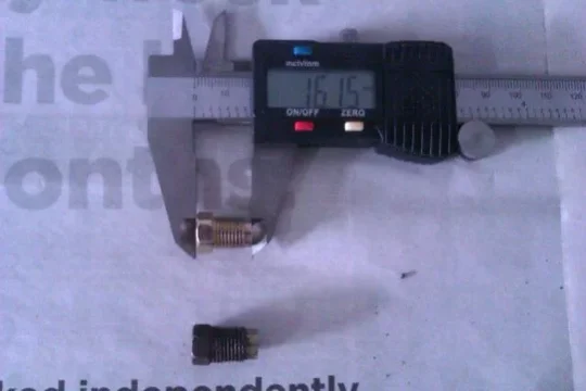

Put the MC back together with parts from the maintenance kit except the front piston which appeared to be very different from the original. Tested on bench before installing and glad I did. Rear didn´t drain or pump thru so took it apart again. The replacement rear piston is slightly longer than the orig so must be for an MC where the rear reservoir is slightly further away from the booster.
Cleaned up the old pistons and used them instead, they weren´t in such bad shape. So what I got out of the repair kit was
- copper washers for the check valve covers.
- check valves
- copper washer for piston retainer
- snap ring that holds the pistons in
- rubber seal that goes between MC and booster
But I think the main benefit of the exercise was it having its first thorough clean out for 38 years. The MC bore didn´t need honing but it had a flush thru with hot soapy water as it was full of crap. Also cleaned the push rod as that was covered in grime and not moving smoothly. MC is back on the car and connected up. Filled & bled the MC but didn´t have time to bleed the brakes. Maybe tomo, or next week, or the weekend.
