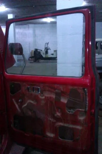

Something to add to the list of bare minimum jobs: install door cards and window winders. Pickup is donating these for now.
nothing exciting to report, been busy with other things. Cleaned the door cards up, lost a window winder retaining clip - it pinged off somewhere, and changed the oil and filter. Radiator about to get flushed and waiting for fuel filter to arrive.
