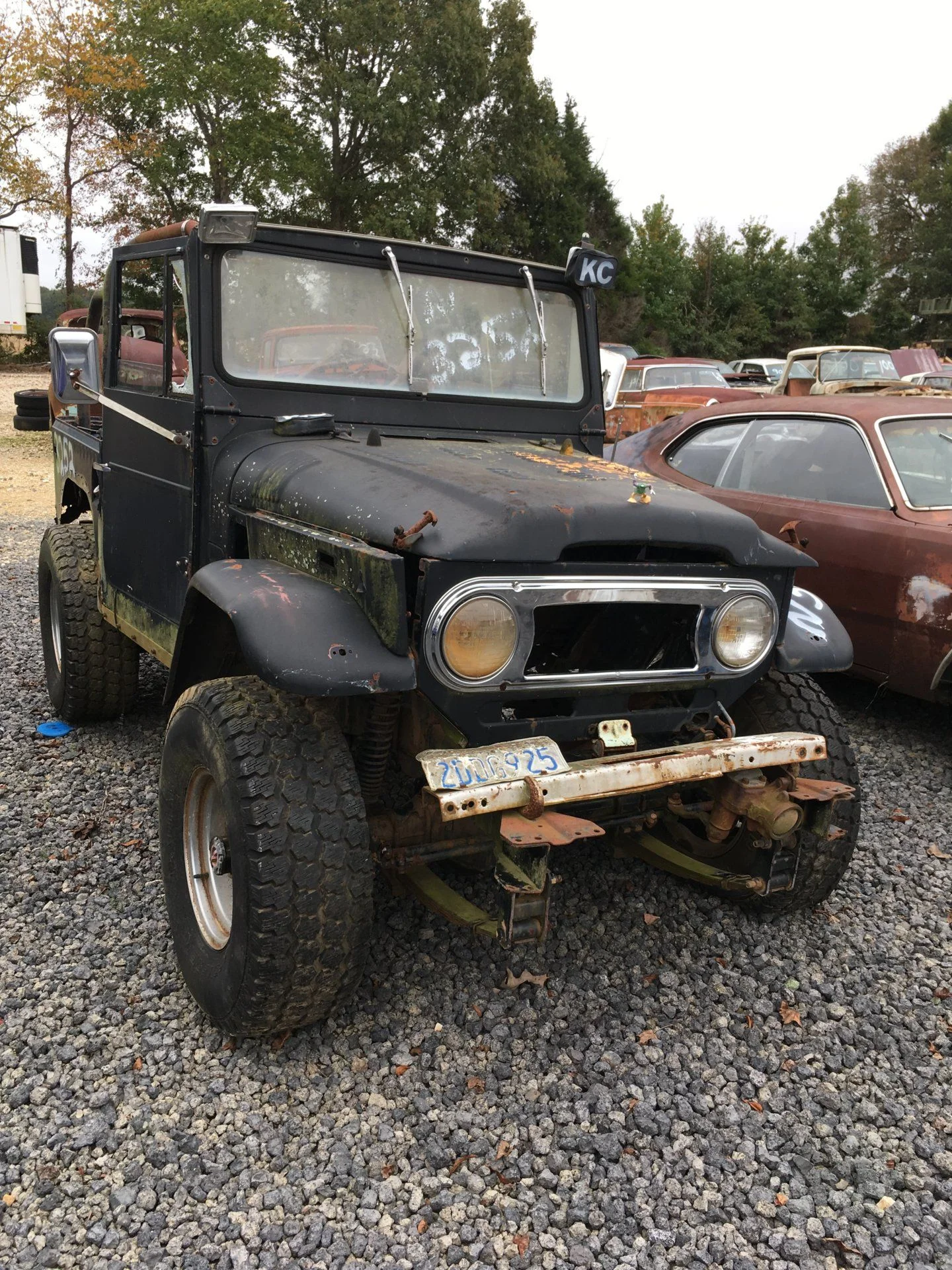

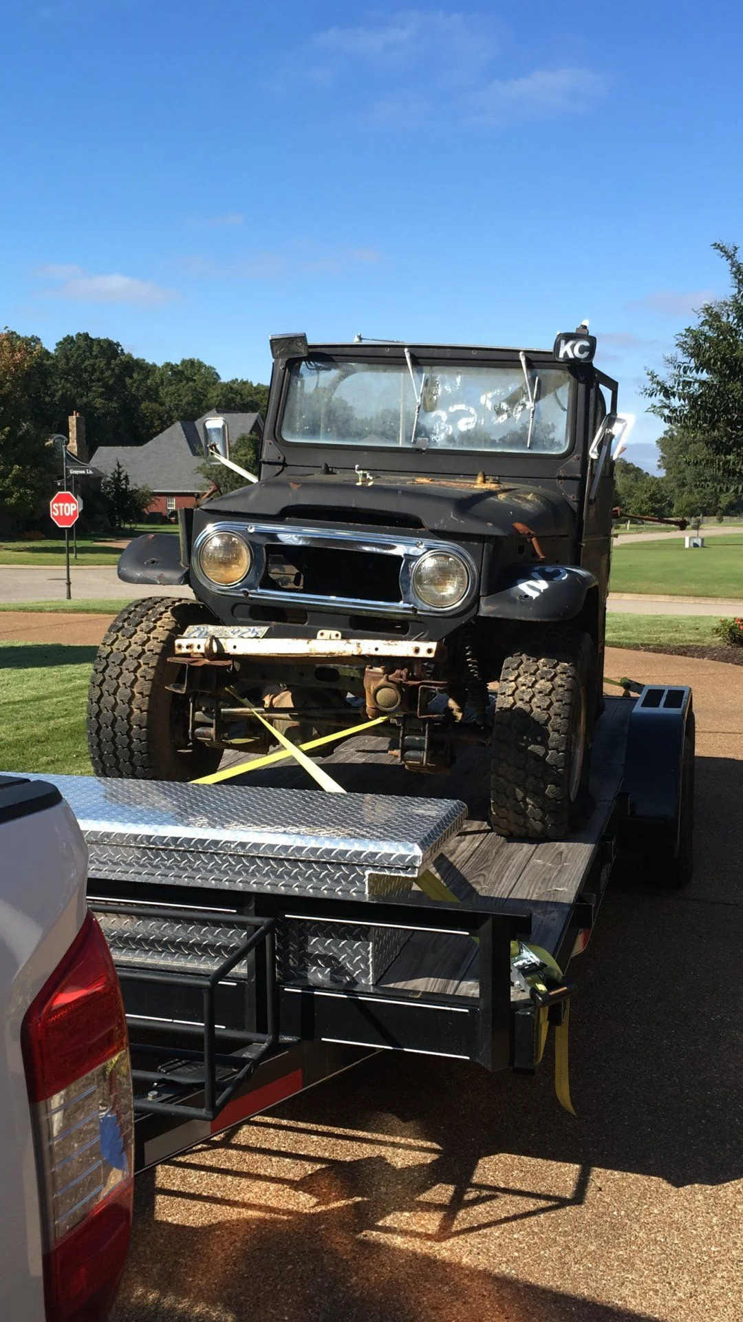

Hi wanted to introduce myself, I just rescued a vehicle from a salvage yard.
Guy was very nice, the yard was local to me. I was supposed to see a corona, and got this fj. Alwasy wanted one, but the prices went so high lately, i doubted i was ever going to own one.
For shell, xxxxxxx$ was a good price. Nothing else, but sheet metal and glass.
I am not afraid to restore, but usually i take my time. I posted on facebook, but im a forums guy.
looks like it came with some modifications and it was a failed project. Someone quit on it.
I will upload pic from phone, tomorrow will use pictures that i took with camera. Ive had the car for a week now.
Love it!!
And the bezel is right side up!
Thanks for saving her:clap:
thanks, guys its going to be a resto mod. too expensive to go original, plus im not the one that failed her. I rescued her.
newer v6 or newer v8 going in it. Toyota engine of course.
Great find with lots of good parts left ion it. The hood ornament must be saved, even if you keep it on the dash once you get it on the road.
Post more pix when you can - we always like to see the PO's wise mods!

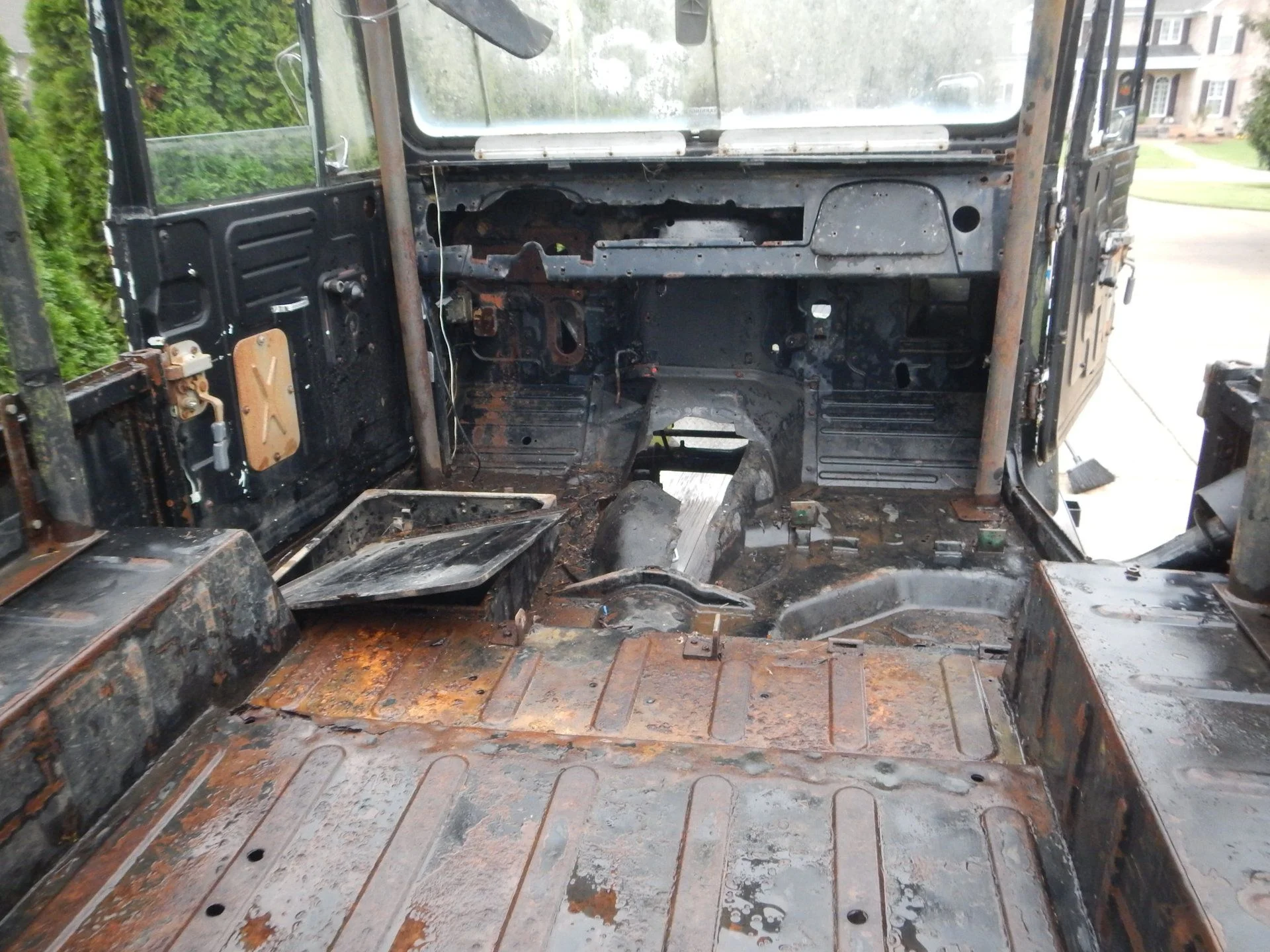

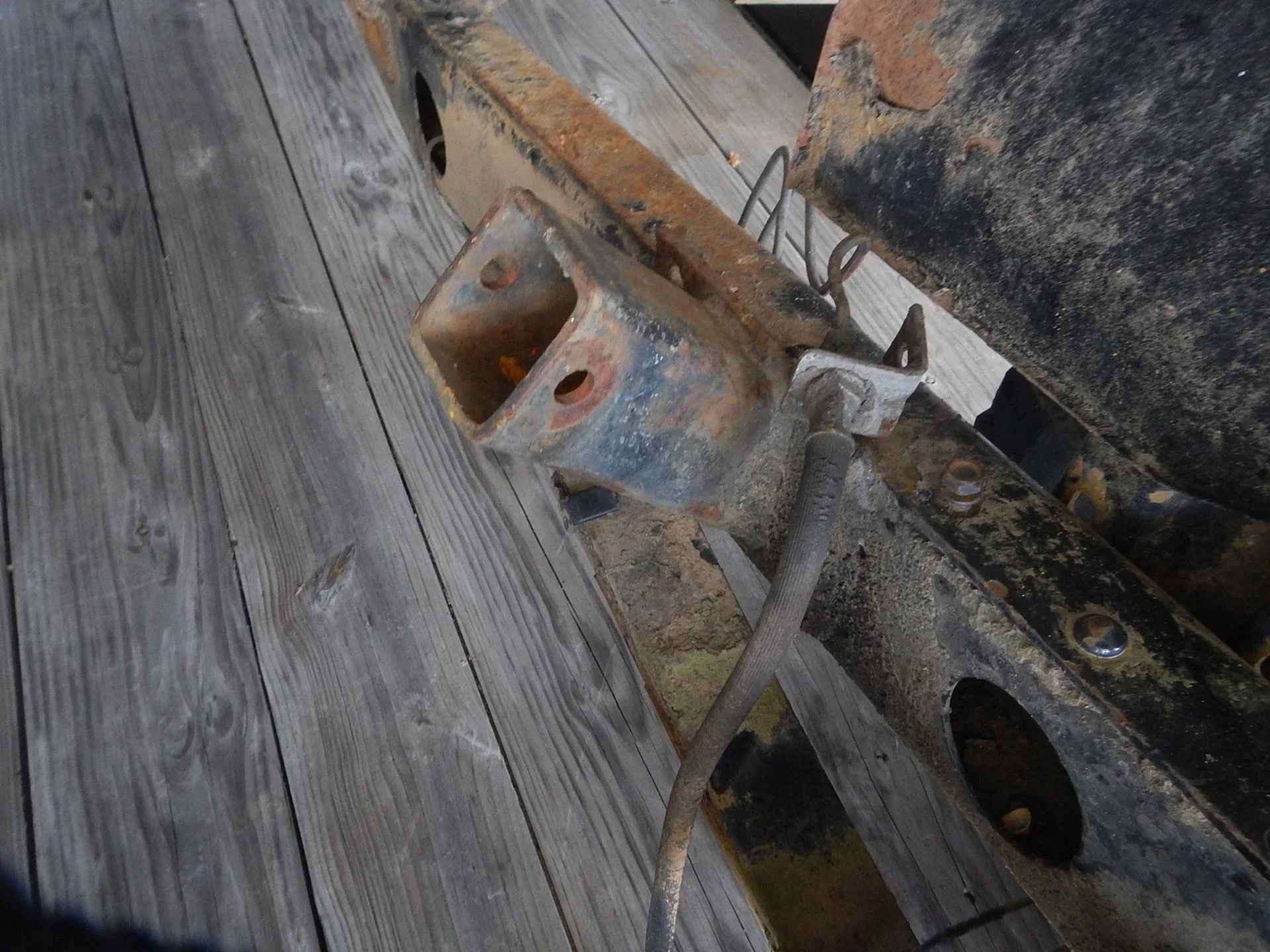

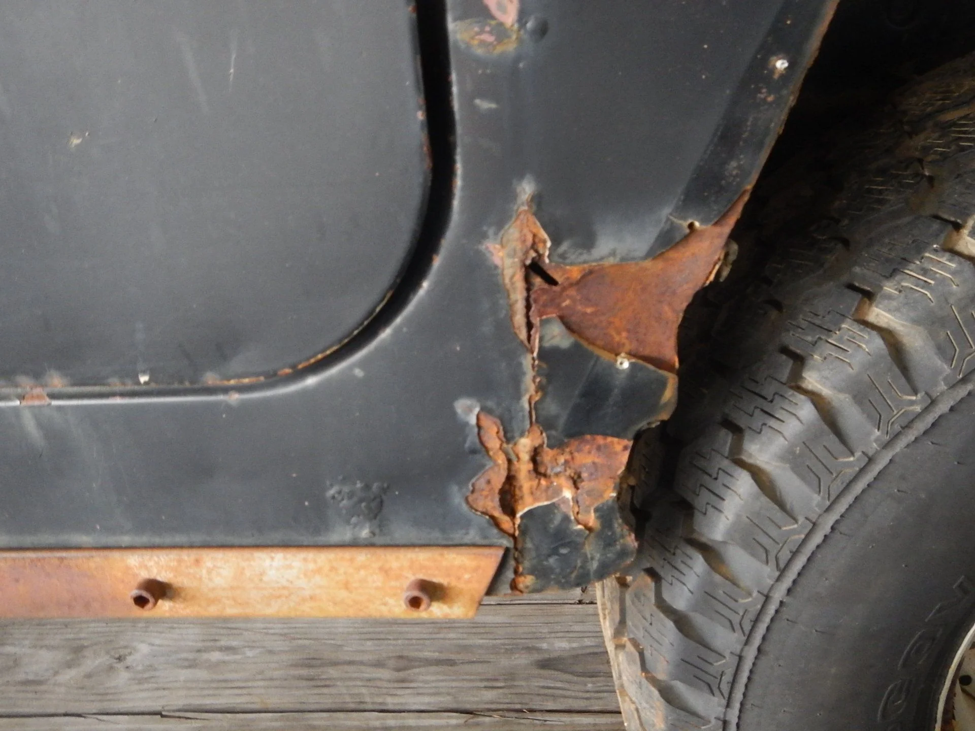

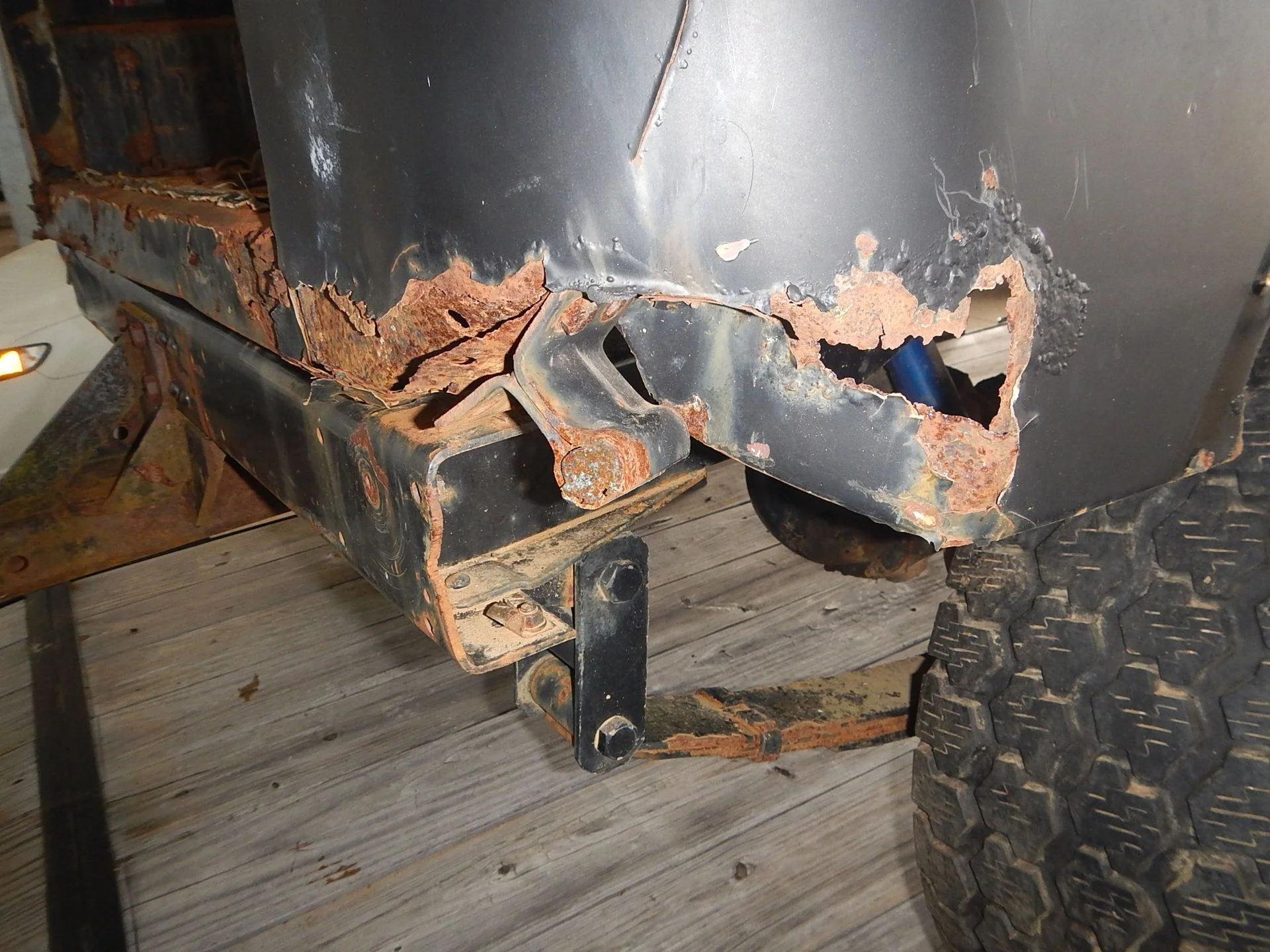

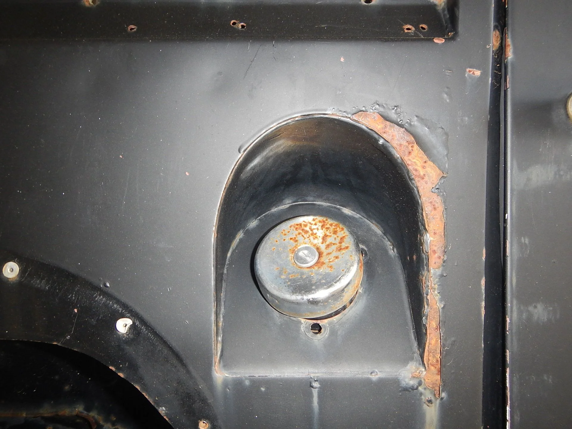

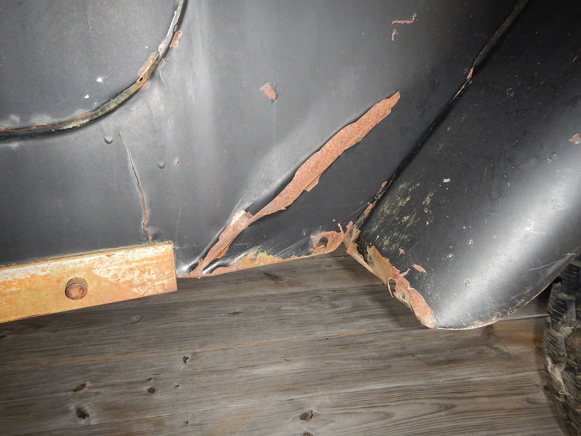

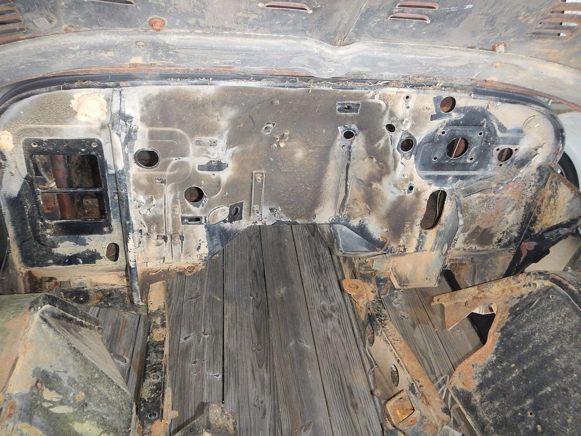

i dont know how many pictures im allowed, but i took a bunch yesterday. to start with rust damage...
after clean up the first day, mostly surface few holes here and there...

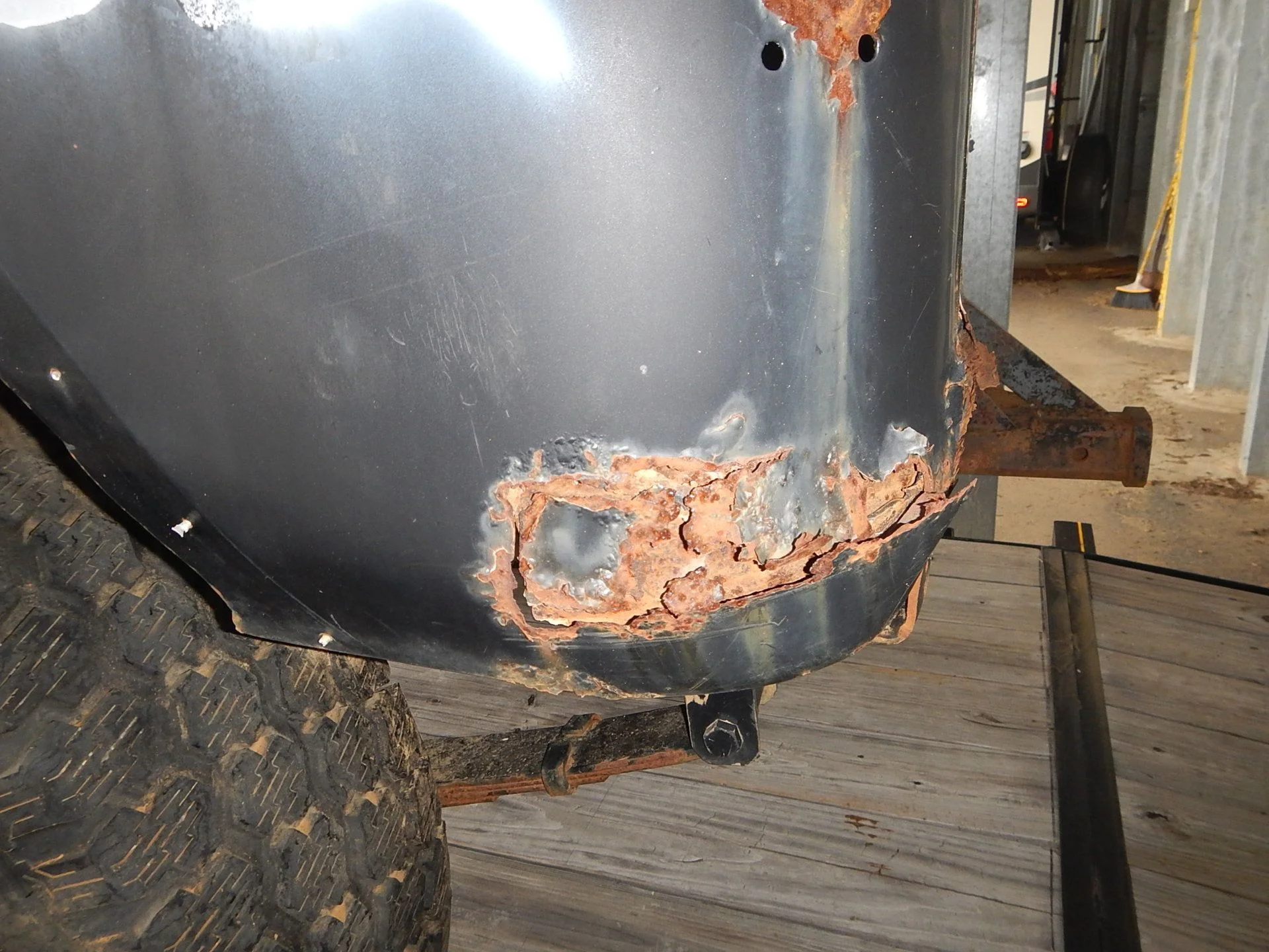

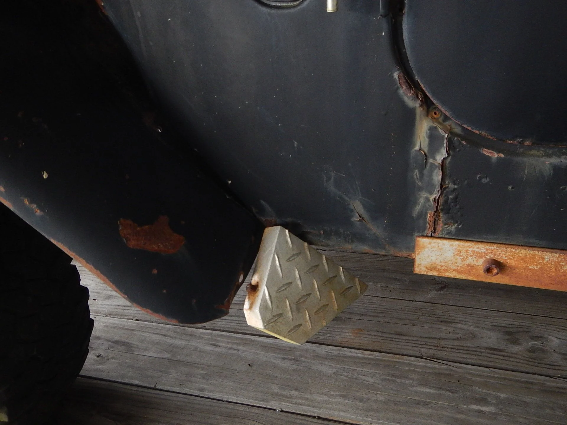

and the other side
next ....
more pictures of the other side
and ..
gas tank area
engine bay

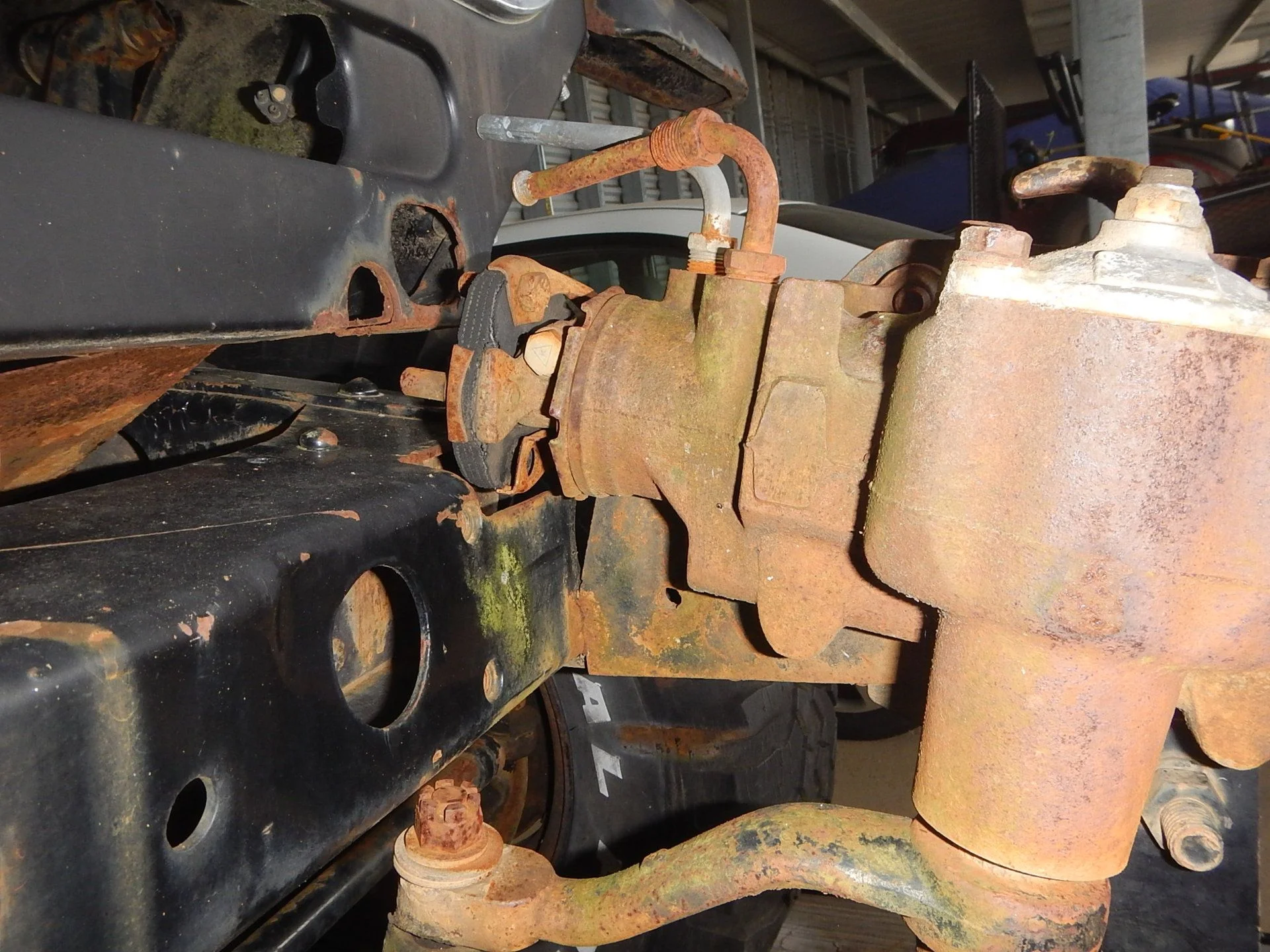

steering box weird angle....
next....
recent or new gasket...

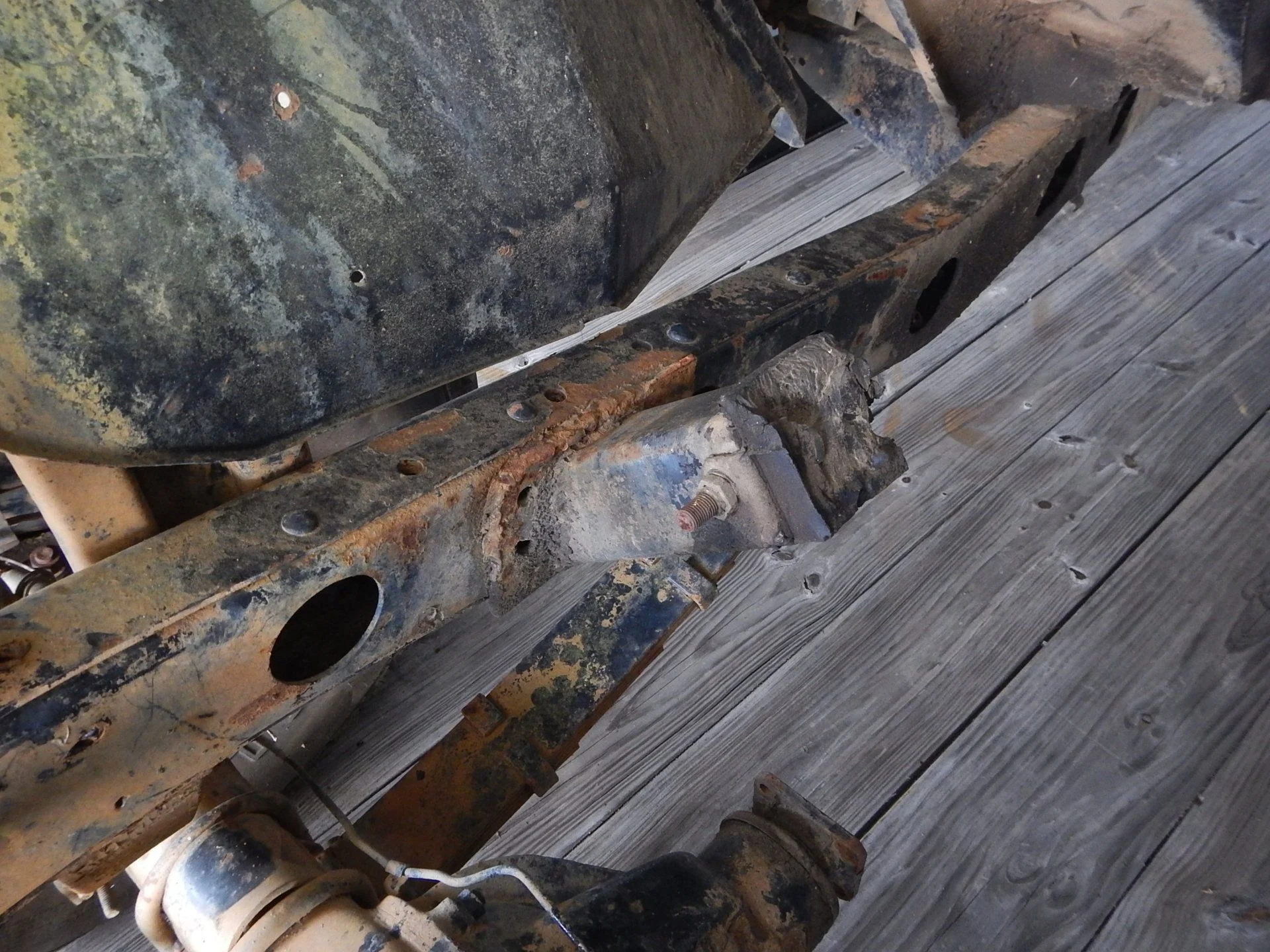

mounts of some sort

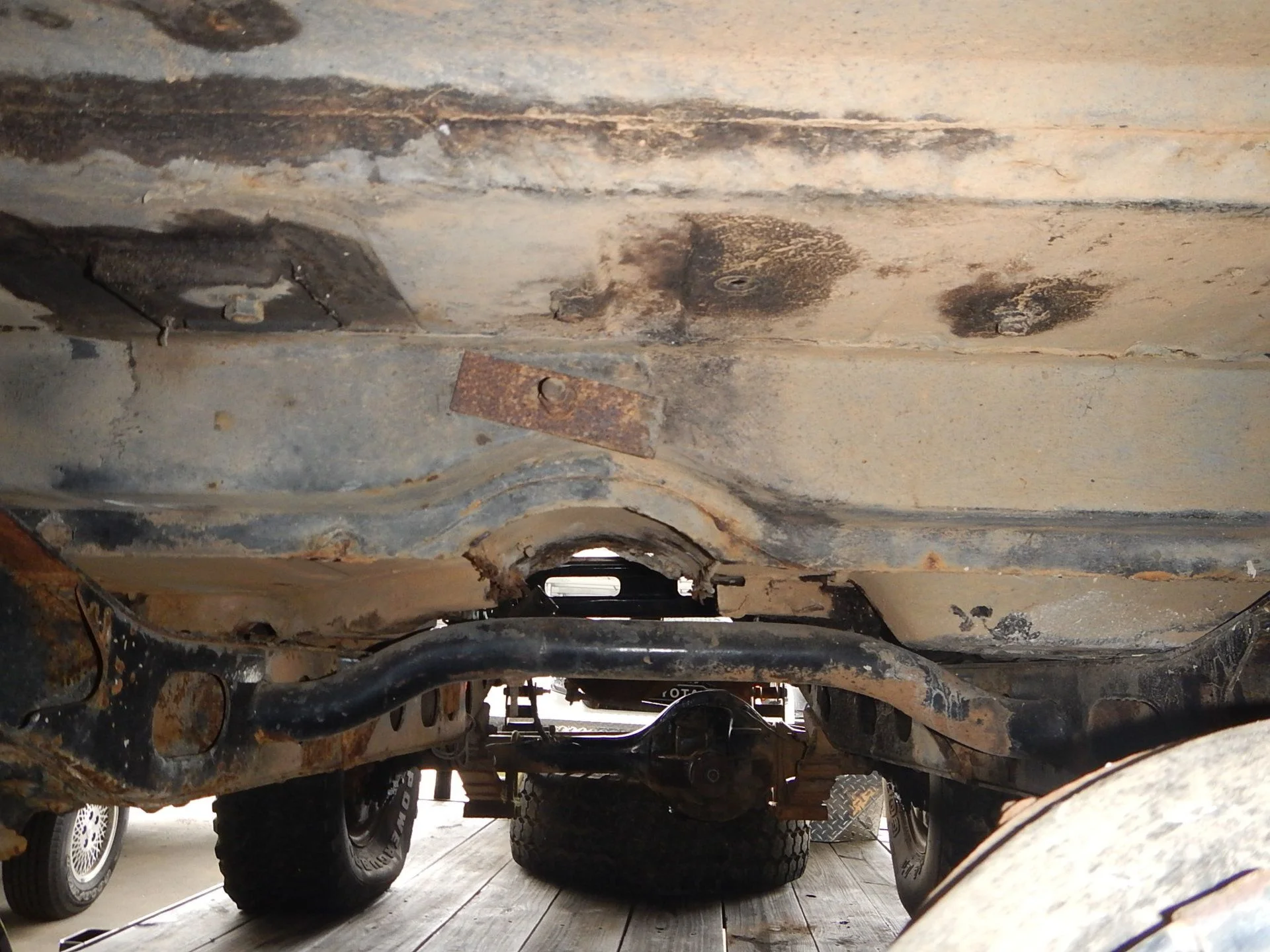

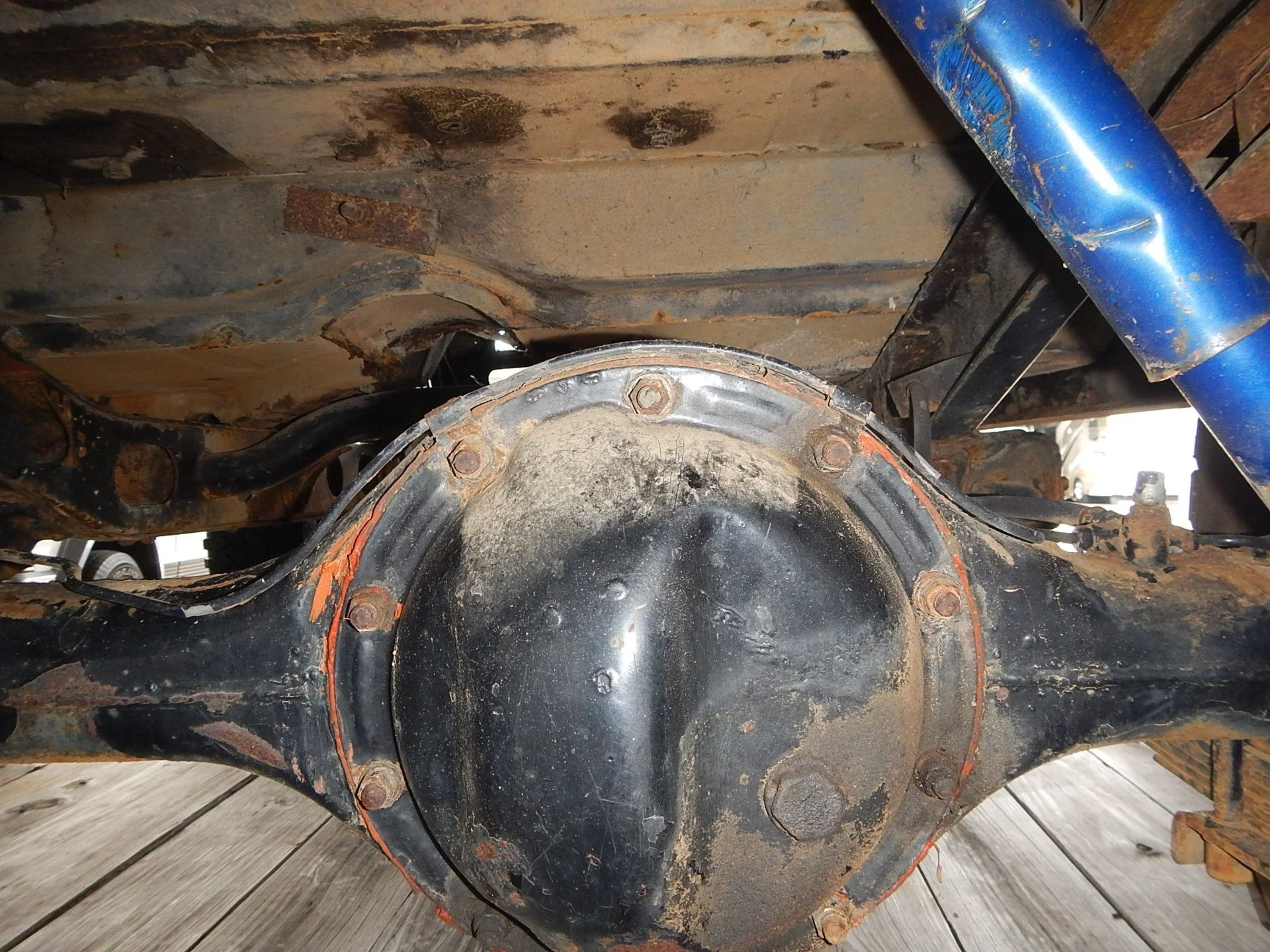

undercarriage
steering arms
not much to work with, but its like a good start

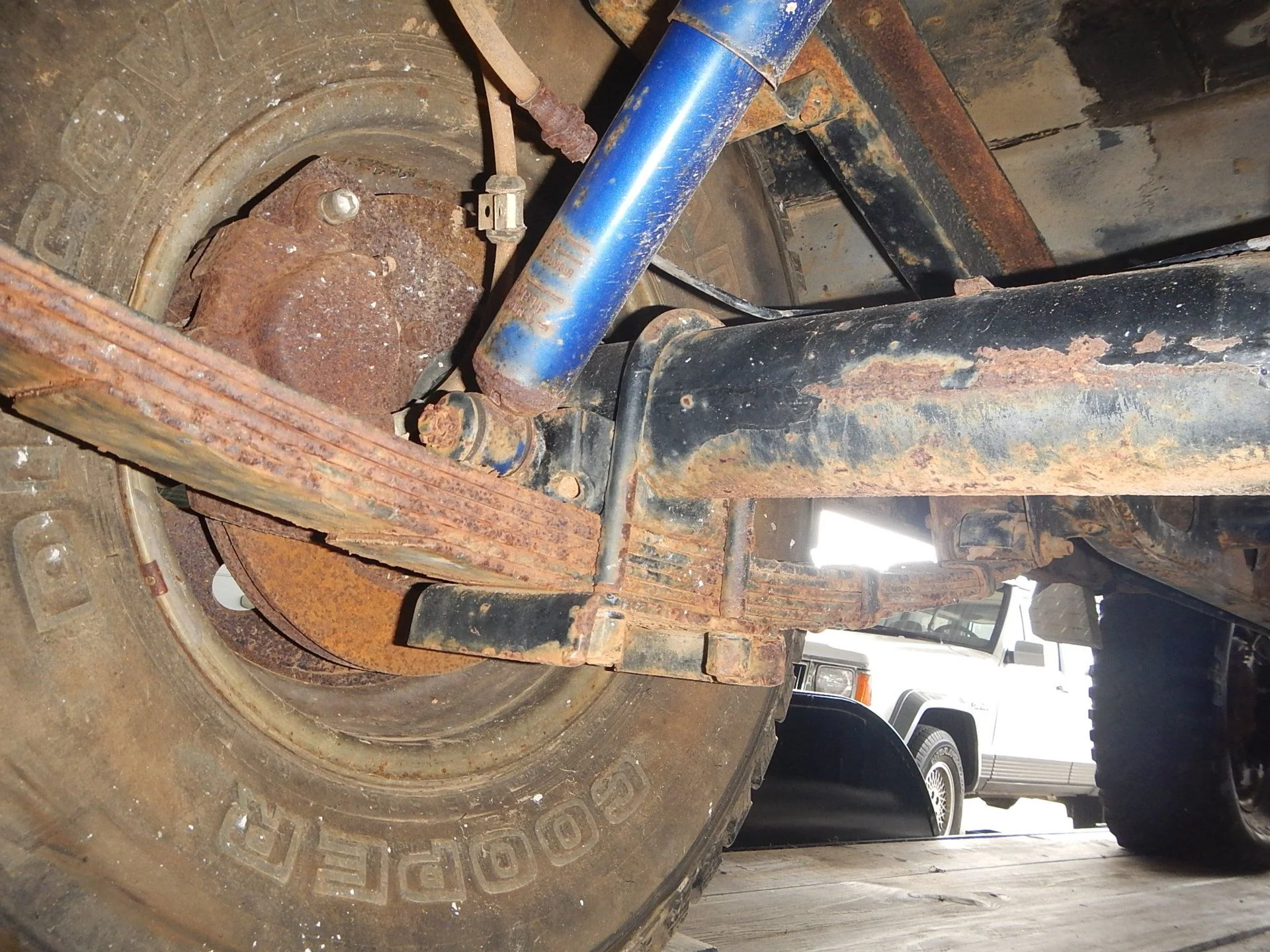

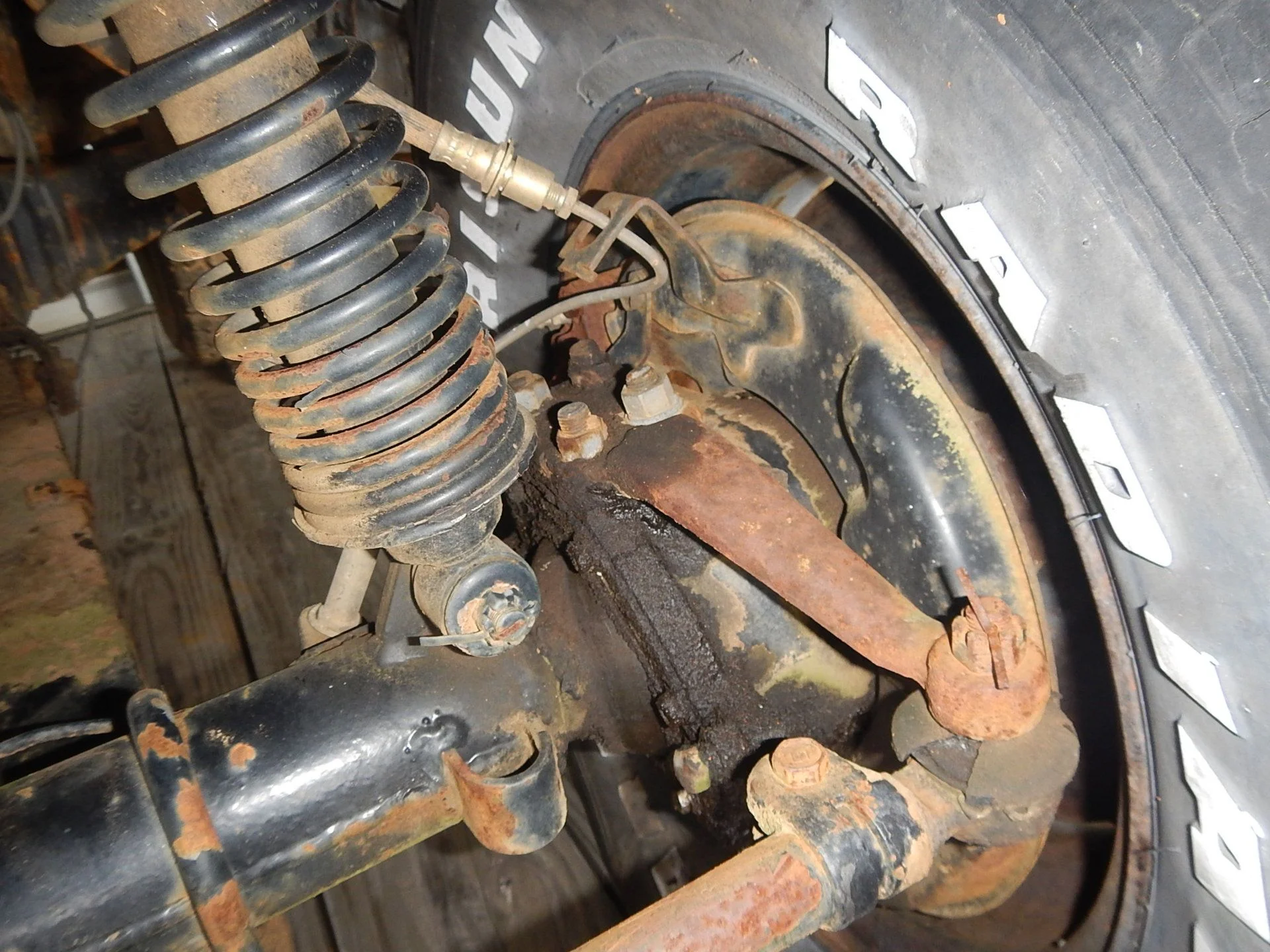

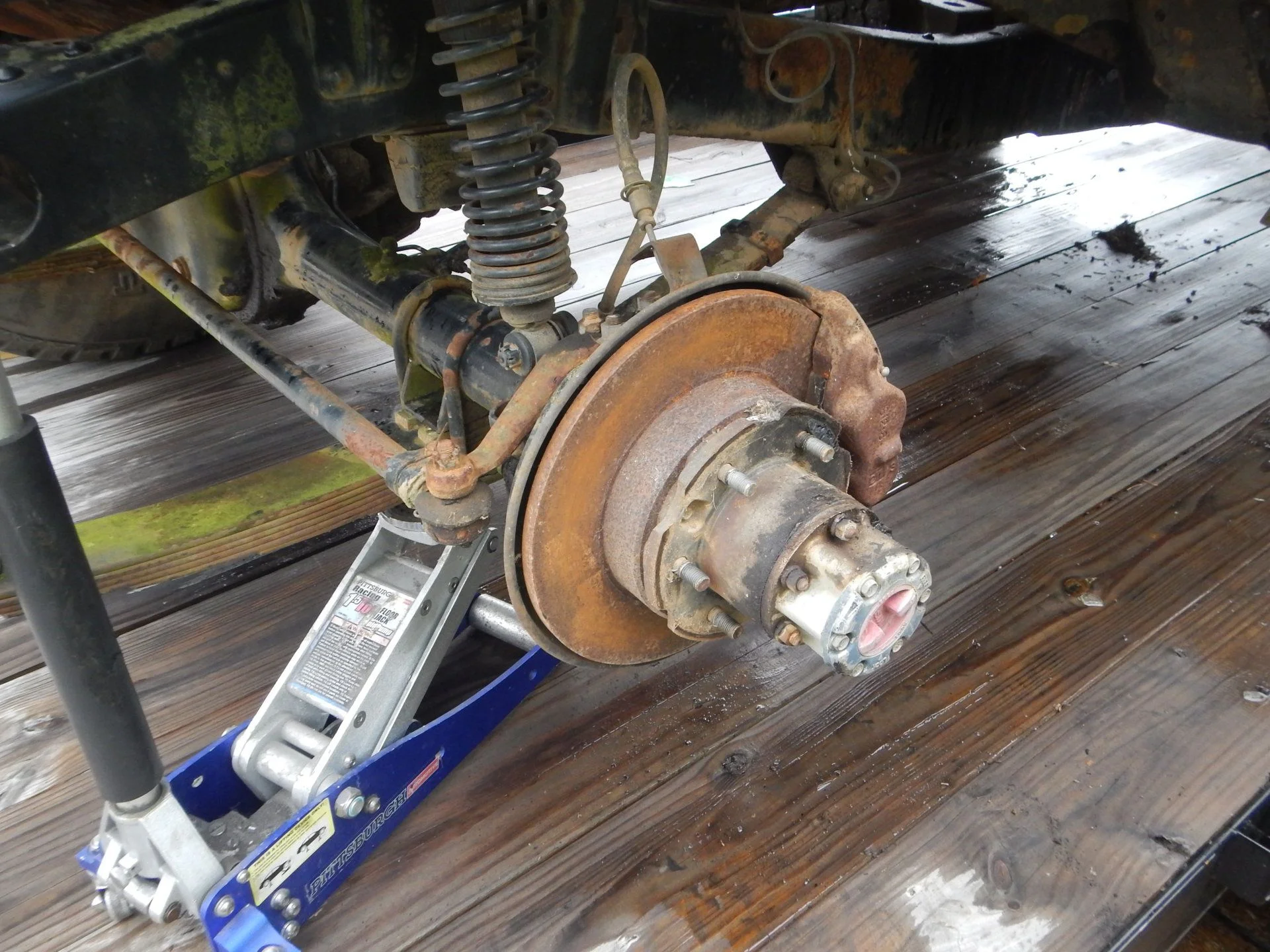

i wonder why there is a coilover setup with the fj when there are still leaf springs. Comfort?
and looking closer the rear discs are vented, and the front discs are solid....

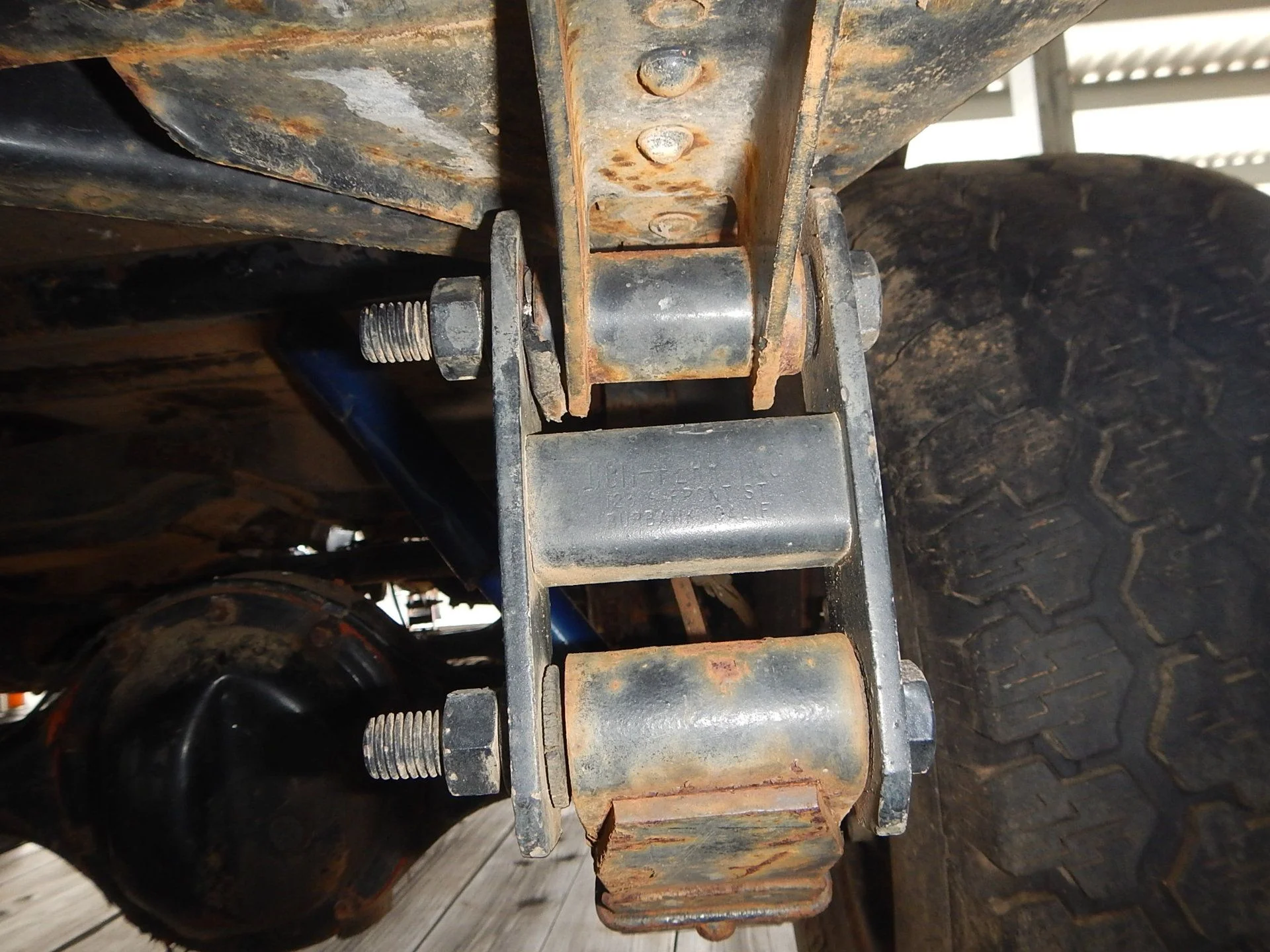

The coilovers are to support the worn leaf springs sagging or just give a stiffer ride. Ditch those. Non vented front discs are likely due to a mini truck front front disc conversion using early toyota mini truck non vented discs. Rear discs are aftermarket kit and likely just need cleaned up. Looks like it has crappy motor mounts for a v8 swap. That is a good candidate for a v8 cruiser if you want one, or put the 6 back in. A ford 300 i6 would also be a cool swap.
thanks good, to know. I guess the first order of bussiness is to look at cleaning the frame and to clean the leaf springs and rebuild them
