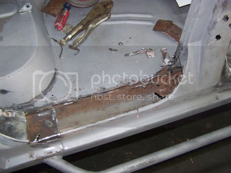

Well its been a while since I posted a progress update so i thought i'd do so today.
Most of the sheet metal work is done. The drivers rear quarter ended up have only one small area of rot and the rest was just dented in and responded nicely to heat and cold to straighten it back out. It will still need a little bondo to make the surface smooth, but shouldn't be to bad.
All four door jams ended up needing cut out to one degree or another with the passenger rear being the most extensive
But Jessi did a nice job of patching it all up
He still has a little work to finish out the sheet metal
He should finish of the sheet metal this week and will put some primer on the bare metal before my pig tries to rekindle her long standing love affair with rust
