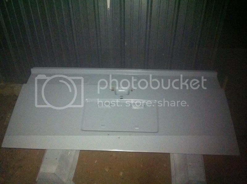

A little damage to the tailgate
Well, maybe more than a little
Tailgates done

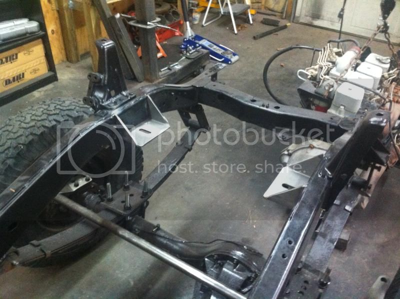

New Engine mounts are done
We repurposed the original nv4500 cross member with a provision to bolt it to the Advanced Adapter.
Crossmember mounts

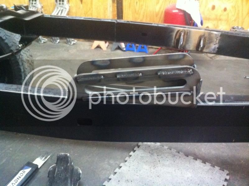

Liquid Iron Industries Leaf spring sliders to replace the shackles and try to get the pig out of the clouds
It's coming along! Looking forward to see your progress. Those sliders go on both the front and back springs, right?
Yes Ron, I'm replacing all 4 shackles
For NV4500 mount, are you using stock NV4500 bushing?
No, he said he was going to have to fabricate a new bushing for where the crossmember will attach to the adapter
I don't know if he tried to connect the crossmember directly to the adapter to be honest. I called Advanced adapters and let them know what we were trying to do, and they said we would need to fabricate a piece to go between the crossmember and the adapter and he was going to then make a custom bushing to go between this piece and the advanced adapter. It's entirely possible we made this more complicated than it needed to be.

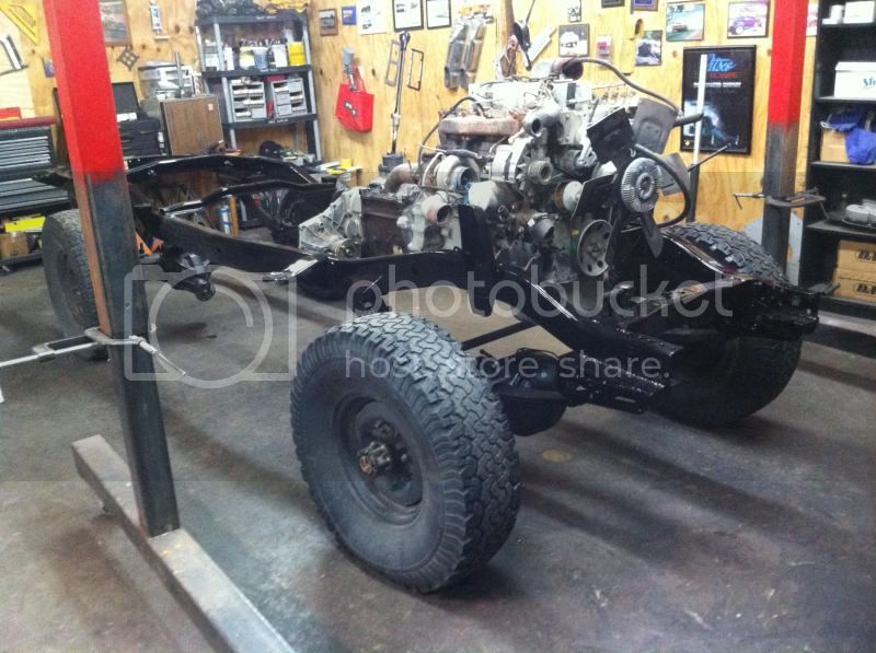

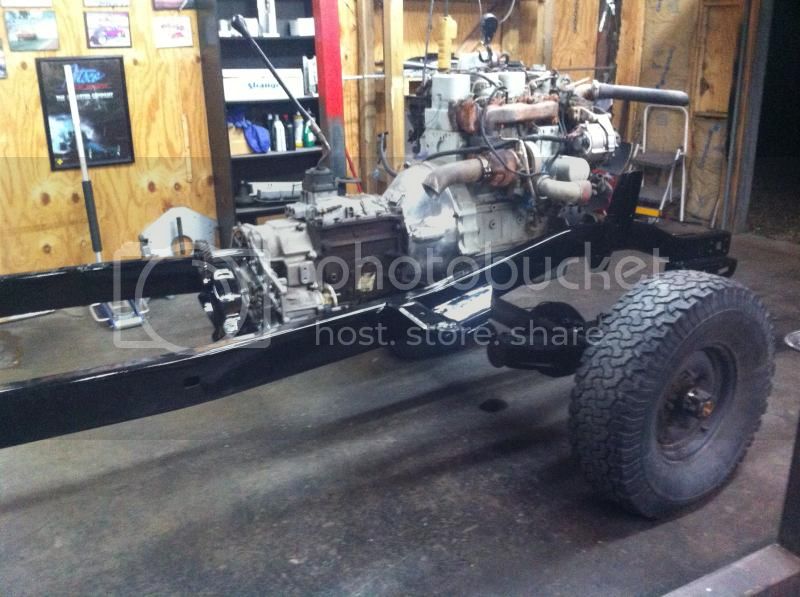

Made a bit of progress. Suspension is done (for now) and the engine, transmission and TCase are bolted up. I'm now at 25.5" to the bottom of the frame rail. A definite improvement and once everything else is added, I should be below 25". Still a big step up, but I'll see how it works. If i'm still too high, I may have to take out my add a leaf and see how she rides with just stock springs.
