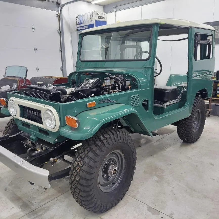

My Dad and I are currently neck deep in a frame off, nut and bolt resto mod of a 1972 FJ40 that we rescued off of a hillside in WV.
Removing SBC conversion, going back to Toyota. 1972 Frame Off
It is currently at the painters and I have had a chance to think about the next project plan for a few minutes.

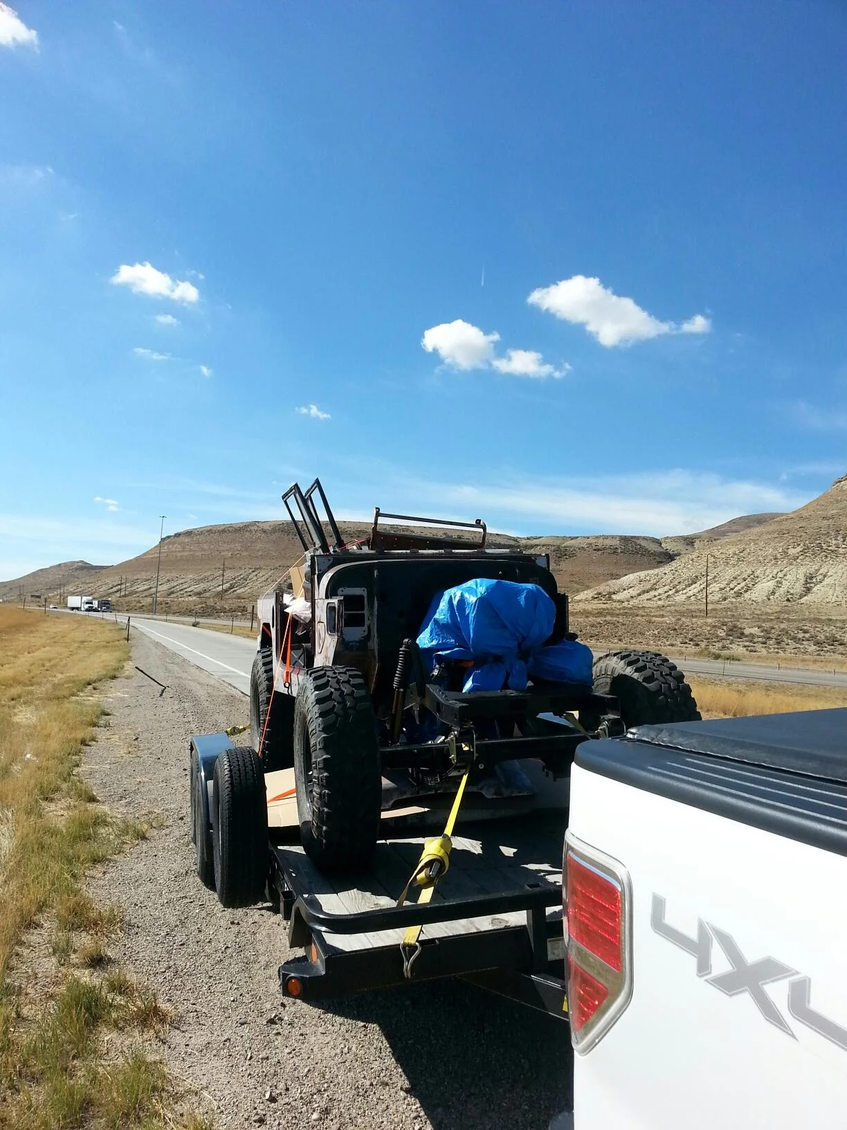

I casually mentioned this to my dad and before we could come to our senses, he was on his way to WY with the trailer.

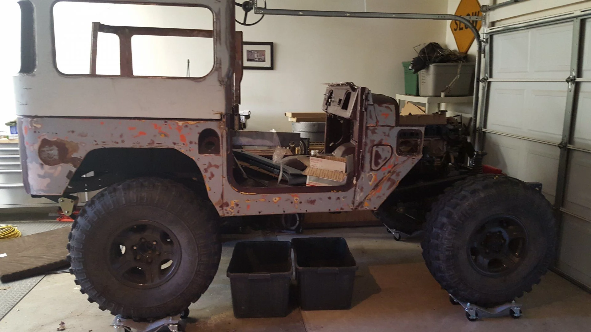

@reevesci had completed 2F/H42/split case, power steering and front disc conversions from a late FJ60. Also, he installed 36x17 Super Swampers on 80 rims, large diameter spring/shackle hangers and a 4" rough country lift.
As it sits now:
Plan of attack (probably this coming fall) is to use as many of the parts that we have on hand to make a capable wheeler that is streetable:

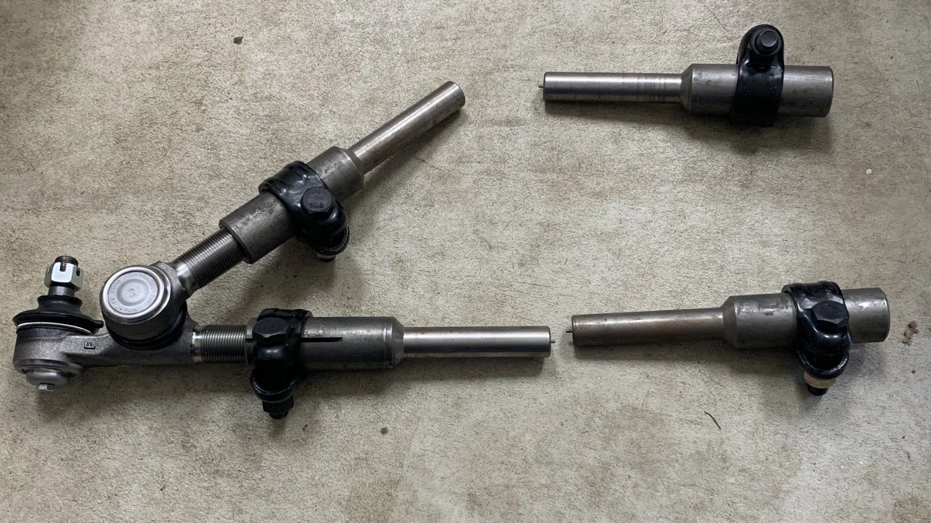

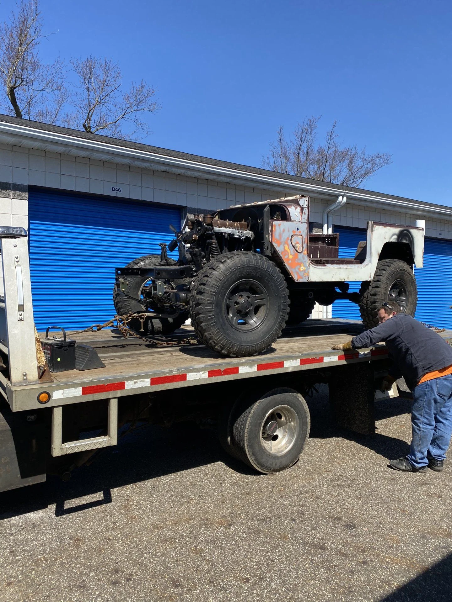

Tank has emerged from storage. I am focusing on getting the steering conversion squared away and have been accumulating parts to get it fired up. The build will be slow as I’ve got the kids home from school and I am selling extra parts to fund other parts purchases.

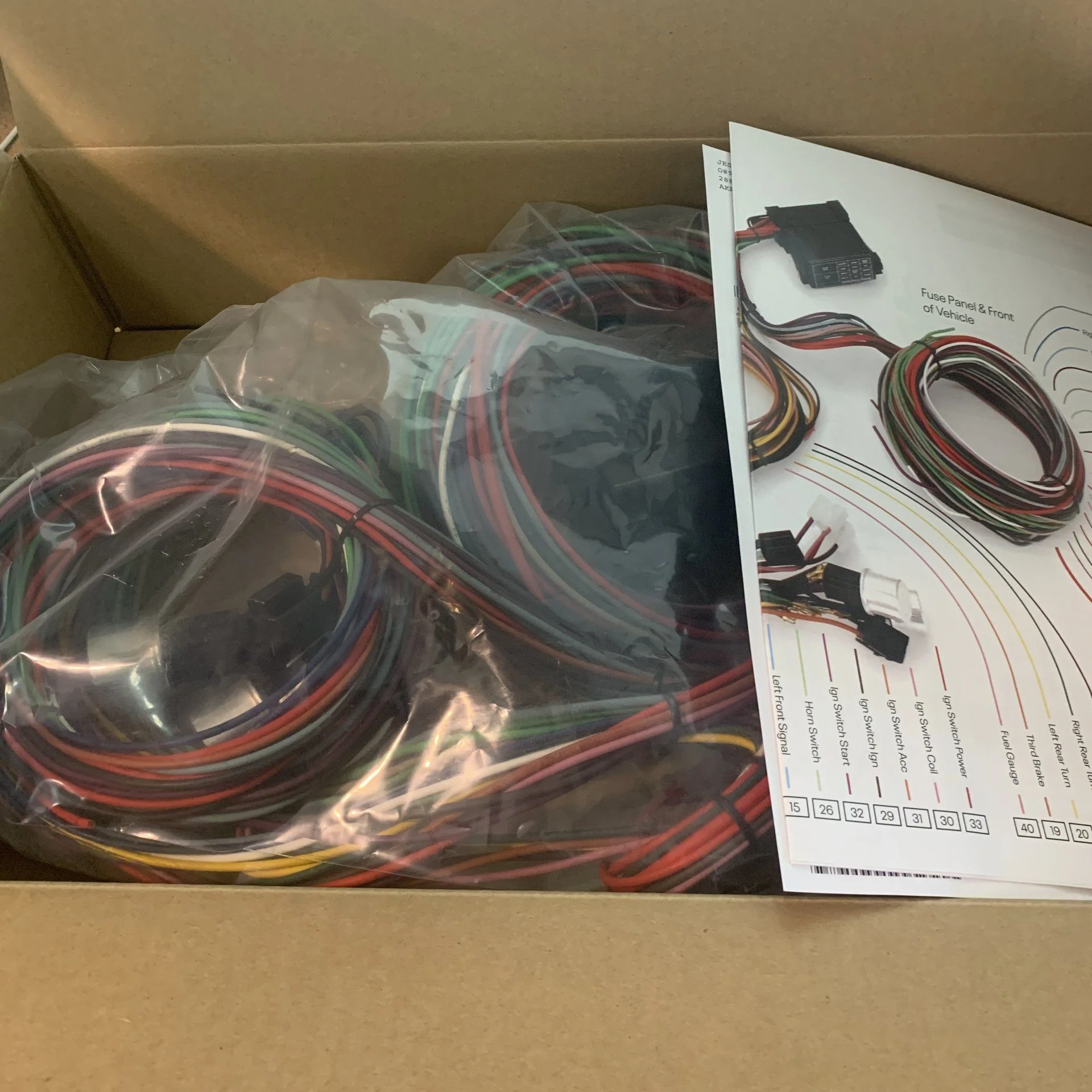

So far I’ve ordered a plastic fan, DOM, 4plus 23mm TRE inserts, Valley Hybrids Saginaw Pump kit, Summit Racing Steering column, radiator hoses and a Speedway 12 circuit mini harness.
Change of plans. My dad smoked the F in his ‘69. The 2F that I was going to use is going into his truck.

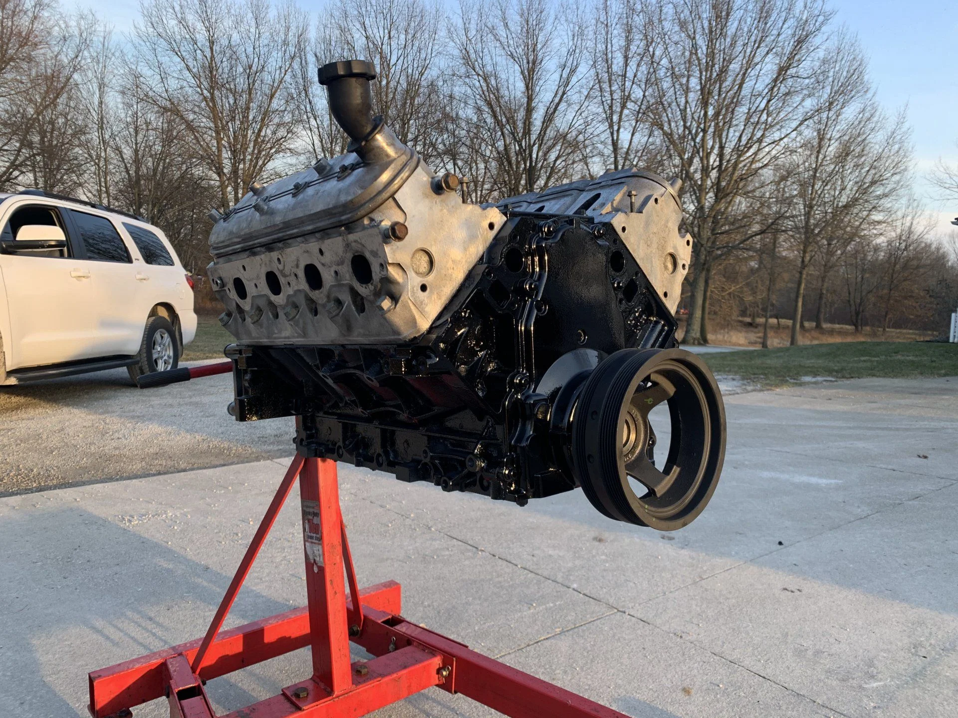

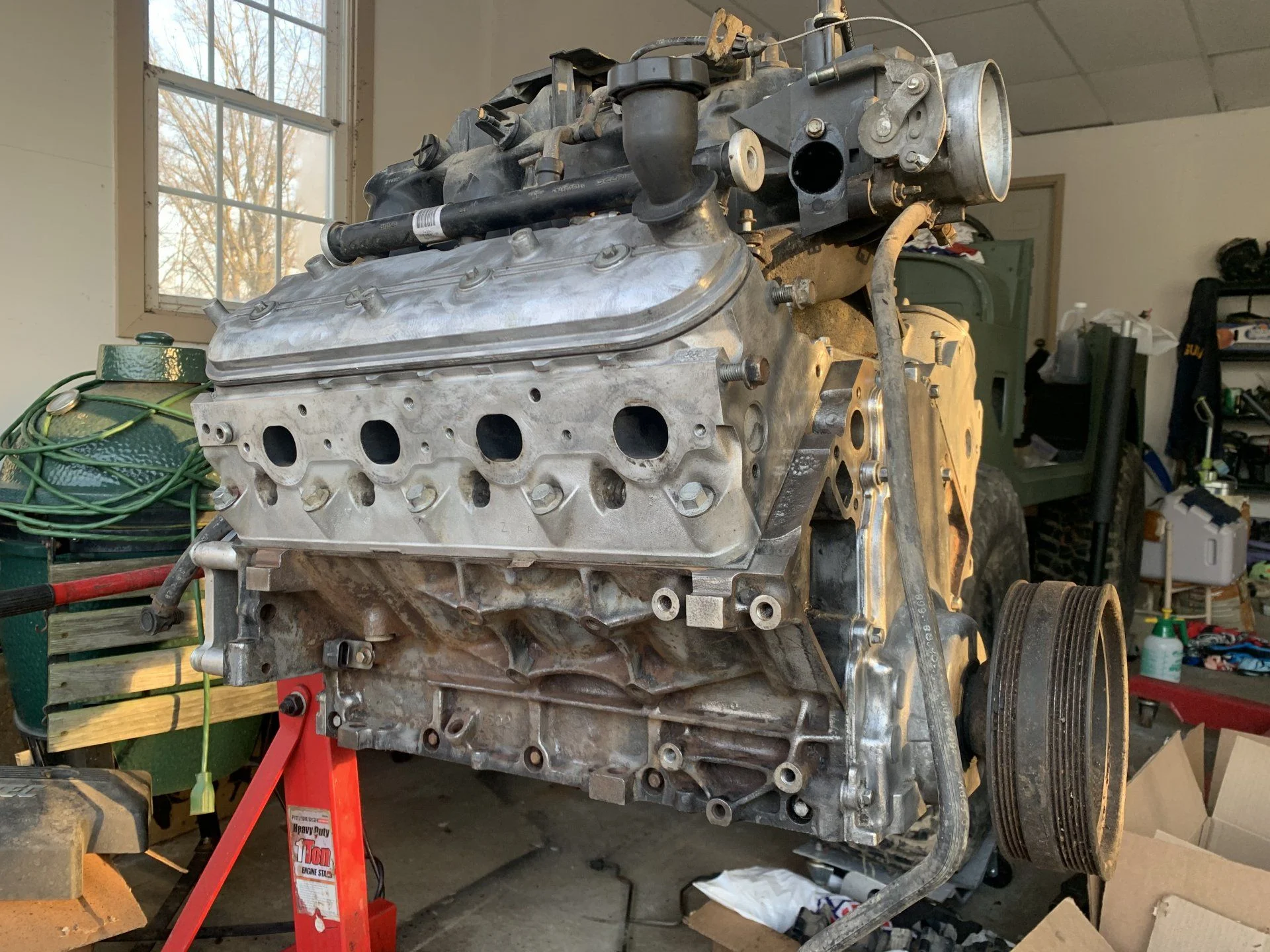

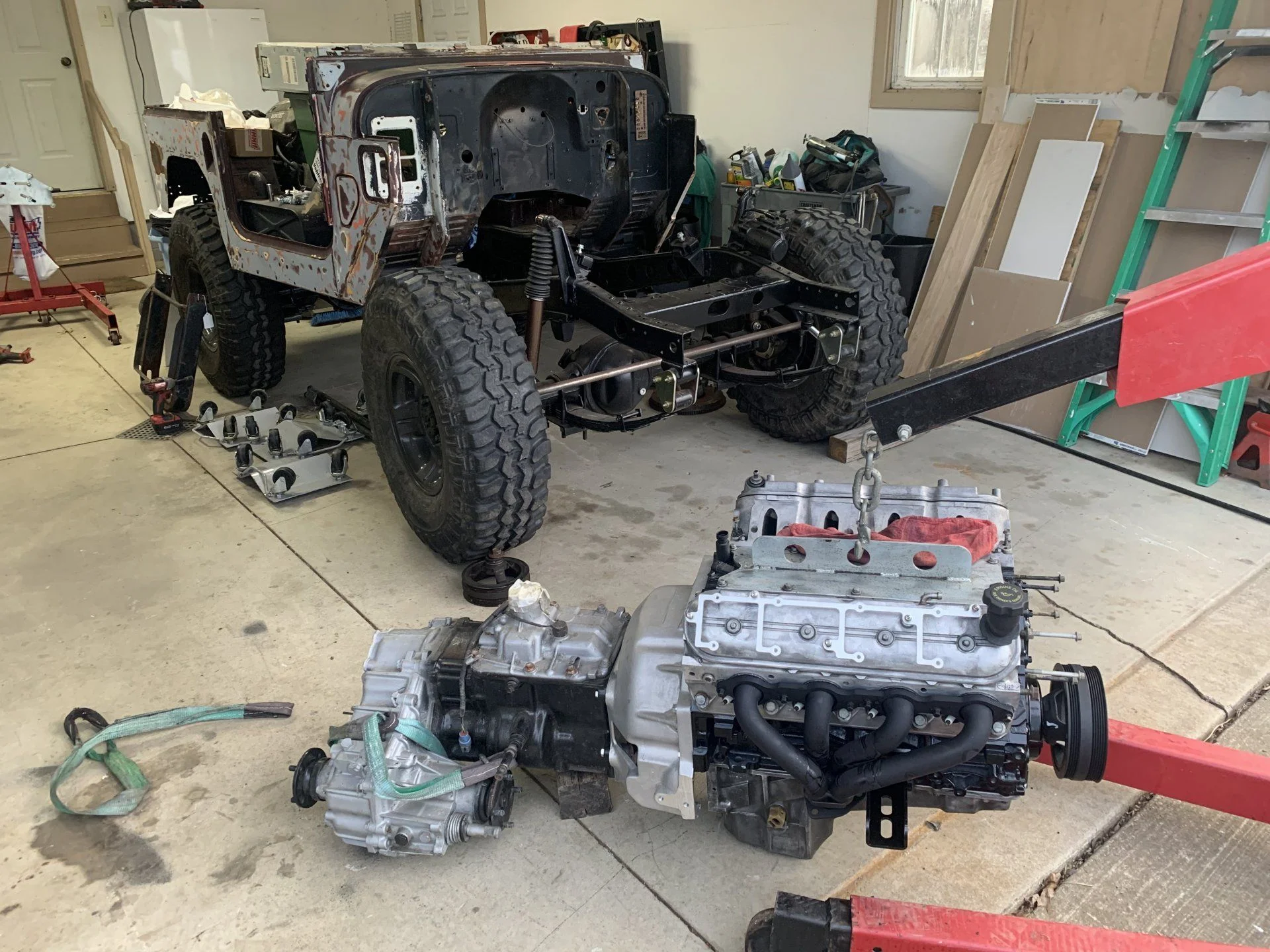

I found a 2000 5.3 to use. I’ll be mirroring @A10Driver s build and using the AA bellhousing to the split case and H42.
The Bellhousing showed up today and I am planning on using LSX innovations adjustable mounts.

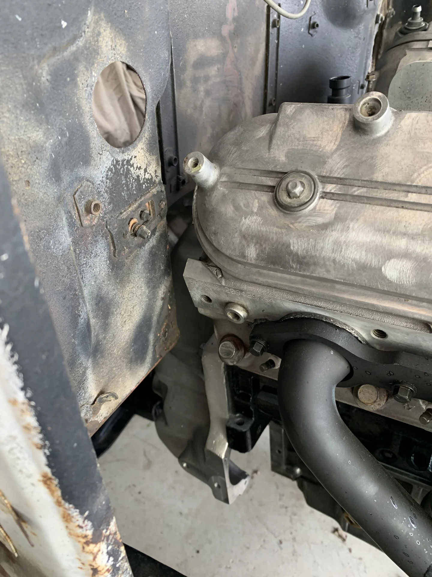

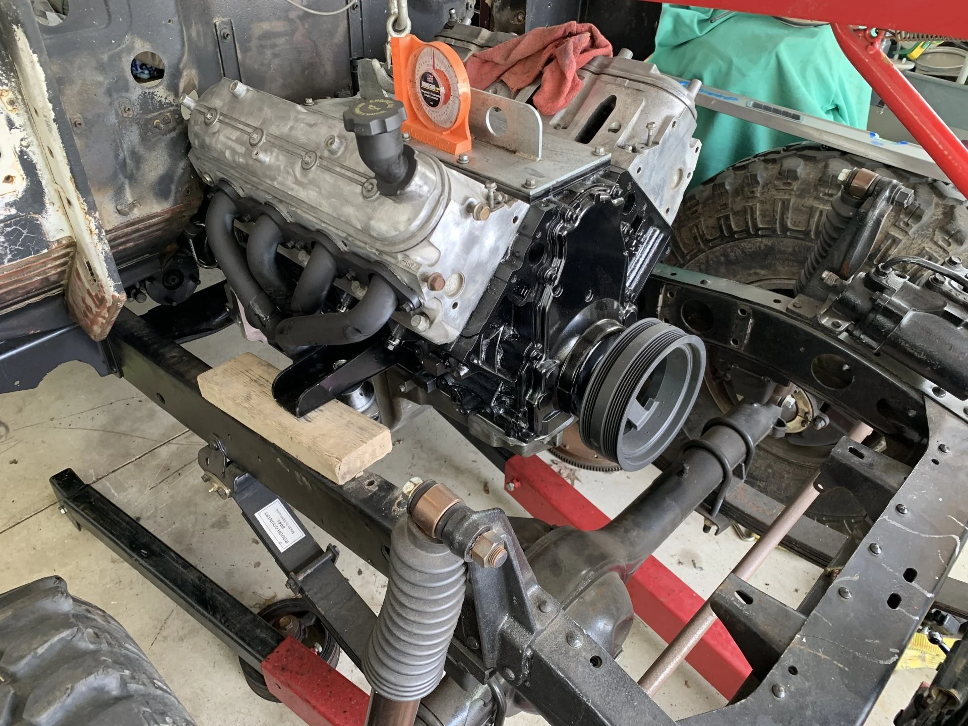

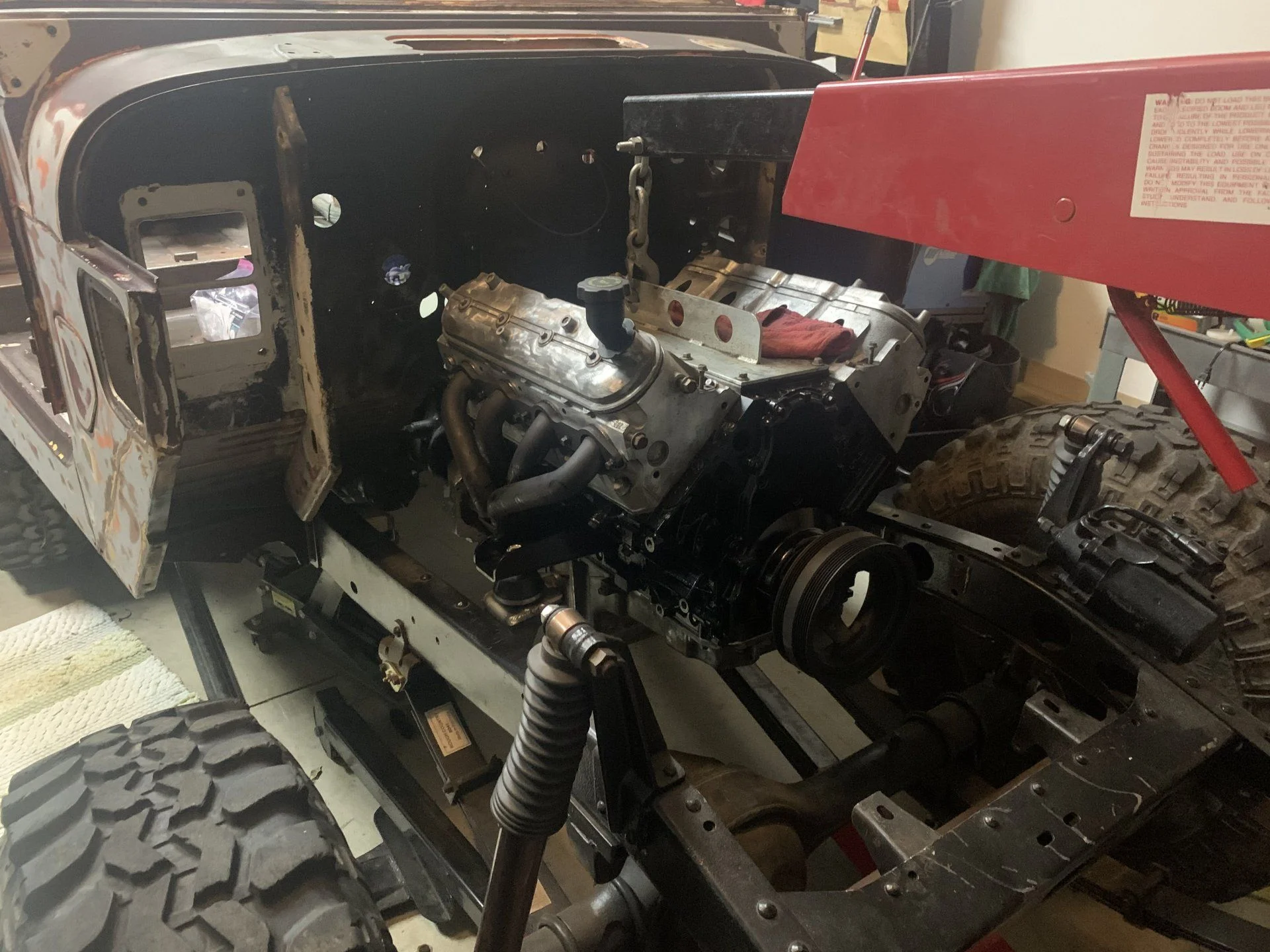

I’ve been messing around with engine placement for the past few weeks.
It’s about 12 3/4” from the front of the AA motor mounts to the rear of the shock tower. 10 1/2” from the front of the harmonic balancer to the front cross member and it’s at about 3.5* of an angle at the intake. I still need to install steering column and build the tranny crossmember.

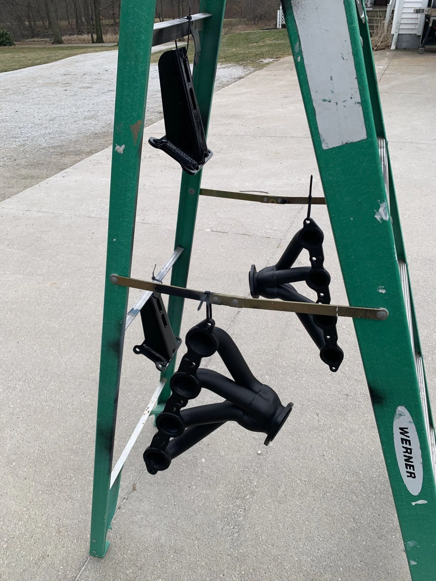

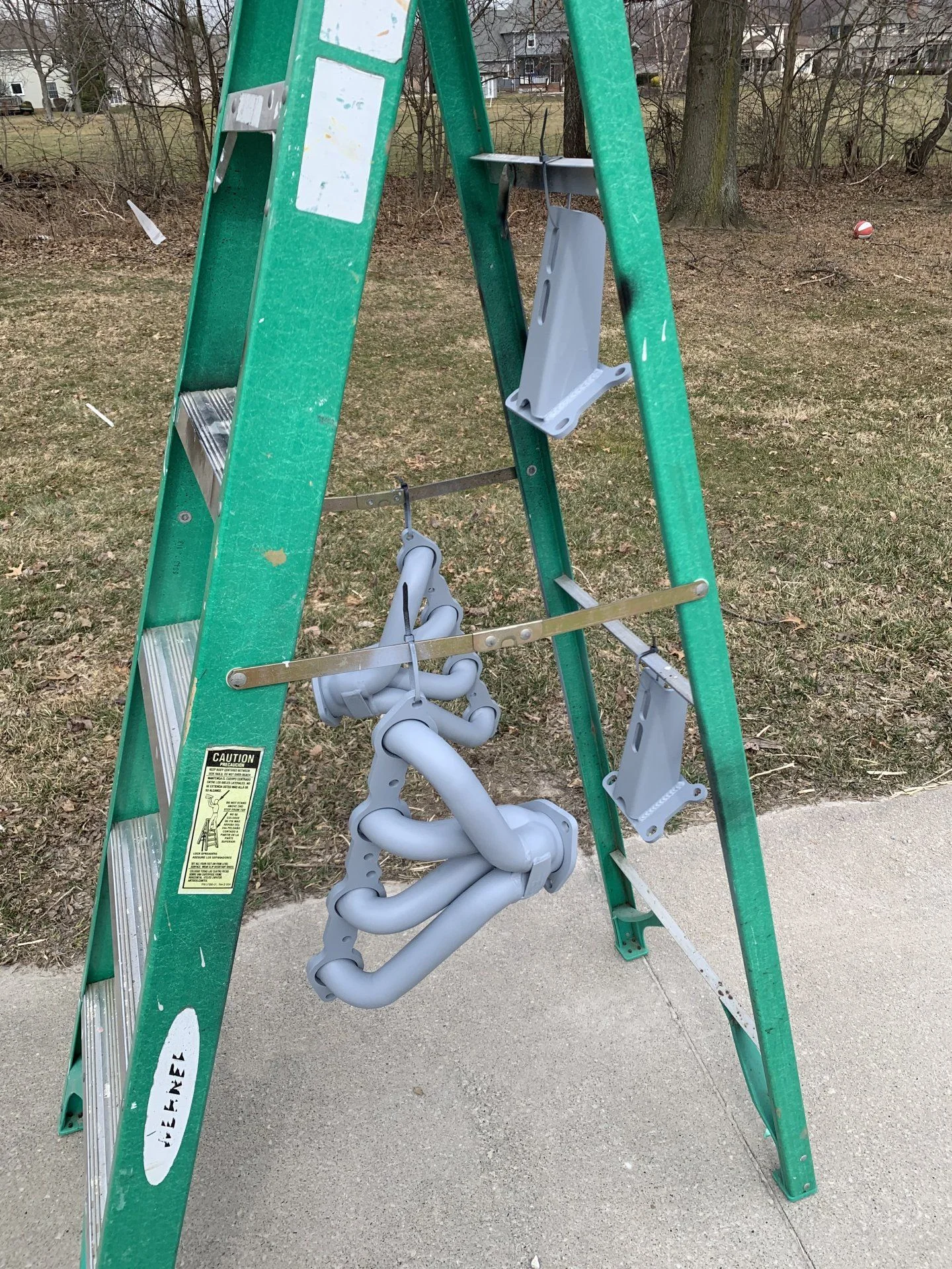

What headers do you have on your LS the ones i initially bought are so close and they are rear exit they will not clear the ears of the TH350 transmission I am running.
thanks in advance for the info...
Sanderson. @A10Driver posted them on his awesome build.

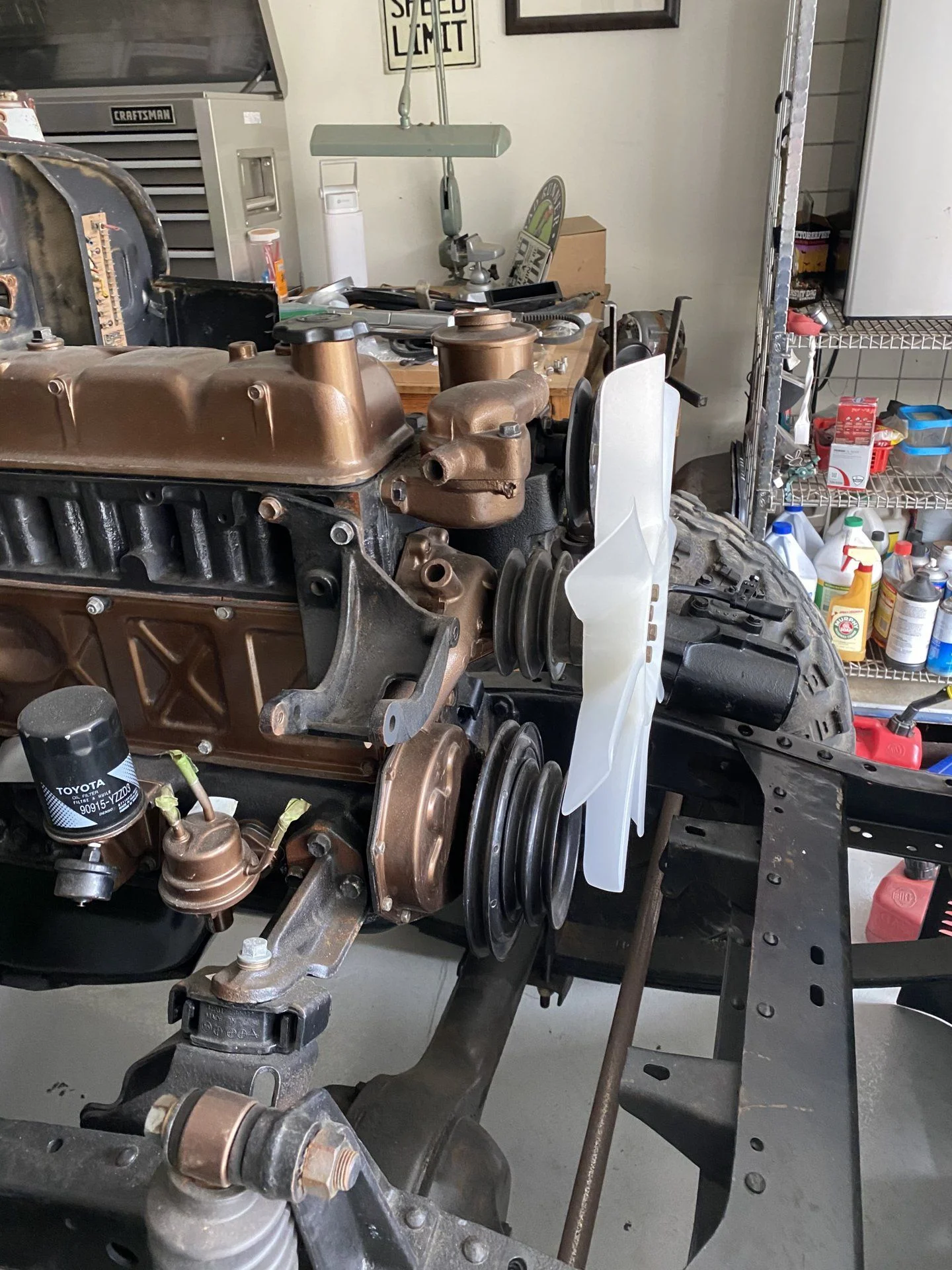

It looks pretty close to the firewall?
Typically a little farther forward gets the fan closer to the rad and allows airflow down & out the back of the engine bay.
Thanks, Jim. If i run the Holley controller, i’m considering electric fans. Thoughts?
A big clutch fan trying to cool a V8 rolling on 36" tires draws 5hp. At 785watts/HP, it would take 3.9KW (300A @12V) to match that.
It's inefficient to use electricity to move air when there is a 250hp fan directly behind the radiator.
