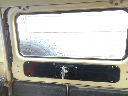

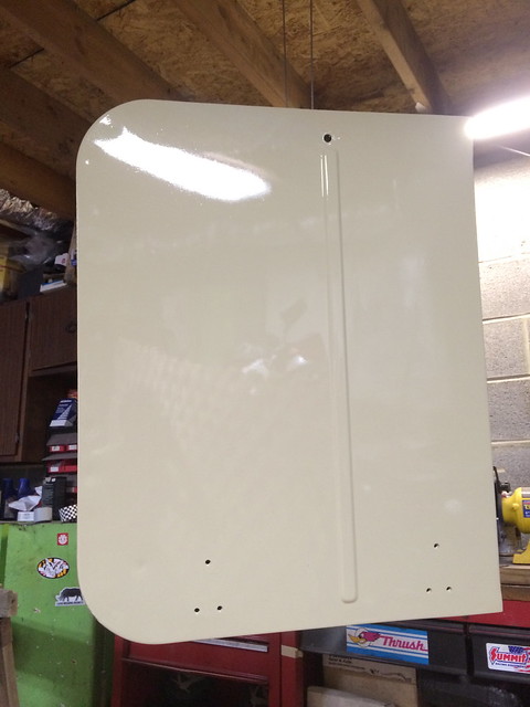

I finally found a reasonably priced rear hatch panel for my cruiser, I've been looking for 3 years and I was able to get one for $36 in decent condition, still a little high, but better than $50 I suppose. I got it cleaned up and painted and threw on old hand on it, pictures to follow...
I painted the hatch panel black to match the panels on the doors, and cluster, I am not sure if I want to take them all back to factor color or not...

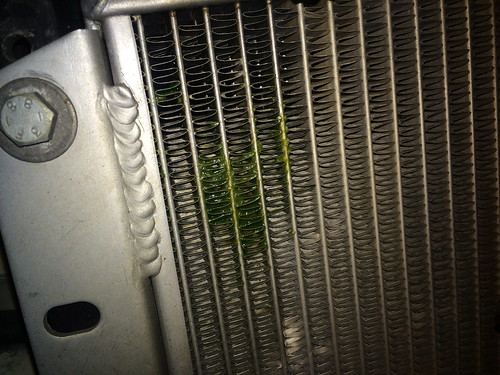

And then there is this.... it never ends.... all my plugs look good, and engine runs completely fine oil is clean so I don't think it is over pressure due to a head gasket, just a crappy ebay radiator...
The cruiser has been doing its fair share of work around the house lately...
And still doesn't overheat with this stupid leak, as long as I keep my eye on the fluid levels.
I am having almost the same problem with my radiator, I bought the same one from eBay. A pinhole somewhere on the upper driver side of it. I capped the overflow line after my alternator ate it up, shortly after is when mine started to leak.

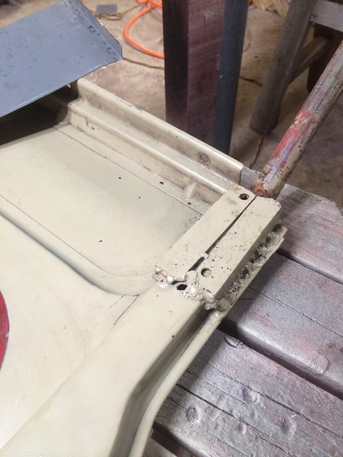

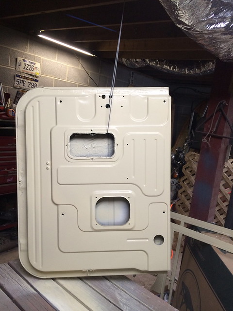

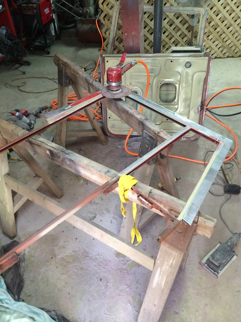

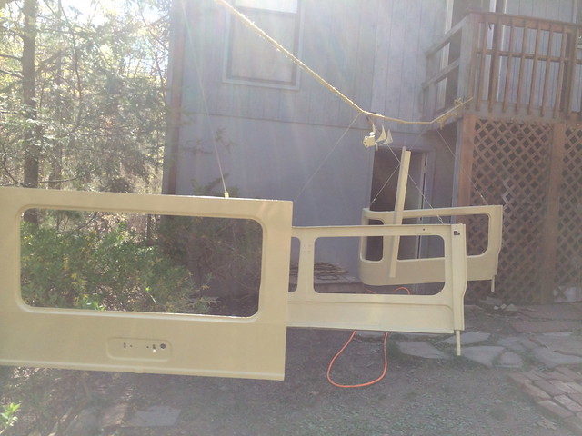

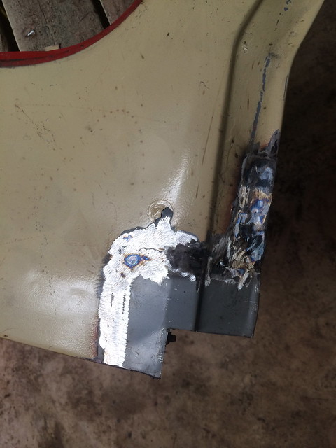

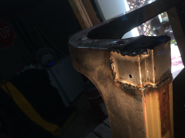

I took my doors completely apart again, new paint, weatherstripping, gaskets, and re-installed the new felts, also used a little new hardware when I had a chance... I welded on new tabs for the door stops, and for the first time in 3 years I have door stops
before
during

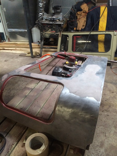

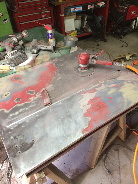

So I work on integrated electronics systems by day, and I am 27...I haven't quite gotten the patience thing down. I don't have a metal break or any real body hammers, I should have welded with .25 mig wire rather than .35 but I don't think it turned out too bad...
Also after grinding off 5lbs of Bondo, I didn't really want to put any back on, so there are obvious dents and dings that I left alone
Maybe that 5lbs of Bondo actually helped preserve the sides from rust, they were from New Hampshire after all
I apparently spent too much time with the 80grit and not the 320, there are a few spots where you can see where the die grinder was used instead of the D/A (once again, I am slowly picking up on the patience thing)
Also I am still relatively new to the Quality Welder Scene, so I haven't purchased a tank of Argon or C02/Argon mix, so I do a good bit of grinding after.
Also, I used my unique Redneck Paint-booth, it works pretty well in April, by May it attracts too many bugs!

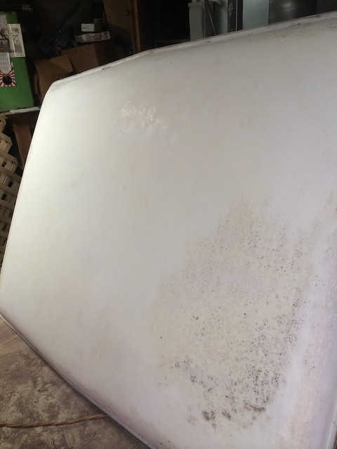

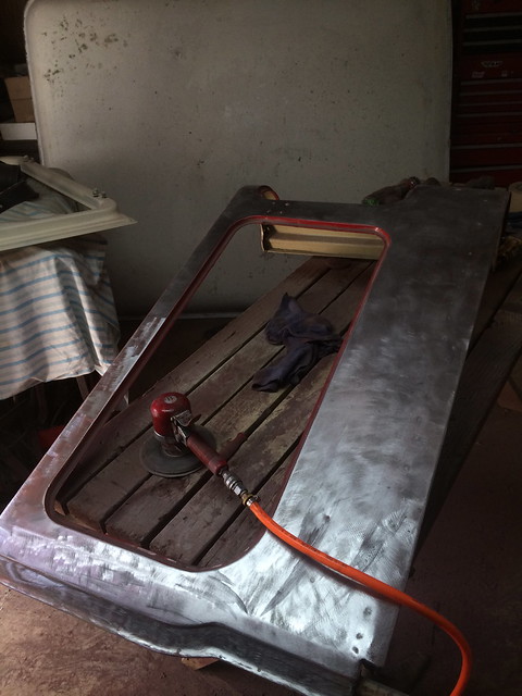

Crusty hardtop midway through the paint removal. When I redid the gutter I had a lot of trouble with this hard factory paint. I some how scraped it all off with a 4" metal putty knife and hit the gel coat with a little 320grit on the D/A.

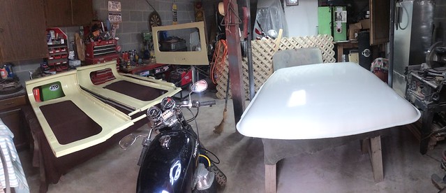

Here is a crappy pano of the workshop while I let the fresh paint setup

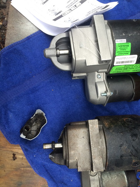

At some point during the painting progress I was driving the cruiser around topless and I heard I pretty big clunk when I tried to start it. I knew the used, remanufactured, really old starter I picked out of my dads scrap pile wouldn't last too long.

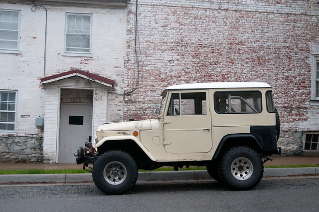

So after all of the intense painting and sanding and grinding this past few weeks I was able to get a few shots out and about

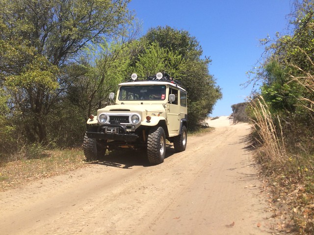

I went down to the Outer Banks, NC this weekend for a half marathon, camping, and beach driving! It was a blast, I had a great time cruising on the beach. I saw a super clean FJ45 on the way to the beach, same color as my FJ40, it was pretty cool!!
Driving on some trails/roads off of beach road, I finally saw the F$#@ing wild horses after years of driving the outer banks.

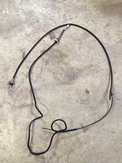

I stopped for gas on my 6 hour highway journey to the beach and pulling out of the gas station I had no power brakes or power steering, the engine ran well though. I immediately thought I don't have hydroboost, these are two separate systems, what is wrong? How are these two systems tied together? I don't get it... When I pulled over and lifted to the hood, this is what I found.
The two systems were literally tied together with my Speedo cable, it had pulled the vacuum line off the booster and bound up the steering shaft. After I cut it off I was able to resume my journey.
Here is the unusable Speedometer cable, of the two I have purchased in 3 years, this one was in better shape. I had to weld the cable core together after it snapped, but it was working mildy-decent for the past year. Now I welded the other cable core back together and taped over the burn spots, we'll see how it holds up...

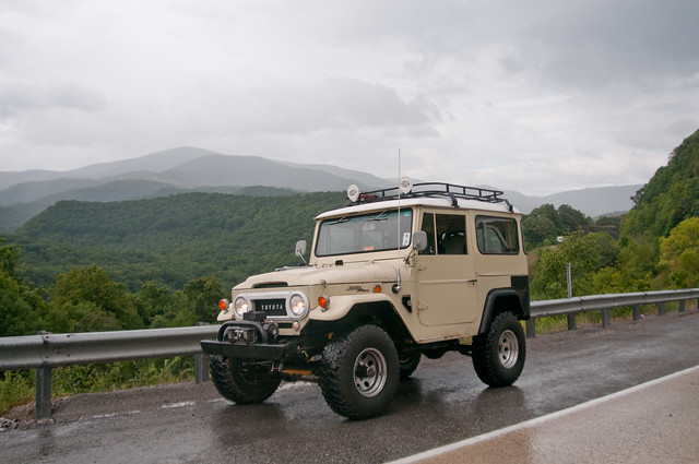

Tonights Trail ride to the top of the mountain (crappy iphone HDR picture)

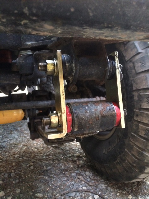

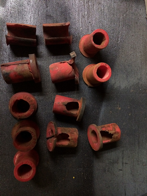

replaced spring bushings (ordered greasable shackles and shackle bushings and spring pins)

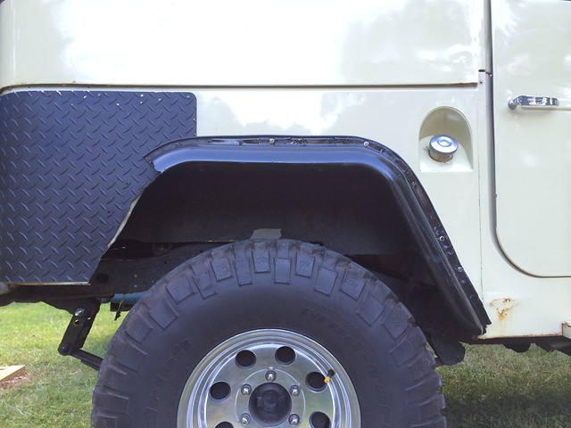

In this image you can also see something is wrong with the fender flare...it may or may not have ripped off on the interstate and gotten hit by an 18-wheeler and then have some cheap fiberglass repairs.

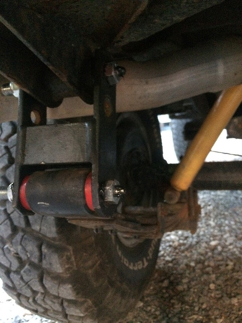

Here is a better look at the extended shackles, which I picked up when I bought the front Disc axle and the new bushings top and bottom (top in black), as well as, greasable shackle pins.
Here are a few of the bushings:
The Front have stock length shackles with greasable pins and all new bushings.

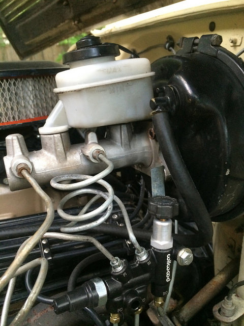

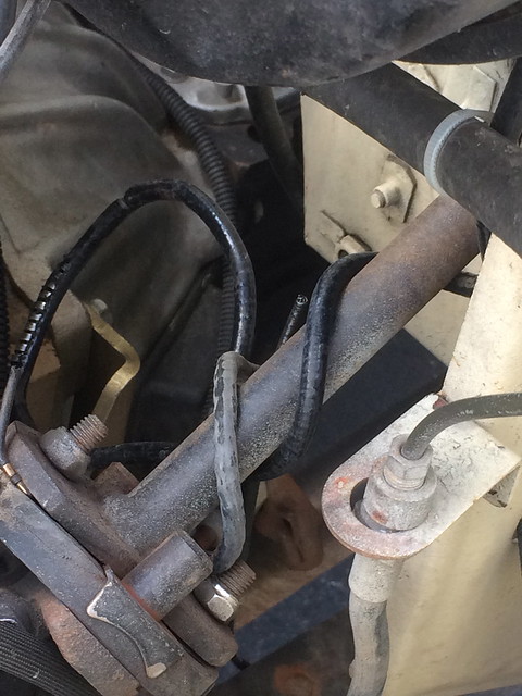

I added a Willwood adjustable proportioning valve and now I need to redo the coils in the brake lines.

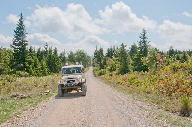

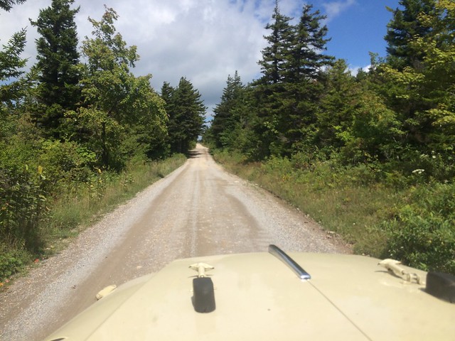

Rusty taking a break in Dolly Sods
WV mountains
This is a typical view on my landcruiser trips

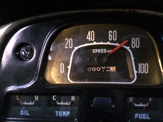

I finally got a new shift plate to match my current set up, and I also spent the cash and purchased the new Dakota Digital Instrument cluster. I know some people are against all this technology in a 60's cruiser, but I must say that for the first time I have a working speedo and engine instruments.... I have 3 clusters in the basement and they are all a mess!!! (see earlier posts :bang::bang::bang::bang::censor::censor::censor::steer:)
The install was pretty easy, I mounted the main unit in the glove box up out of the way. There is a CAT-V cable that runs to the cluster to power it. It uses the OEM fuel sender, and they provide a water temp, speedo, and oil press sender for their unit!
I am pretty happy with this thing! way better than:
