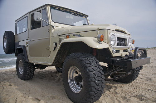

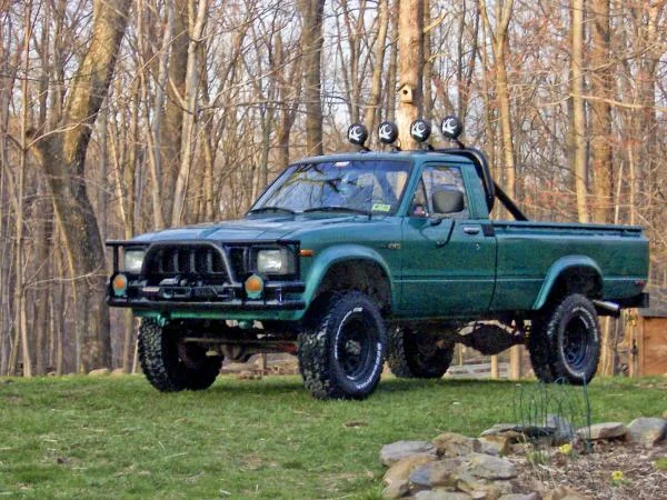

My first vehicle was an '82 Toyota truck with a 20R and 5-speed...so I guess that started my Toyota Appreciation. Here is a somewhat recent picture of my 1968 FJ40 Toyota Landcruiser.
I have wanted an FJ40 ever since I was introduced to them while working on the '82 pickup in high school. When I purchased this one, I was really excited to find one in relatively decent condition, and somewhat original. I wanted to keep it all original, and repair all the original Toyota parts. I Think the '76 is a perfect year for me (considering all the features); however, I like the look of the older FJ40s and I like the fact that this one seemed to be in good condition as far as metal (body and frame) went. Several factors have influenced me to make the modifications and decisions that I have over the past few years. Over all, I am very happy with the readability and reliability that I currently have.
From The Begining::cheers:
I never started a build page when I first joined the thread....as with anything it got put off.... So here we go:
After crashing my '05 Subaru Wrx STi and realizing I needed another project, I finally decided I wanted an FJ40 and I knew with all the rust on my old '82 toyota pickup truck I wanted to make sure the frame wouldn't rust in half after I bought it. I got in a hurry and over payed for a 1968 FJ40 in Tennessee.
I made the purchase in Febuary of 2011 and it has been a non-stop project since then...

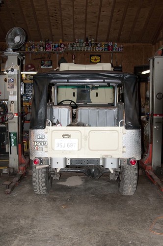

a kaymar rear bumper that was nice but had no tire carrier and was wired wrong (trying to convert to 3 color lights)
I flat towed the FJ40 home because it was in no condition to be driven, they brakes were all messed up and it would have been cold with half doors:

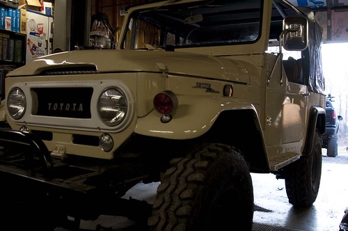

Here is what it originally looked like:
So I quickly started searching for a hard top and full doors. I also got a new single circuit master cylinder but then just switched it out with a dual circuit when I picked one up with the hard top!

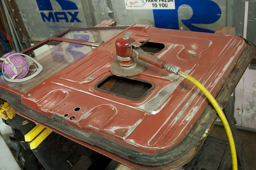

I started to work on the doors right off the bat... it was cold out by now....

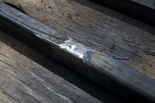

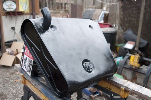

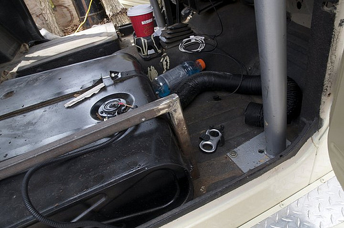

My gas tank was also leaking, one of those options you pay extra for at time of purchase....so I patched it up....

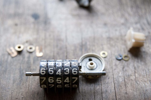

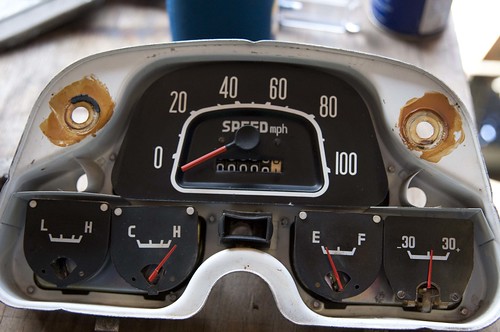

Also the speedo and fuel gauge worked but no odometer or temp or oil press....so I began to work on that....
The odometer was super crusty.......

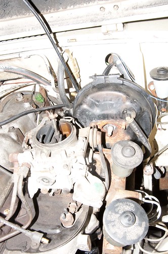

I added power brakes and a dual circuit master cylinder with a adapter from JT, it was just 1/4" steel so I figured I couldn't go wrong. I re plumbed some lines and had brakes in no time!

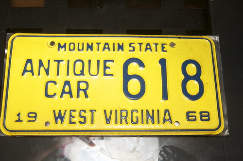

I was able to locate a pretty rad WV tag and shortly after, my dad found this one that is actually a '68 antique tag..... I love it!!!!

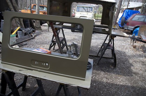

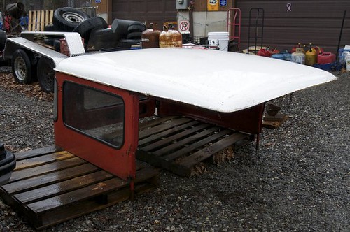

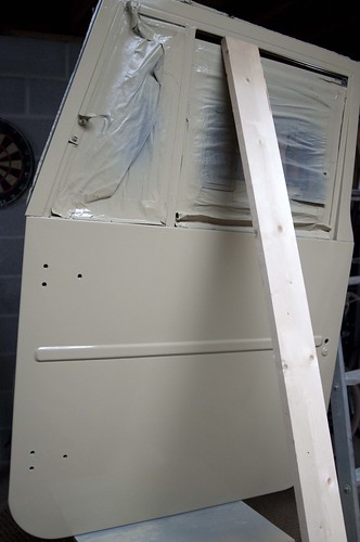

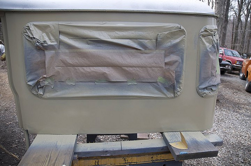

later I put time into getting the hard top prepped...it had been fixed and painted before and wasn't in the best of shape.... I had to locate a new hatch because this one was jacked up..... so I took the glass out of this and all the hard ware and added it to a better hatch I got off ebay....
Its like a 10:1 ratio of work to beer..... :cheers::cheers::cheers::beer::beer::clap::steer:

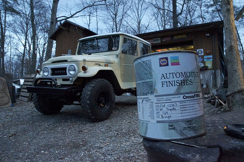

I got a NAPA paint code that took a little research and turns out didn't match my existing paint like I thought....however, it is an official toyota paint code...I'll have to look it up but I think toyota 732 or something????
464 Beige..... I was way off.......

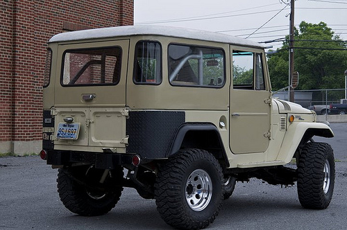

I was so happy to finally have a hard top and full doors, everything was starting to come together now!!!!

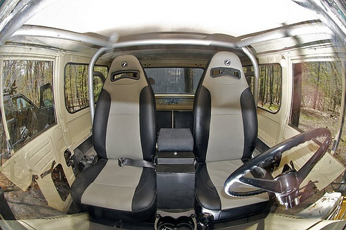

I shot a wedding to make extra cash what little profit I had after overhead went into getting new seats. I was able to find free square tubing at dads house, so I was able to weld up a frame, then just mounted the sliders as low as I could go....
Huh, theres coffee and gatorade in this pic, this must have been before I cracked open a beer
improvements

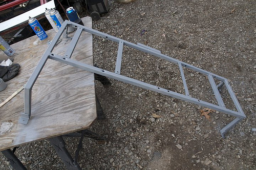

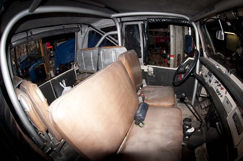

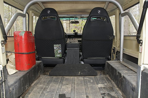

The seats finally came in and I was done building the frame....glad I chose to build it after all, for a while I was considering buying a kit from someone....
I got the smittybuilt lockable center console... I love it it has cup holders and a CD player mounted in its own little compartment.... fit was perfect....
Much better than what I had before...

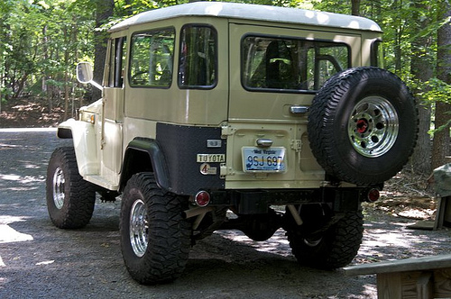

I got 5 so I had one for a spare, but I had to locate an older model factory tire carrier that wasn't 15billion dollars.....
a buddy gave me a free BFG all terrain 33x10.50 for the spare....it fit perfect.
I also painted the bumperettes and the diamond plating black so it didn't look as bad....with the two-tone going on because of my miss-matched paint I tried to keep all the colors choices to a minimum....

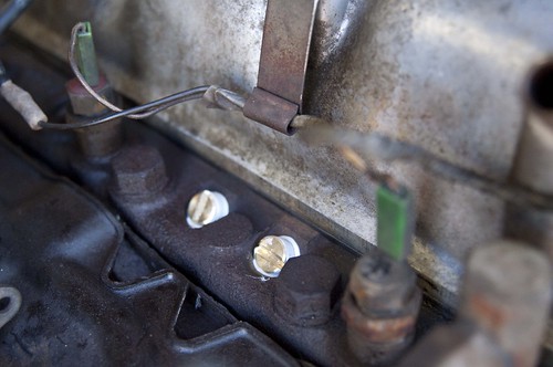

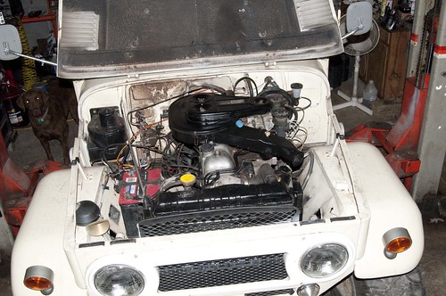

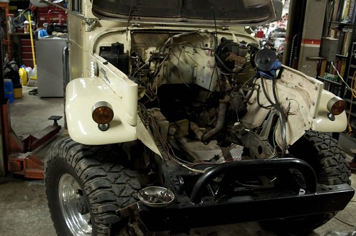

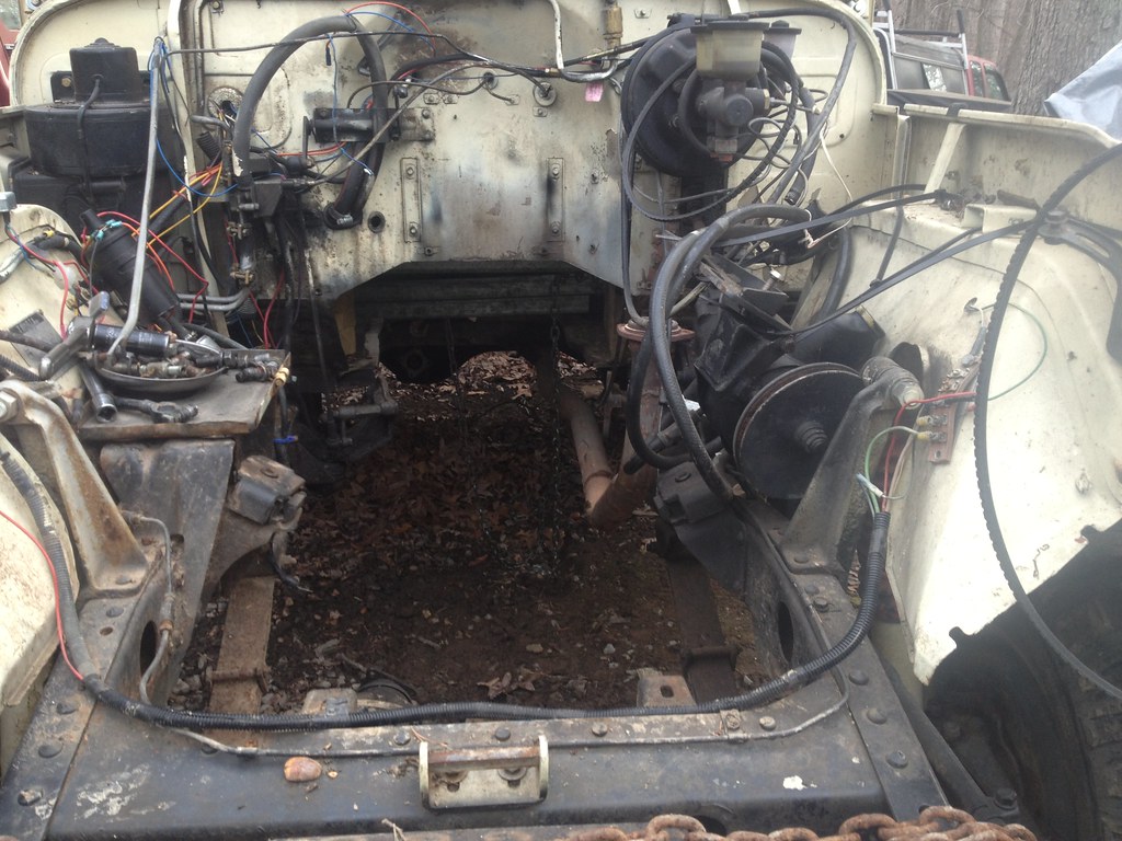

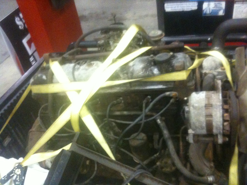

And then it happened....my old F135 engine started to make a crazy hissing sound and had a misfire...I looked into it and noticed a lot of blow by and oil spraying out of everything.... so instead of spend money on this older engine, why not locate a newer 2F that I could get more parts for and more power out of...
The 2F on the ride home after a long day of checking it out then pulling it!!! Can't wait to clean everything up and clear out some of the emissions stuff that is still half bolted on:

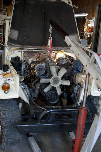

Heres the original engine finally out....
Heres the new engine I picked up from FJ40MATT, we listened to it run and then pulled it out.....I only had to drive to NJ for this one.... it was from a '76 so I figured it would be good enough!!!

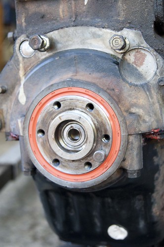

I put in a new rear main seal and removed all of the remaining smog stuff since the air pump had long been disconnected and several parts were missing..
Almost in....this involved a lot of adjusting and adapting things...

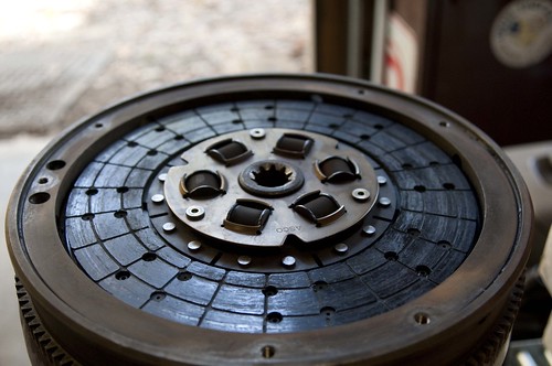

The clutch looked fine!

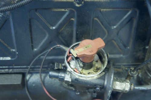

I also went with my original 1F dizzy since I had de smogged stuff and it was an aftermarket nice one with electronic ignition instead of points, and I could get rid of all the '76 igniterbox and diodes that somehow stopped working in theh short time it took to get it home.... Matt and I just listened to this engine run, how did the damn ignition stop working....I work on Avionics I am pretty meticulous when it comes to hooking up wiring and checking everything for correct polarity before adding voltage...
And then after much work, boom, it is in, and it is starting to look like an FJ40 again!! you can see all the oil on my firewall that the old engine was spitting out....I later took her to the car-wash and cleaned everything else off...
There were fitment issues when it came to the power-brake/dual circuit mod and the '76 double barrel carb... I eventually took a few extra brackets off and the vacuum secondary diaphragm as well as the throttle breaker or whatever that other thing was called (its been a while)....

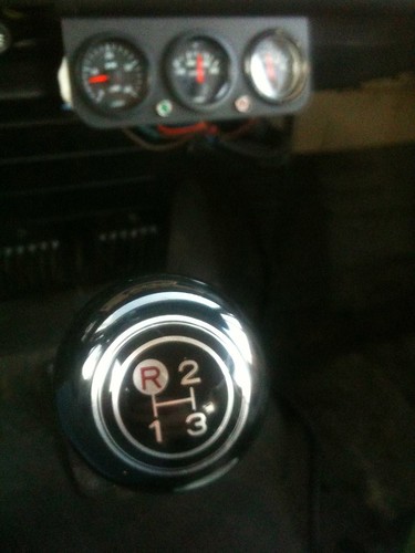

I tried to reletter all of my knobs and painted the speedo, ashtray, and glovebox door...I still need to take all of it off and paint the dash, but my windshield knobs are siezed up....
I have done alot of work to this dash, back lighting, new lightswitch, wired the wipers, wired the heater switch, new ignition switch, wired up the temp sender, replaced a speedo cable, and the obvious rebuilt the odometer... everything I look at is a birdsnest of wires from the preivous owner....
Oh hey Kevin, you have to work this weekend, I hope you're not mad we told you at the last minute possible....Driving the cruiser in was the only thing keeping me from loosing my $H1T, and I think that was b/c I have cupholders in my Smittybuilt box for coffee.....lots of coffee......
This lil cluster used to be in my old '82 pickup, so I took out the clock and added a 4K tach to it so I could keep an eye on everything....
I still need to hide the wiring a little bit, maybe get some more loom to put around them

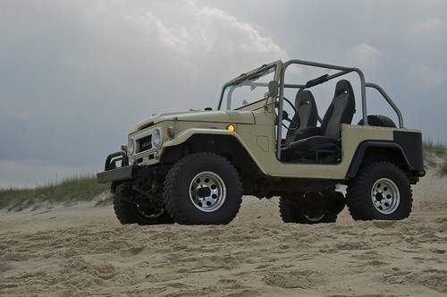

More topless beach pictures!!!!

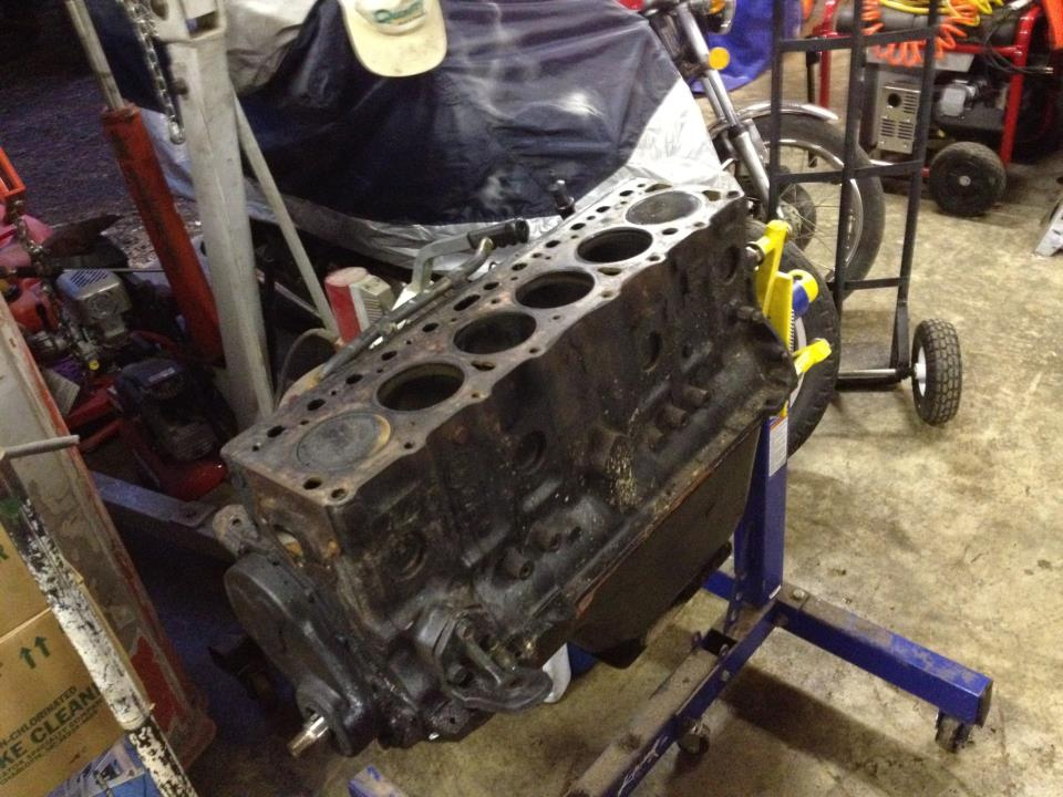

I finally built up the courage to drive it over to the shop and pull the engine, so I could look how bad it was....

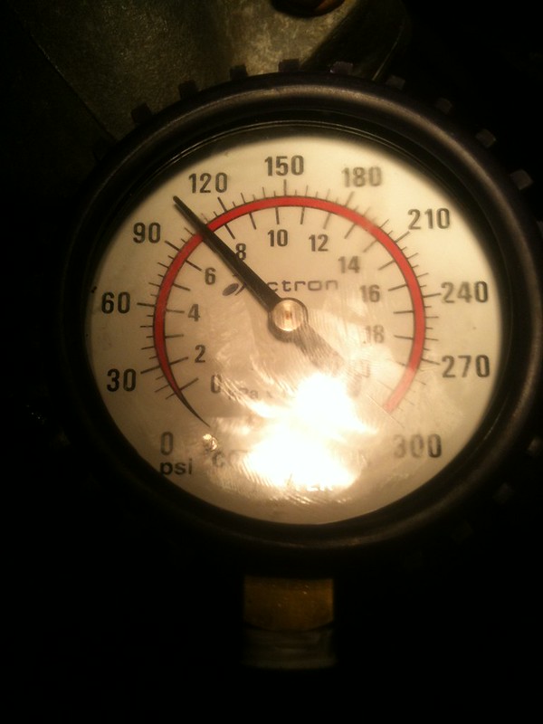

...and then just before I got the lower end apart to finally see what all that knocking and wear and tear was about, I did what I do best, and gave up....
picture.php
picture.php

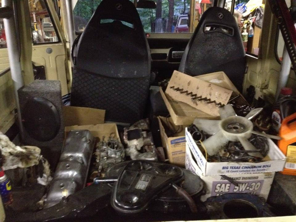

just taking apart everything to this point I found out I needed both manifolds, I knew I really needed a new carb + adapters, and a few valve guides looked like they could be replaced, then just pricing parts I was getting overwhelmed... Ryan said he may have some parts laying around from his 2F build so I may have had a crank if I needed it, but I didn't even bother to look any further....I'd still have wanted to get a 4-speed and then either make the driveline fit or buy all of it, or go with an adapter to my 3-speed transfer case, after I spent all that money I would start to be happy, so I just did nothing for the better part of a year.......

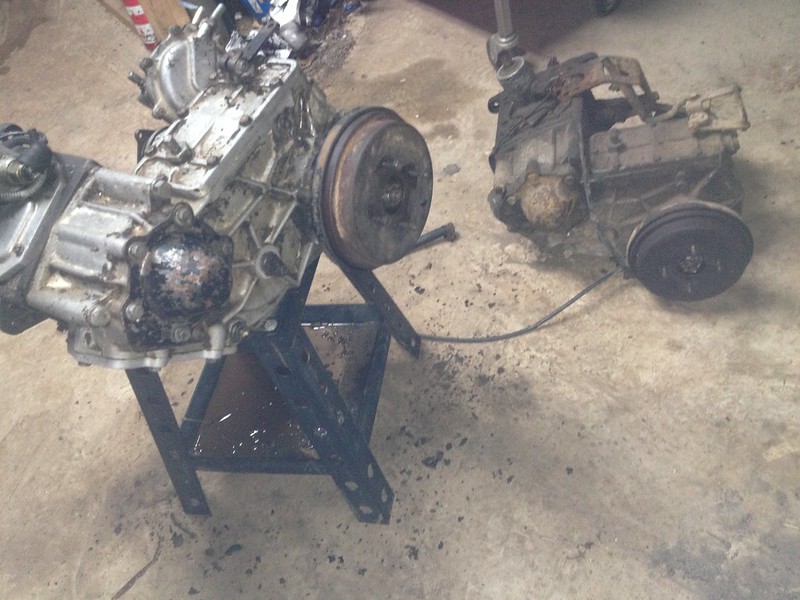

I pulled the trans and transfer the other day after taking measurments for fitment....

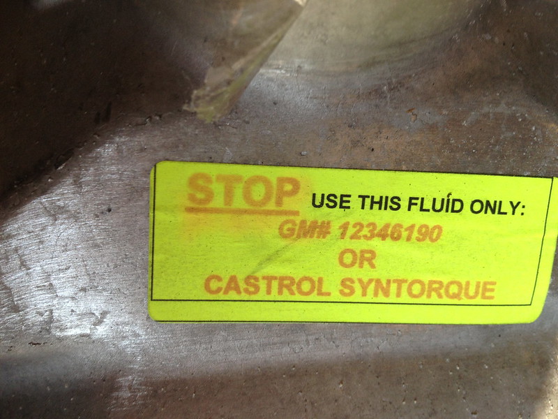

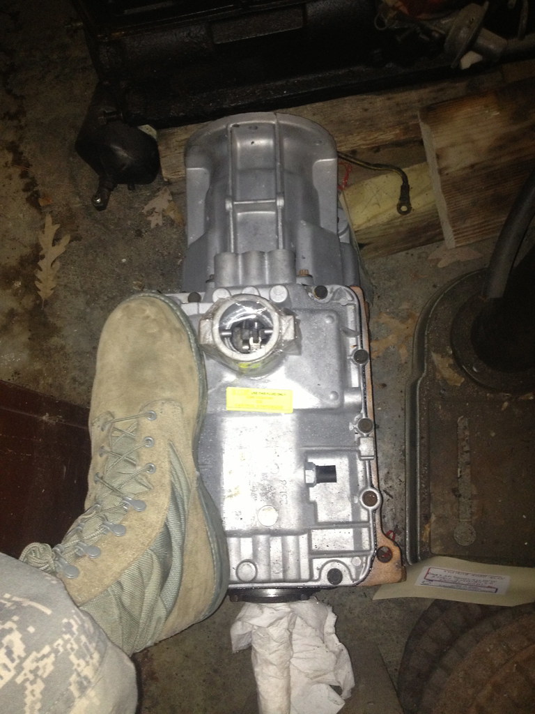

I bought an NV4500 and I had to find a shifter so I did a little research and got that
I measured the NV4500 and checked it out.... I bought a rebuild one off ebay from a transmission shop up north, they seemed pretty cool, we'll see how it goes, it is a 92-93 model so it should have the lower 1st and reverse.... Senor Aguas is selling me his used Advance Adapter kit so I can save a little money, I am trying to source all the adapters and parts and trying to save a little money.....
Then I measured my J30 3-Speed
Using my WV measurement system it is about the size of my foot.....that means the trans is 1 foot long..... look at the measuring tape, I'm pretty acurate with that thng.....
Someone needs a carwash..... :frown::frown::frown:
I am going to take the transfer off soon and clean it up real good before I start taking it apart... i want to put a case saver on it also, since a SBC will have a little more power, I don't want to break it....
I am trying to locate enough stuff to change my transfer over to manual shift and use a twin stick kit, I don't need it, everything works fine, buti'd like it and now is probably the best time to fit it all in there....

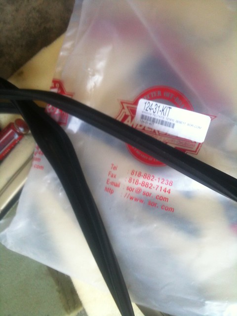

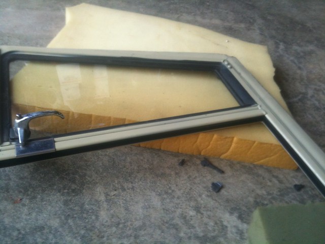

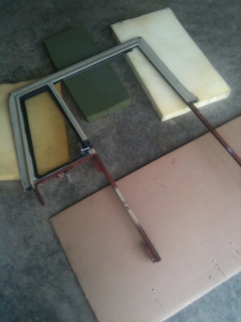

One day back on December 5th 2011 I put all the new window seals in my doors and it was awesome.... I just came across these pix, so I figured I would update it!!!!
After looking up and down the forums I went with the spector kits, they seemed pretty nice when I was installing them.... and they still seem to be doing well today, even though I am not driving the 40 anywhere...
When I got these doors with the hardtop everyhting had been sitting in a barn for a while, so I had to take a screwdriver to get all the crap out of the way, just to roll one window up, so after hearing the glass rattle for about a year, I pulled the trigger on the window trim kit from spector and I must say it is nice.... I have also put a drivers side window regulator in and replaced all the door handles and locks also....nothing has been easy, hahaha....

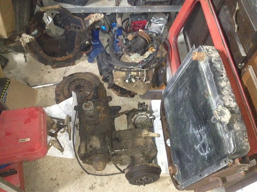

So I have been trying to do little things to get ready for all of the work to come. I pulled the trans and transfer a week ago and I wanted to clean it up...
This is after about 20 minutes of brushing off grease/dirt with parts cleaner and a brush....
and this is after the carwash(numerous soaps, soaking and pressure sprays) as well as brake cleaner (chlorinated of course) super clean purple spray, a brass wire brush, a wood chisel, and other such abrasive, scraping methods were used.... total cleaning time 1.5 hours at this point...WTF.... I also let it soak in the super clean for the drive home and over nite....

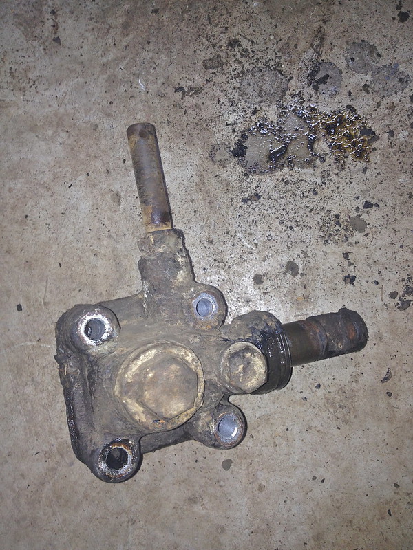

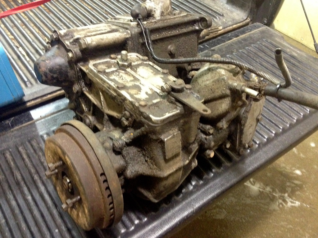

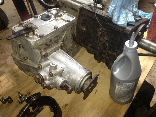

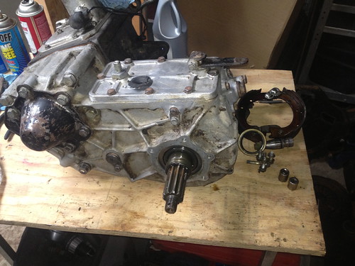

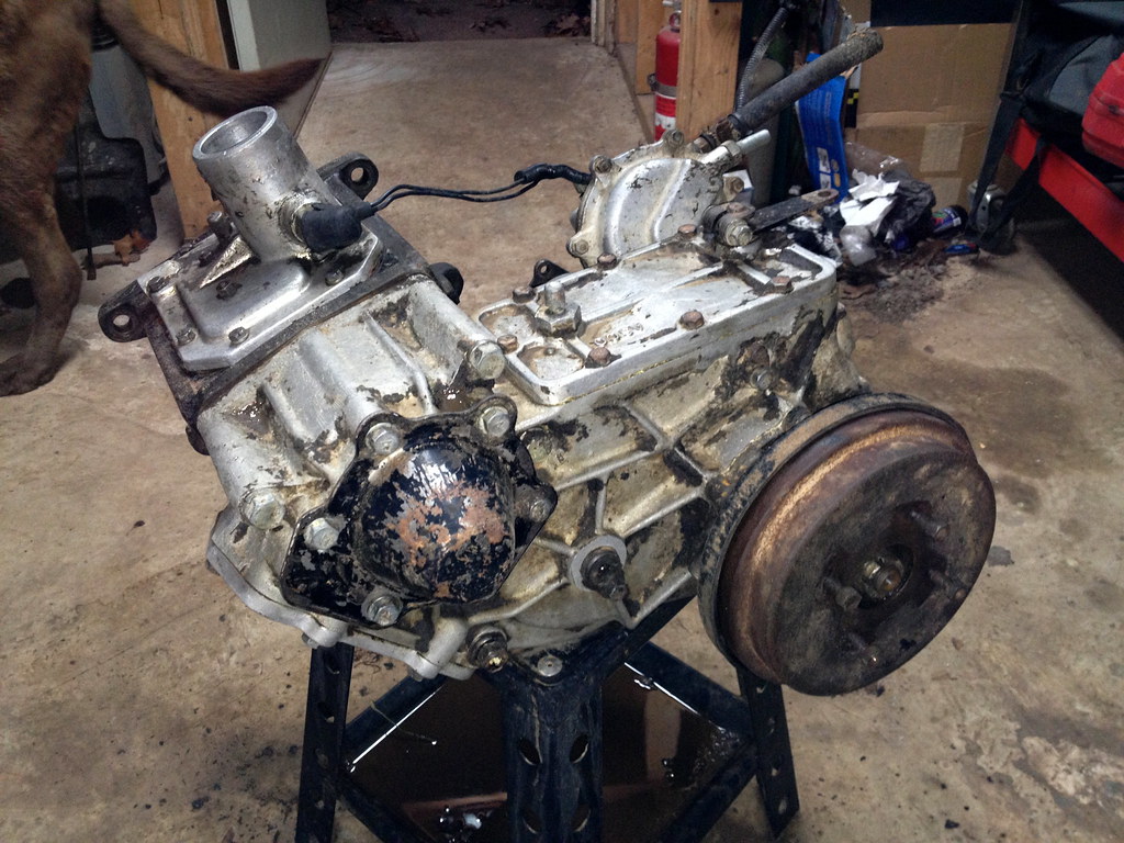

So I noticed that the shifter on the new mechanical linkage transfer case was frozen and that it was in such bad condition, so I decided to remove the housing with the mode shaft and shift fork to check it out..... it was nasty, and seized
I was finally able to wire brush and clear it with a scribe, soak it in WD-40 and get it to move with a few light taps with a hammer.....I decided to take it apart, and when I got it apart I cleaned it thoroughly and ordered a boot, o-ring, gasket, and oil seal from SOR as well as the transfer to trans gasket all for about $25 when I do the twin-stick install it comes with a new mode shaft, so no need to clean it up any more!
I tried to clean my transfercase up some more,but it didn't help looks like I'll need to really spend some time on it tomorrow...

So I am still cleaning this transfercase...totally envy these guys right now:
How to Clean a DIRTY Transmission and Transfer Case

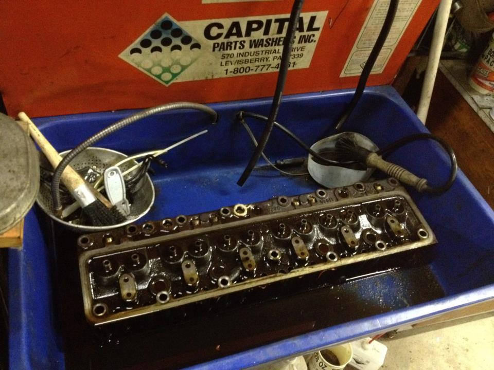

We have some good cleaners on here.... I tried the oven cleaner method, and it is pretty awesome!! my aerosol ran out of propellant but still has cleaner in it I may stab the can and use the rest...Before.....
It's fume free and MAX cleaner, lolol....works like a champ tho! The Parts cleaner is pretty bad ass too! I thought I was out of solvent but I forgot the other container was untouched!! scheweeT!!!
and here is an after shot, still plenty to do, but I am still pretty happy with the progress, and the fact that I am working out of my basement everynight!!!!

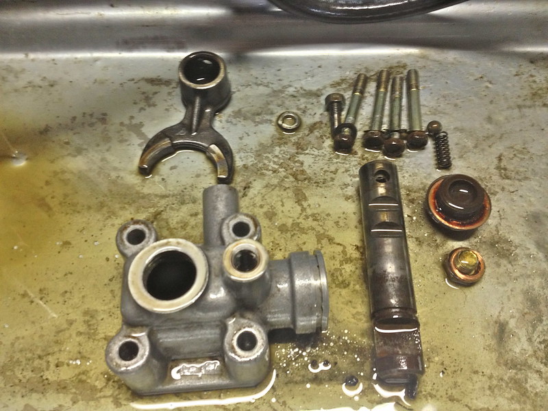

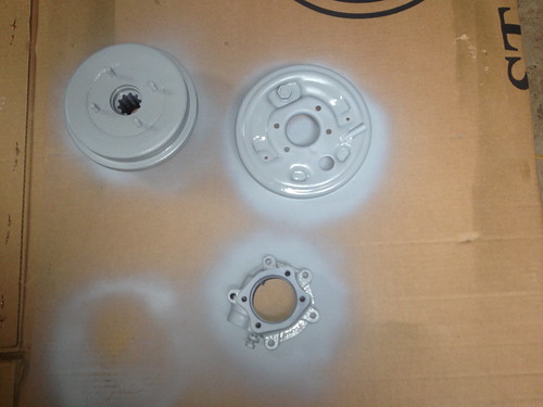

Also I took a few items off and soaked them in the parts cleaner to get all the gunk off, now I have primed them, and tomorrow I will stop and get some hi-temp hi-gloss black paint for the parking brake parts....
Then there was much rejoicing, Yayyyyy!!!!!
