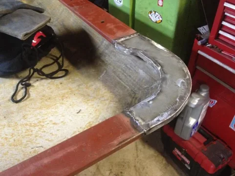

I started working on the corner channels, I decided to make the. Out of spare sheet metal & just weld them rather than try to bend metal
I ran out of wire, but once I got them welded up I ground everything down to imitate the factory bent metal.
Much better than the rusted out "spare" corners I had.
Here they are finally welded in, I just need to clean it up & start drilling holes

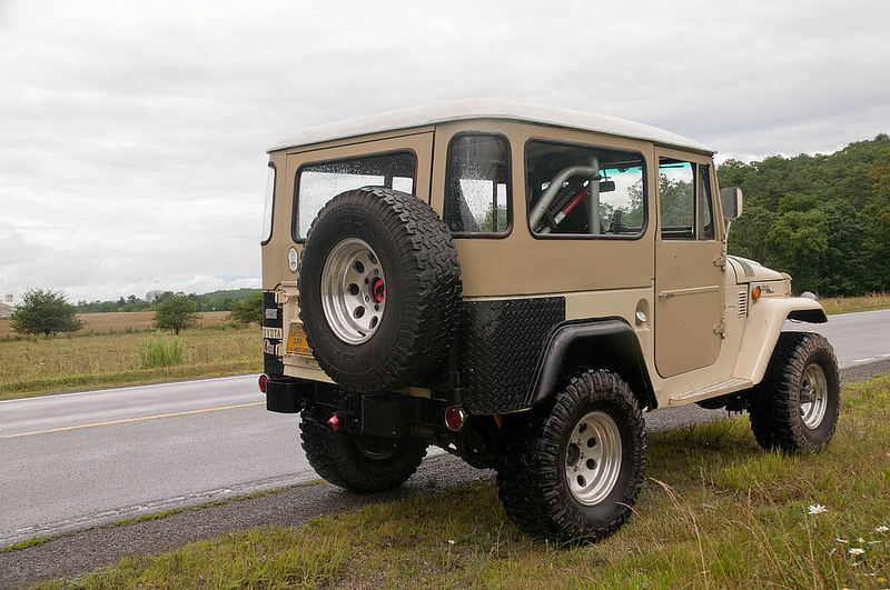

Here is the National Radio Telescope in Greenbank,WV as much as I see it I figured I would get a decent shot, and a shot with the FJ40 in it....
you can kinda see it in the distance... and you can see I still need to trim down my corner channels, like I said, I got in a hurry

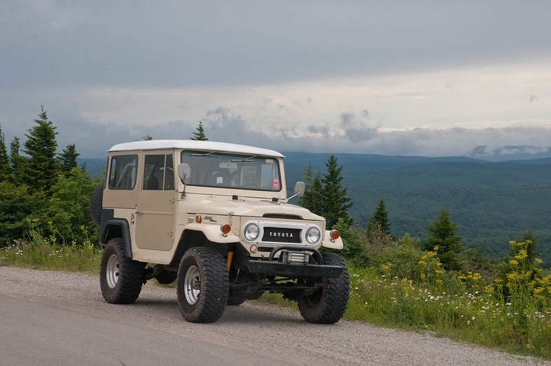

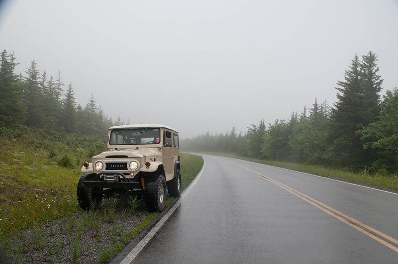

And another on Spruce Knob, WV's highest point...

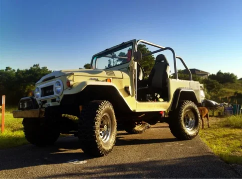

The cruiser has been down this road before, but now with a V8, a 5-speed, mini truck calipers (used to have drums), twin sticks, no rain leaks, defrost/fog, window felts, and everything else I have been raving about it was a WAY BETTER DRIVE!!!!!!!!!!!!!!

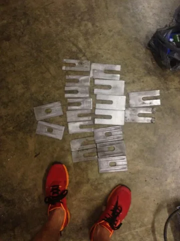

Also, for what its worth (chime in if you read this) I have had horrible'er steering since the engine swap/Axle swap/Disc brake upgrade, not to mention my steering was only a fractional amount better prior to all of the front end work... I do have what looks like a 2-2.5" procomp lift (springs) that more than likely came installed from the PO's PO.... I have done about 3 tow-in adjustments, after a full axle rebuild. I am starting to think I am having a Caster issue after reading DGANGLE's posts (especially #19) on this thread https://forum.ih8mud.com/40-55-series-tech/293665-castor-adjustment-camber.html
I think I might need shims, but riddle me this: Could my problem be the fact that the Front end sets at least 1"-2" higher than it used to because of the Engine/trans swap ????? hence changing the normal spring height and maybe a degree or two of axle rotation???
The cruiser likes to track the road. On a freshly paved road it is fine, on a road with tire tracks warn into it, it will jut left or right and jump from track to track very abruptly never actually driving straight.
Please feel free to shoot holes in this theory or offer advice or anything at all, I would like to put it on the lift and remeasure the tow-in and then measure my camber and determine if I need shims........

I have some shims on the way, but until then I will just keep driving it with the deathgrip on the wheel....

Well I got the shims in, as far as I can tell the axle is now setting at +1 & I straightened out the toe-in & now it is 1/8" toe-in. The cruiser drives soooo well now, & I put new weatherstripping on the rear barn doors & bottom of the hatch to stop the rattles, as well as repairing my door latch & adjusting the spare carrier pad. Now almost all of my rattles are gone!!!

Stop driving over 100mph and you won't keep breaking em! JK, good luck with that crap. I might hit you up soon about steering and shims. My 40 runs all over the road, I'm starting to think I'm going to be spending some money for some castor shims.
Try a speedo shop and see if they can rebuild yours, may have to ship it off but can't be much worse than what you've spent already, nice build BTW...
Ryan, Hahaha, maybe I should!!! Yea, those shims and re adjusting my toe-in made a world of difference, maybe one day you can bring it over to the shop in Harpers Ferry and we can measure the angles and then put it on the lift and slide some shims in, don't buy any, I am pretty sure some of these will fit, you can just buy my dad a case of beer!
