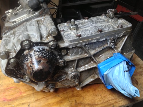

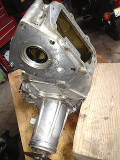

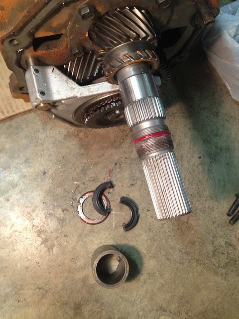

I finally separated the trans and transfer, so I could clean a little better and get it ready for the Adapter!!! I hope these baby steps aren't boring anyone yet!!!! hahahhaha except me....
Transfercase Again!!!!!
I know everyone is so excited to see more transfercase action!!! hahahah!!!! I had a great snow day off work, and the storm was weak, so I decided to do a lil more landcruiser work...

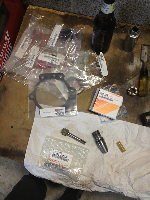

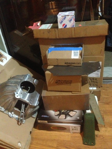

My seals and gaskets finally came in for SOR, everything except for the seal I actually wanted Toyota # 90311-38047 (the front output shaft seal) so I ordered that at the local dealer today...

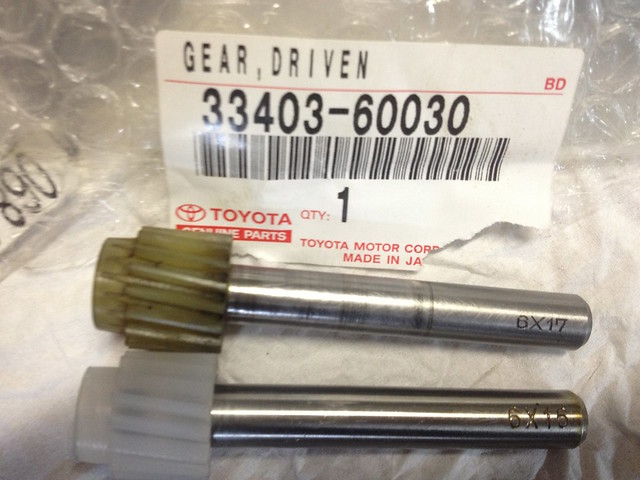

My new speedo gear came in so I went ahead and installed that, I remember doing this with my '82 pickup truck, it went from 10 over to 5 under, but it was a free gear in a donor truck and I was rebuilding my transmission....This should be dead on for the 40 with 33's according to another post here on MUD...
and there it is, in there somewhere, I guess i'll appreciate that $36 when my speedometer moves.... it was supposed to be $40 something and I talked them down!!

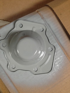

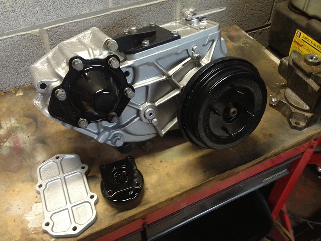

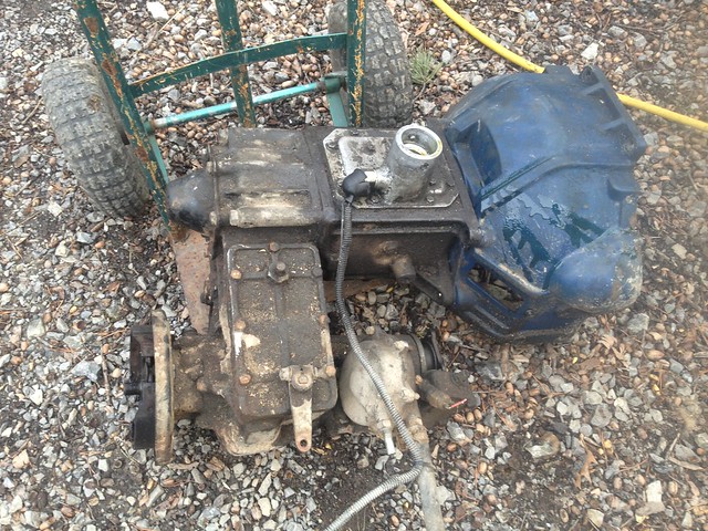

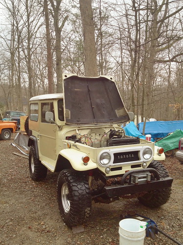

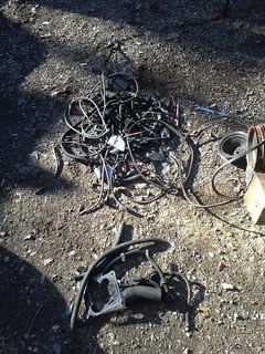

And here is where I got to...of course the cover is just on there for looks, it won't go on until I get the AA piece to bolt it to the NV4500.... Also I got a Case Saver from JT Outfitters, I have heard the ups and downs from them, but so far I haven't had any issues, I watch what I buy from them though....and just because I am so proud of myself, here is a picture of what this beast looked like about a month ago when I pulled it out...

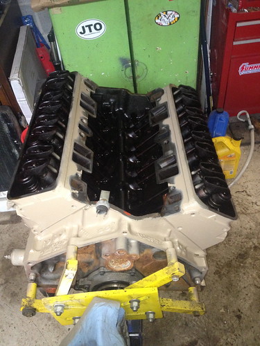

Engine cleanup!!

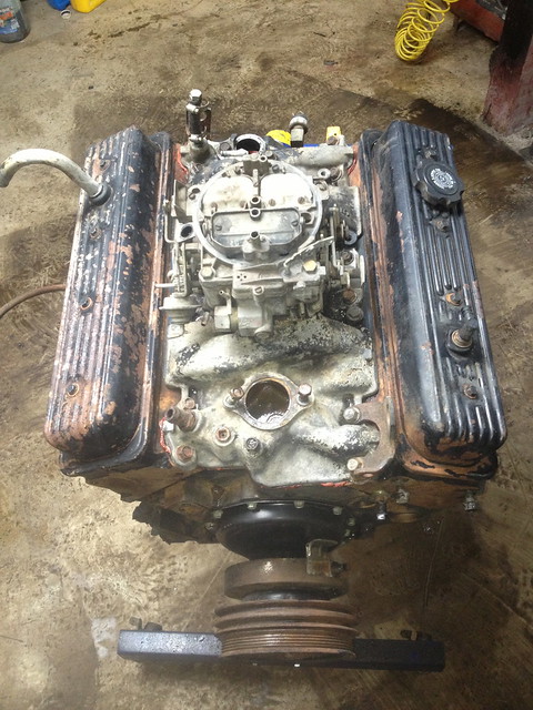

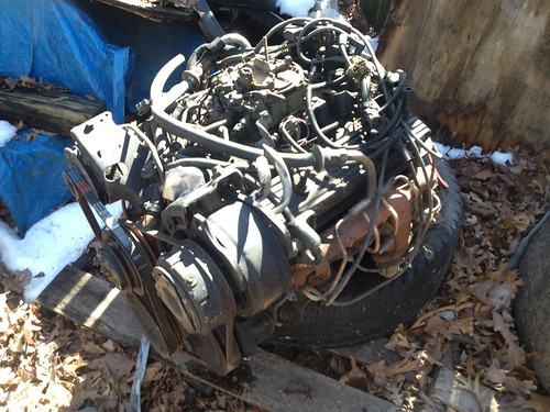

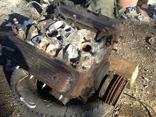

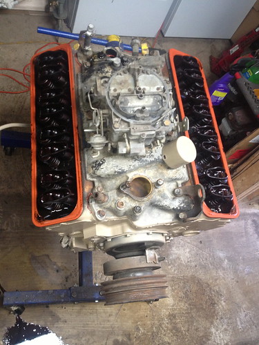

So now its engine time!! I thought it was a 305 HO but now I found out it is a TBI 350 with a GM carb on it.
So first I need to get rid of everything on this ugly beast!
so here is what that is under all of that...
after the first round of oven clean....

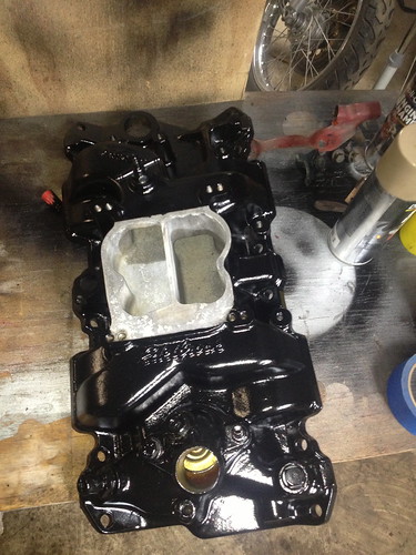

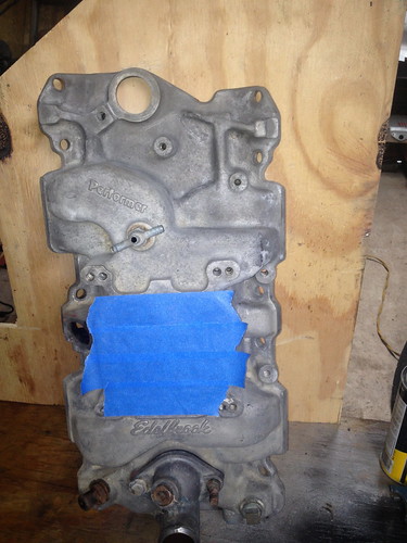

Here is the GM aluminum manifold from a 70's-80's Monte Carlo or something..

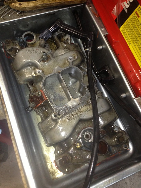

Then dad gave me his Eldelbrock Performer manifold and carb!!
So that is cool, I'll clean that thing up!!!!
Oh, and there is this stuff sitting in my living-room!!!!
and then there were a few brewskies!!!

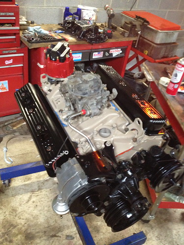

Engine week has been somewhat succesful!!!!
As soon as I clean the basement I just make it a mess again!!!
Cleaning began on the engine parts:

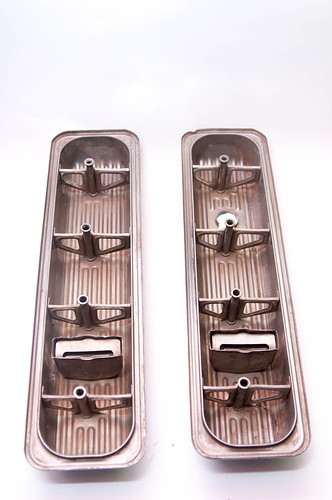

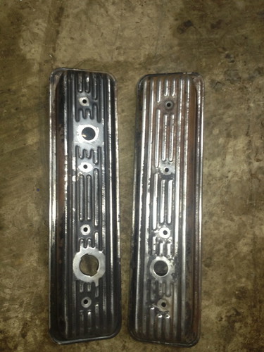

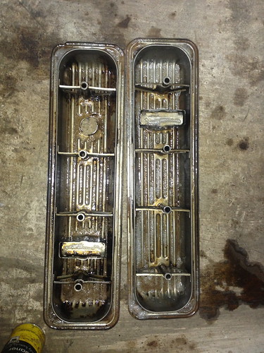

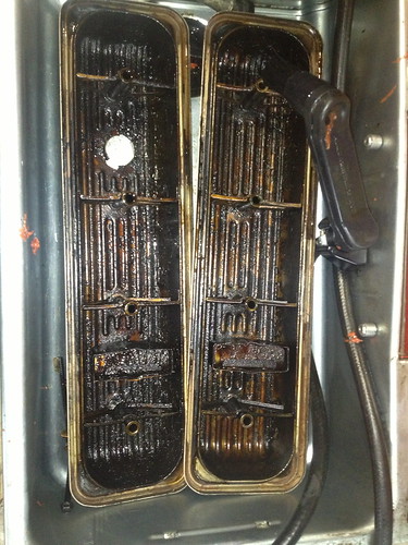

Then I pulled the valve covers and started to clean again....

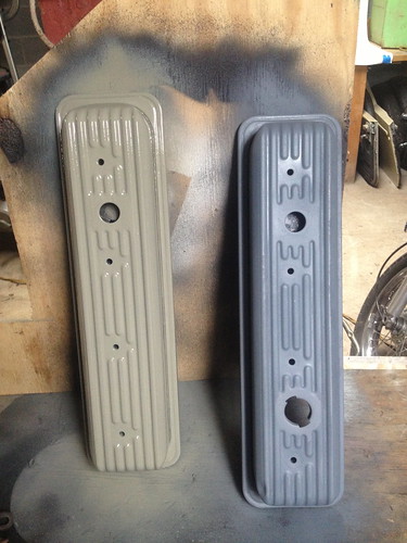

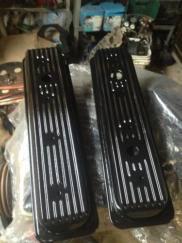

They were pretty nasty, and but I wanted to retain the black GM covers, after a few days of scrubing and soaking I was starting to think the cheap chrome ones would have been a better choice, but I pressed on.....
I took the wire wheel to the outsides after I was done with the insides, then a lil 220 grain paper, and primed them, one with a little krylon the other with dupont 1K self etching, because I had a few sprays left in each....then the hi-temp gloss black

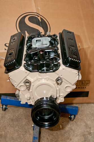

After several rounds of oven cleaner the block was ready for some spray, I wanted to do the block in beige so it doesn't stick out like a sore thumb in my engine compt.
MOAR PARTS!!!!!!!!
Only a few more needed and I can bolt it all together and see how it fits, and then the cutting, welding, and adapting begins....:steer::steer::steer:

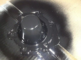

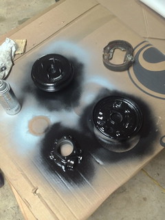

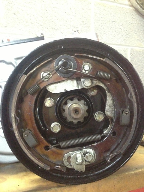

Today I loaded up everything on the parking brake drum so it is ready to go, and put the other seals in the transfer case
Then I loaded up everything so I could take it all to the shop and get started with bolting everything together...

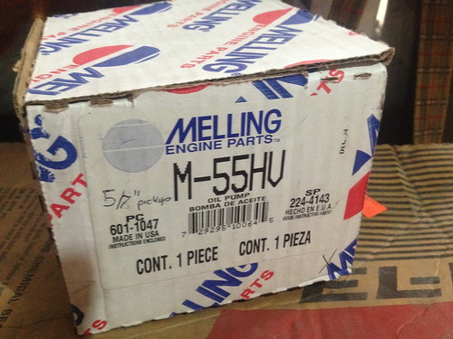

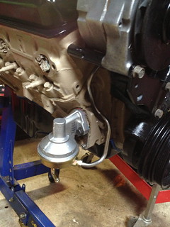

I purchased the gasket set for the engine, hopefully I can get the valvecovers, manifold, fuel pump, and such all bolted down now, and drop the pan and replace the oil pump and rear main seal as well. I also want to get the firewall painted before I start putting the engine back in. Most of the vacc shift 4wd stuff is out already.

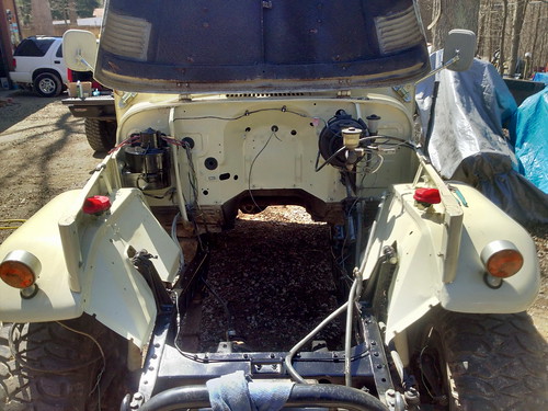

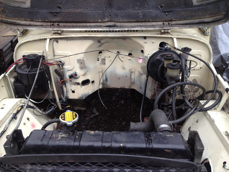

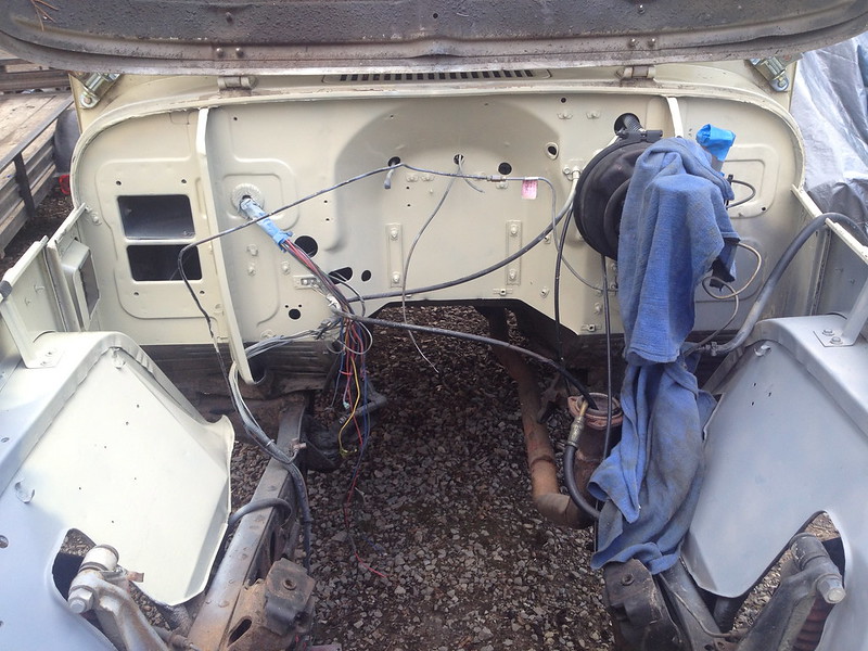

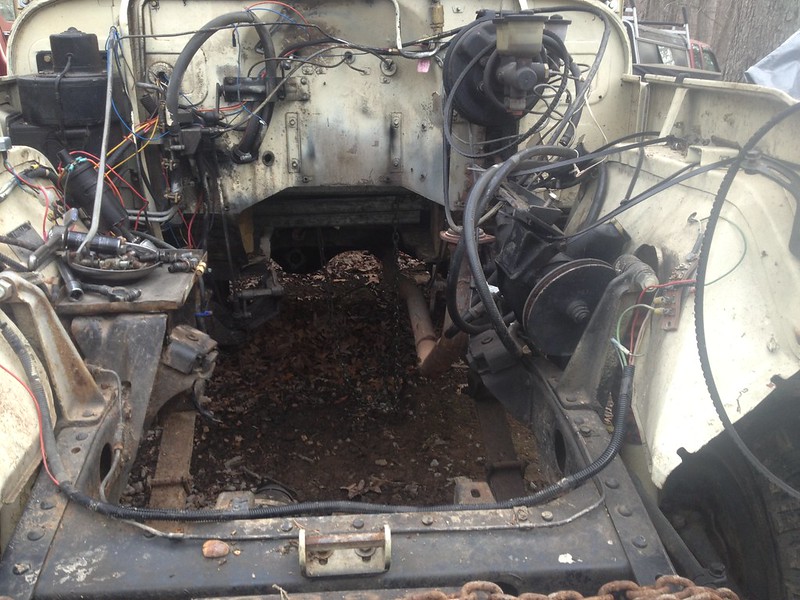

Firewall clean up session number one had good results, I can't wait to get some paint in here......
BEFORE:
AFTER:
I am still cleaning up some of the wiring mess from the PO and I am guilty of running a few random wires over the past few years as well....
I also washed the cruiser, removed the battery tray, re-routed some wires, removed the 4wd vacuum shift and linkage, and got the engine ready to go.

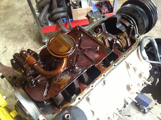

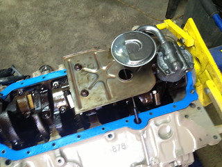

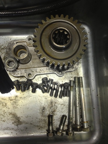

Oil pump and baffle Before and After:

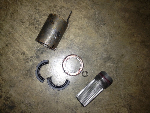

While waiting on more paint and grommets to arrive for the firewall and fenders, as well as wire loom (the good stuff) I decided to tackle this beast!! i have been putting it off because I was nervous to cut a transmission up that I just paid for, but it was just as easy as I thought it "should" be...
Some extra pieces....

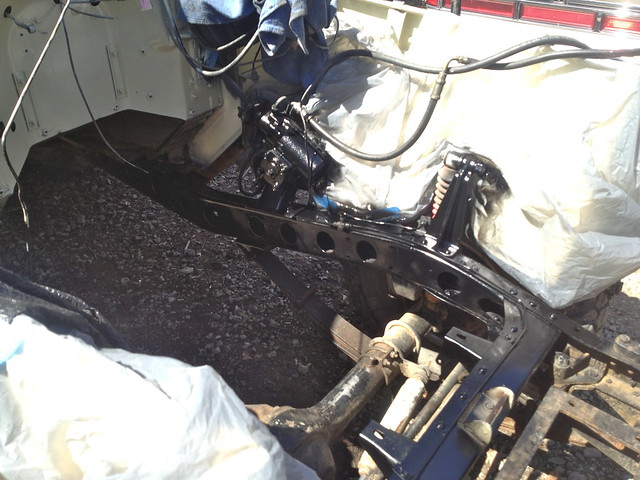

I got the over-sprayed rhino liner & gunk off my frame, and I removed all the motor mounts. The frame is looking much better. I also got a little clear coat on the newly painted fenders...

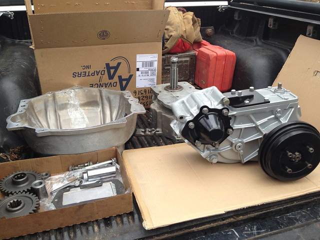

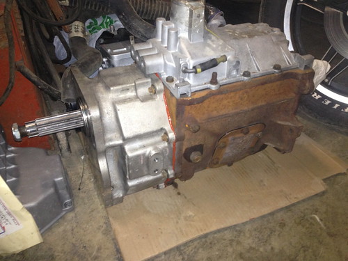

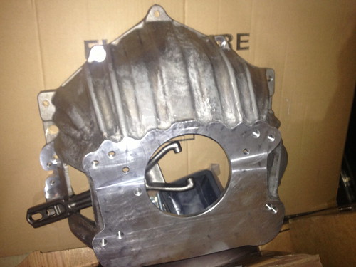

The trans is finally all bolted up to the transfercase, the adapter and bellhousing went on fairly easily. I got the shifterbase & twinstick hardware installed.

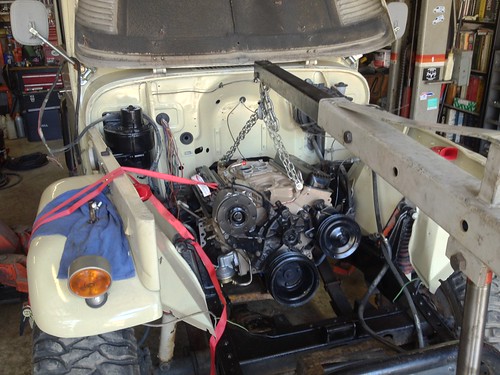

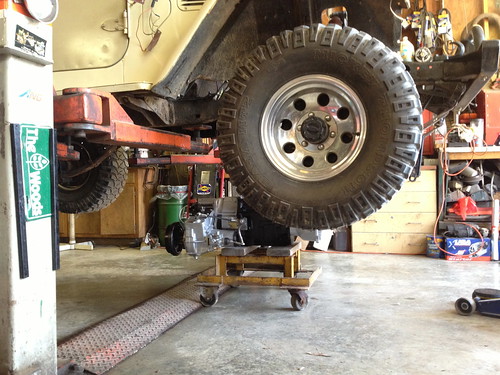

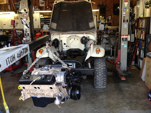

And so it begins.... I got a friend to help me push the engine out of my basement and load it up on the S10. I then was able to get the FJ40 in the garage and in position to mock up the driveline to see how it all fits...
I took a lot of measurements and went by all the guidelines that Advance Adapters seems to have, as well as, advice from other forum members.
Having the lift around (and this extra engine dolly) really made life easy.
More measuring and adjusting and measuring and adjusting...

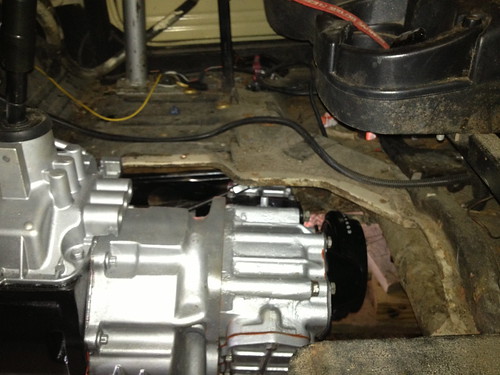

The NV4500 and the 3-speed case are all the way up against the floorboard, it looks like my transfer will set about 2-3 inches back from where Toyota put it, and because of that, the hump in the floor doesn't line up with the High/Low shifter linkage, thoughts???? go as high as I can, or mod my floor??

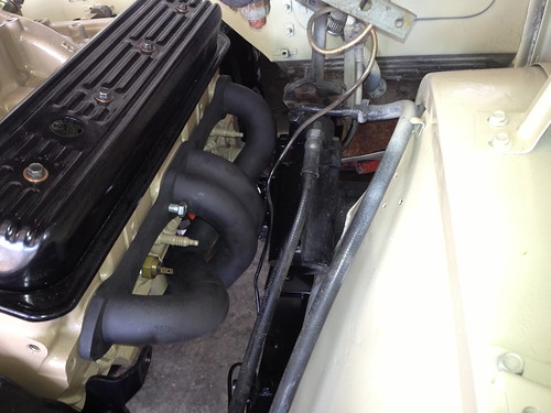

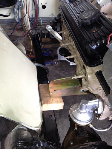

The Headers are definitely a no-go, they won't clear the steering box as many of you had said...the ramhorns are on the way...
Motor mount placement looks good, I will weld in the L brackets tomorrow...

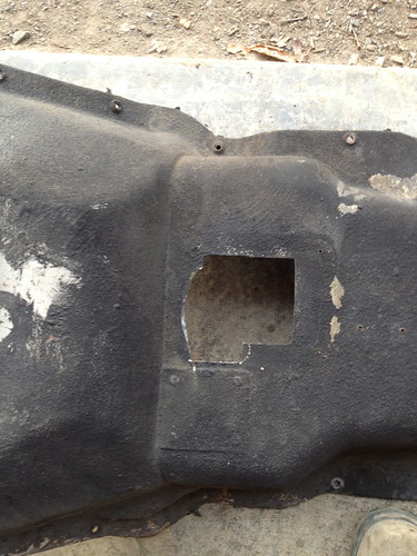

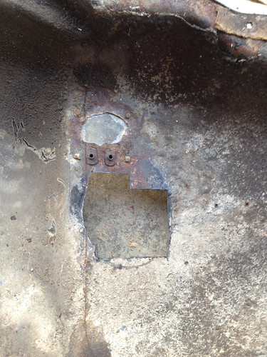

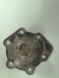

Anyone know why this patch was here and what it could have been for??????
It had nutplates???
