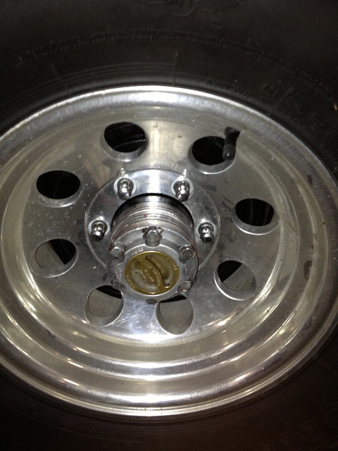

Here is one of the hubs back together and striped of all of the chipped nasty paint...
I cleaned both up and re packed them with some nice high-temp bearing grease instead of the white lithium grease that was in there... I also cleaned up the passenger side bearings and took most of the burrs out of the races and bearings.... put new inner seals in both sides, tapped the races back in and re assembled. I torqued, pre-loaded, re torqued and all and now I think I am good for a little while.... it was definitely smooth and way better than it was(passenger side)

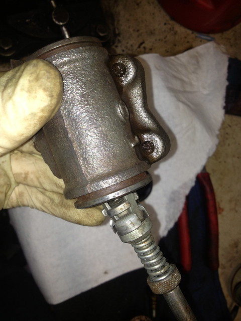

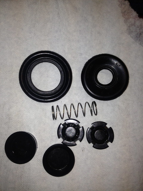

Then I rebuilt my leaky wheel cylinder on the passenger side rear drum, and what I found was a relief, the cups and boots looked great, the cylinder was just full of nasty stuff and needed cleaned.... so I wiped everything down....
Then I honed the cylinder and smoothed it out, and ran the outside through the wire wheel to clean the excess junk out...
After I reassembled it I was confident that it would work just fine...

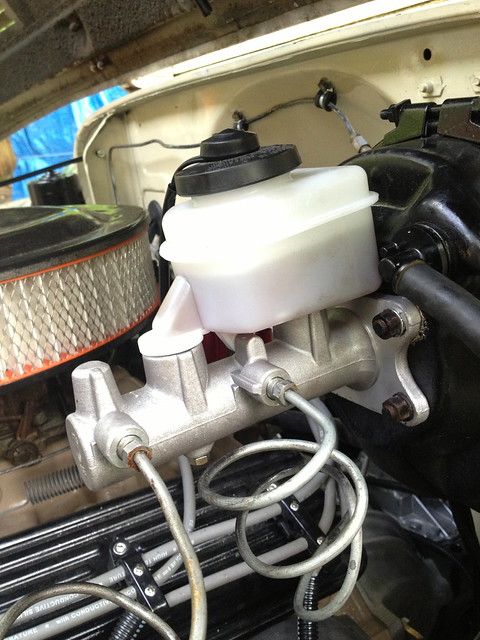

And that was the installation of the 80-series Master Cylinder I purchased for just under $50 (new Aftermarket)
And after a short amount of time spent bleeding the brakes again and of course the bench bleed of the new M/C ....... I HAVE THE BEST BRAKES I HAVE HAD SO FAR!!!!! :clap::cheers::grinpimp::D

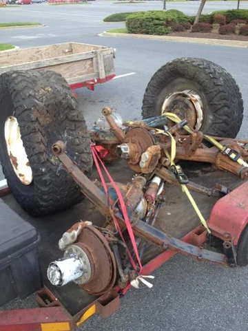

Well the 'Ol quadrajet finally started acting normal on the commute to work this morning, & the brakes felt nice. Here's a few shots of the disc front axle & all the other junk I picked up, hopefully I can clean everything up & get rid of what I don't need...
These dry rotted 39's may be a problem to get rid of, but the 15" wagon wheels should clean up nice...

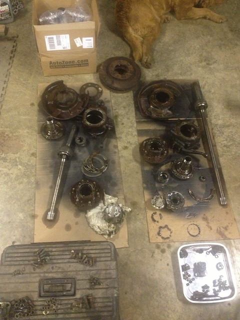

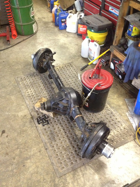

Well, I pulled everything off of the Axle that I brought home the other day....I am not 100% sure what year it is, but judging by the rotors and steering arms I 'd say it is an early disc axle, but that is just my best guess......
I have been talking to a few people and reading all the forums, and the more I do the more difficult my decisions get.....
PLEASE ANSWER THESE QUESTIONS IF YOU CAN!!!
1. I have a 1968 FJ40 with coarse splines at the hubs do I have ball-in-claw and coarse inner spline axles? I am assuming yes ( I know how to find out, but I'd prefer not to tear into it yet)
2. My donor axle (complete disc to disc) has Spring-over perches welded on, I am going to cut them off with the cut-off wheel and grind down extra weld bead, is this a problem or worth the hassle???
3. Using this complete (I assume 76-77ish) donor axle complete, knuckles, diff, housing, and all will be worth the time or should I try to slide the innards into my '68 housing and attempt to figure out the bushing/seal issues????
I think that is it for questions, but please offer any extra info that you have.
if I am using this donor axle complete, then I will just re install the shims back as they were, but if I need to cross parts over to my housing then I will have to borrow an alignment tool, I am curious as to how well I can remove these SOA perches, the PO of this axle wasn't a bad welder ( I want to remove them because one is slightly crooked and they will limit my axle travel and "its just not correct to leave them"[I think]).
I have most of an axle rebuild kit, all new bearings, scrapers, seals, gaskets, just nothing for the newer style warn hubs and the seal the spindle rides agains( the one that bolts one (in my picture top left-of-center-ish, by the rotors) anyone know where I can get those individually? SOR has a warn "rebuild kit" for $25
Any help would be appreciated, I know the info is all here on IH8MUD somwhere, I will keep searching the threads when I have down time at work.....

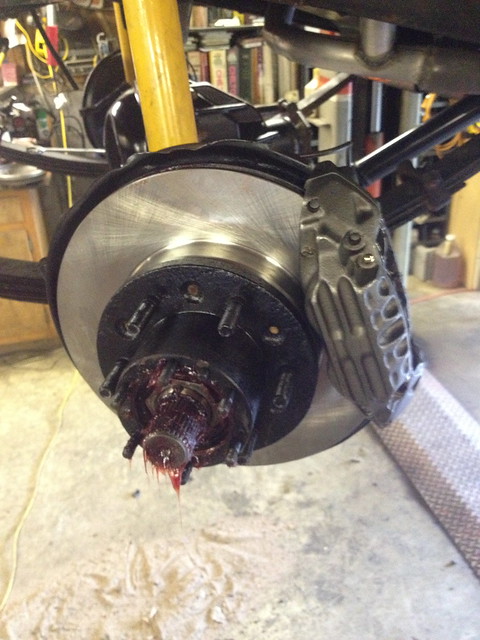

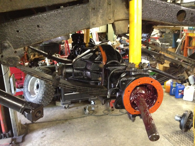

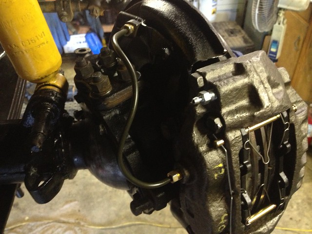

After tearing the axle apart I decided not to wait, and went ahead and ordered the rest of the parts. I decided not to cut the SOA perches off just incase I decide to do anything with them (I won't,but they don't really take that much travel away)

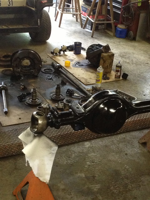

Here are some more pieces...

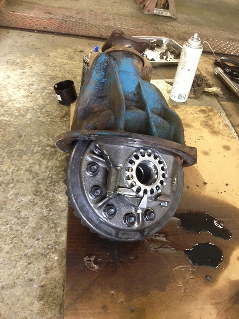

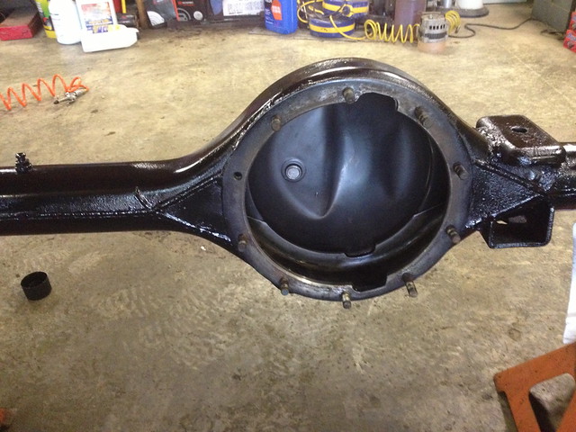

Pulled the diff to check gear ratios and such, it looked ok, I'll have to check my drum diff to see how good it looks later...

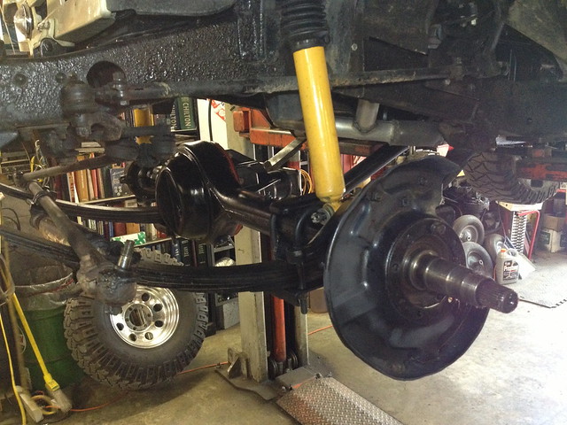

Here is the old Drum axle finally out after a lot of sweat!!!!
Here is after a little assembly

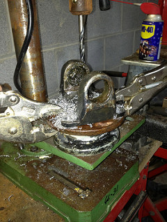

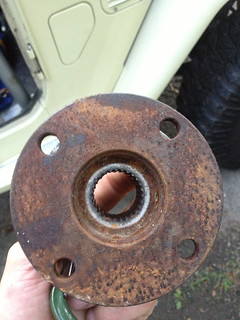

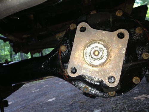

I have all the brake lines made up now I just need new brake hoses, and I will need to do something about the Yoke, I new the bolts got bigger on the newer driveshafts, but I heard that the pinions had the same spline count, that is false, I am assuming that the older coarse spline axles had coarse pinions as well, and the newer stuff has fine spline.... so there is that, guess its back to the driveshaft shop.....
I think someone said early and later driveshafts have different U-joints also so I can't just swap the bottoms out....meh...:bang:

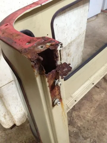

Yup, like I said, I just want to get it on the road again and drive it, well then I started this axle swap, now, I pulled the hard top off and it is ready for a make over, every bolt that was in the rain gutter snapped off, and the corners above the corner windows have a decent amount of rust...theres no going back now.....

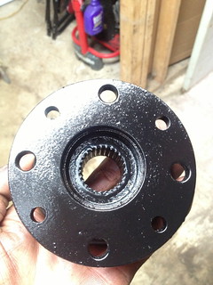

Driveshaft
Well, after a little work I finally got the cruiser back together, I was able to go through the other axles and fine a fine spline flange from a mini-truck that I could drill to the old pattern and use my driveshaft since i just got them lengthened...

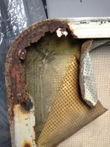

Here is what I found when I removed the hardtop
Plenty of nasty stuff & rust
The corners will need a little body work too

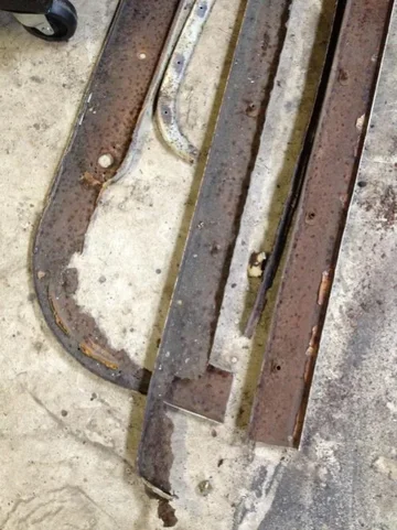

I set everything out too check how it fit, I still don't have any corner pieces though & CCOT wants $190 for the pair

I started to make new corner channels last night, im going the easiest route possible. Pictures to follow. I also patched a few fiberglass spots in the top last night.
