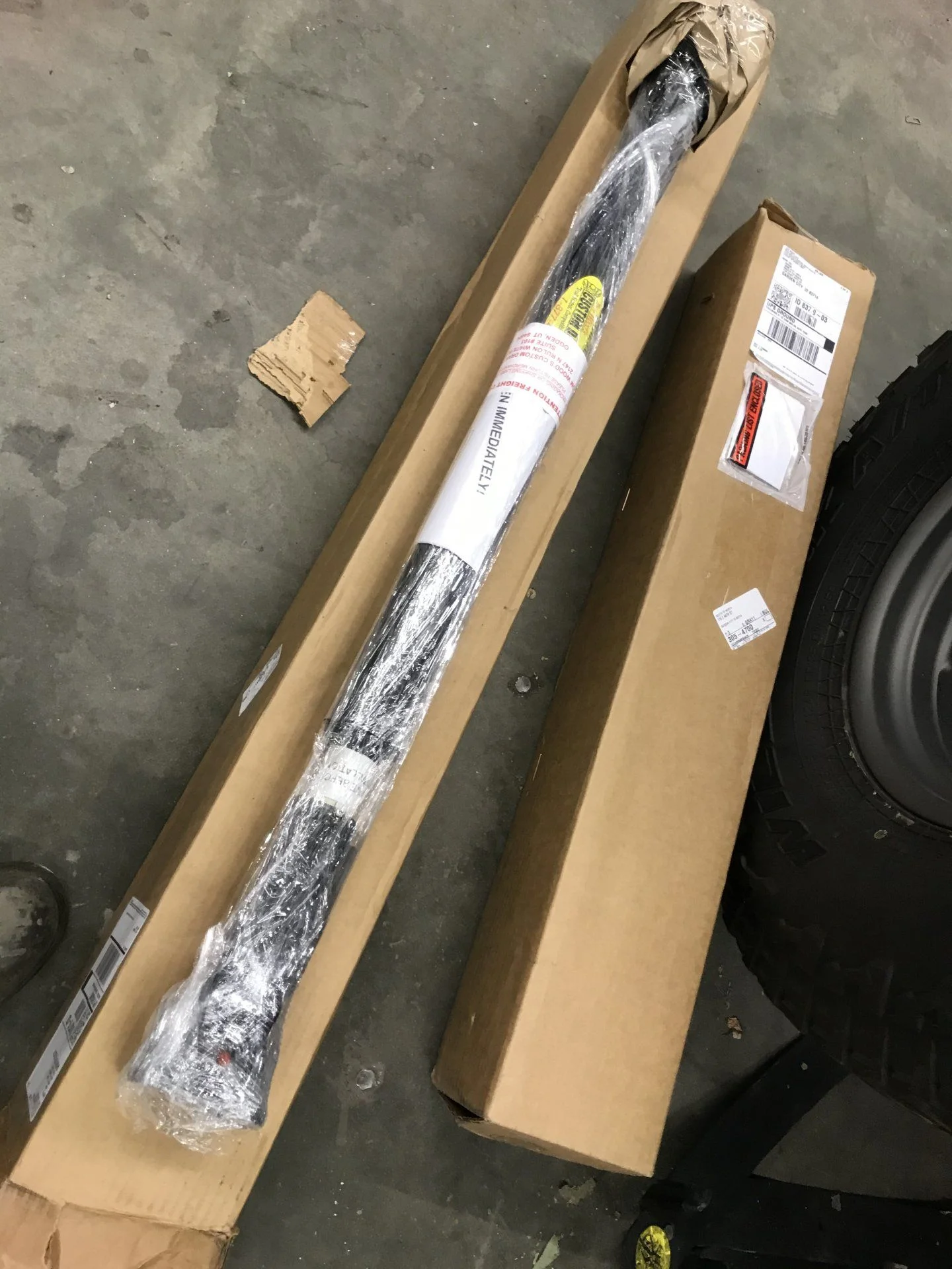

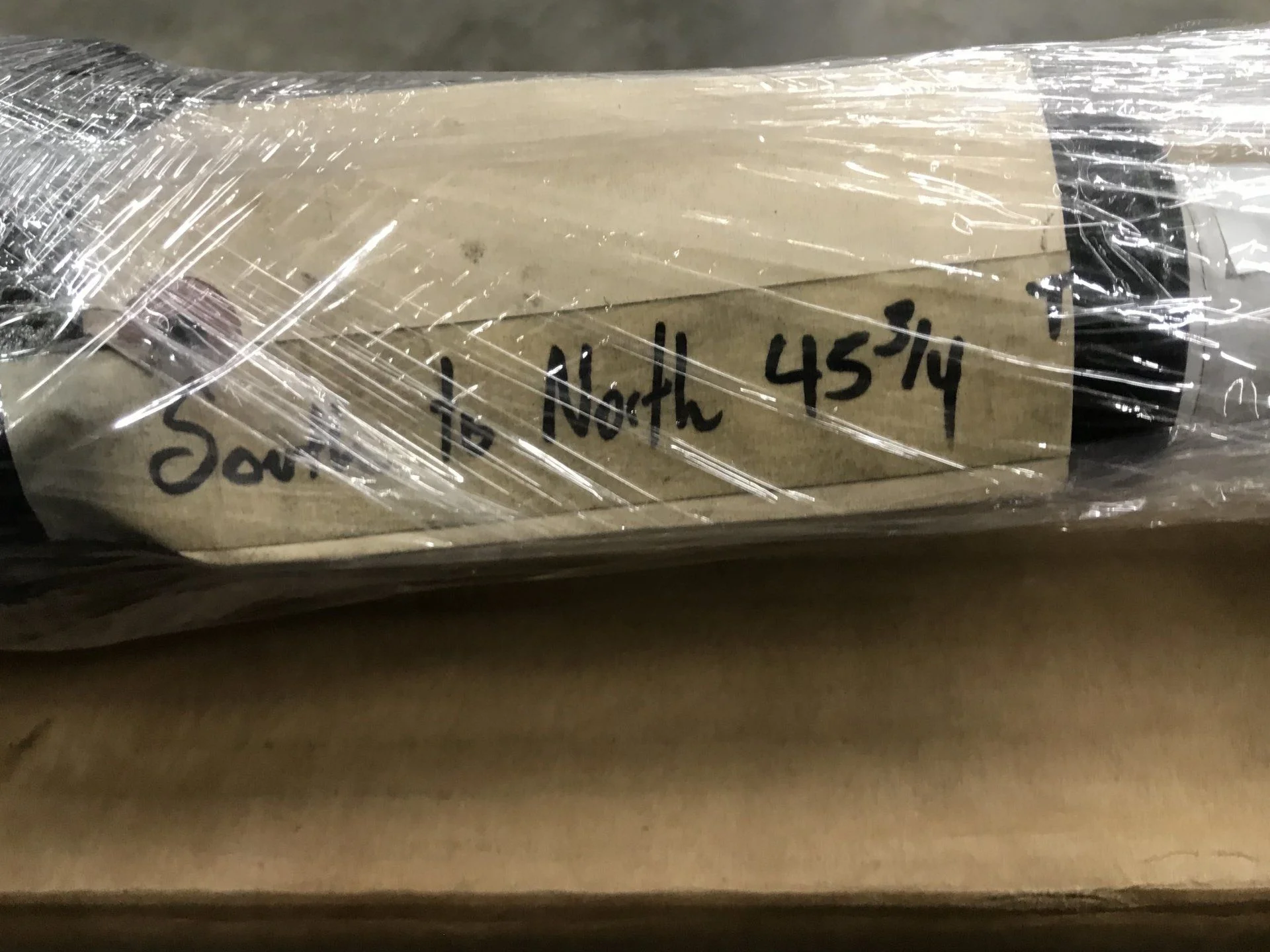

Ordered new drivelines today from Tom Woods. DC front shaft and standard rear shaft. I like working with TW, they have done me right so far.

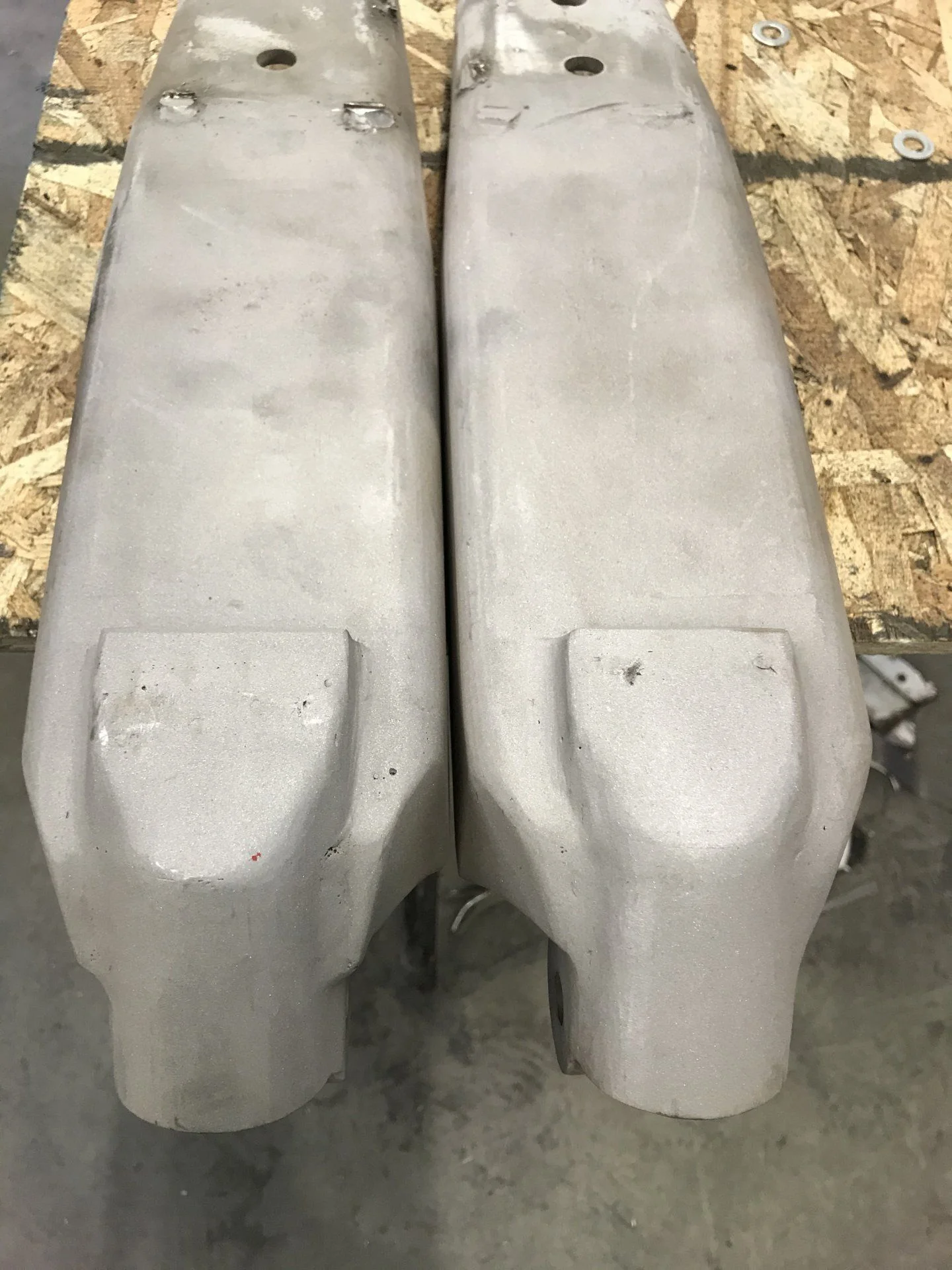

Got a couple of beauties in today. More pics coming, don’t want to fully unwrap just yet.
The last three sets of drivelines in my shop have come from Tom Woods. Real happy with them, solid price, solid product, excellent communication and knowledge on their end and real fast turn around time. I was using a local guy for drivelines and he is good but slow and expensive so I think we will be sticking with TW for the foreseeable future.

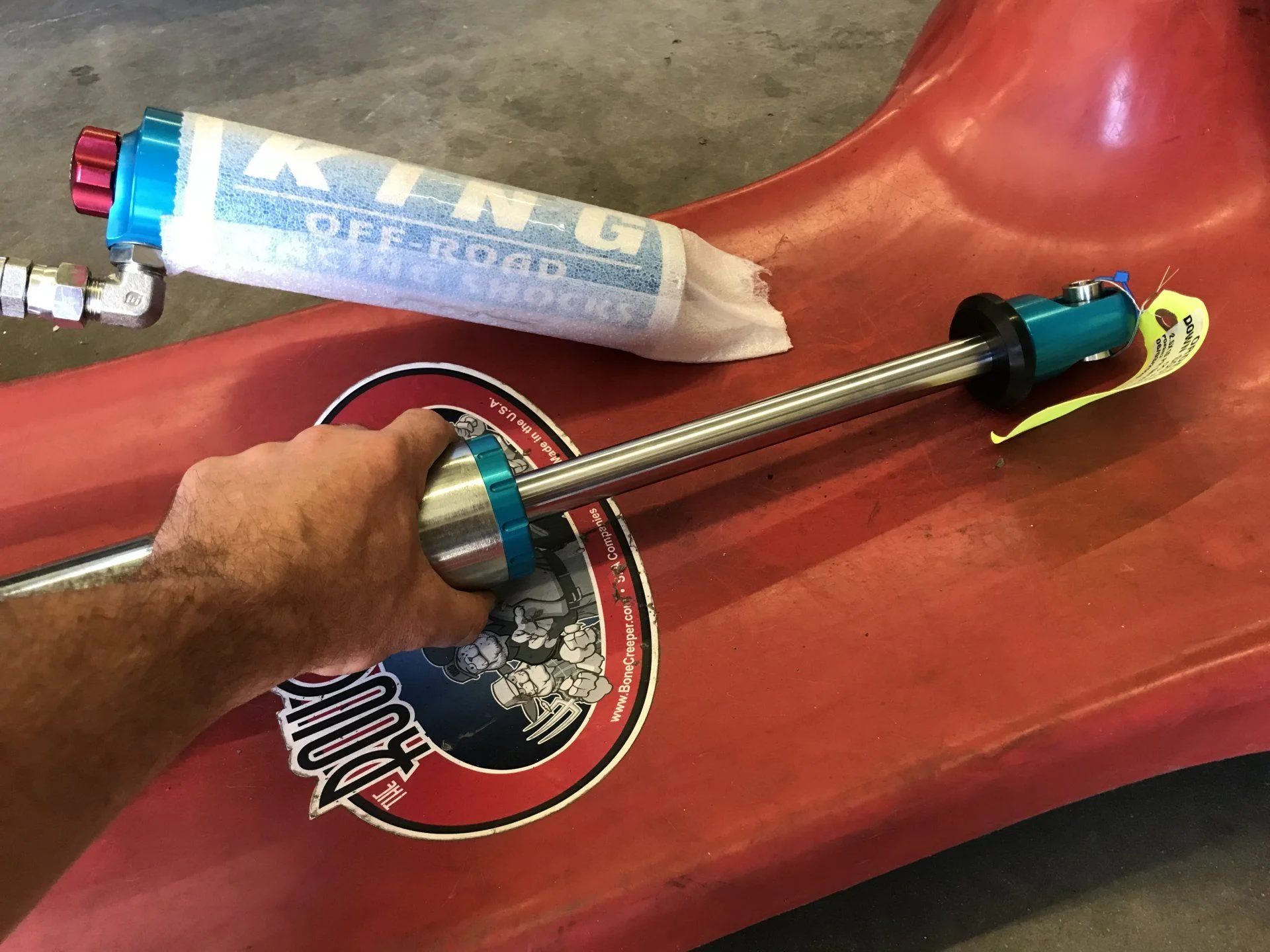

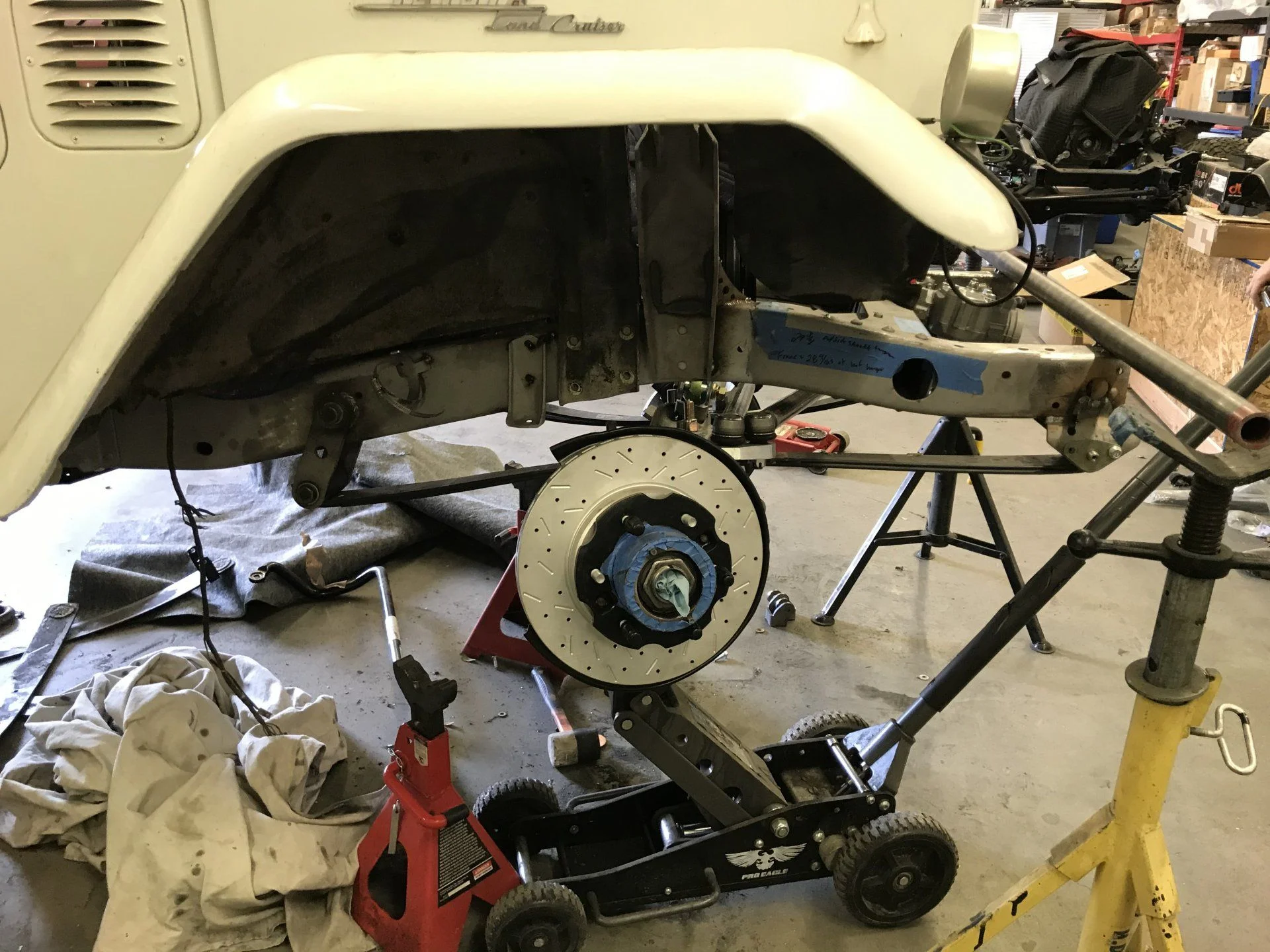

Cheers

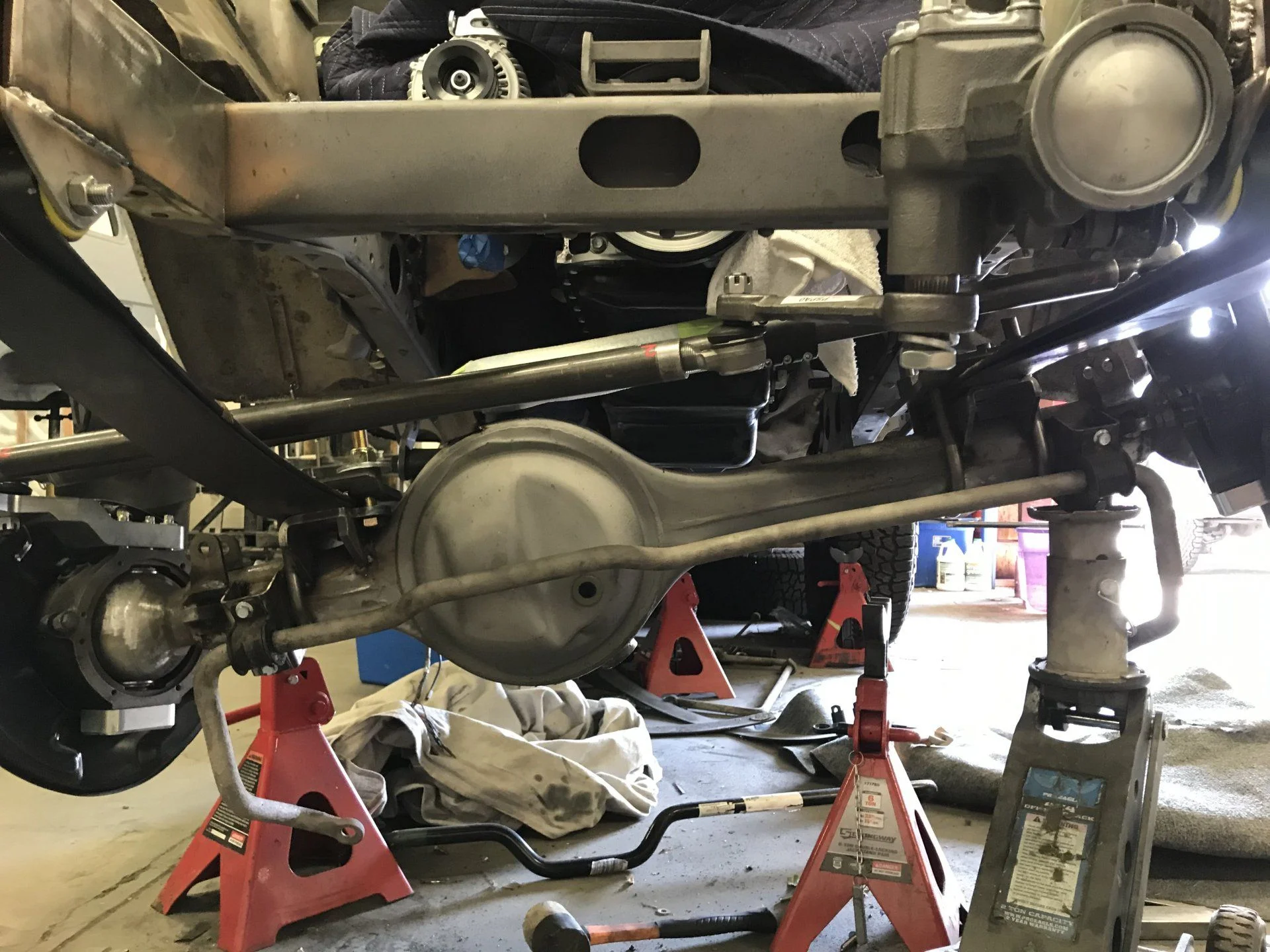

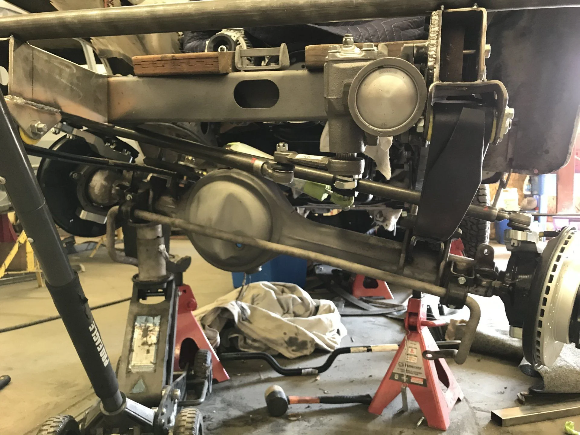

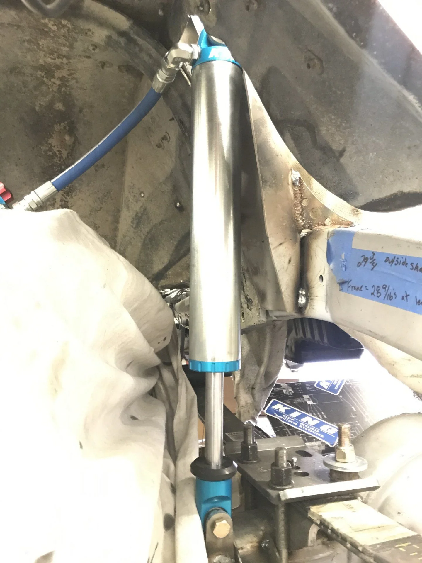

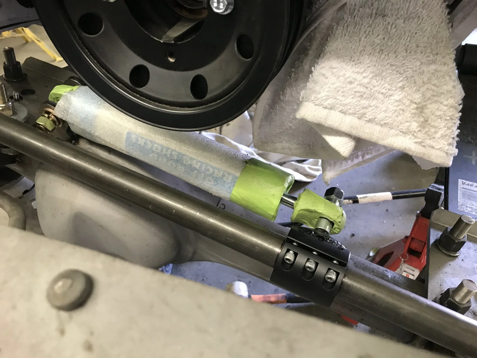

It looks deceiving since it is such a large body and shaft but that is 5” up travel on the shaft and the Cruiser is sitting at ride height.

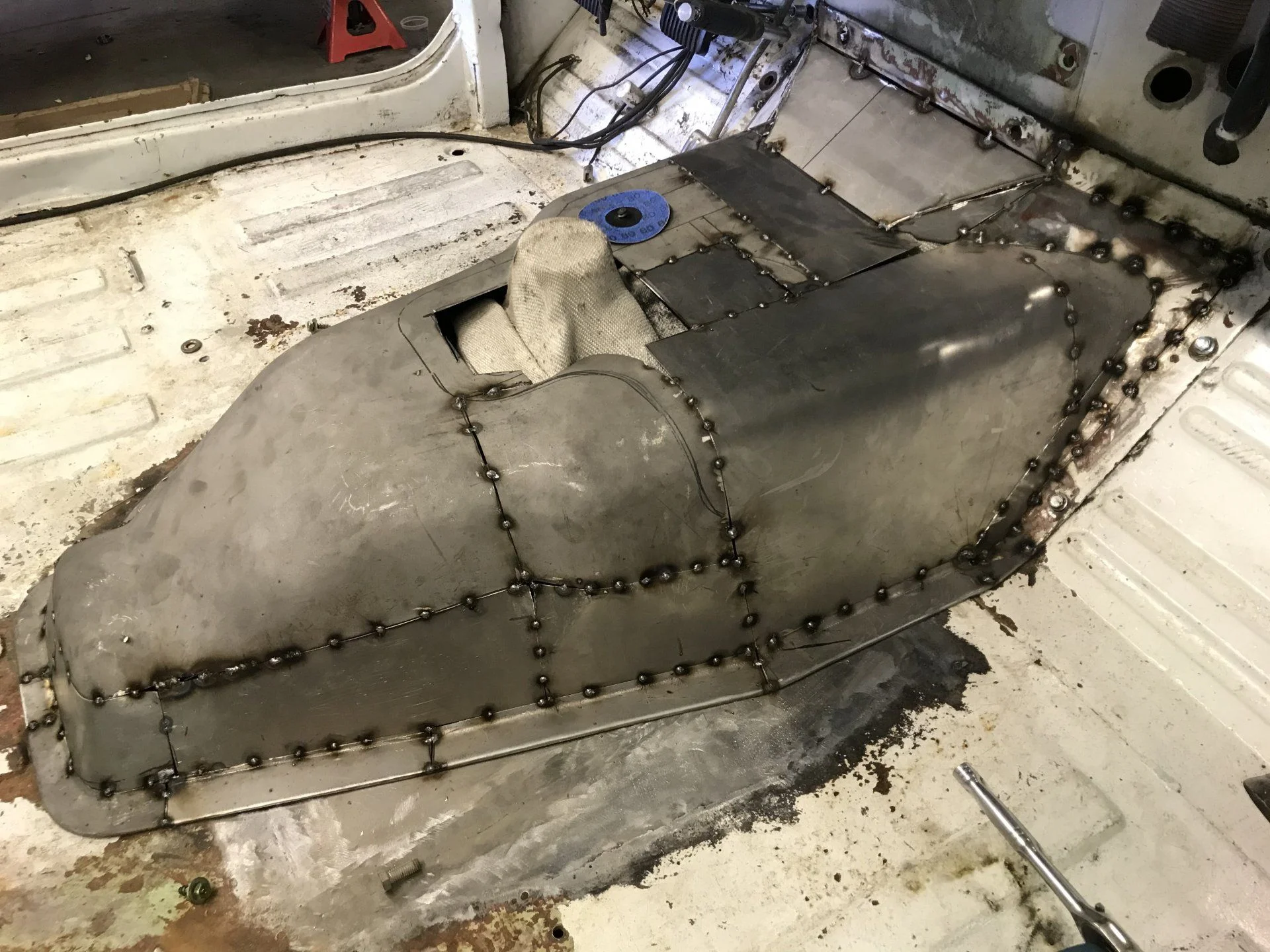

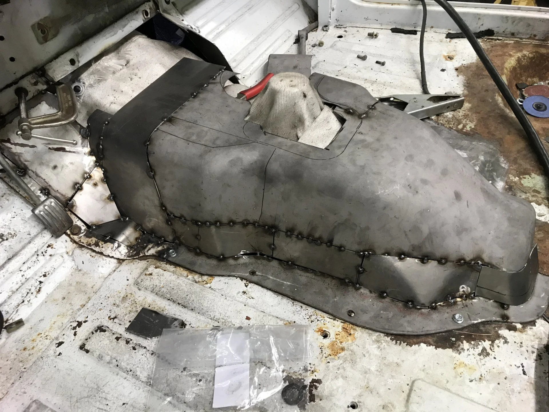

Changes made to trans tunnel, it’s really starting to come around.
Lots of foot room here, even for winter boots.
On the final stretch.

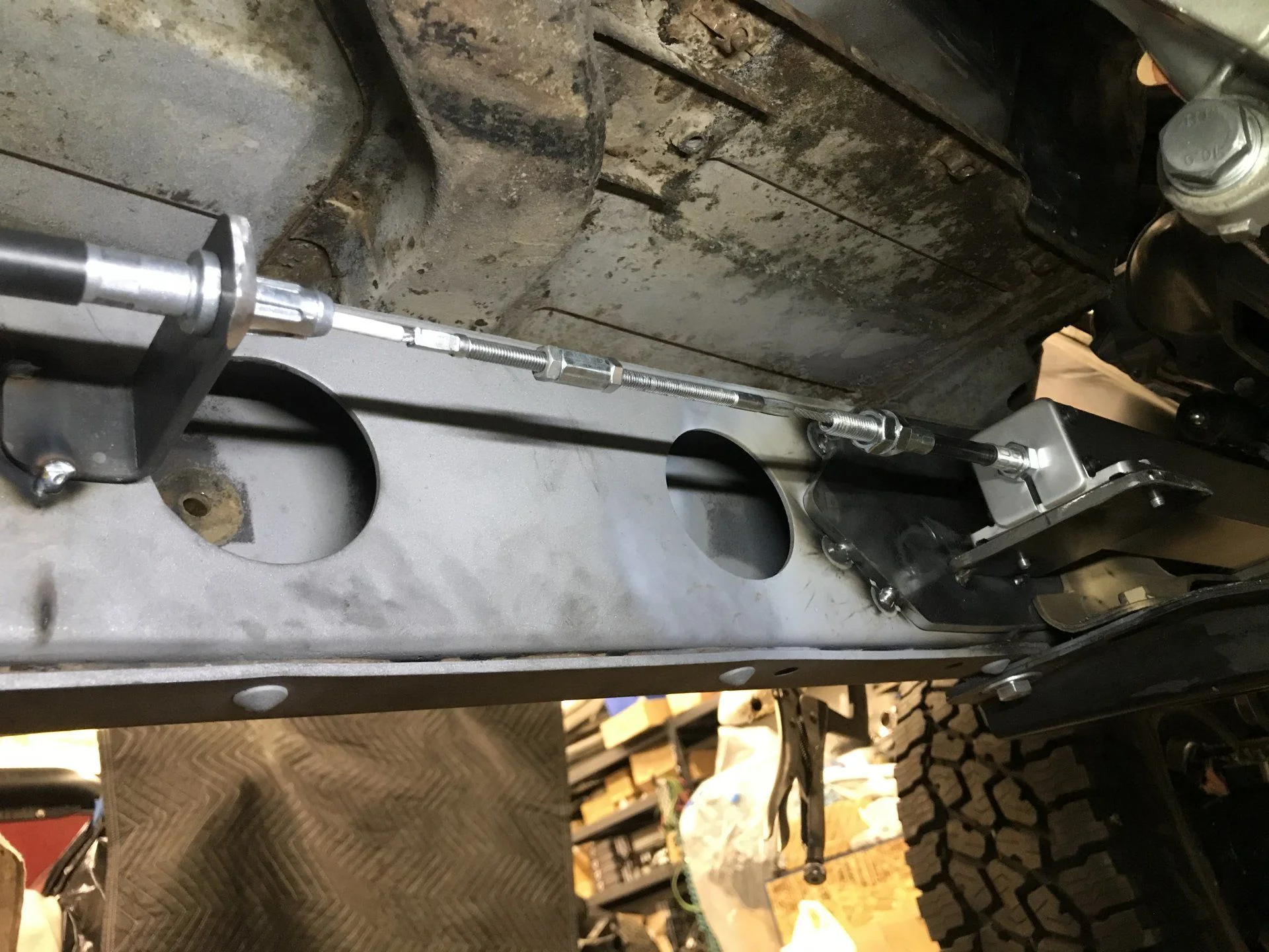

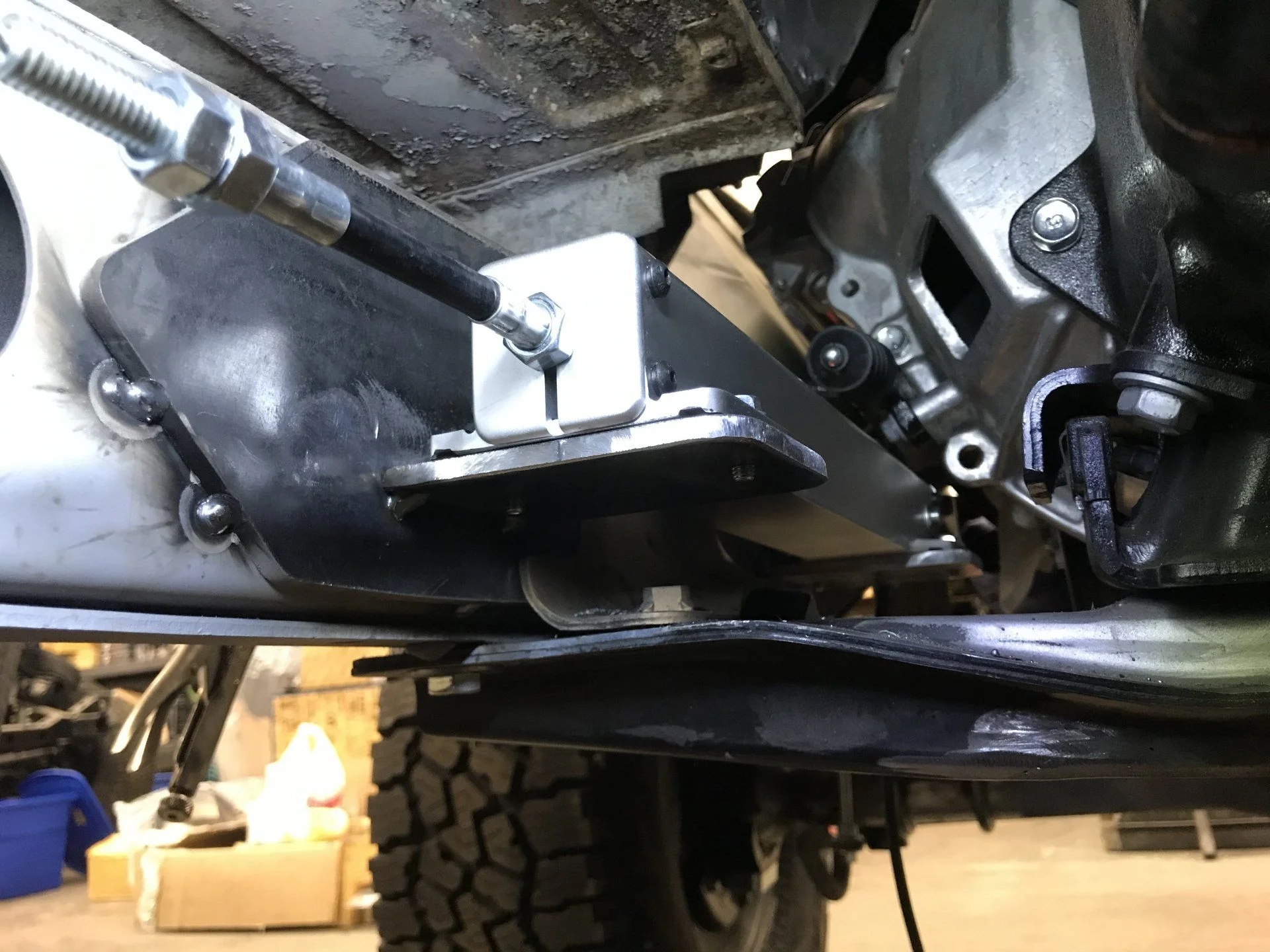

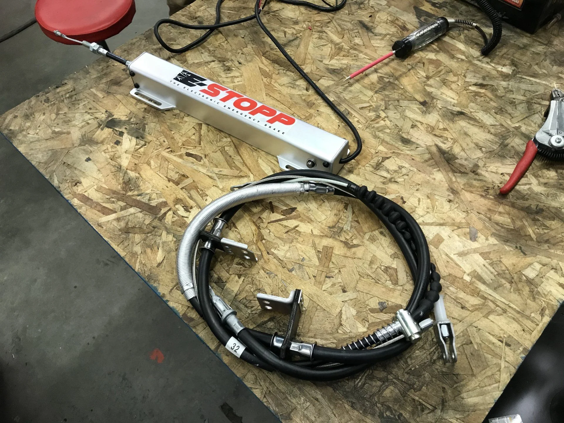

This goodie is going in so the truck has a very good ebrake.

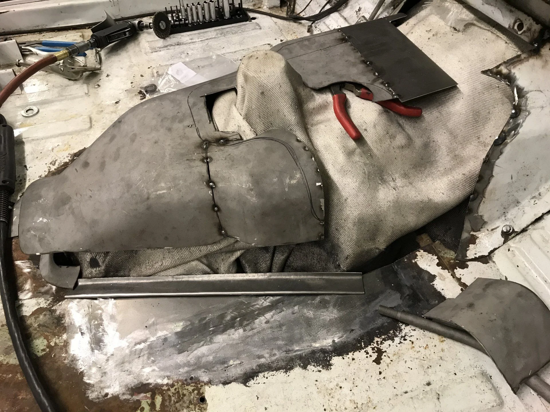

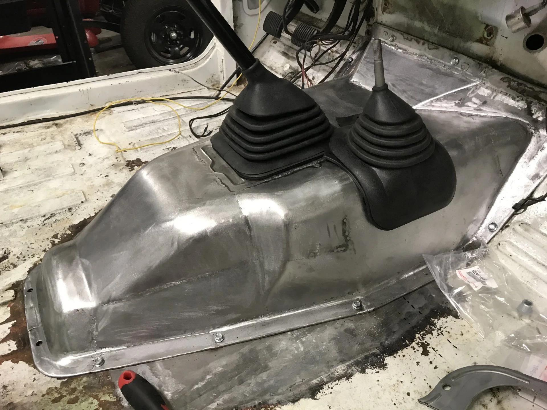

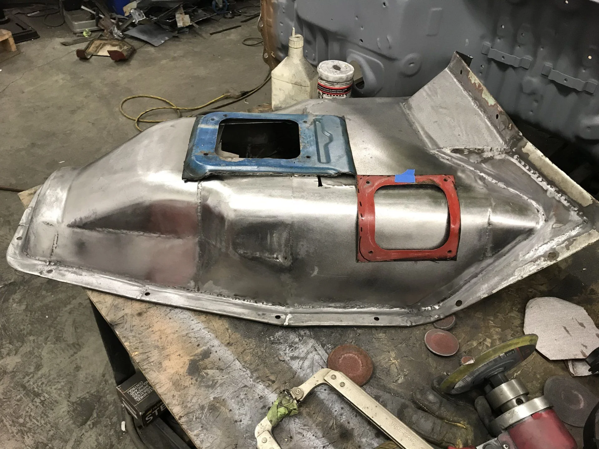

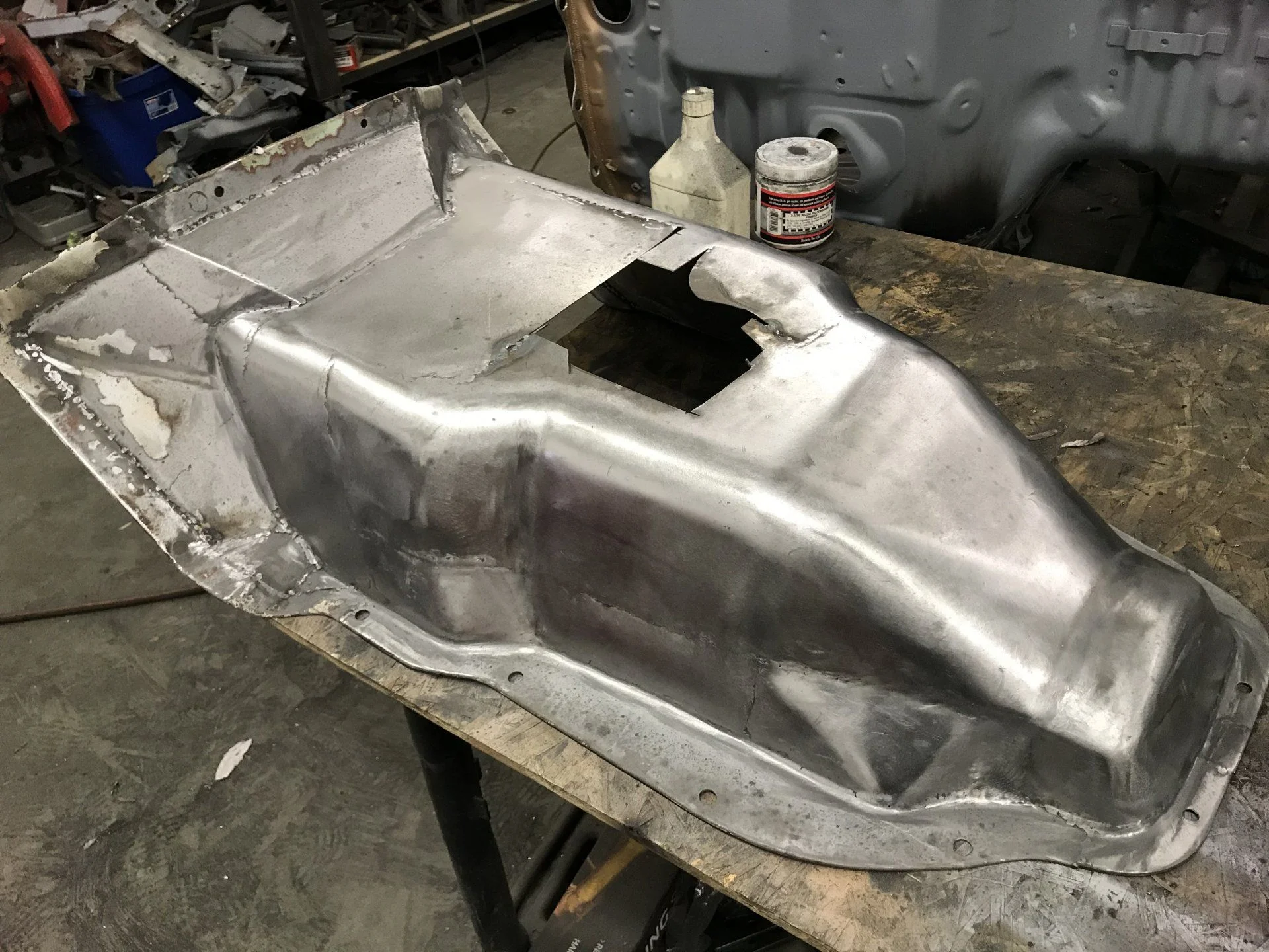

Trans hump all roughed in. Still need to fit the shifter boots, then final welding and clean up. We could have built this out of less pieces but we wanted to retain as much of the original shape a ls possible.

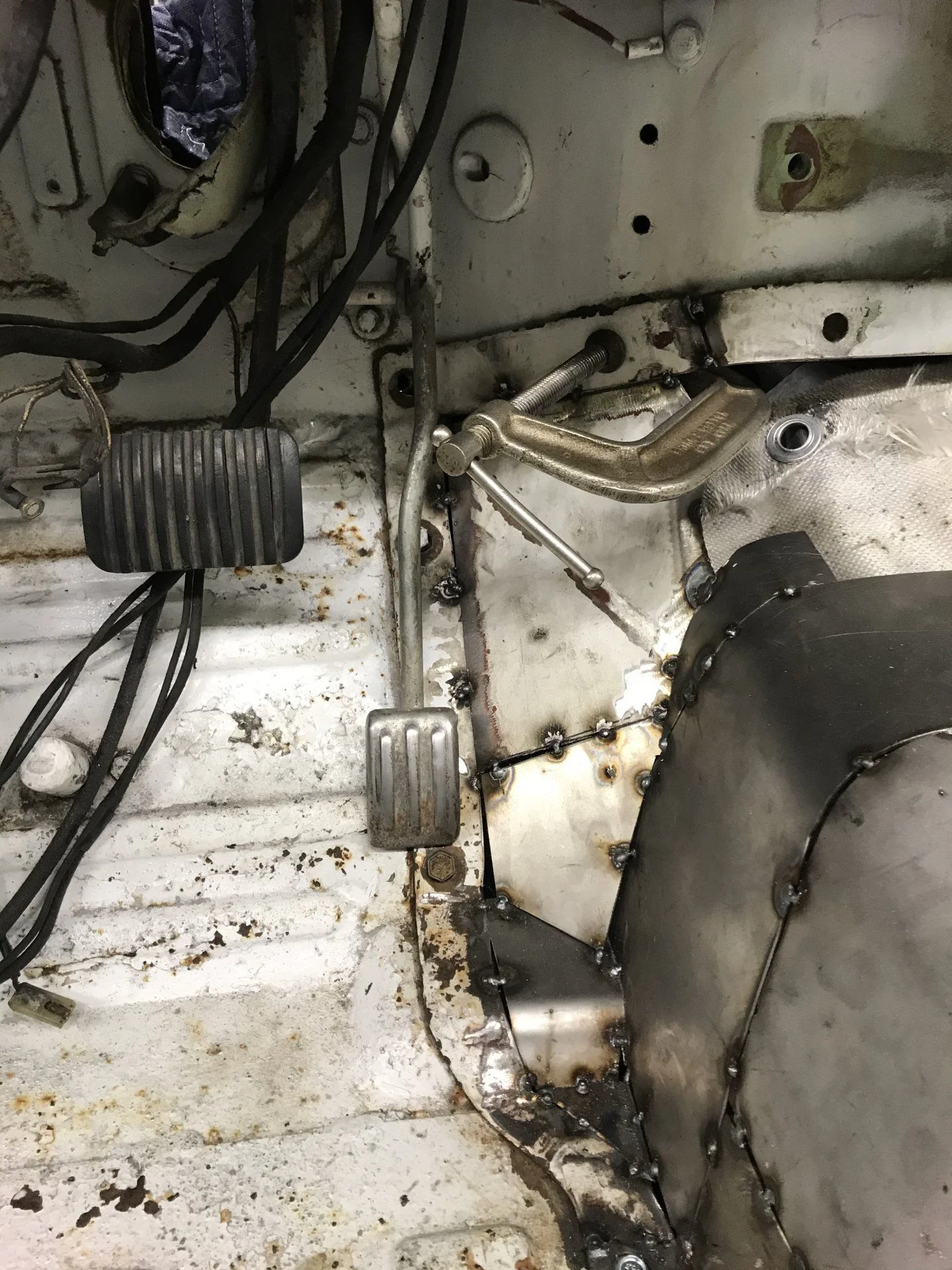

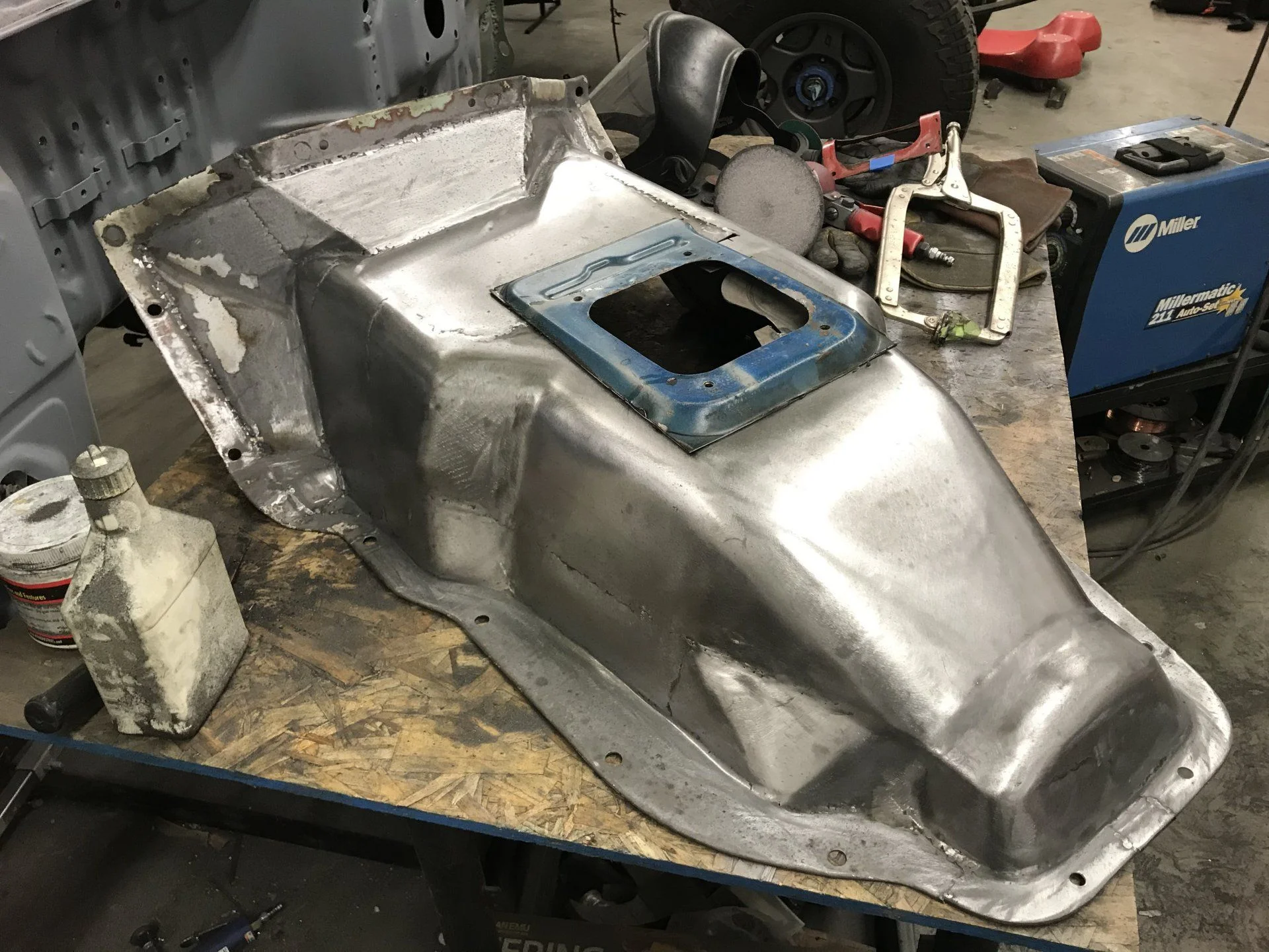

Getting far along with this.
Bit more to do an getting ready to weld in these FJ60/62 pieces for shifter boots.
Cheers

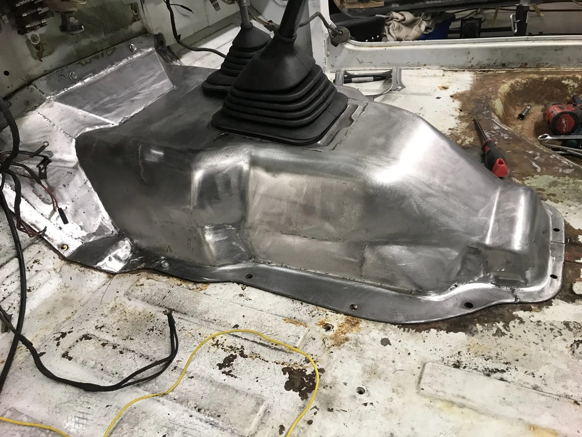

Pretty well there with this.
It will need some body filler to smooth it out The rest of the way but not much.

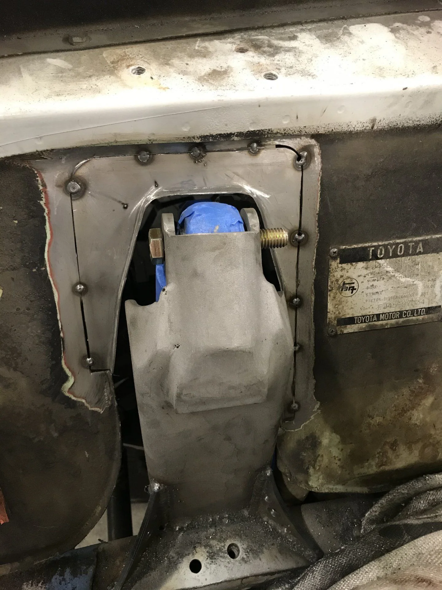

Starting to work on this and how I will graft in the later style for a clean booster/master install.

Can't answer what they got, but if the kit it comes with an actuator and control box.
Correct.
We discussed setting it up so the stock lever would trigger it. To keep cost down it was decided to just set it up on a switch.
An added bonus to the Estop is theft protection. Without a tow truck to pick up the back end or knowing where the switch is you can’t unlock the ebrake. We are not mounting the switch on the dash. 😉
Cheers

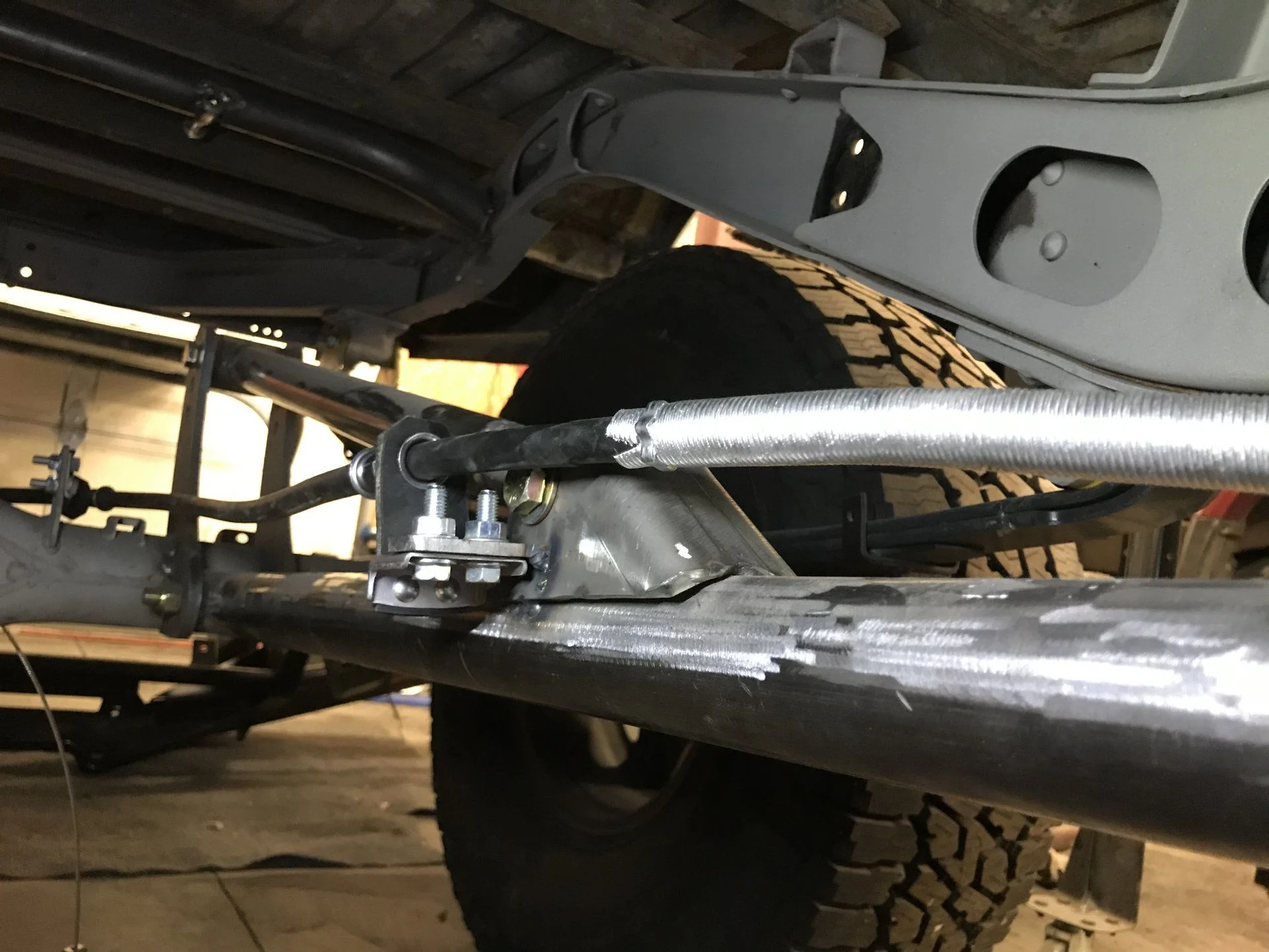

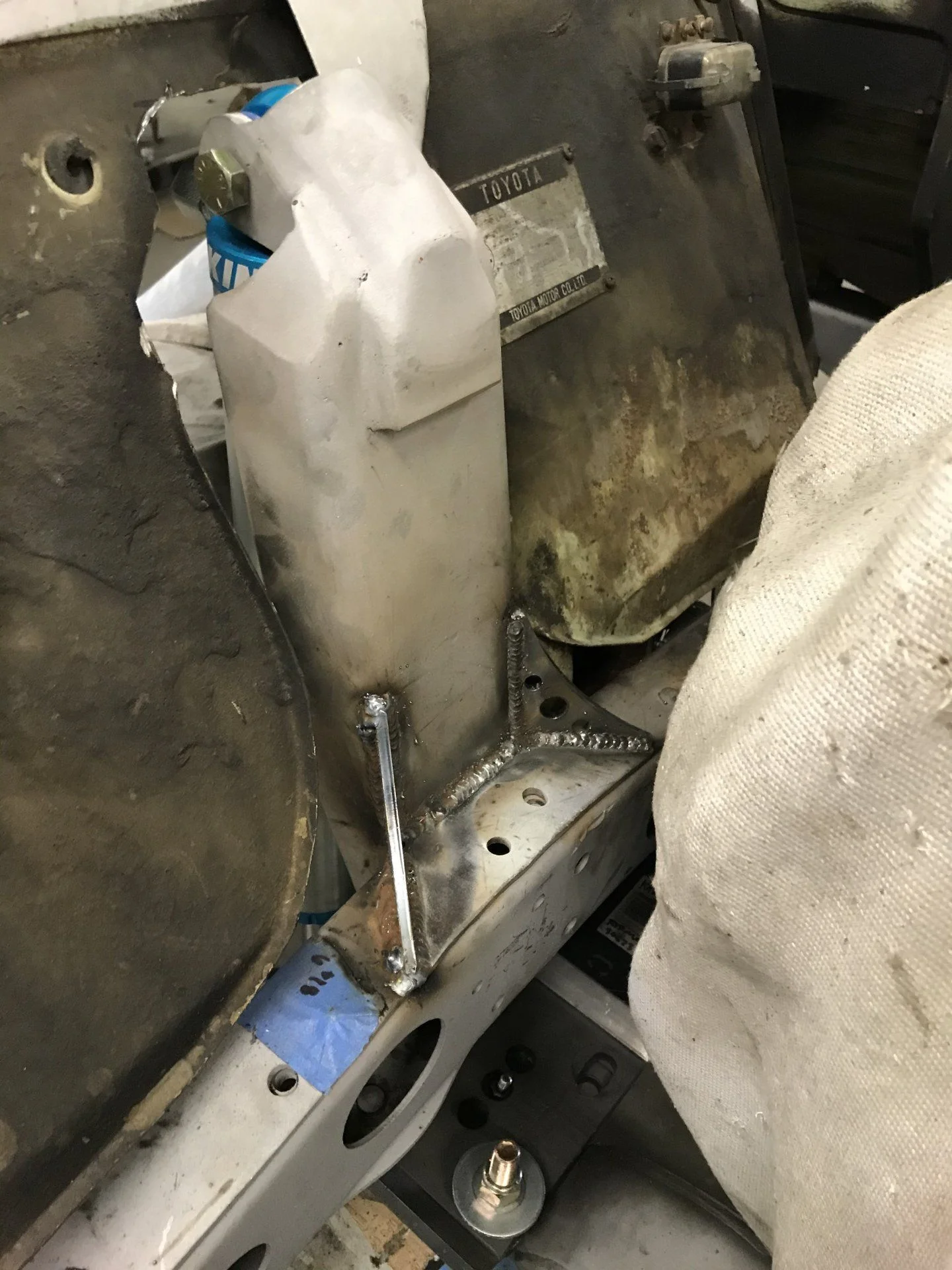

Estopp installed and ebrake cable ran. Did I mention it yet? We used a 75-series ebrake cable. Good length for the 45 and correct for the rear axle setup. 😎

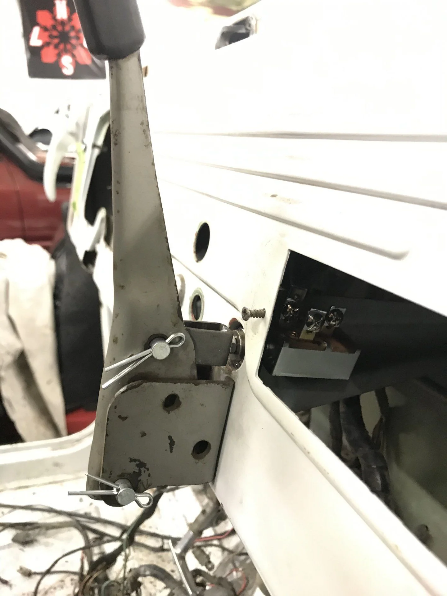

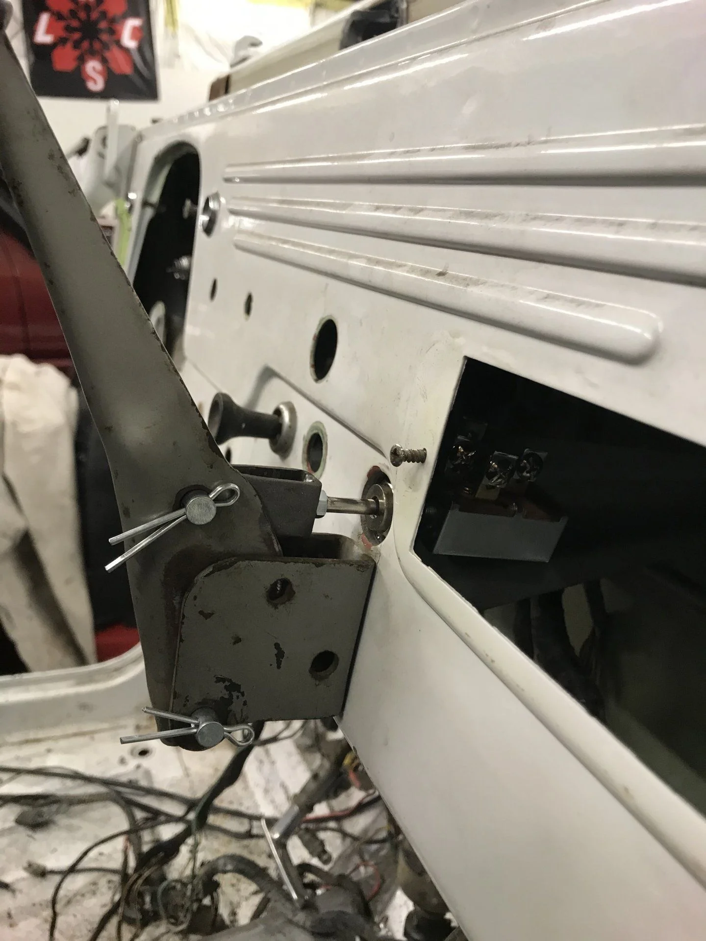

Our stock lever being used to trigger the elockers.

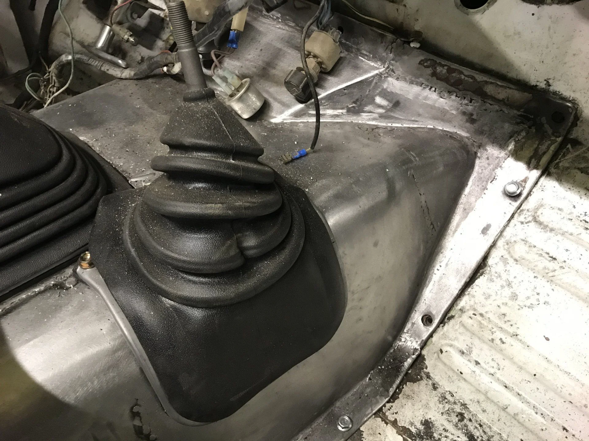

Tcase boot and shifter finalized.

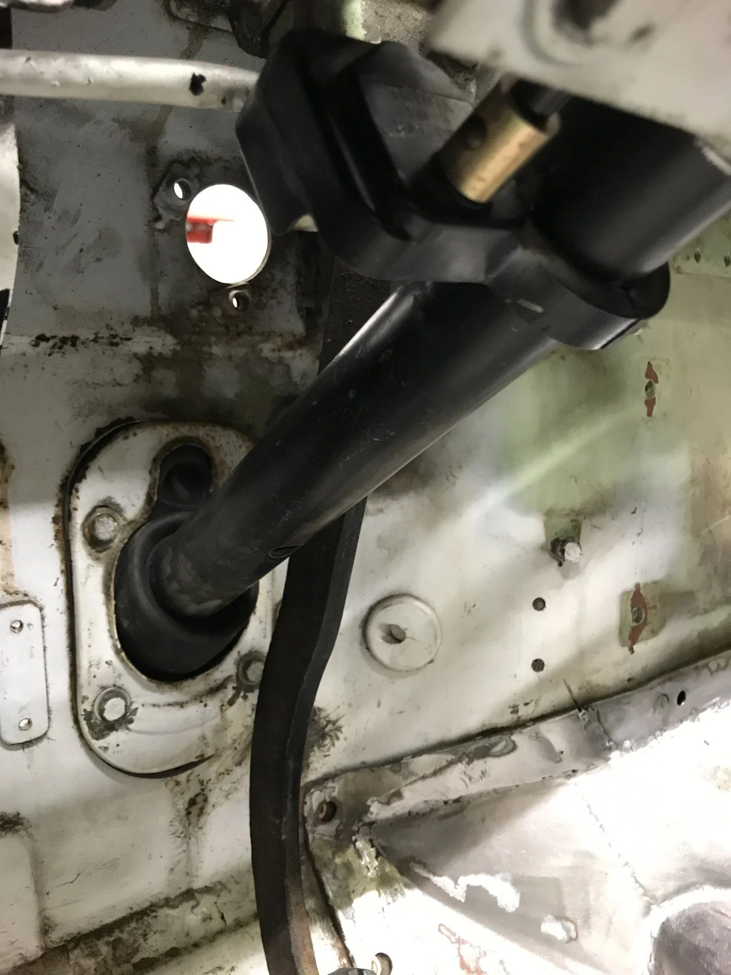

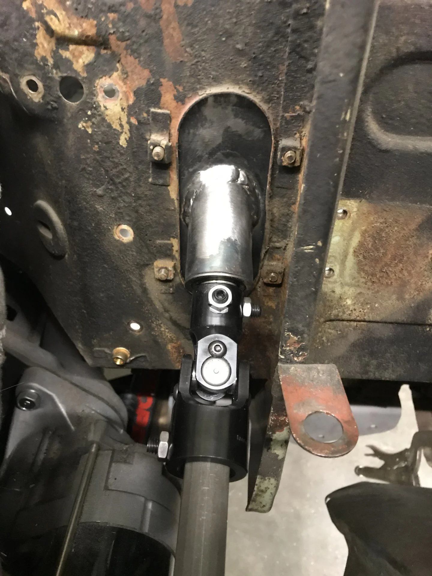

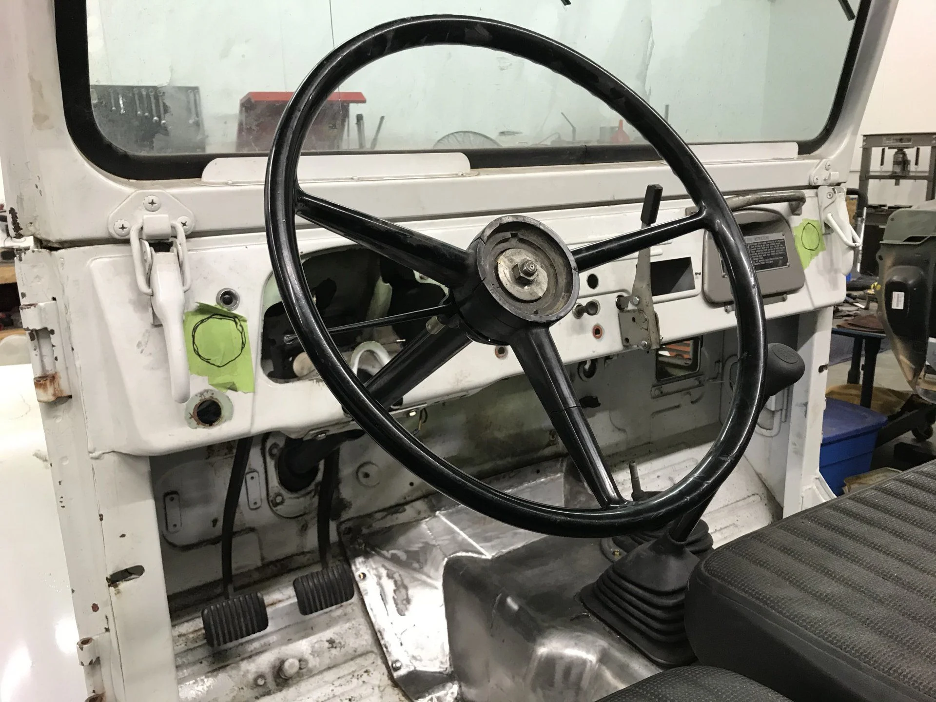

Steering column and wheel pretty much all worked out.
Thanks @Onur for finding us the early column to firewall boot. 😎

lots of really nice work man. i think you're going to want some gusseting on that tab that the brake cable goes through on the frame, unless I'm wrong all the cable tension goes through that point, no?
