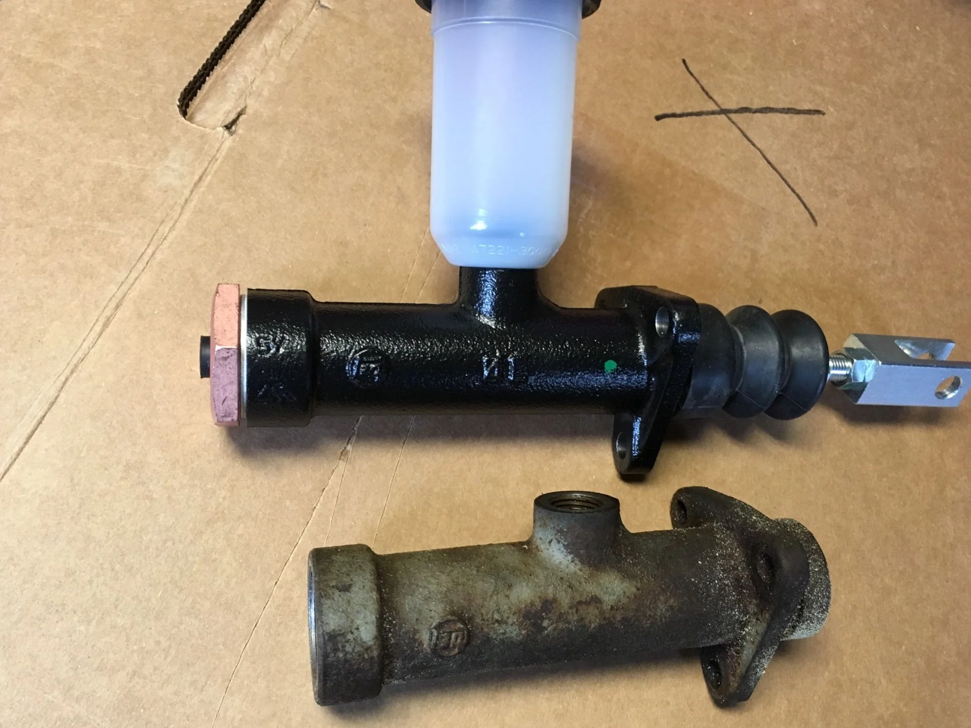

I had original, but it is badly scored up in the bore so not rebuildable. bought a master for a 70, because everywhere i looked 67 were out of stock. The pic for the 70 master showed the large end cap and i figured i would just swap my 67 end on to the new master, well part showed and it is solid one piece master. cheap fix was just adapt to small line, as i am stuck with master cylinder. I will check out the 10 mm nut size.

Large end Cap??
Did you get a 70 Clutch master cylinder?
Can you post a picture if it?
No, its for the latter 70 brake master, Like i said earlier is showed the large end cap and was going to do swap like others have done with a clutch master. No such luck, showed up with solid housing drilled.
