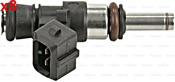

Some nerd tech for you Mr. Bob M. I'm at the part that I need to start telling the computer what I have so I'm spending the morning printing everything to bring out to the shop and thought I'd share the injectors I used and why.

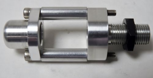

My original plan was to use the Alkydigger injector holders and try to make this a quick simple update to the Mrs. Pickup. Looking at the length of the threaded section you can see my first issue, with the spray angle (20° for mine) and some quick math you see that the fuel will hit the sides on the adaptor before it enters the port creating larger droplets so I had ordered extended tip injectors to help with this.
Fast forward and the Alkydigger adaptors wouldn’t work so I moved on the plan “B” and tooled up to machine the Hilborn housings to accept the injectors, I already had the extended tip injectors and like that they extend down into the ports slightly so that’s what I used for this one. (FYI I used Chevrolet flex fuel 12613411 injectors on the other set up)
The Holly software ask for the injector by part number assuming you are using an OEM or one of their injectors but the Bosch Injector I’m using was originally for a BMW motorcycle and not on the Holley list and I’ll have to manually add the info.
Bosch EV14KT compact extended fuel injector, part number 03-21 0280158038.
43.5 PSI
31.4 lb per hour
12,00 Ohm resistance
These injectors are good for about 400 HP running at 80% duty cycle on gasoline and more than enough for anything we will be doing with Mrs. J Mack’s pickup in the future…
