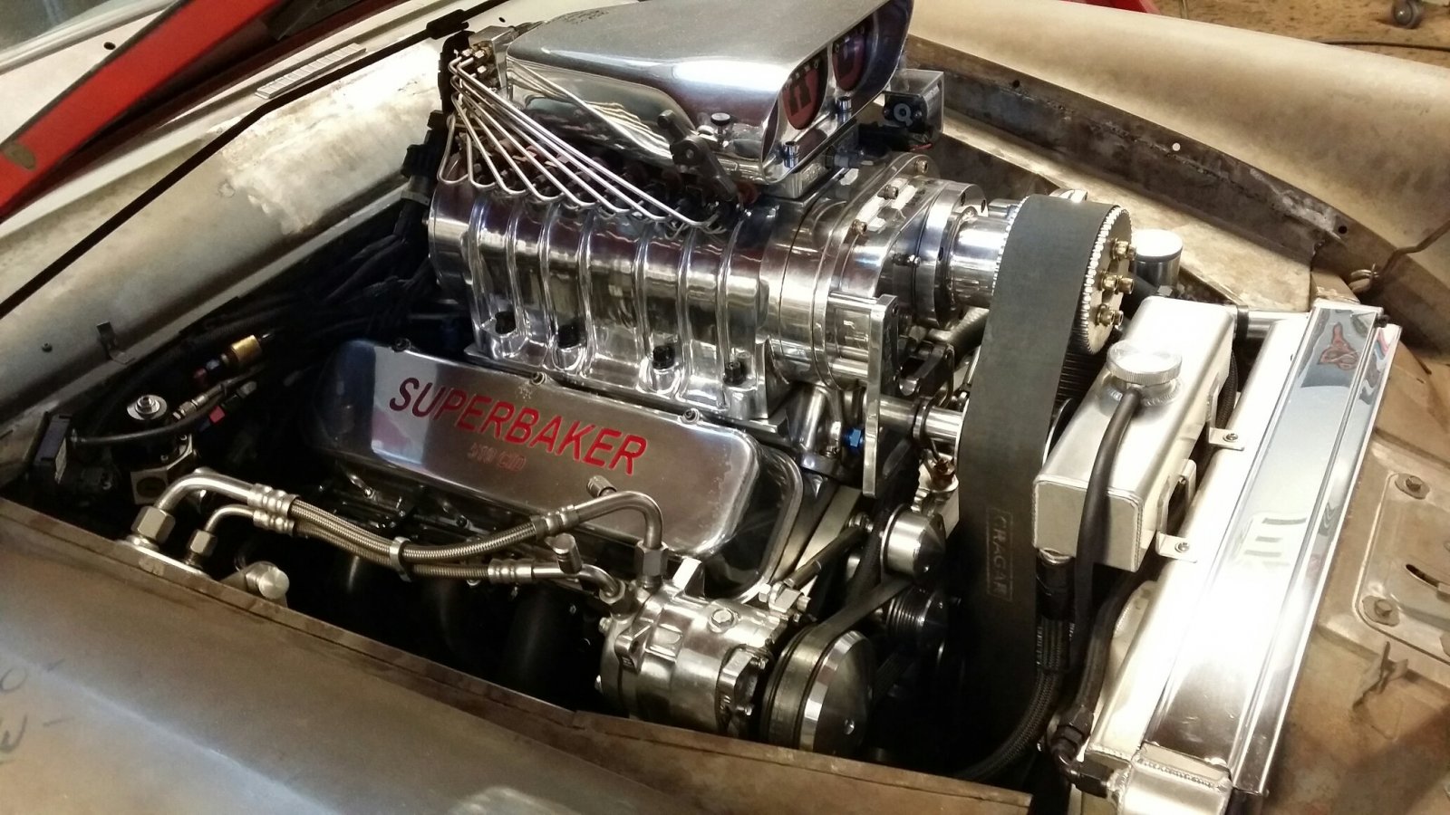

Well there is no turning back now, going to be a few weeks of bad decision making...
Trying to fit valve covers, throttle linkage, cooling lines and fuel lines all in the same spot...
Now that I have a better idea of how everything is going to fit i started on the fuel delivery lines and the rear coolant lines, going with stainless for these, the copper I bought was cracking at the flare and no amount of annealing seem to cure it.
Trying to get all the last little BS crossed off the list before the final install..
Transmission kick down cable mount..
Pressure testing the fuel lines...
