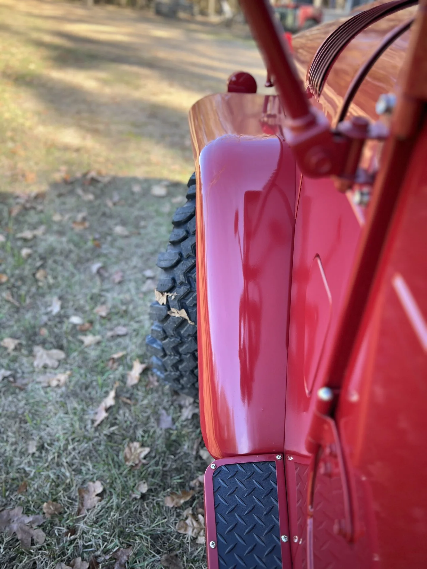

Super Swamper LTB 34x10.50-15 bias beauties. I fell in love with these during the Baja69 build, especially after I drove it and they were not bad at all on the road.
Per specs
  • Tire Diameter Actual: 33.6
But fair warning when Googling these, you might end up in a Jeep forum 😝
no one has asked yet?!
whats the actual tire height?!
33.25” on a 16x6 rim with 34#
50 RPM less than the 255/85r16 Yokohamas
