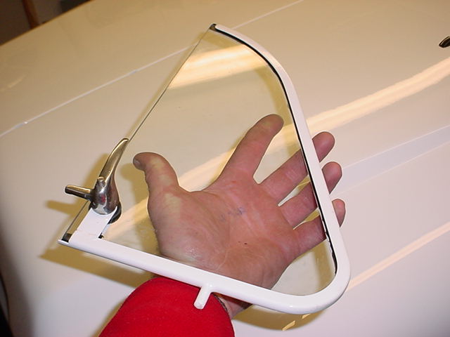

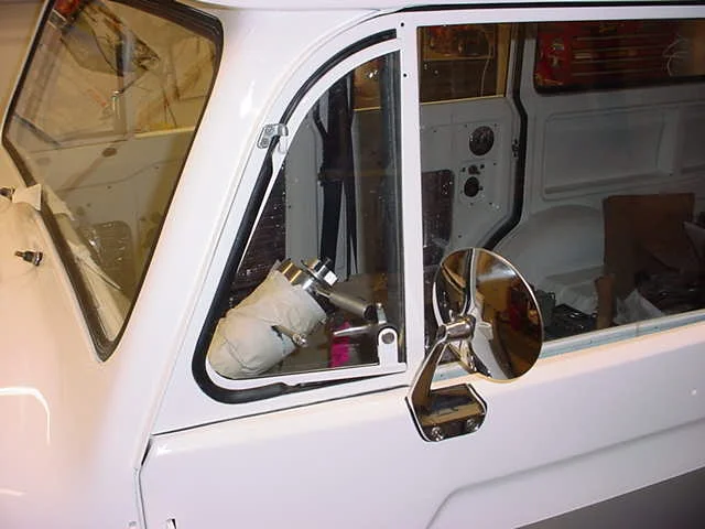

Got those installed tonight along with the turn signals. I also put back together the vent windows and there assemblies. Installed the windows back in, can't lock them yet because I don't have the stainless steel pieces on the inside. It would bark up the paint if I did without them.

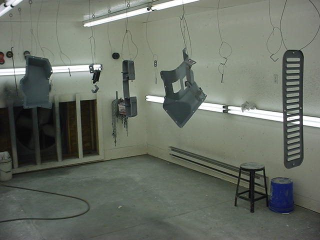

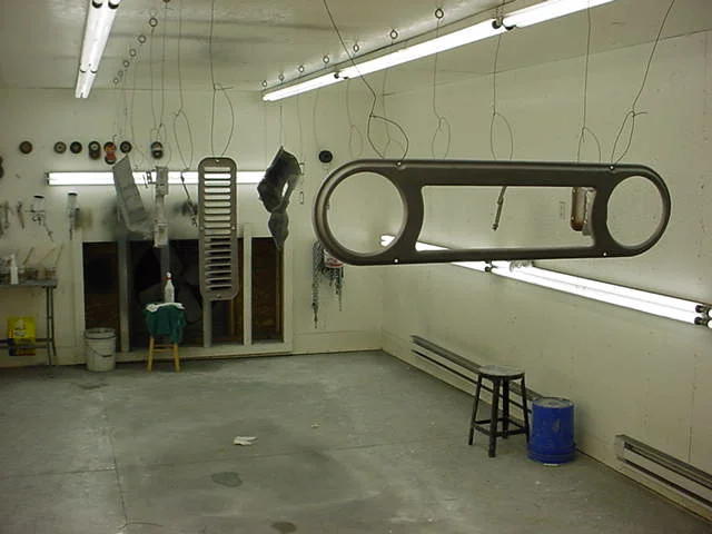

Good 4 hours on the lv tonight, but doesn't look like much.

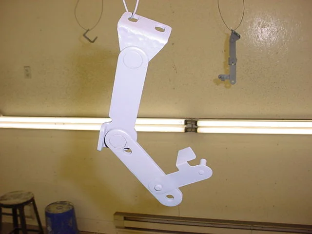

Got home and fired up the sandblaster. Blasted parts for over an hour, lots of little stuff. Got everything blasted, but the seat parts that Semlin sent me would not come apart. So, had to fire up the torch and heat up the pins and other hinged joints that wouldn't move. Got all the pins out and all the stuff moving again. Lubed everything up and then blasted it again. I am pretty amazed how nice those parts cleaned up for coming out of that lv in the woods.....:)
Hung everything up in the booth and shot a coat of epoxy primer on everything. There are going to be a lot of different colors sprayed, but I sprayed 2 parts black tonight. At least they will be dry tomorrow and then I can start in on beige and white and start clearing. I'm sure it will be a good day in painting tomorrow.

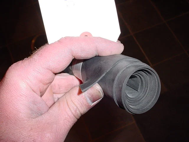

Also, ordered a 12" x 36" x 1/16" Burm-nitrate rubber in 50A durometer, that showed up today. When the paint is drying probably start cutting new gaskets for all the door handles and rear handle.
Matt
