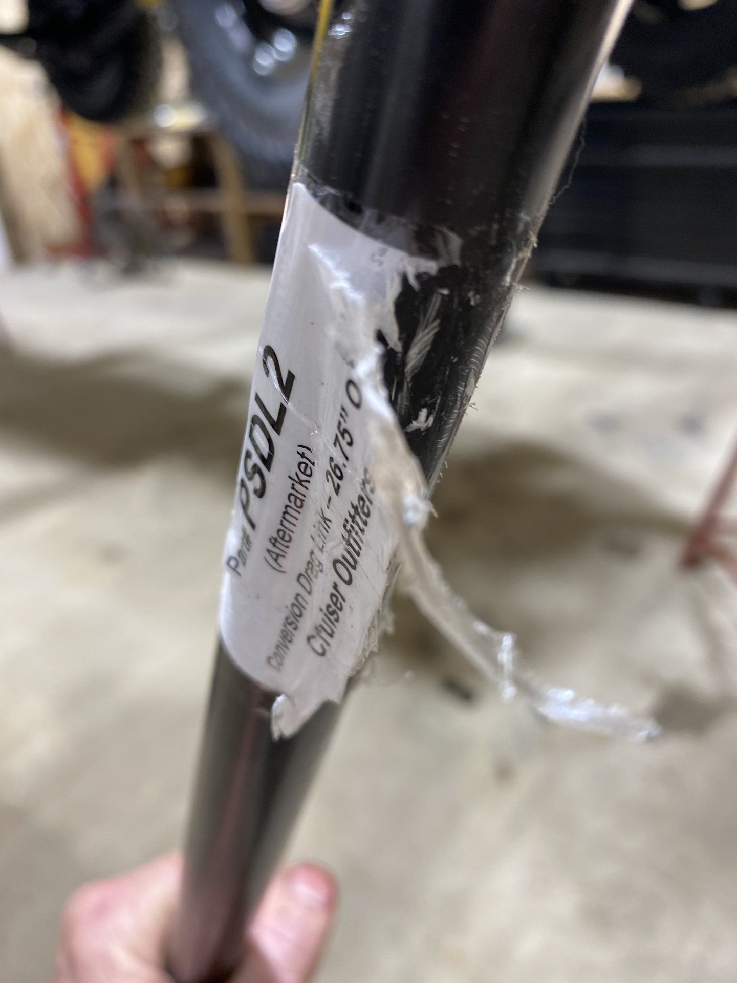

I offered @cruiseroutfit an extra $10 if they would send me a drag link without the sticker and tape from hell on it. I had to get the longer drag link they sell.
