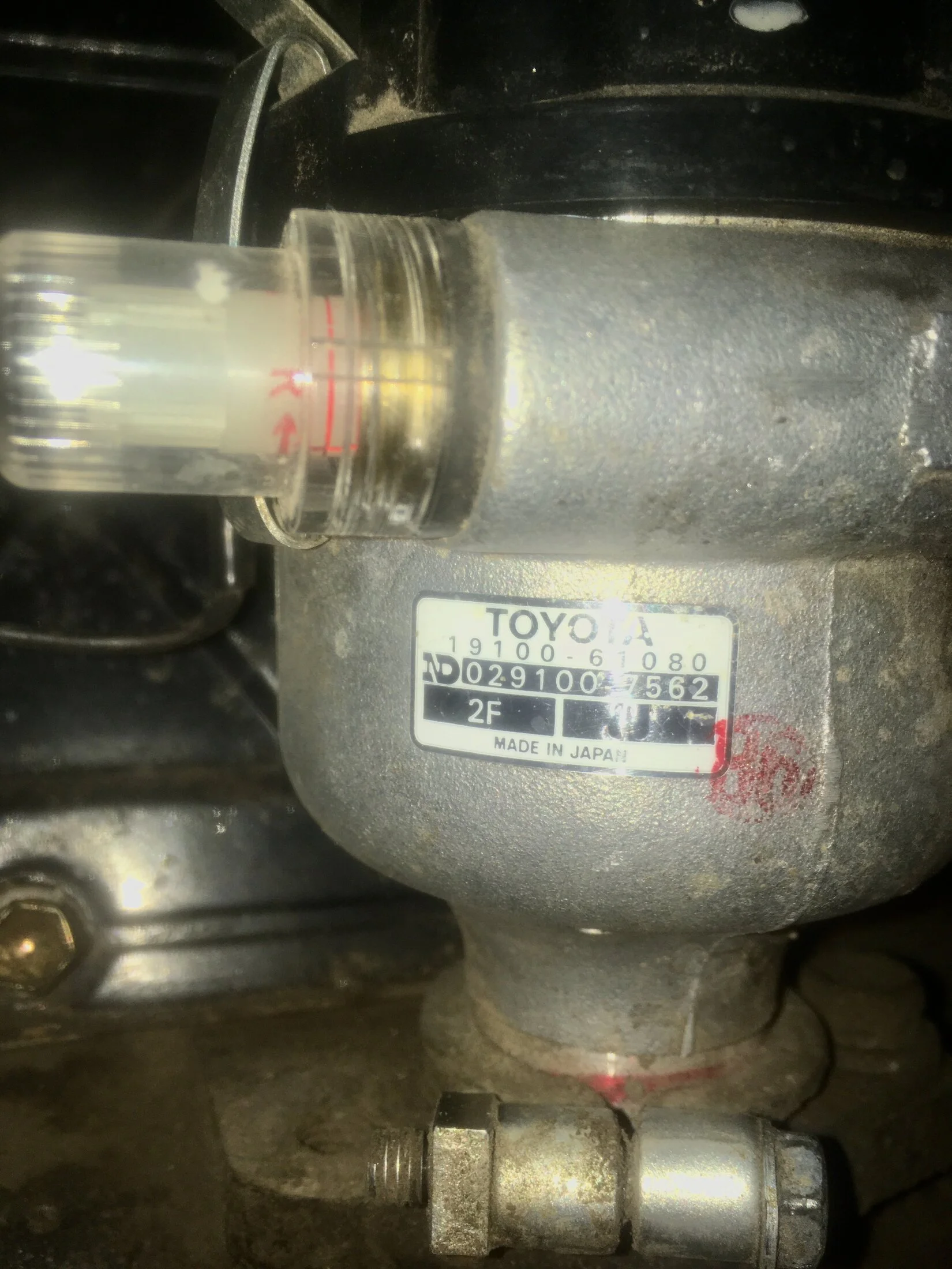

Found one thing screwed up in one of the 413S carbs that was messing with its acceleration pump, fixed it and things are better. But the tach is still twerking a bit at higher RPMs (😂 that’s 2000 for this old cowboy). Coil resistance still checks out ok, but my dwell is very low. So I’ll take a look at the points and gap tomorrow. I have a non-USA OEM dizzy, can’t find anything specific on replacement point part numbers (email to city racer is in where I got the dizzy to see if they know). Maybe it’s just too much gap, we’ll see. Wondering if that’s causing the tach jumping, but the dwell meter is steady. ‘65 parts catalog says dizzy points are 19142-29020 and several sources say 04191-40010 replaced those. Anyone know anything about what points work in these non-USA OEM dizzys?
What's the part number on the tag on the housing? Starts with 19100-
I think with more snooping it looks like the replacement point set is actually 04191-41010 for this dizzy. Or 19145-41020. 😂
Points, 19145-26060.
Condenser, 19133-60040.
