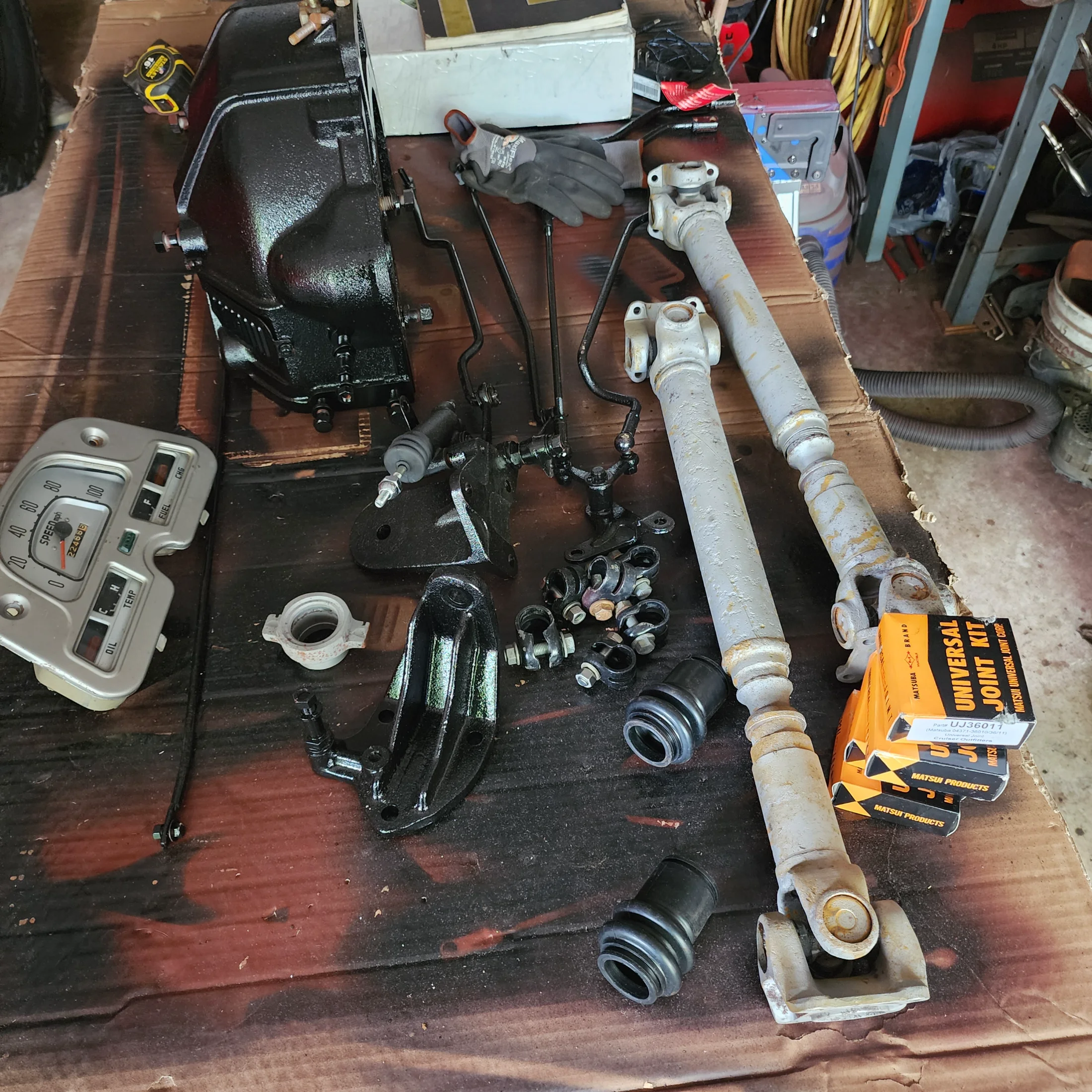

Continuing the gathering and cleaning of parts.
Scored another cluster to harvest some parts from.

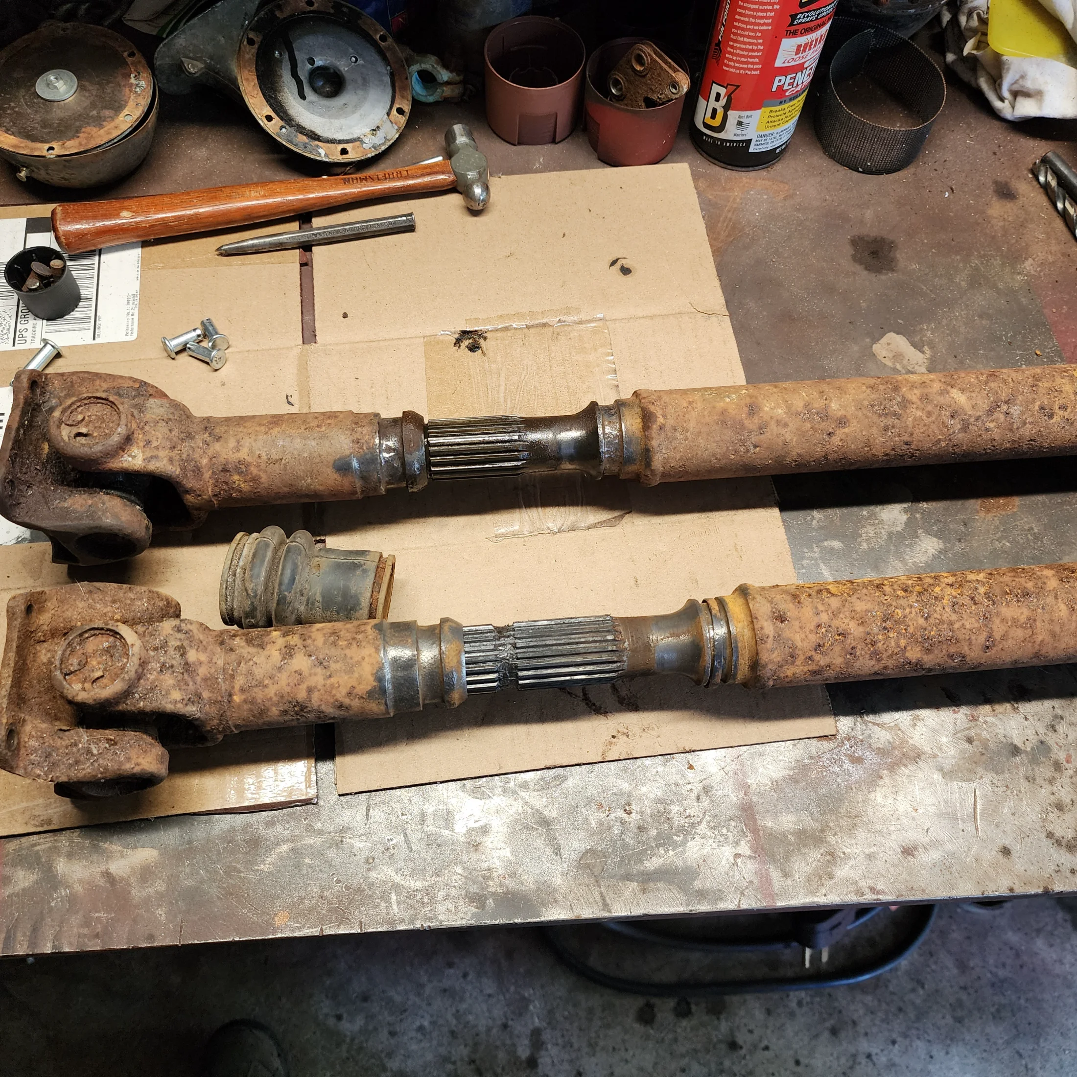

I just noticed that the front&rear prop shafts appear to be the same lengths.

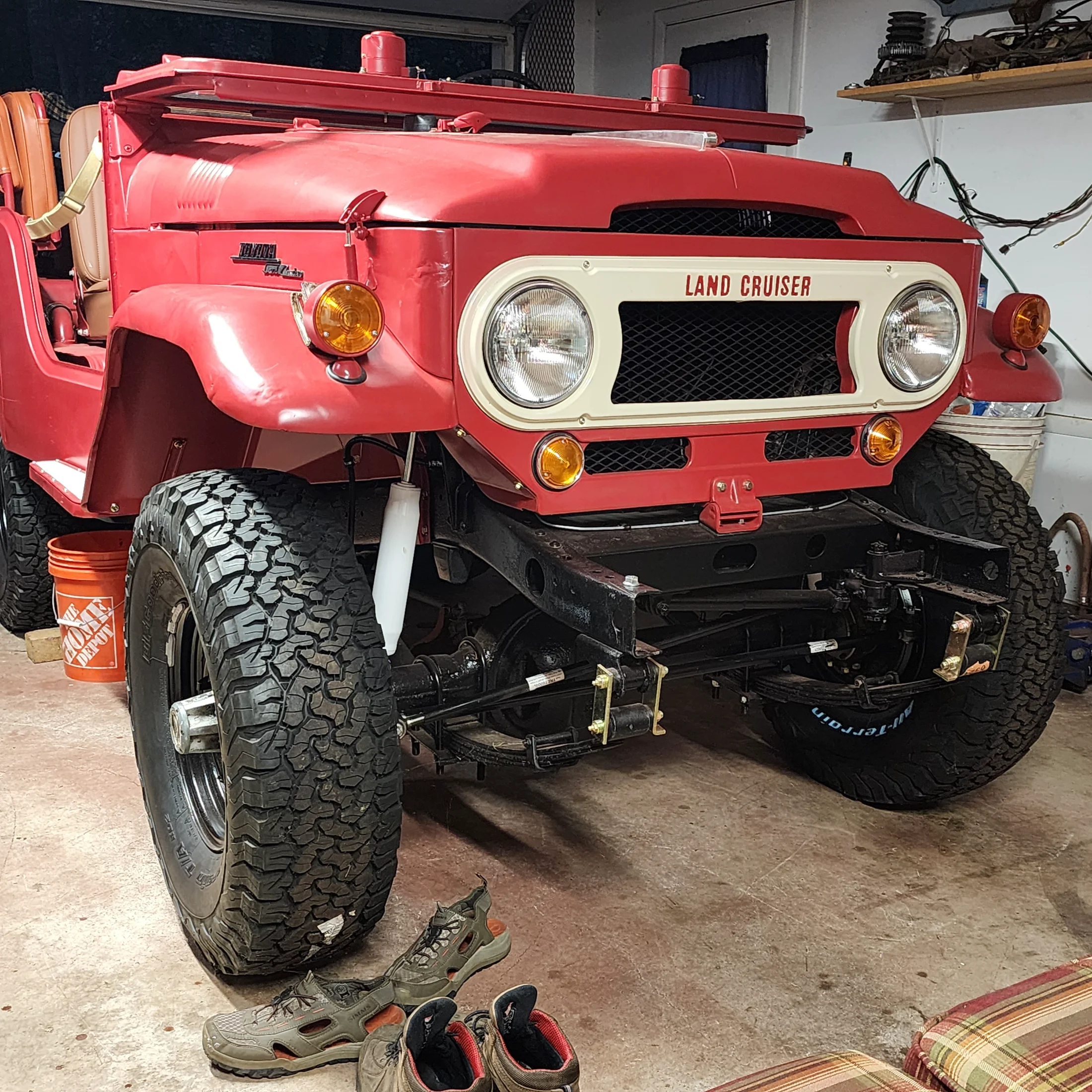

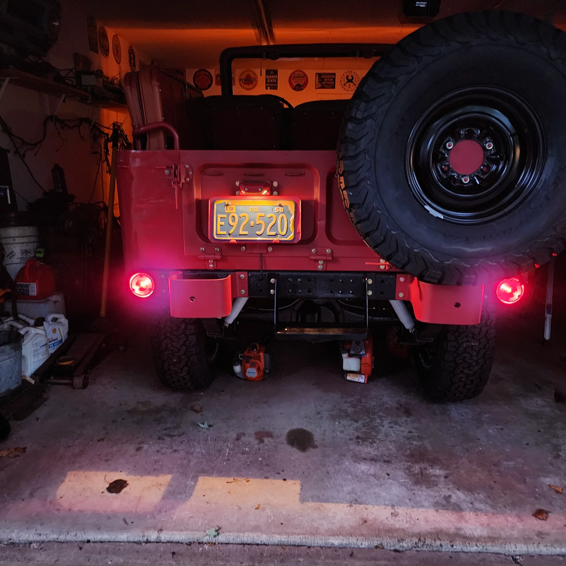

Still need to clean the clear parking light lenses and replace the ambers.
Did you take the stock bulb shades off of inside your cluster or are you running led bulbs? Looks nice and bright.
Hoods in place with the bulbs it was parked with in 1978.

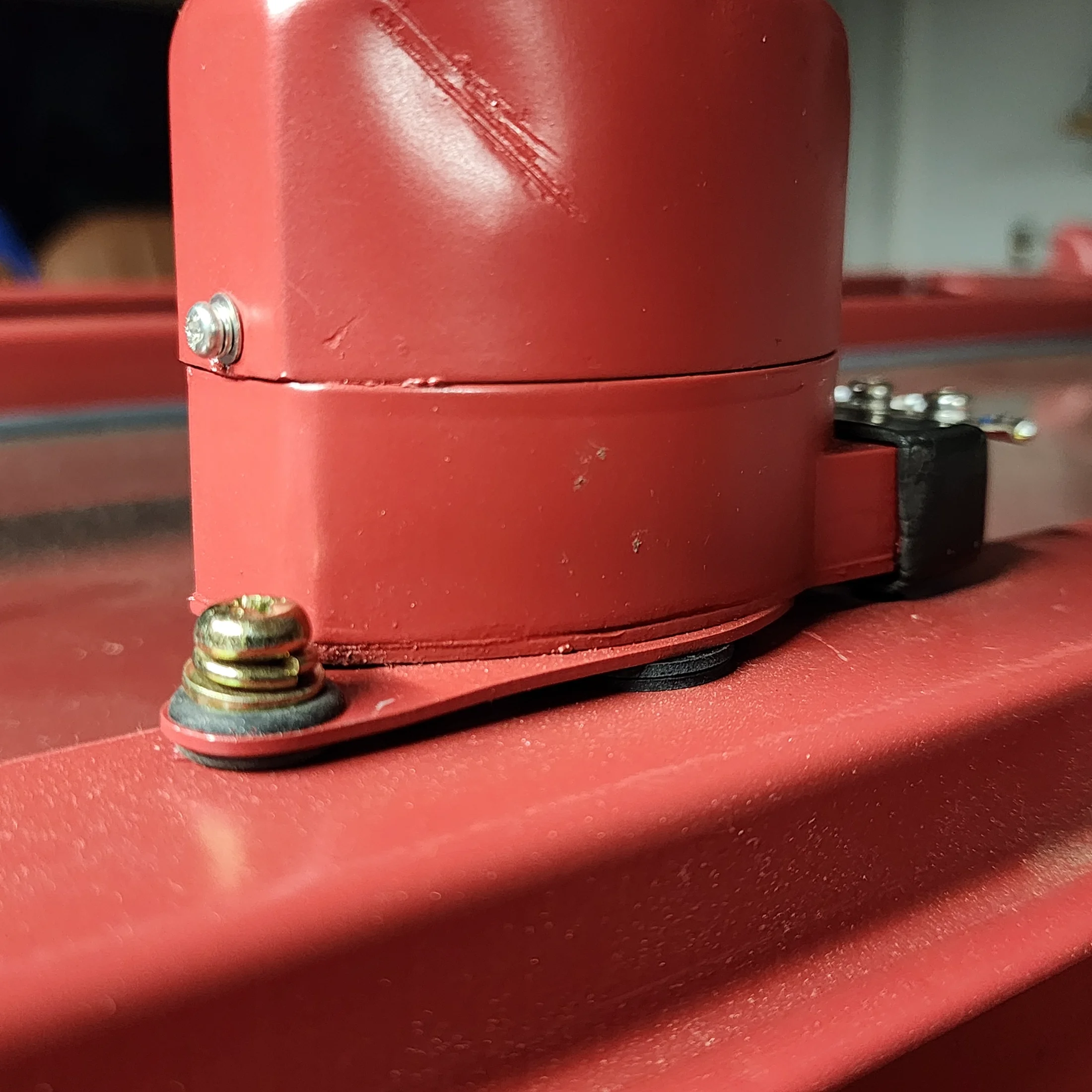

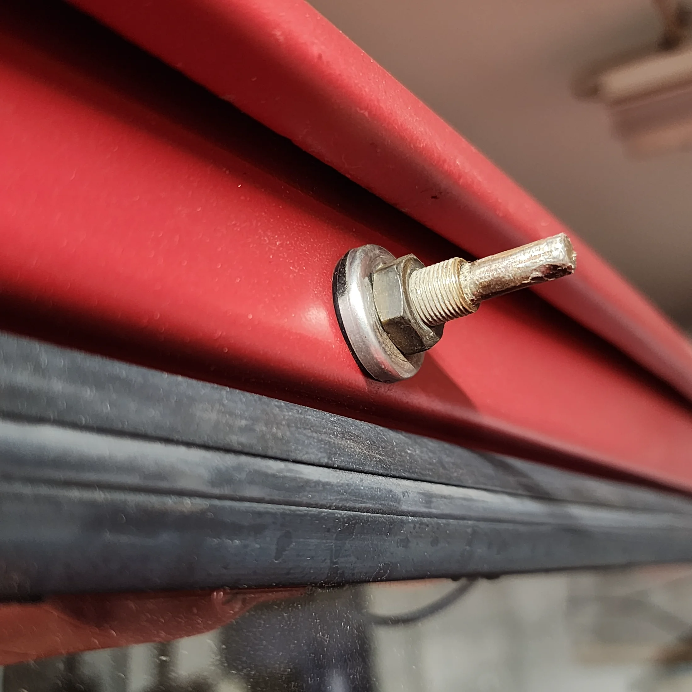

Not sure why, because with no top it will seldom see rain, but broke down and bought one of the new wiper motor kits just to check it out.
