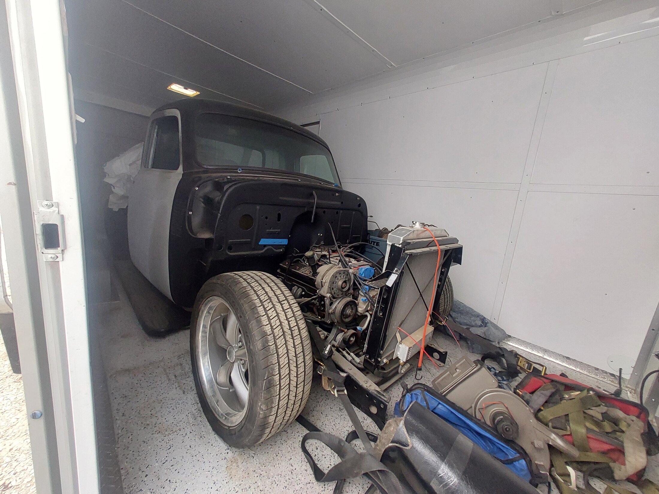

Is that AD on the original frame or an S 10 chassis?
Original frame with C-notch rear and Mustang II front arms.
I'll get better pictures once I get it out of the trailer.
