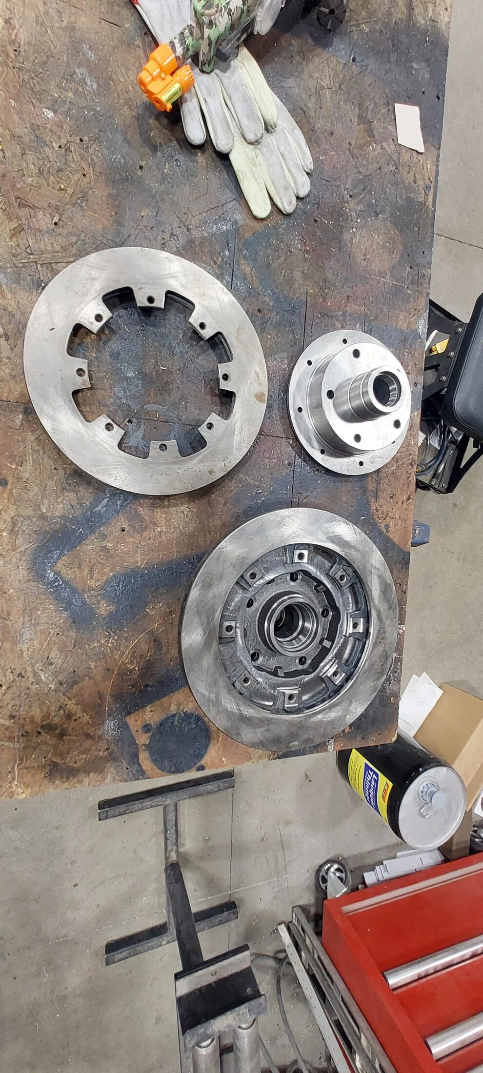

Made my own hats for some 11" rotors, the ones I bought made the track width 1.5" wider and I was having a hard time finding anything that was affordable.
The original 9-in Ford mustang 2 rotors are the correct width for my needs so I machined them down for 11" bolt on rotors.

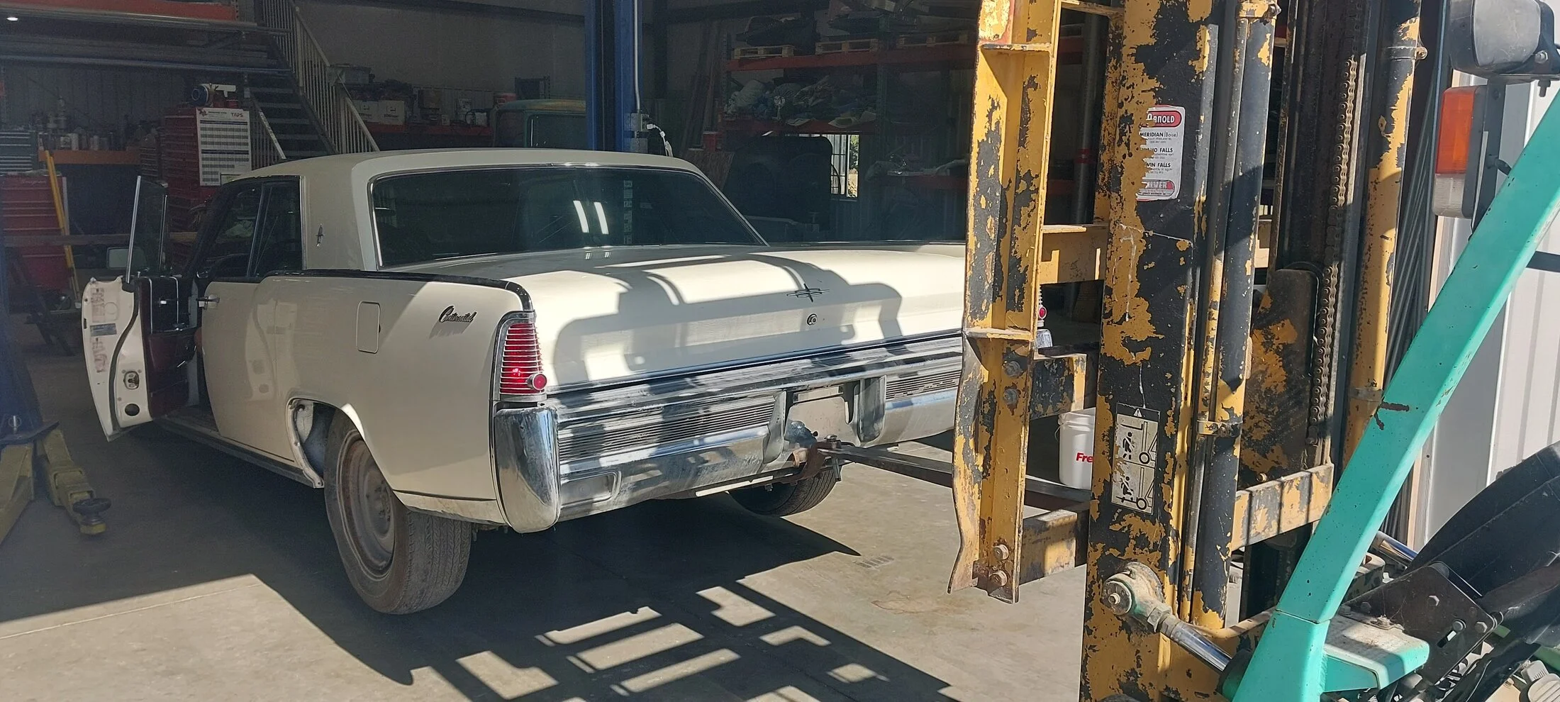

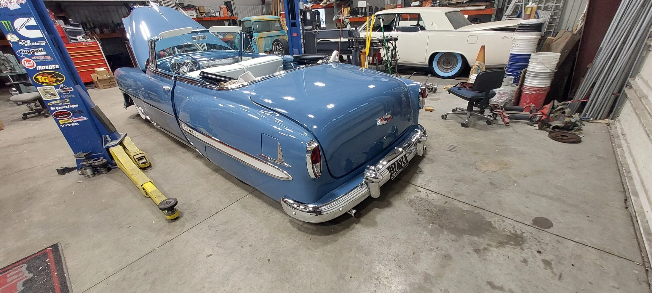

Pickup is pushed in the corner for a bit while I finish the 53 and the Lincoln...
WTF you sleep on da job?
I'm slowly working on the Lincoln as promised parts continue to trickle in weeks late and one of the rooms flooded a couple months ago was my reloading room and I've been spending way too much time building new benches.
Hope to be back on this soon. :flipoff2:
Sorry to hear about your flooding issues J. I hope the benches were the only thing affected by the water.
Lincoln eating all da ⏳
Yeah Da Lincoln is taking more time than it should, parts not fitting like advertised and Holladay's have slowed me down a bit over here..
Still a bunch of stuff happening on both projects just nothing worth posting about.

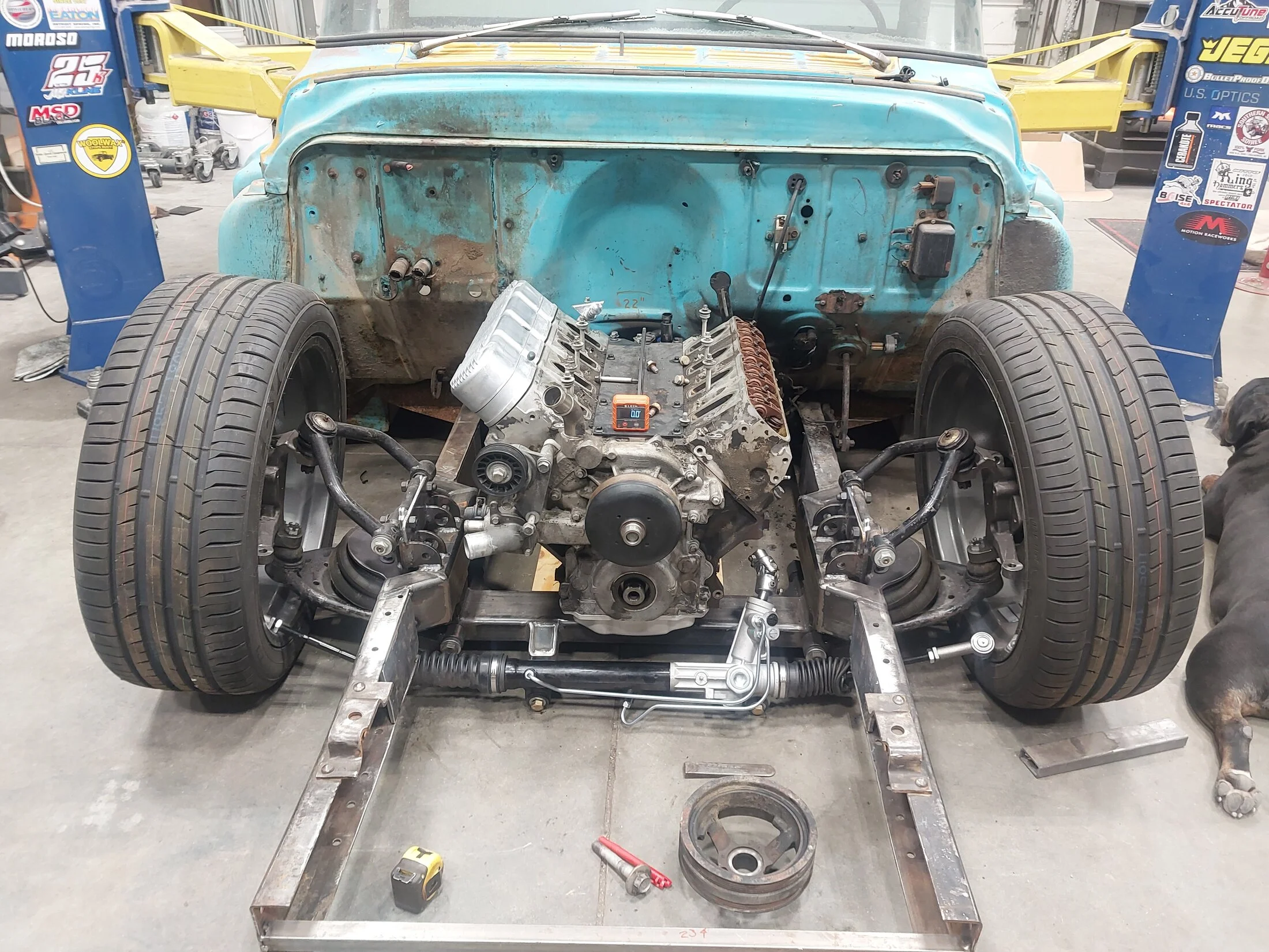

I've been told somewhere @ 4 to 6 degrees towards the back,
Traditionally yes I have always angled a couple of degrees down in the rear...
On the 53 and this one the pinion is higher at ride height then the center line of the crank so they get set at zero.
