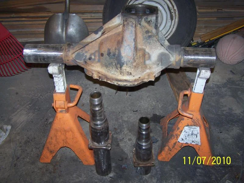

Well I have to hurry because I need to leave for a birthday party but I made some progress today. The axle is now in three pieces. Ordered the shave kit from Ballistic. Ruff stuff 14 bolt install kit and the flange from High Angle. I will get the pictures posted tomorrow if not later tonight.

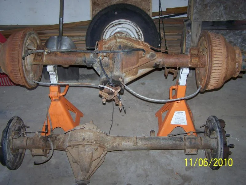

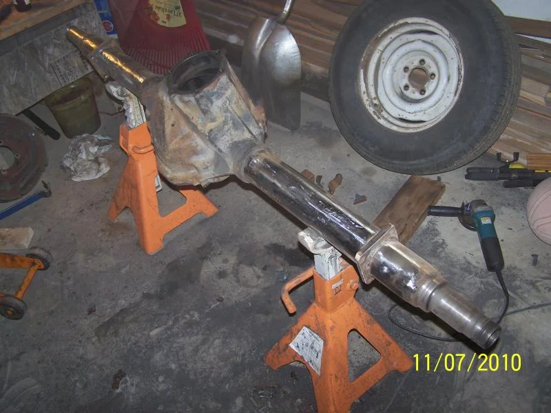

Here are some picture of the 14 bolt.
While I spent more on cutting, grinding and welding supplies than I did for the axle I would not say its cheap to put one of these under your Land Cruiser.

Why did you cut both sides?
X2 I thought you were just gonna cut the long side (passenger) and do it that way.
Oh yeah, my thought was to match the stock FJ60 axle width of 57" but I have 2" wheel spacers on the front and rear now so it makes sense to swap the left and right sides to keep the axle 63" and not have to run wheel spacers on the rear anyway.

Did you just measure the same length from the flange or did you do like freds40 did on his and cut different lengths off of the tubes?
Sorry for the delayed response. Been a bit crazy lately and haven't been on in a while.
For the 14 Bolt I found that the long side (passenger) shaft on a factory axle is right about 6" longer than the factory short side (driver). For the housing to be offset and re-use the factory shafts, the long side now has to accommodate a shaft that is 6" shorter and the short side now has to accommodate a shaft that is 6" longer.
For my setup I measured 4" back from the back of the backing plate flange on the short side and 10" from the flange on the long side. Swap the tubes side to side and the shafts will swap over no problem.
never mind Im retarded, the pictures you posted speak for themselves.:doh:

you might want to think about renting an alignment bar or building some sort of jig to keep everything straight when your welding it all up......and i can promise you sir that the 14bolt shafts are infinitely stronger than your yota's are
