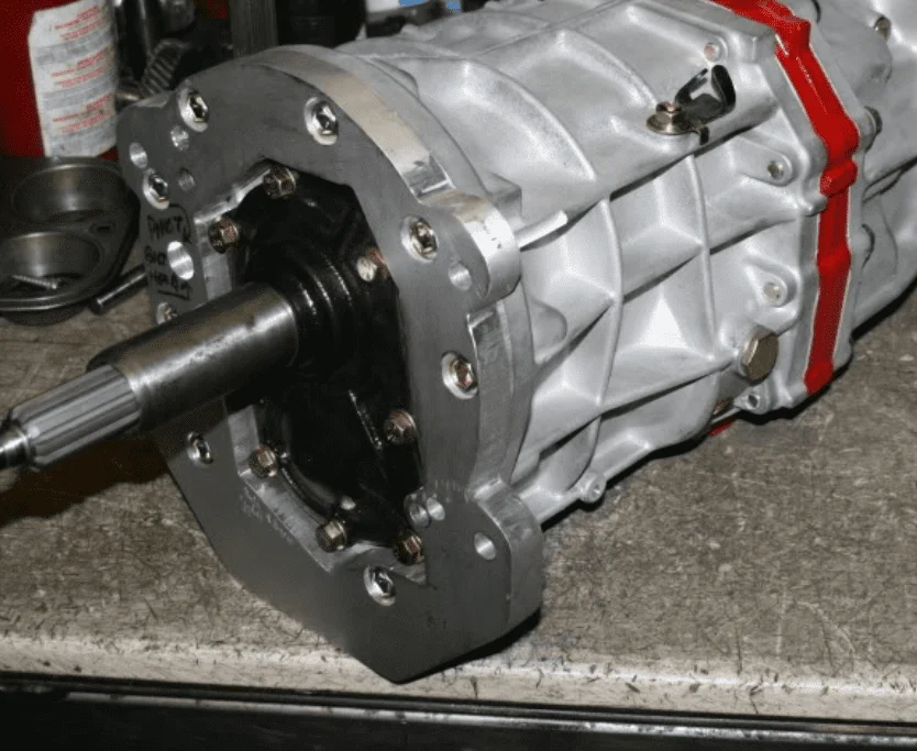

Hi all and Fred if you are still monitoring this thread.
Concerning the adaptor in the attached image. I need the H42 bolt pattern and any CNC or CAD information if it is available, and i'm happy to pay as well.
I intend doing a similar conversion but with a H55f bell housing to an H150 gearbox.
I believe that the H42 and H55 share the same hellhousing pattern????
If any similar information is available for the H150 bolt pattern then I'm happy to pay for that as well.
George
Sorry @Gengis this adapter was hand made and there were no drawings. Marlin made some notes in his book but nothing substantial. I have the adapter now and there are some things in the works but as with all my projects the ones that pay my bills faster take first priority.
