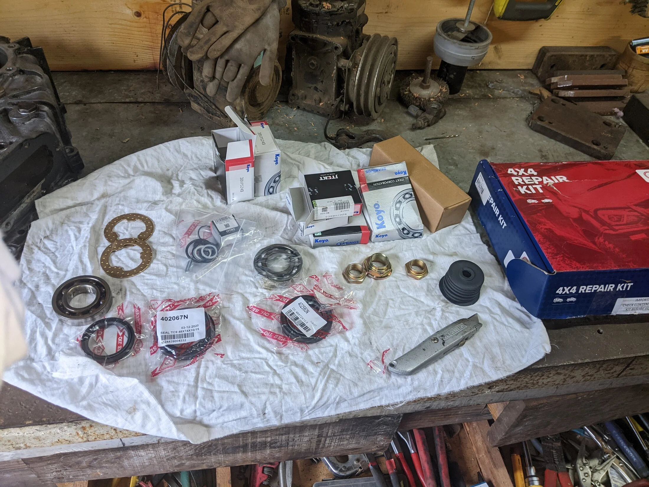

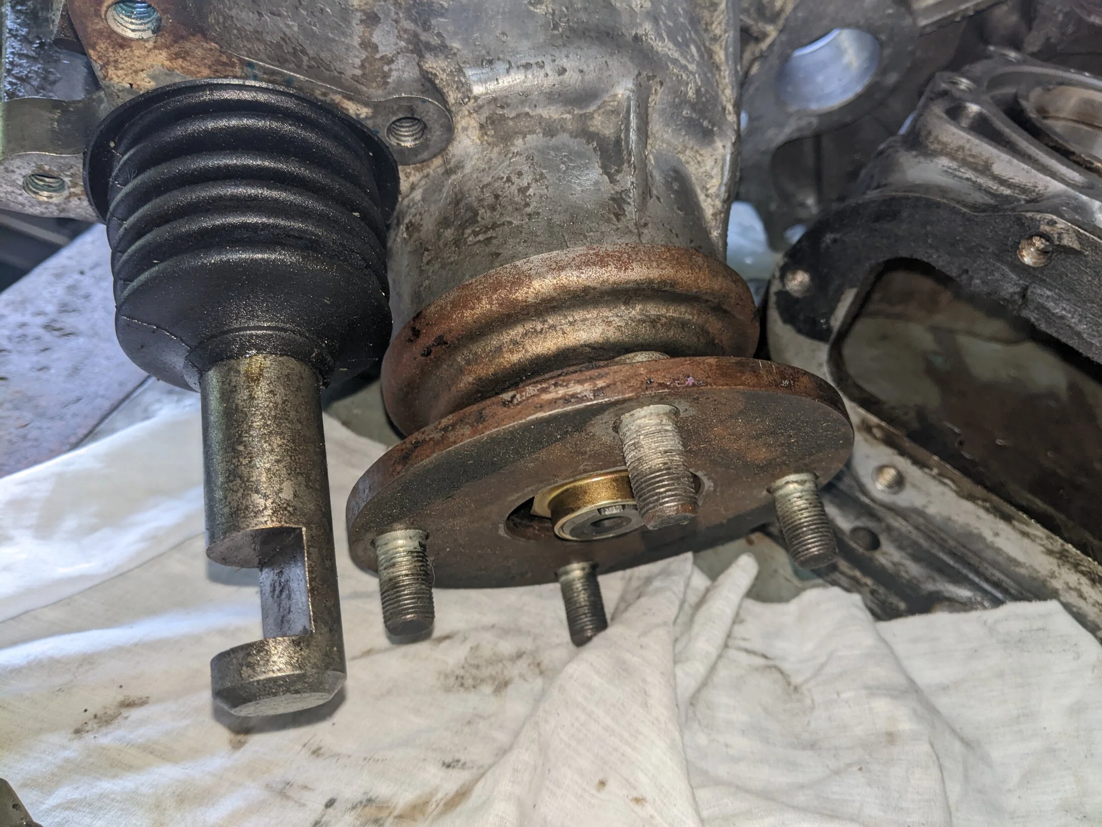

So I started rebuilding the spare tcase. Figured I could get it all together, it'd be a fairly quick swap when I'm under the truck.
Online auto parts kit. All koyo bearings.
Not staked in case it's a different bolt pattern.

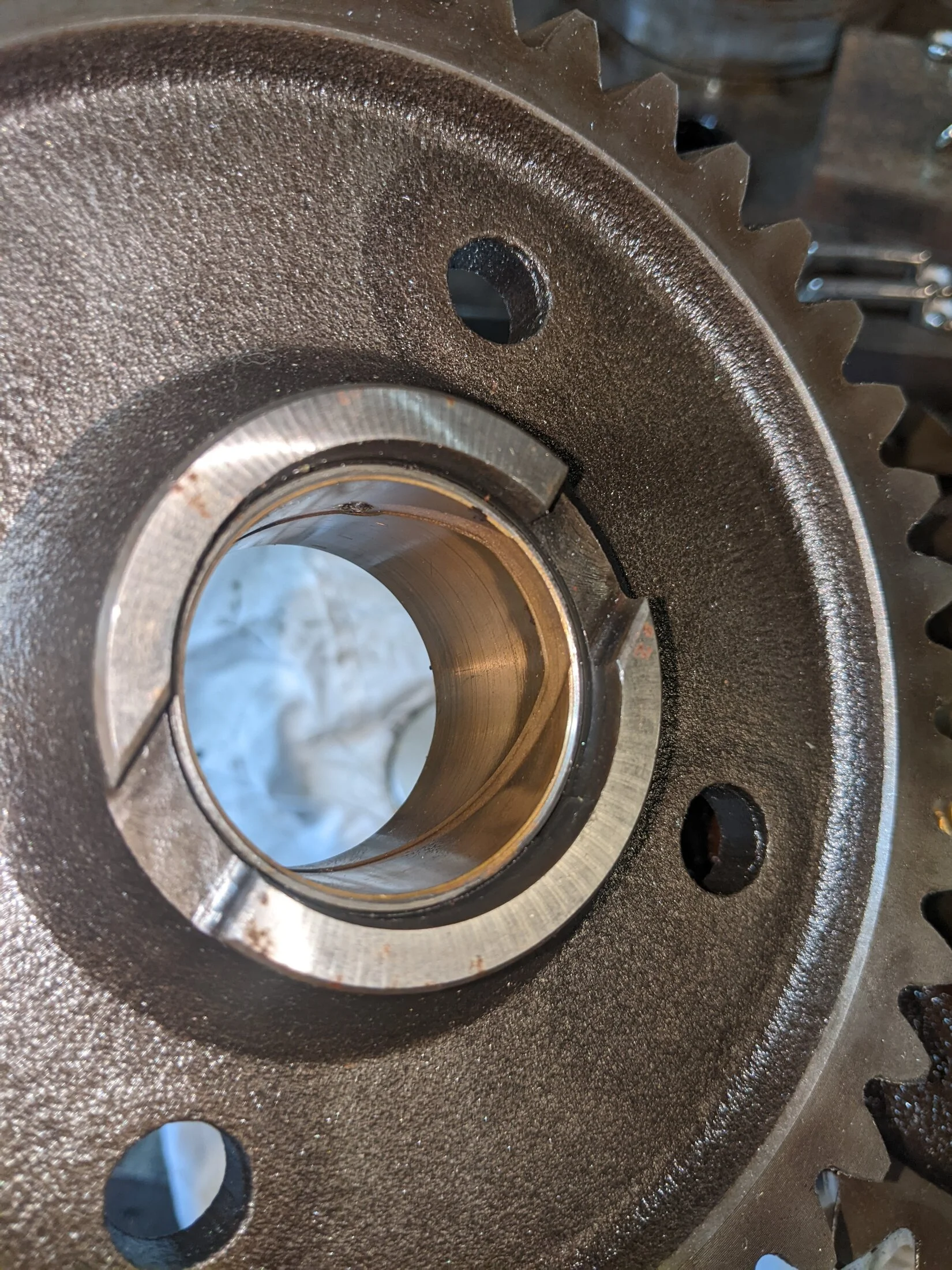

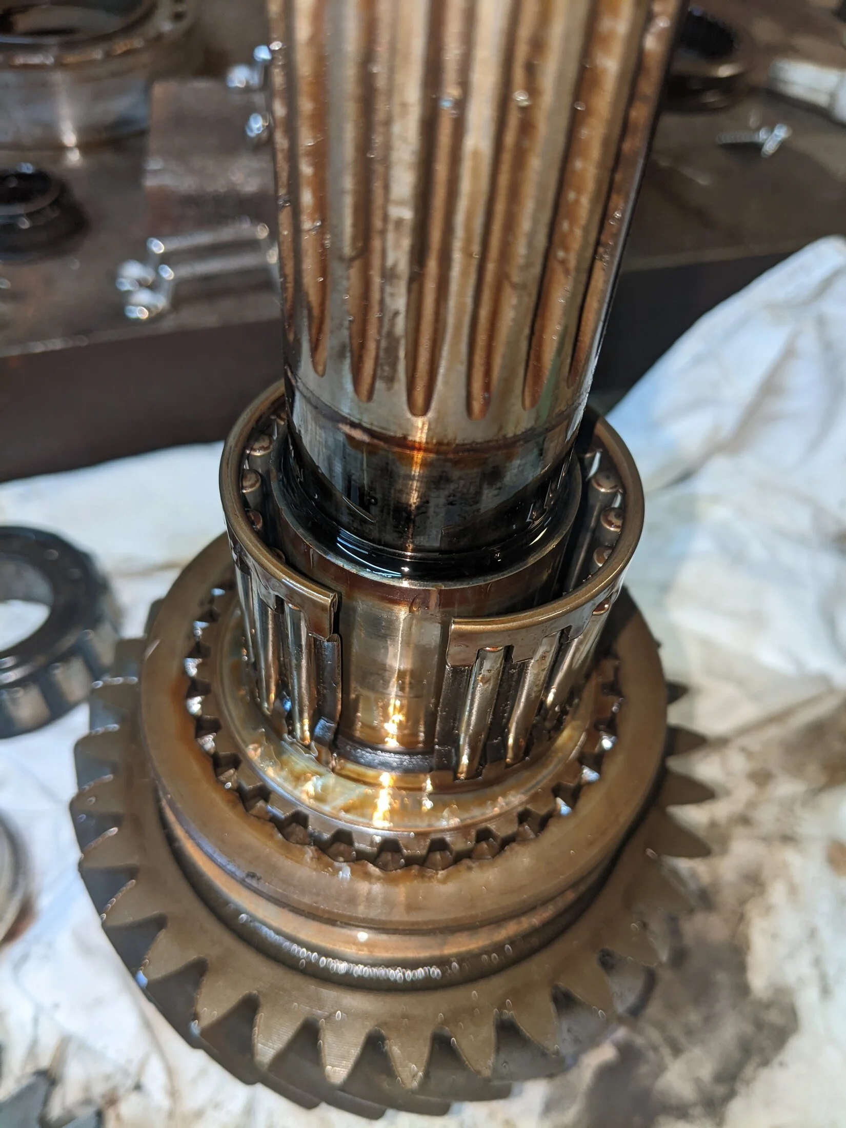

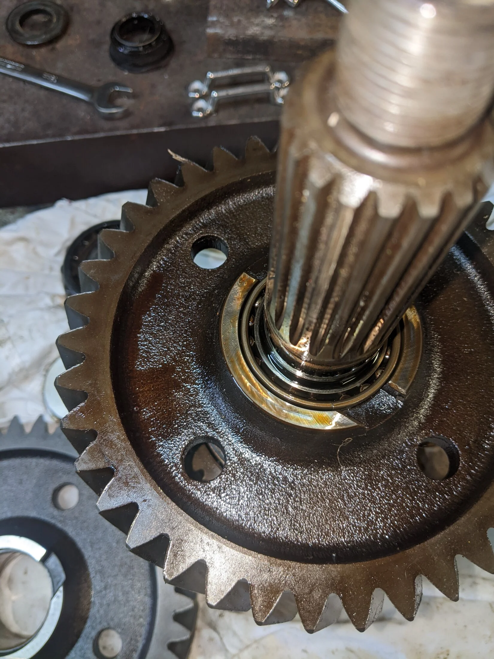

Anyways first time I've seen this. Actual roller bearings inside the gear and not just a sleeve...Hmm. kit certainly didn't come with that.

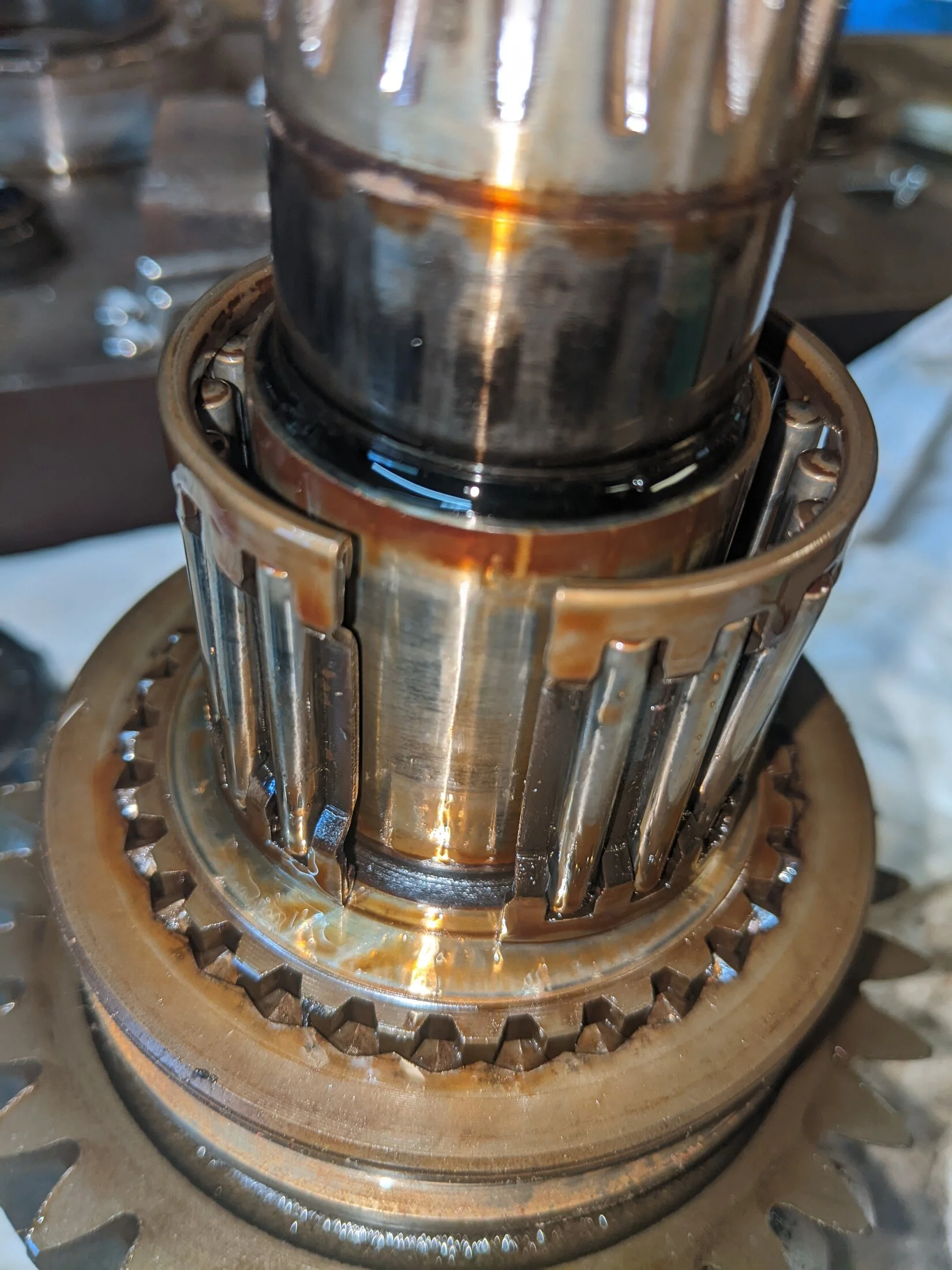

Roller bearing is actually in two halves too.
This case and gear set came off an auto. I don't know what year. Or if autos are all like that?
At any rate, real question is if the shafts are the same or not. I'll have to do some digging on that I guess.
Those look normal to me. The kit doesn't have replacements? I might have a set of those in my shop. Let me know
and they are in the boxes under the radio on the shelf above the 5 speed.

I've never had a kit come with a 3rd roller bearing for the main shaft.
It's an 87 and up auto thing apparently.
The kits I got from CruiserOutfitters have them, cause my t-case has them.
This thread has all the necessary info
I'd have to see it I can't remember what you are talking about. I thought you meant the split bearing
set there.
Yeah it's not something I've run into before, and I've done a few cases. But I hate autos :lol:
The auto main shaft gear has this
Instead of this.
It's similar to the rollers that go on the idler shaft
Basically unless you order an 87+ auto case RB kit, you won't have it.
I'm coming due for another box of oil filters, so I'll see if I can order one on its own from Toyota parts direct.
Or just say ****it and use the non auto gears.
Weird tho. I wonder why Mr T felt the autos needed a roller bearing there instead of the bushing that's on every other case.

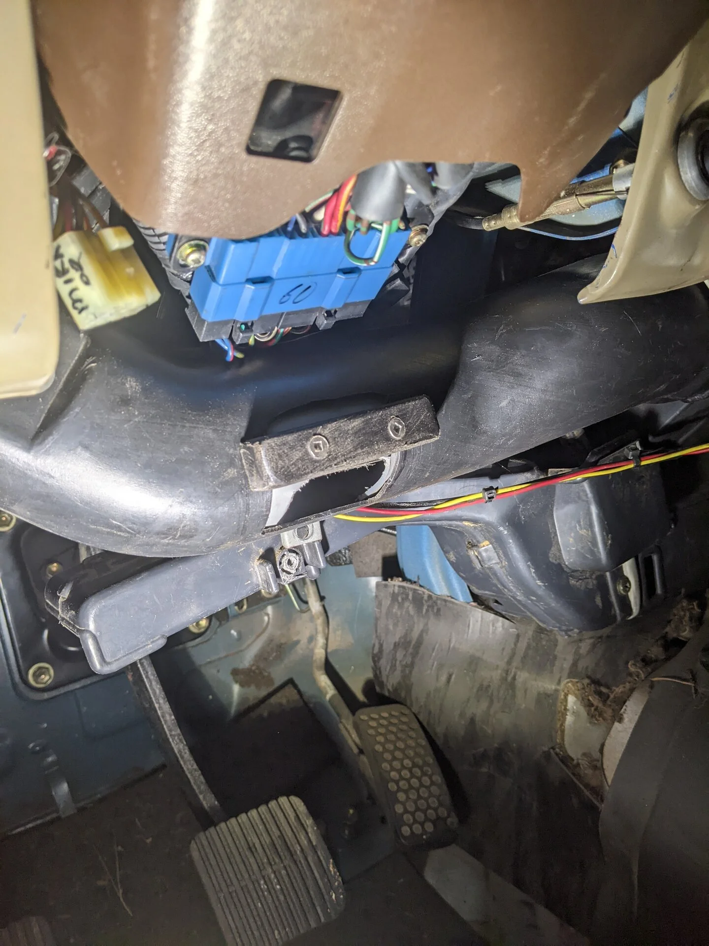

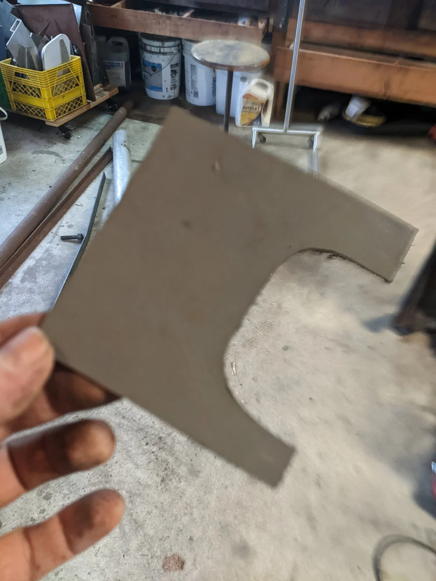

Something I've wanted to try since I bought the truck.

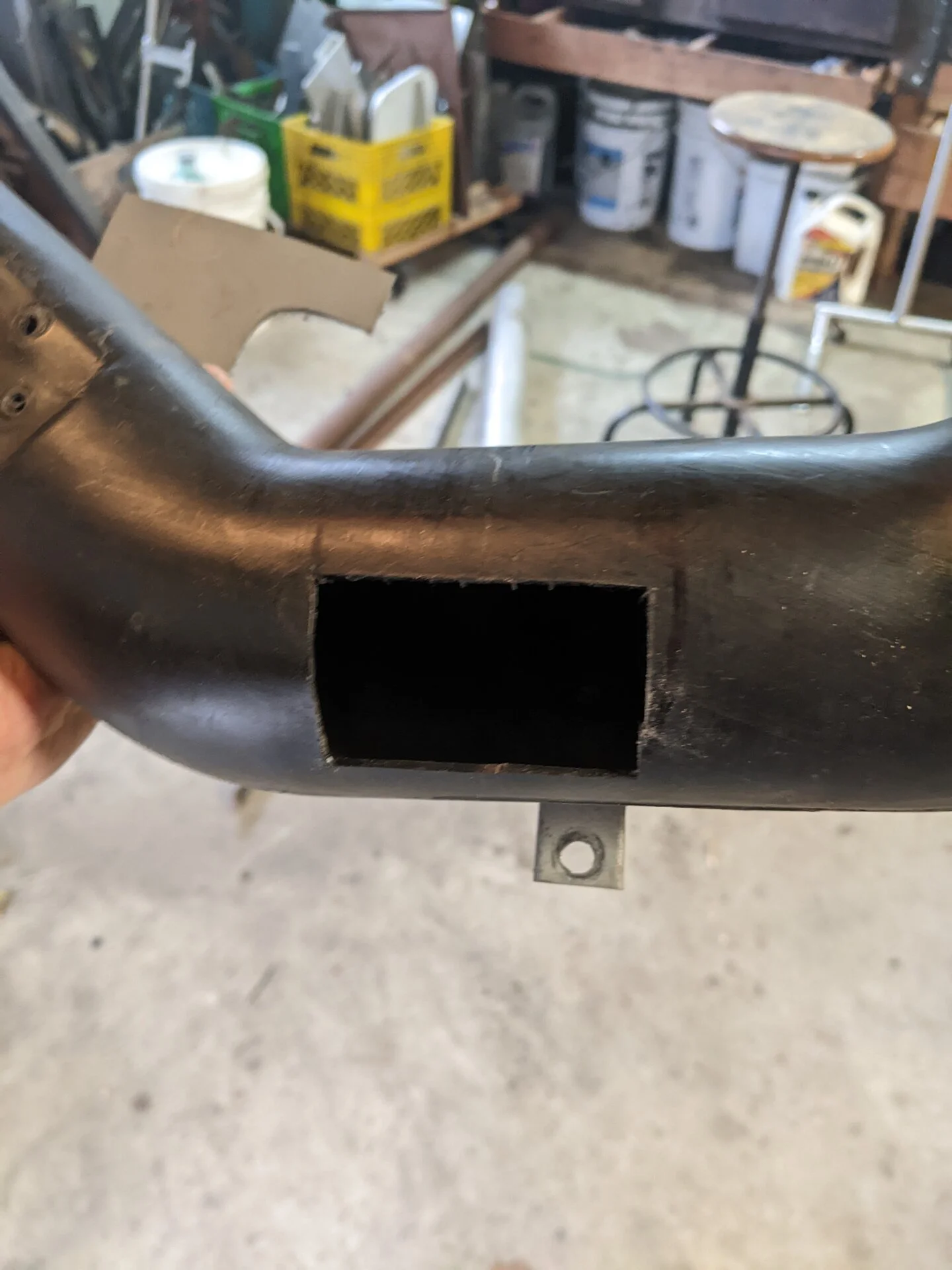

In my not particularly humble opinion, there's too much air aimed at the side windows and not enough at the drivers feet.
Hopefully this means warm feet even in defrost mode, which is where I usually leave it set. :meh:
Be better if I found some black plastic already curved, but the s***ty old tote lid will have to do for this experiment.
Seems to only barely reduce the flow to side window, and blows pretty hard at the feet. I'm ok with that. 😊

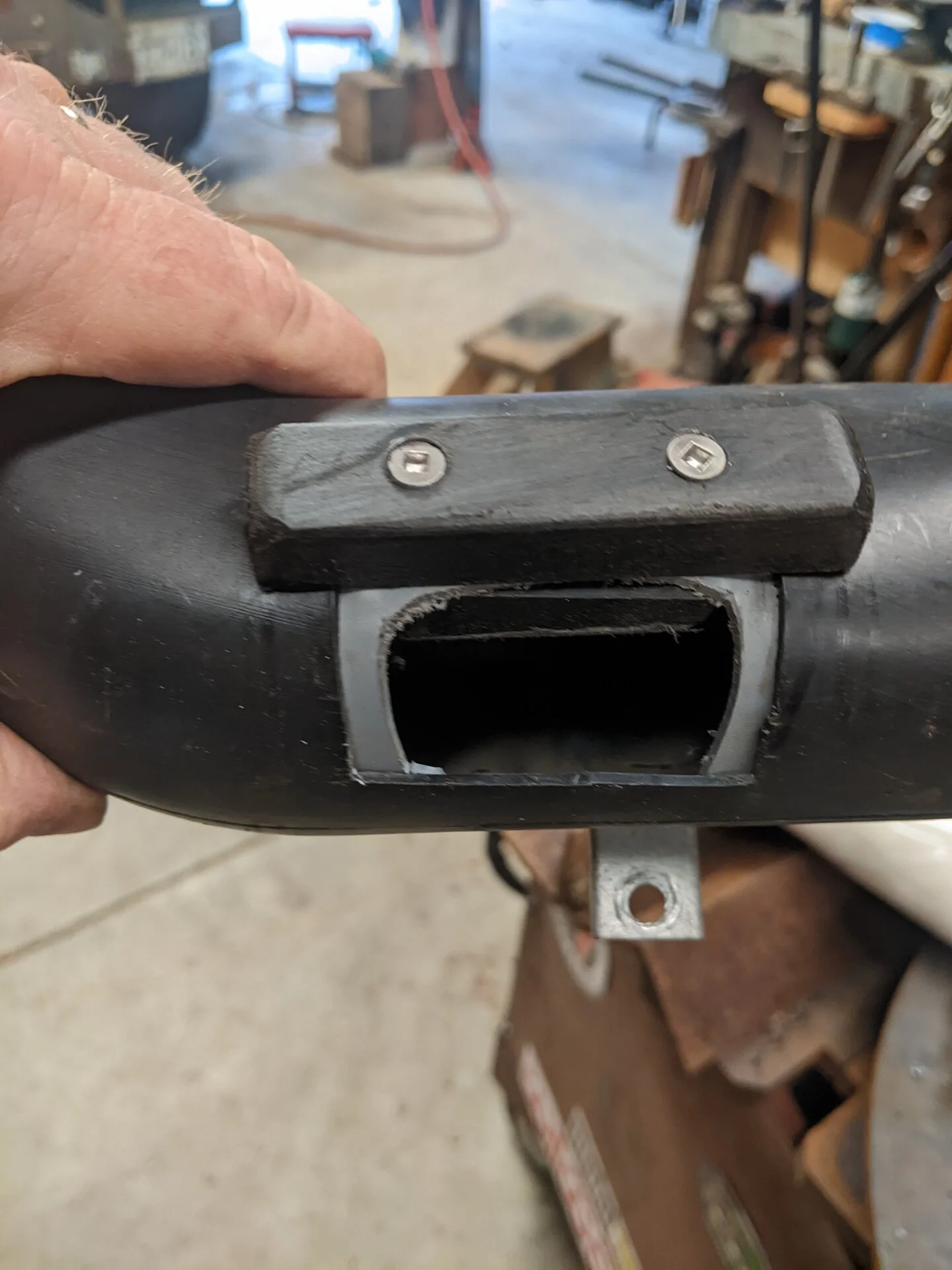

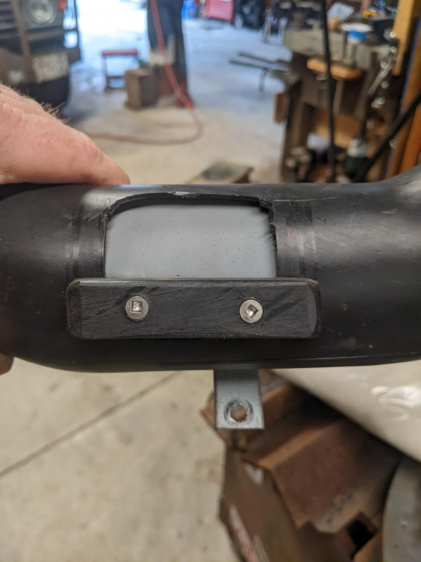

So this was a surprise.
I did this vent thing to help warm up my legs in winter. Worked pretty well, then I forgot about it.
So today, I'm driving the 60 in shorts for the first time in ages, and it's hot out so the controls are set to vent and I discover I have a nice breeze blowing on my legs.
Maybe not quite as good as a 40 series kick vent, but pretty freaking nice.
For a 20 minute free job , definitely recommend it.
