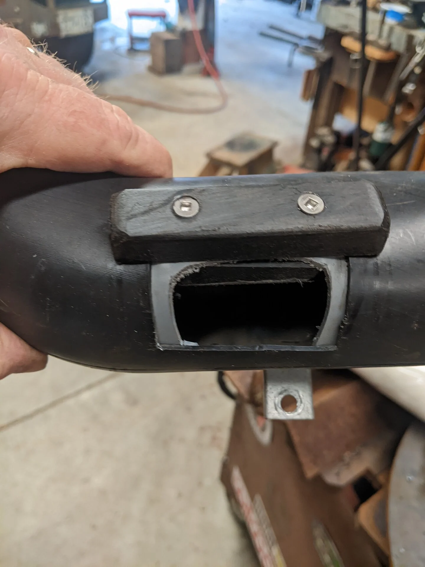

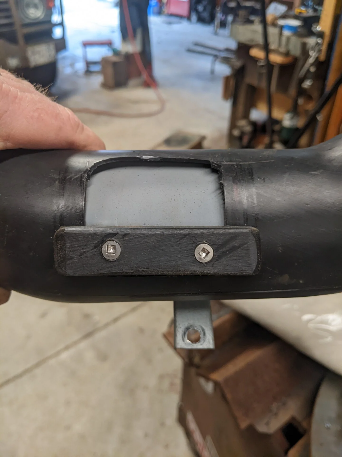

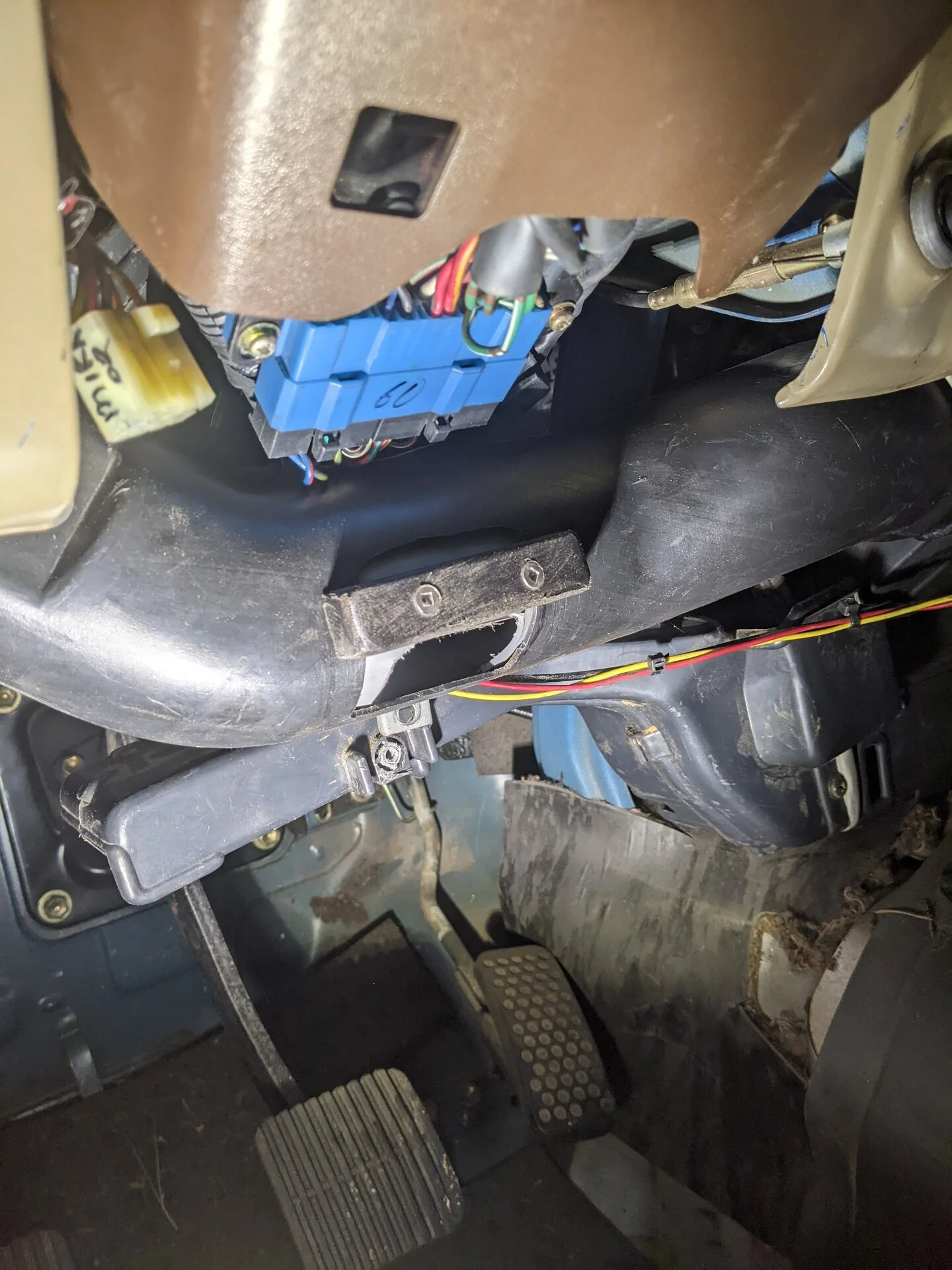

In my not particularly humble opinion, there's too much air aimed at the side windows and not enough at the drivers feet.
Hopefully this means warm feet even in defrost mode, which is where I usually leave it set. :meh:
Be better if I found some black plastic already curved, but the s***ty old tote lid will have to do for this experiment.
Seems to only barely reduce the flow to side window, and blows pretty hard at the feet. I'm ok with that. 😊
Do you have the distribution duct right in front of the shifter that’s located on the bottom
of the heater? My feet get too hot from mine. Didn’t you just do the heater core itself?
83 bj60 I think? There's this haywire snorkel thing that goes up and over to blow air down. It's never been much use. Probably would be better to just remove it, but that wouldn't really fix the root issue.
Went out for a bit yesterday, warm air on feet while in defrost mode, which I previously could not do.
I'm usually in defrost mode for most of my commute trying to get the windows clear.
