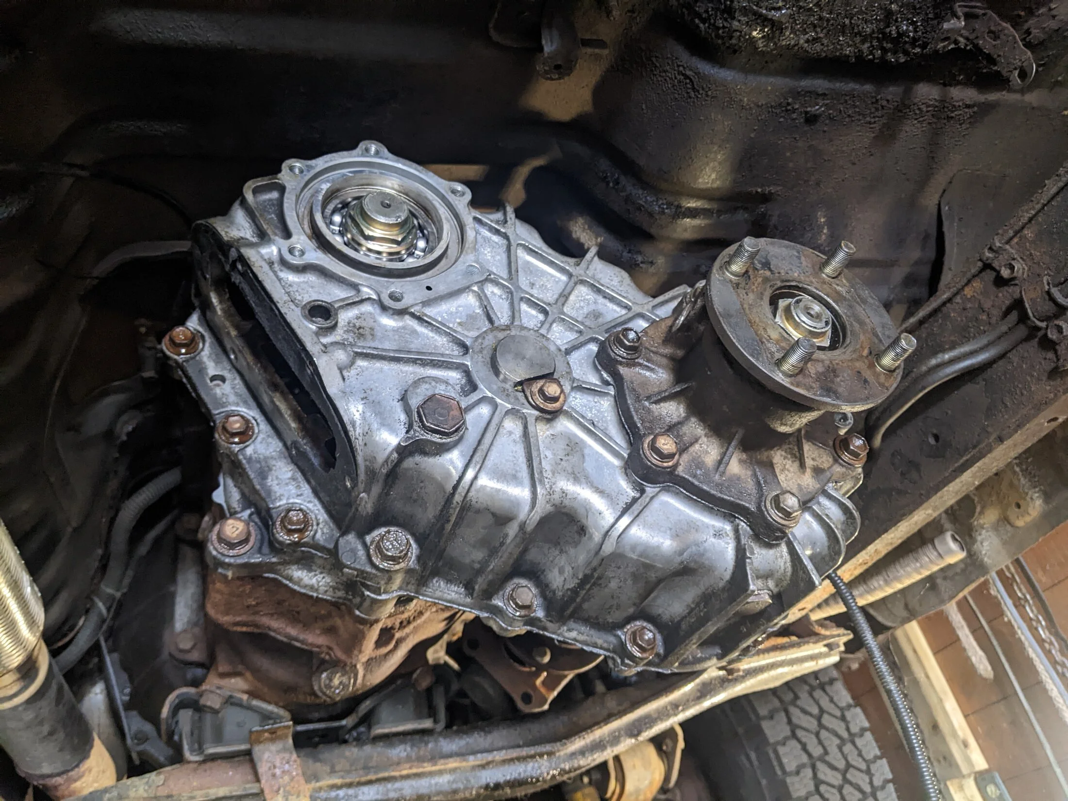

Tcase rebuild, manual conversion.
Did your kit come with new gasket between the 5th gear housing and transmission body? You've taken out the 4 pass thru bolts
so I'm just asking as Georg @ Valley Hybrids recommends making sure you do that front gasket as once the compression is
off it will eventually leak if not replaced and sealed. I use that red stuff he recommended. Just passing info along.

Yeah I've done that one before. On new transmissions they just put that gasket in dry, that's what he's referring to.
This one appears to be glued on something fierce so I'll see how I feel about it climbing back in.
This h55 was rebuilt at some point before I got the truck. Dude used some intense gasket glue.

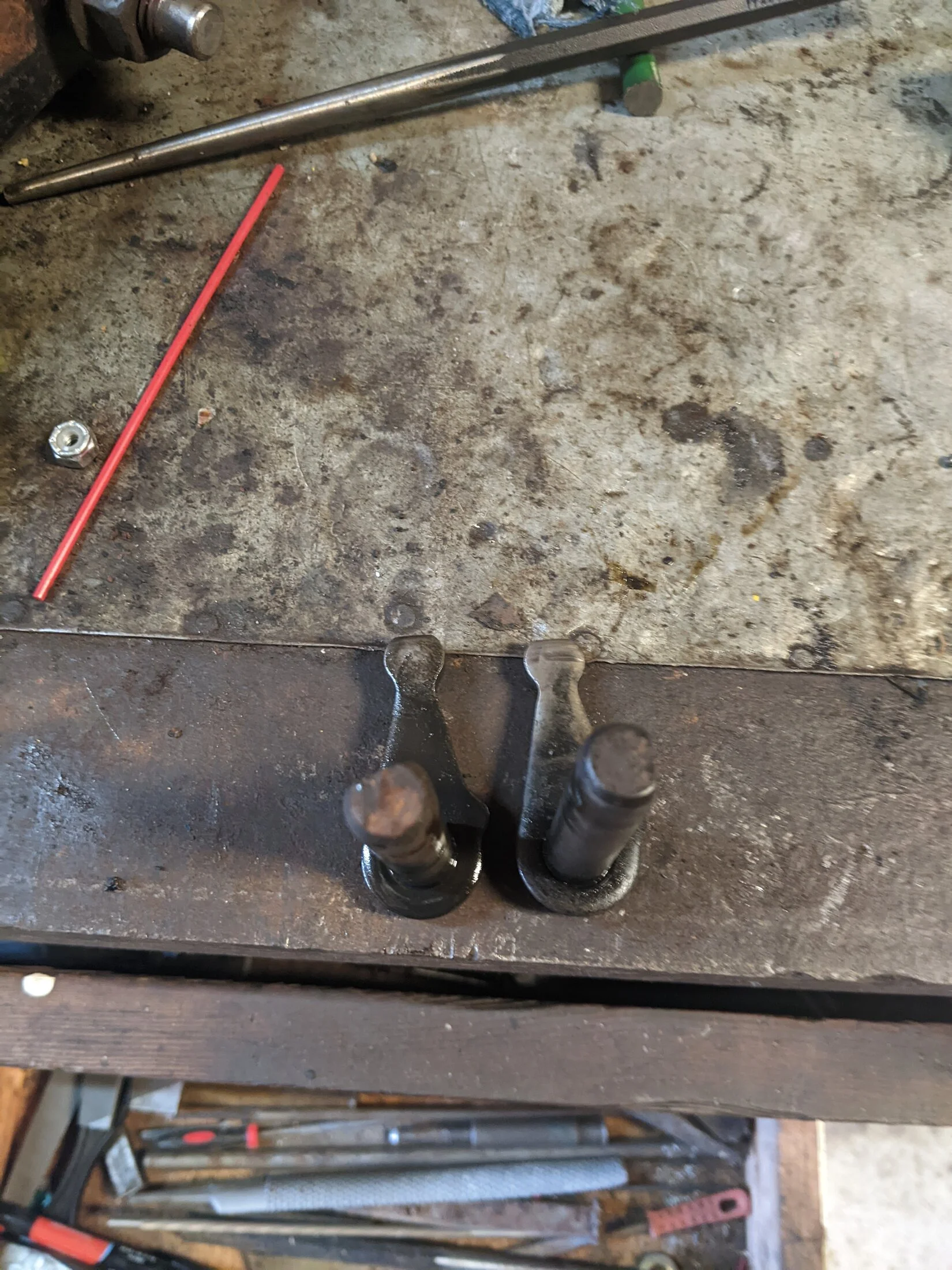

Well this is annoying.
Robbing the shifter setup off the 40, this piece is clocked differently. As are the levers that clamp on.
So I can put the manual one on the 60, steal the top piece, but I'll be stuck with modifying the one on the 40.
Because I ain't taking the case apart to change this out. I'll also be hoping like hell it doesn't drop in. Because that would suck. A lot.
Oh well. If it was easy, I'd probably do something else to satisfy my innate masochism. 😔

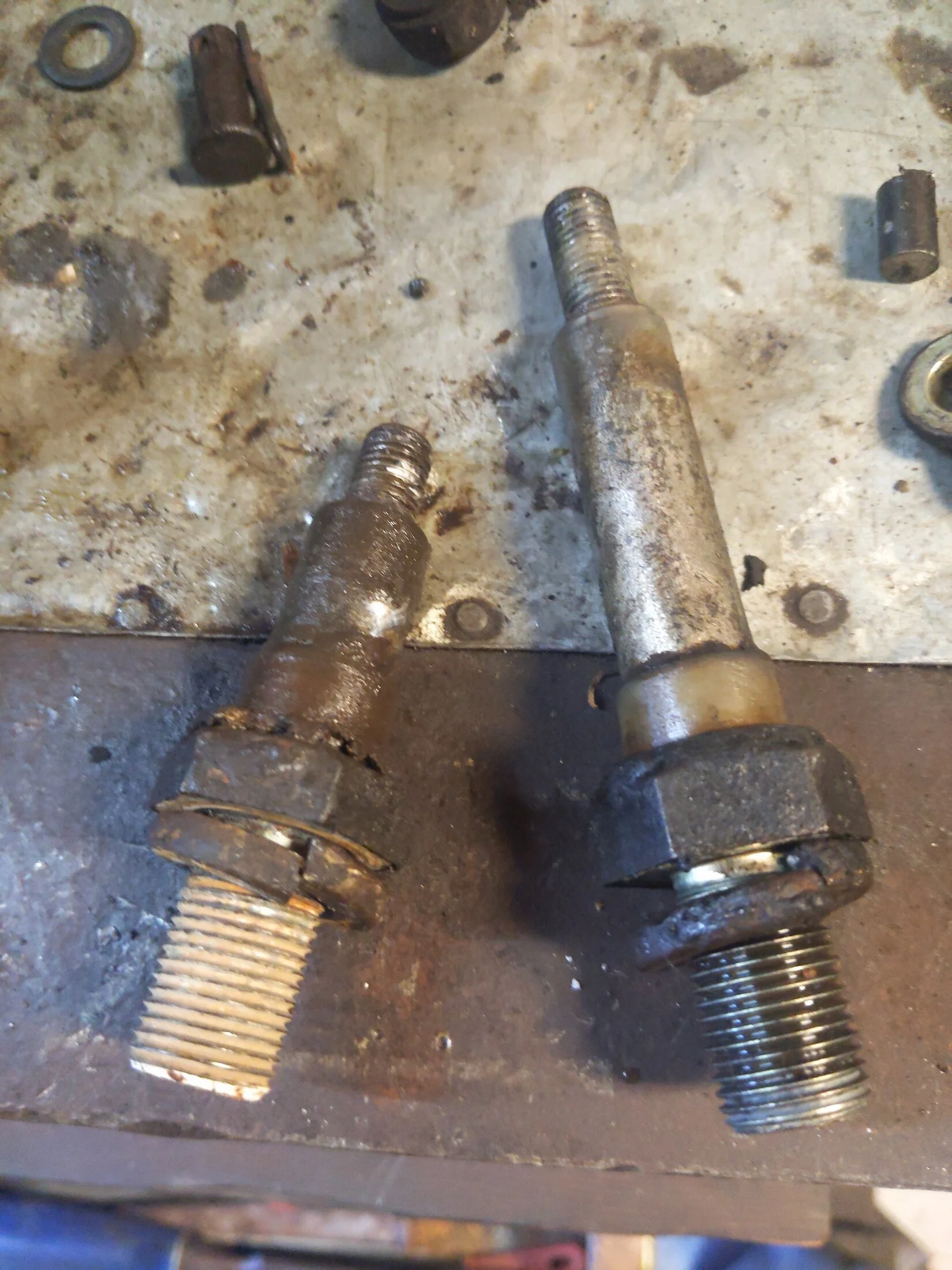

Fun fact, these need swapping too. Vac shifter version is shorter.

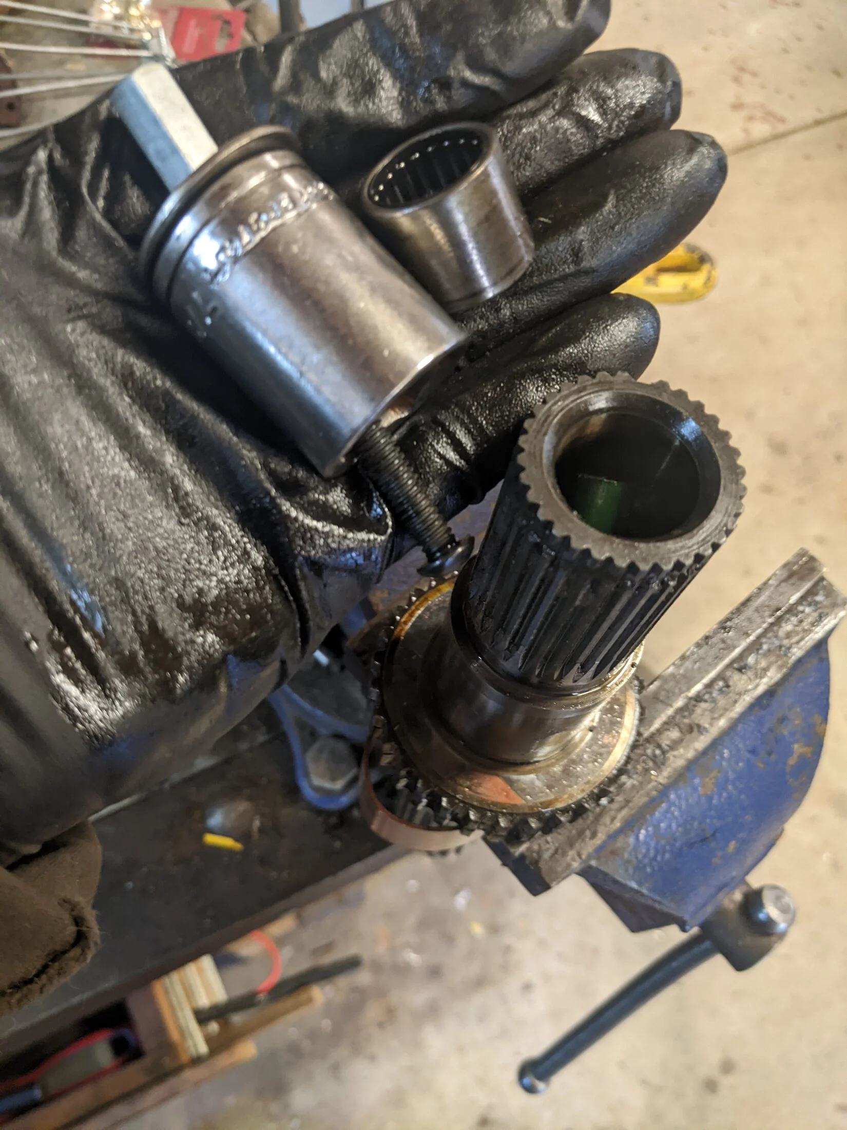

That's enough for today. I need my wheaties before torquing the big nut to 100 or whatever it is.
Preload fought me a little. That's why that output housing is dirty.
After a couple in and outs playing with shims on the one I cleaned up I noticed that the bearing race was tight going in, but once it was fully in, it had a bit of wiggle. 😬
So I had to start the whole process over again with this one.

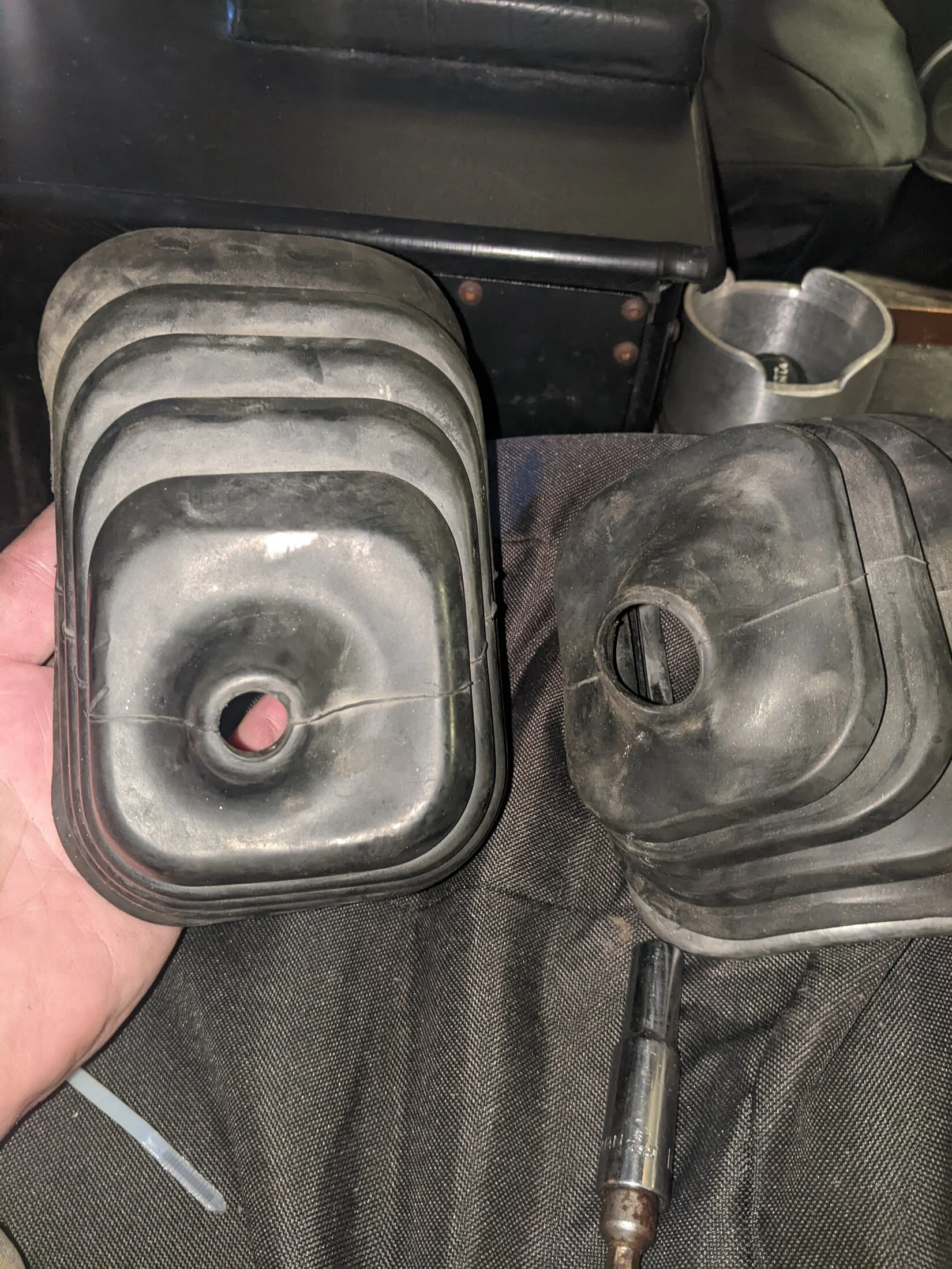

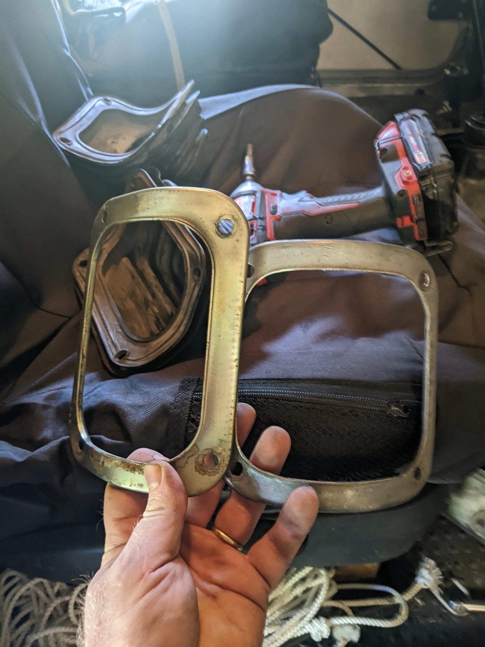

Couple minor ****eries to deal with. Shifter boots are different. Could just use the old one with the bigger hole, but the base plates are different too. I bent the shifter a little, but the hole in the plate is bigger too.
So I guess I'll cut the hole bigger and nutsert but for now I'm gonna work on the other truck.
