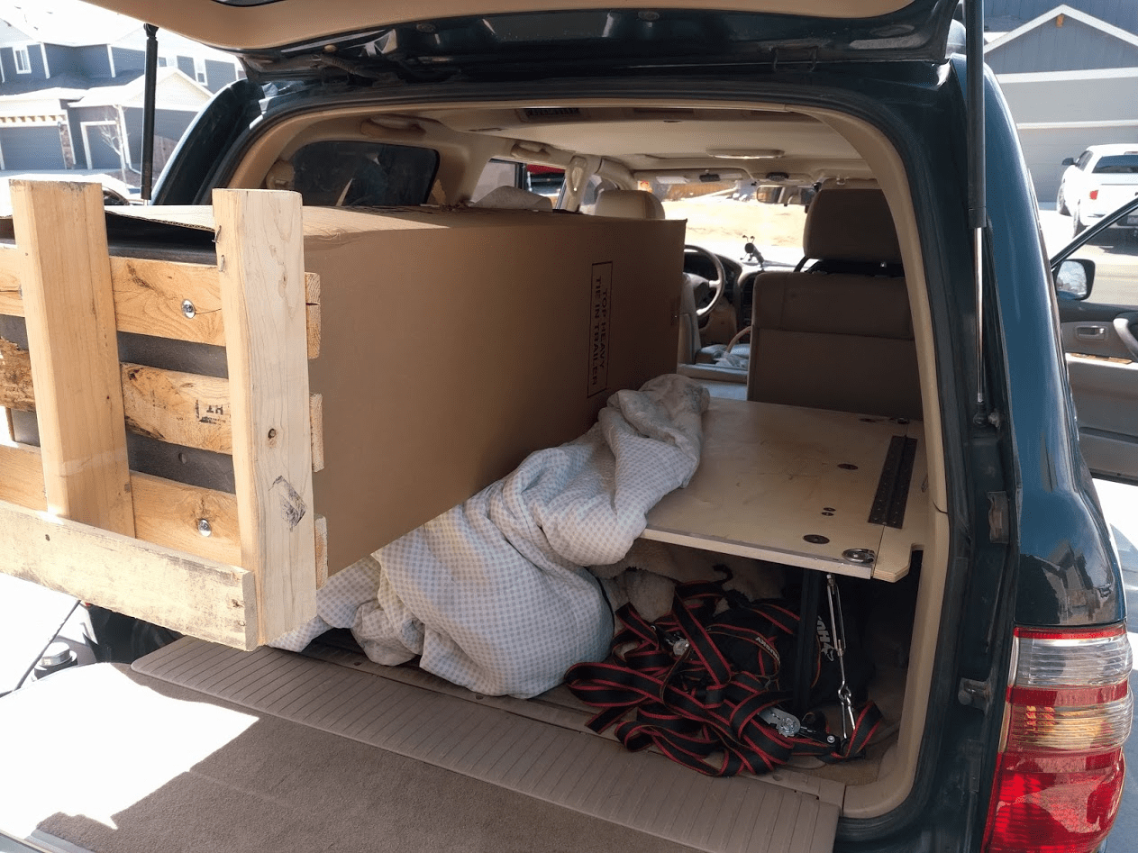

Just wanted to say thanks to everyone who posted in this thread. I was able to make my own 2 part sleeper system and combine it with a Exped Synmat 10 sleeping mattress I bought previously for car camping. It fit great and the extra storage underneath was very much appreciated on a recent road trip. I'm 6'4" and fit just fine.

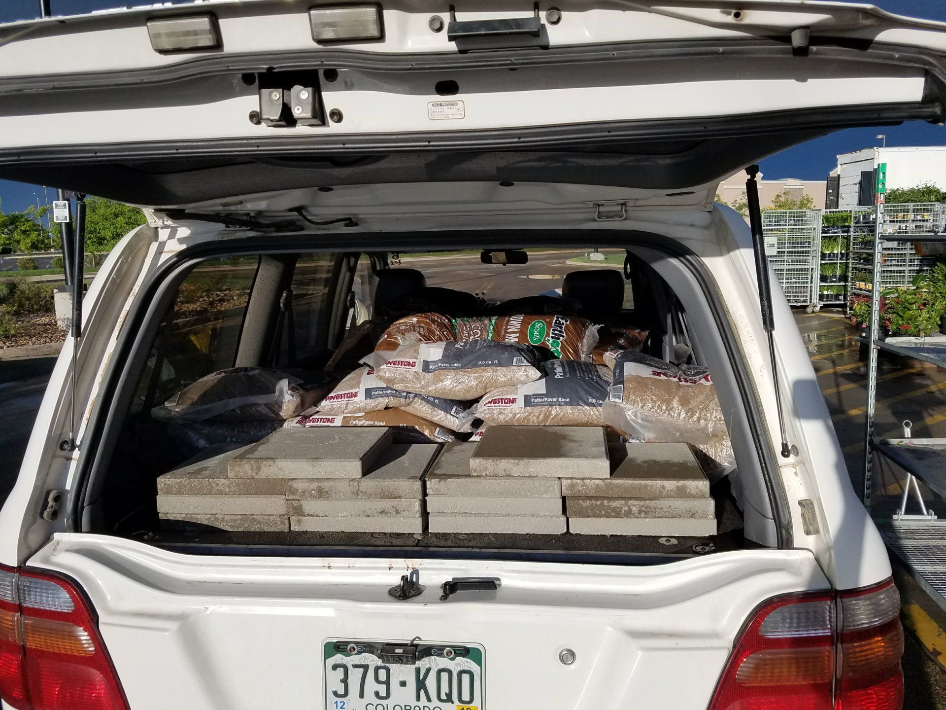

Building on this; here's a pic with 900 pounds of landscaping material on my SS1. I was prepared to keep going until it broke for some product testing, but ran of pavers and sand before that happened!
Nice pic... I beat mine up pretty good and there is no signs of stress. I went with herculiner over all of the wood which is nice for wet dog and snowboard rides.

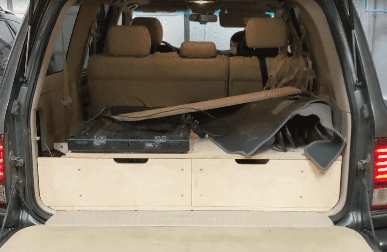

I started on my drawer/platform build over the weekend. It's about 90% done, not including staining. Will ultimately carpet it.
Big priority was strength as the whole purpose for me is a sleeping platform. I used 3/4" birch for the main box and 1/2" for the actual drawers. I took a page from @Magnetic 111 followed his design in mine. I also built in a small space between the drawers and back of the 2nd row for a small cubby.
-UHMW slides
-Felt tape between all wood-to-wood joints to keep squeaks away
-Pocket hole screws on all joints except the top panel and 'rear' panel (facing the back of the 2nd row). Otherwise, no exposed hardware inside the drawers or on the main face in front of the tail gate
-Routed out sections to slide some 1/2" dividers in various sections of the drawers
-Recessed magnets inside the drawer face to help keep them in place. They slide smoothly but shouldn't move without intent.
-One sleep panel is cut and installed, the other needs a trim for width but is already drilled for the piano hinge. Ultimately will give lots of totally flat space inside with 2nd row folded down
-Wings on the side need to be cut, shaped, and attached. Plan is for one side to hold a quick fitting for my compressor and some power accessories.
