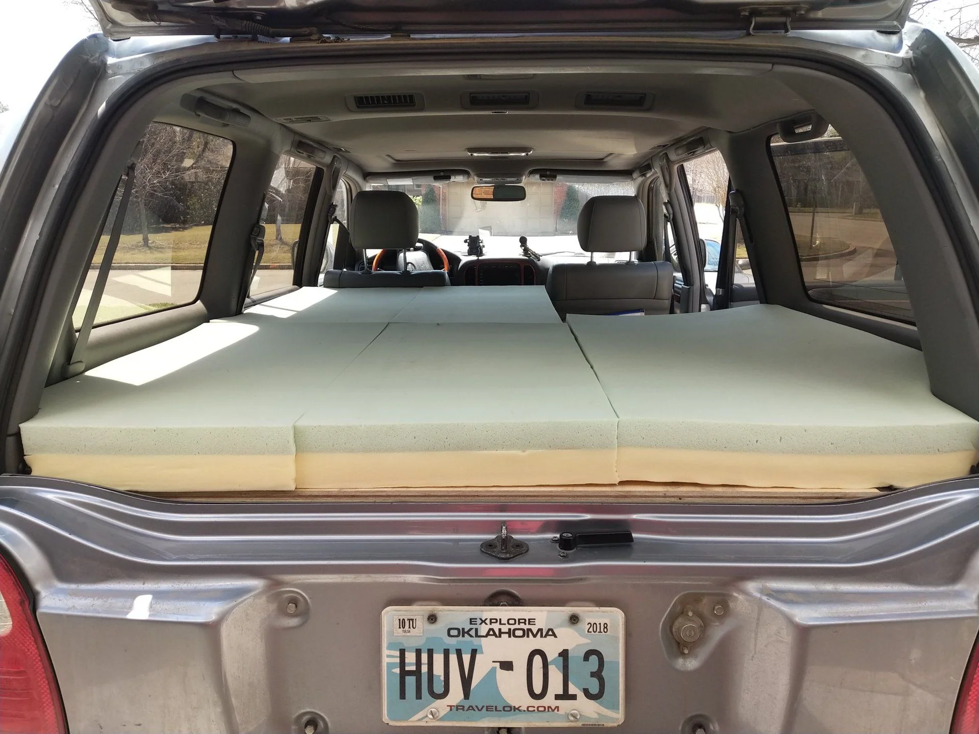

Foam sucks because? Moisture or just preference or? This mattress is the same one I'm sleeping on at home, I removed the bottom layer for a tad more headroom, bench tests ok for camp comfort. I like that I can shape it around the fridge shelf. I plan on making some PUL fabric covers that will prevent moisture from getting to them.
I had a grizzly self inflating roll that was awesome until it got a hole, i don't have to worry about that with the foam.

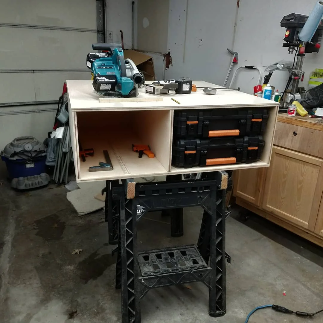

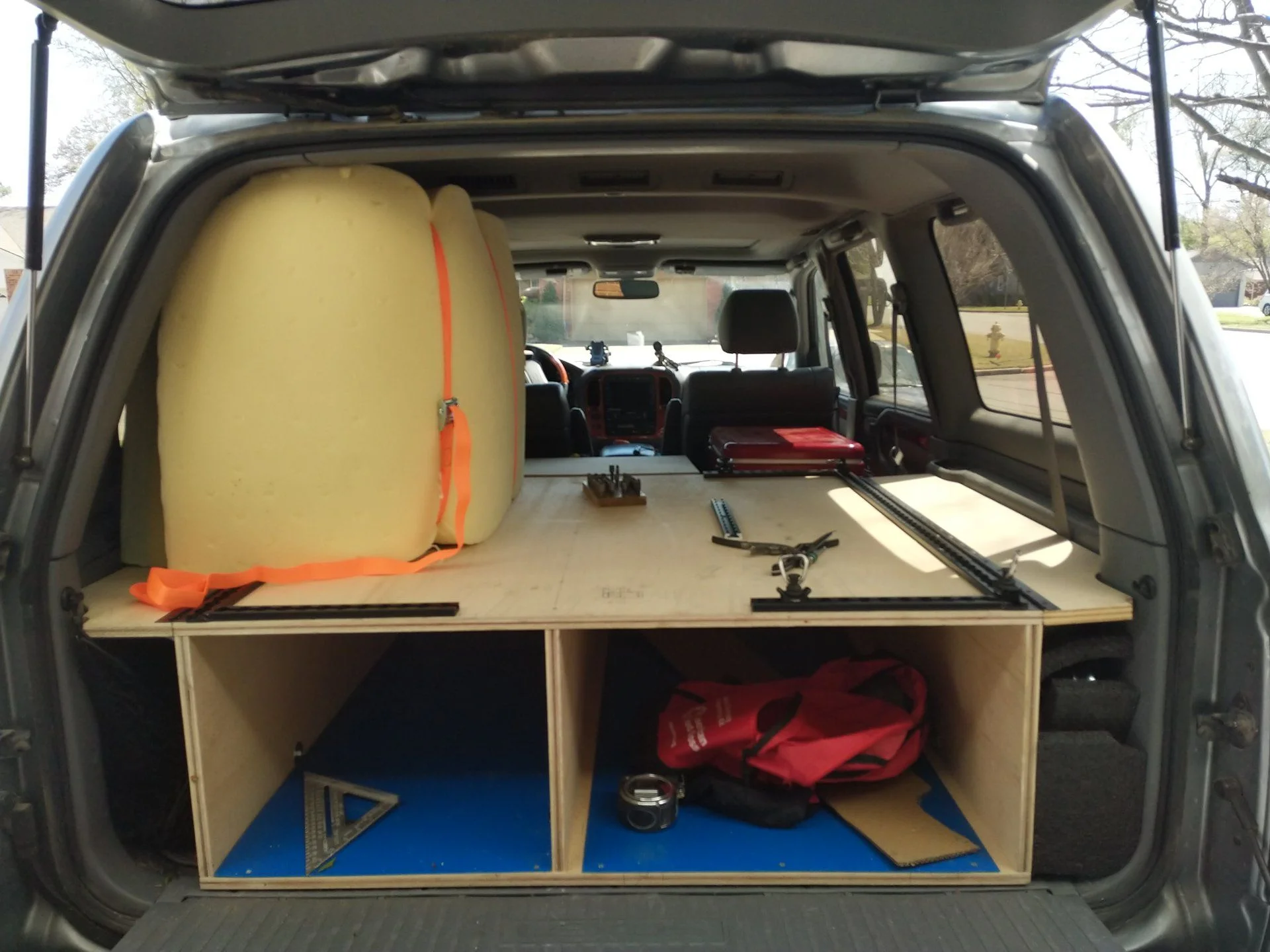

Almost finished with my set up, getting ready for Cruise Moab. Shelves in back a tad higher than the tail-gate, cut to fit the Rigid Tool Boxes. I pulled the 40% rear passenger seat and put my fridge shelf there. I cut up a Queen foam mattress from amazon for ease of removal and increased secured cargo area. Added some aluminum anchor tracks for securing anything that won't fit in the shelving, want to limit this to soft bags, clothing bedding etc. Any camping heavy stuff to be secured in the shelves within boxes.
I can pull this entire set up out in about 15 min. 4 turnbuckles holding the main box in place, 2 seat bolts for the fridge shelf and four bolts holding the sleeping extension to the main box. We'll see how it holds up in moab. lan on using that as a test run, then pulling it apart and making any adjustments needed, then bracing and gluing it all up.
Lots of inspiration from @CruiserDave 's KISS and @TheAshenWolf 's build.

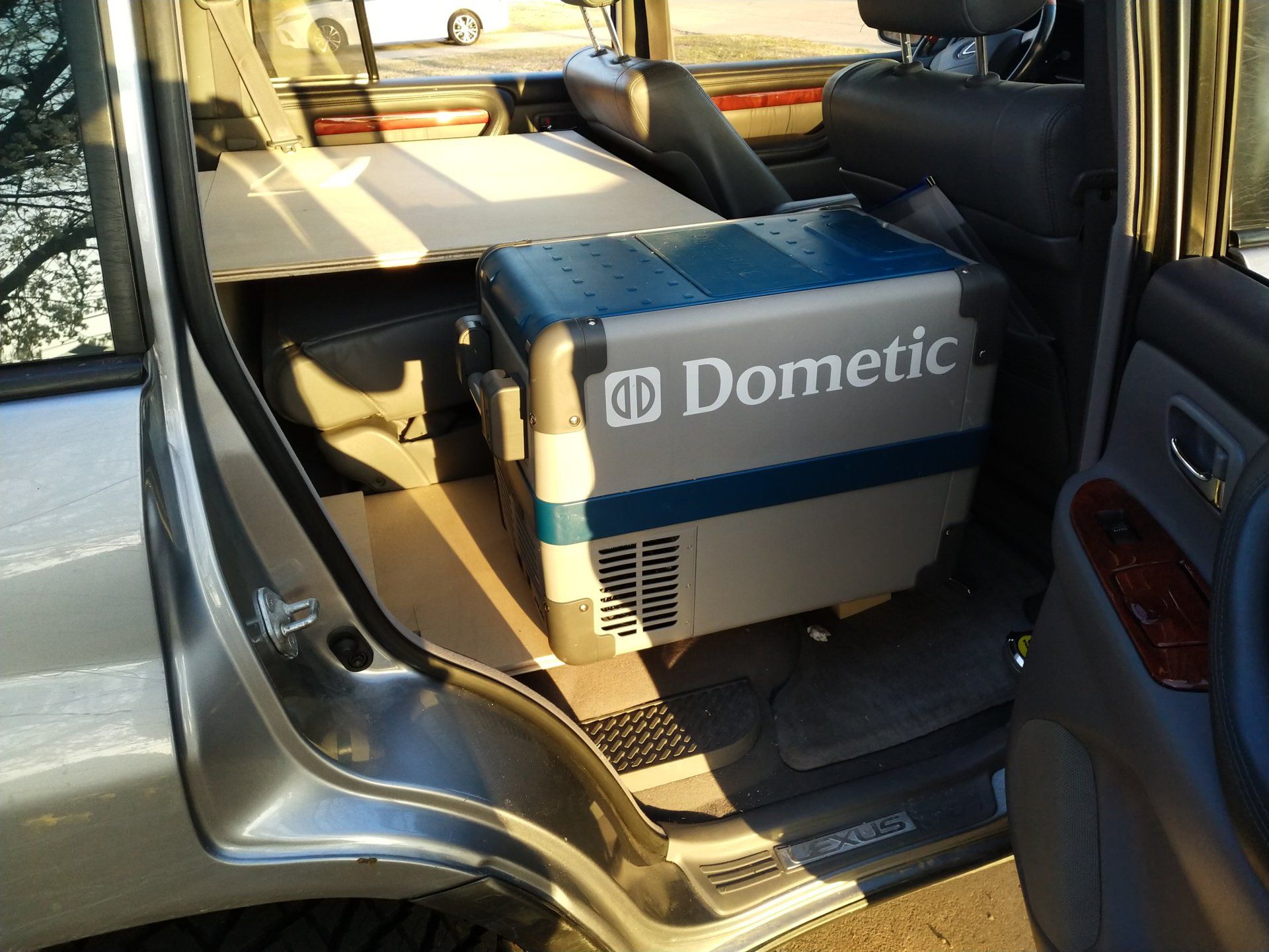

Nice setup. I am thinking about putting a fridge there. How did you secure it? Is that the 37 or 50 dometic and how to you like it?

I have the small 28Qt, got it as an open box buy and couldn't help myself 1.5 years ago. I use it as a beer fridge at home and works well for a few nights worth of beer and food. Will hold 24 cans plus the shelf, which is about 10 deg warmer than your stet temp. Happy with it.
I can also mount my 54 qt Coleman Steel Belted Cooler in the same spot if needed.
For the shelf, I made a 2 layer plywood sheet and used the 40% seat mounting bolts to hold it down. I used a forstener bit to cut recesses so the top of the bolt heads are under the level of the top, then I used a section of the Aluminum tie down strips for hold-downs. I'll take some detailed pics tonight.

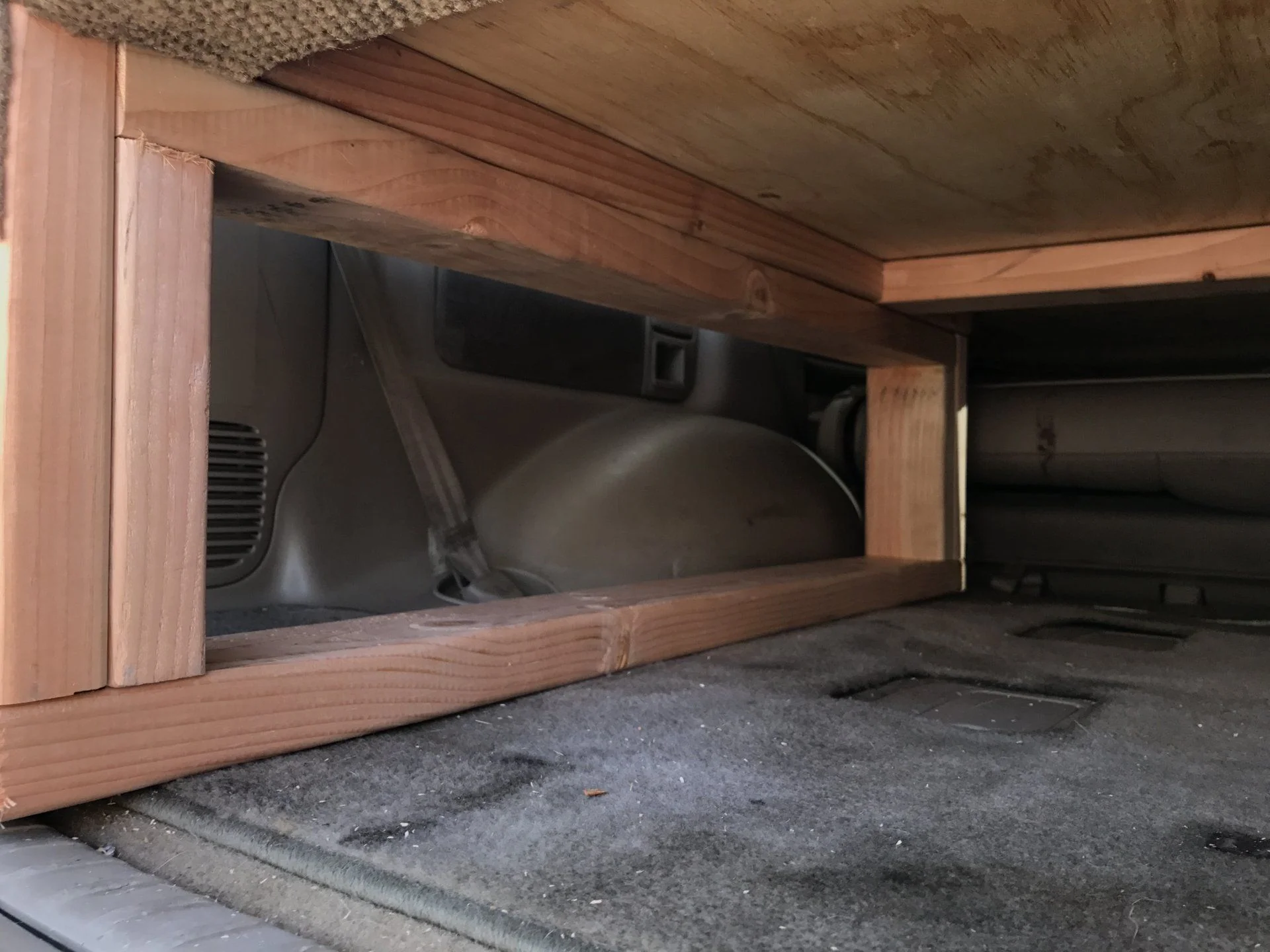

Found this thread a week or so ago as I was planning my own road trip from SoCal to Colorado. Given the cold temps and plans to go solo, I thought it would be perfect to build some sort of platform that would allow me to travel and sleep inside of the Cruiser. With about $90 in wood from Lowes (not including the $15 12-pack from the market) my buddy and I built this platform to meet all my needs. Given more time — and ambition — I would probably mimic @TheAshenWolf build as the modular aspect really appeals to me.
At any rate, here's how my build turned out. Perfect sleeping platform for myself and my dog, while also leaving room for storage underneath, a 54qt cooler (or single seat) in the cavity and the ability to bear as much cargo weight as I would ever put on top:

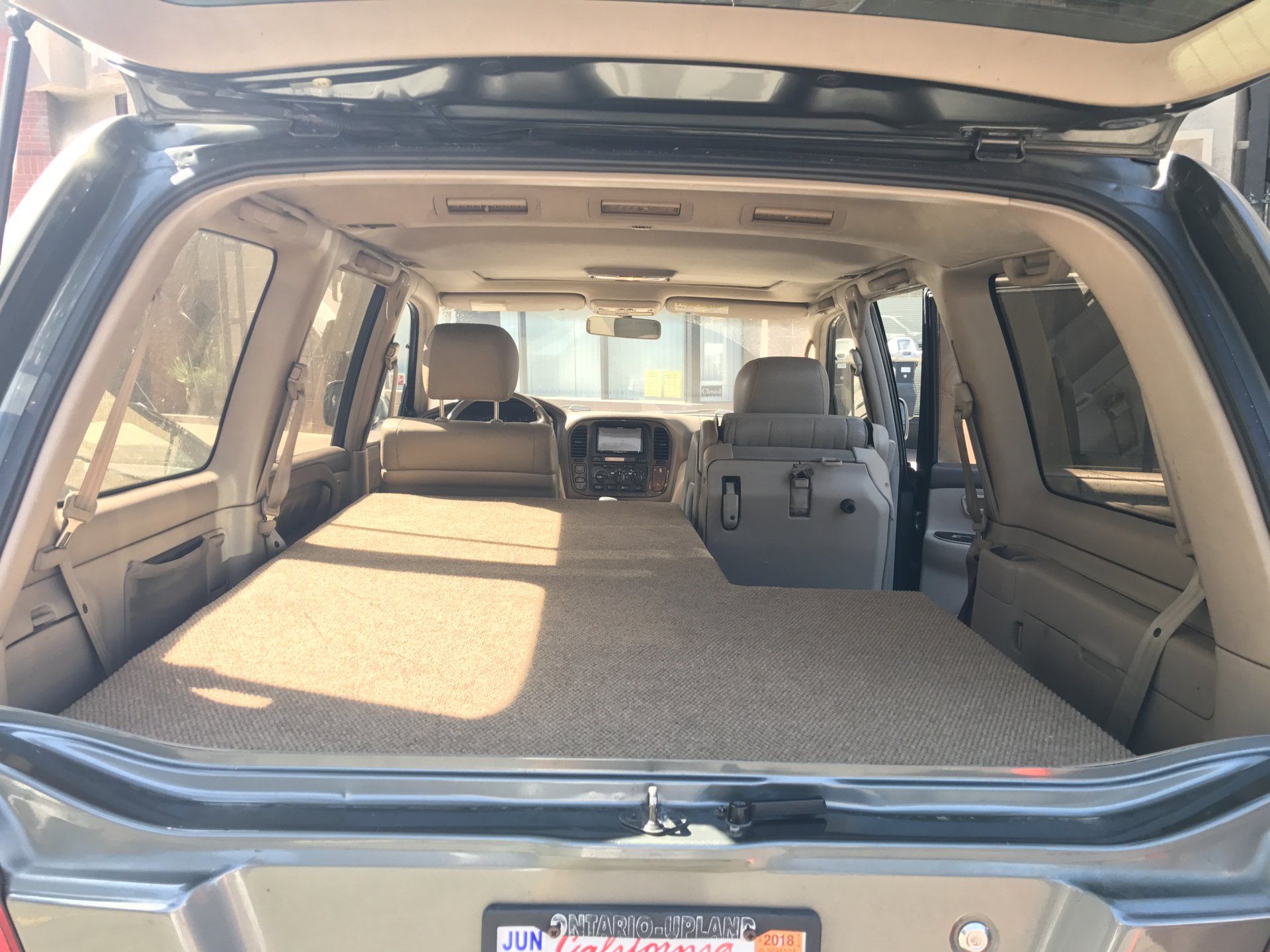

I built one using scrap wood i had lying around. Pretty darn comfy once you throw a foam mattress and a mattress topper on top.
Spent 3 weeks living out of it for my cross country trip
