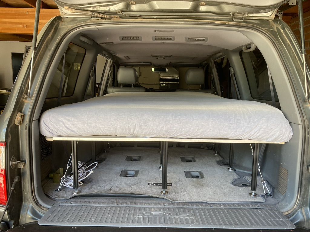

I made a simple storage/sleeping platform. With seats folded flat and a 4" memory foam topper it's very comfy.
I would use 3/4" for anything that's taking much weight, but I think the KISS and SS1 kits both use 1/2". I could be wrong, through.
SS1 is 1/2". I recall the KISS system being 3/4, but can't confirm.
I think even 1/2" is overkill for 99.9% of users. See my gun safe pic or @Kyle Bell putting nearly 1000 lbs on the 1/2" SS1. The 1/2 panels of good quality Baltic Birch are very strong. Unless you're loading hundreds of pounds of steel rails into your cargo area and placing them right in the middle of the panels, 1/2" should hold anything you put on the platform.
Pending on what drawer slides you use, the slides will fail well before the 1/2" material would, if you're using typical dovetail joints in the corners.
That being said, if you're using plywood from Home Depot, 3/4" is probably a good idea.

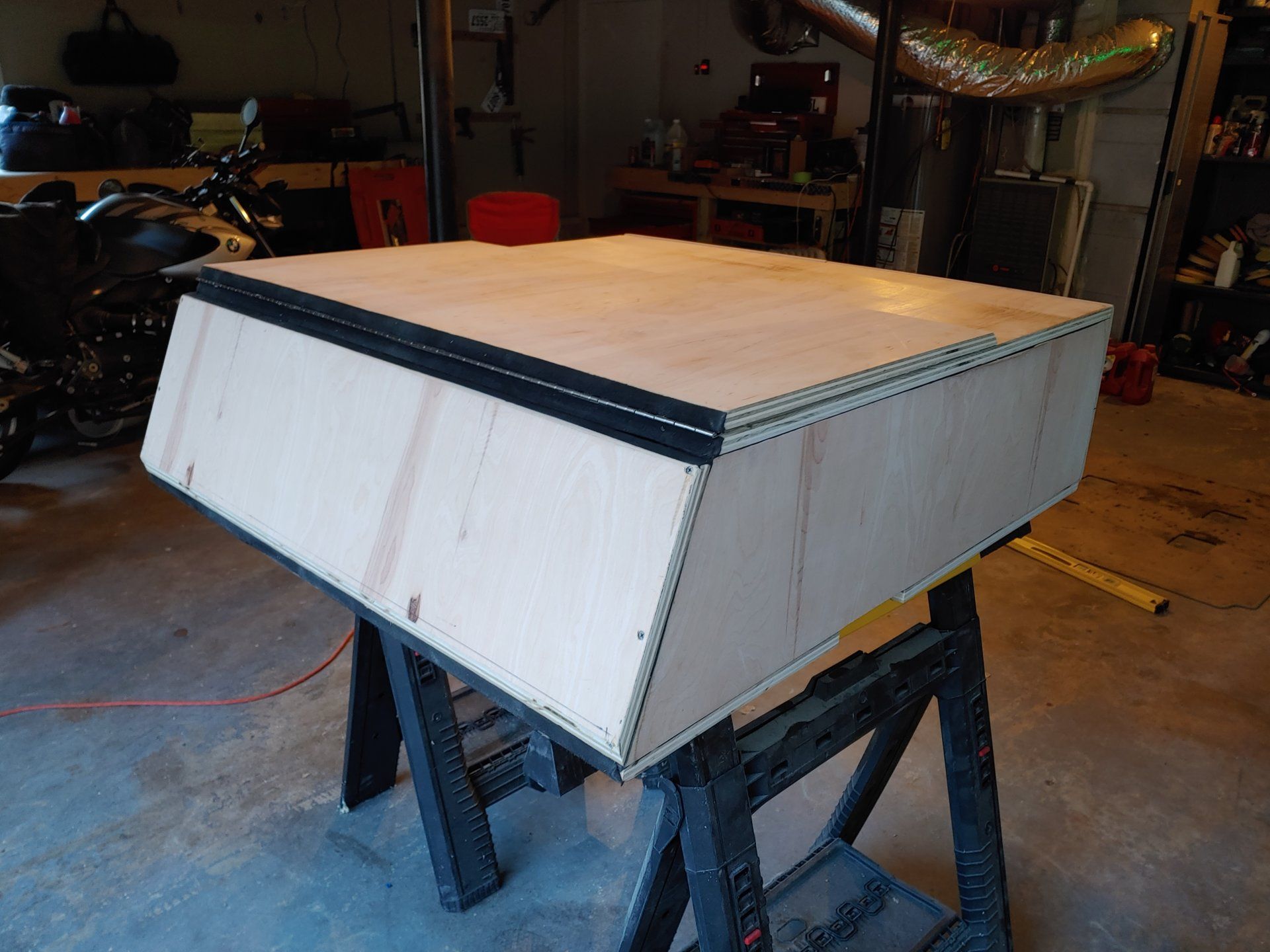

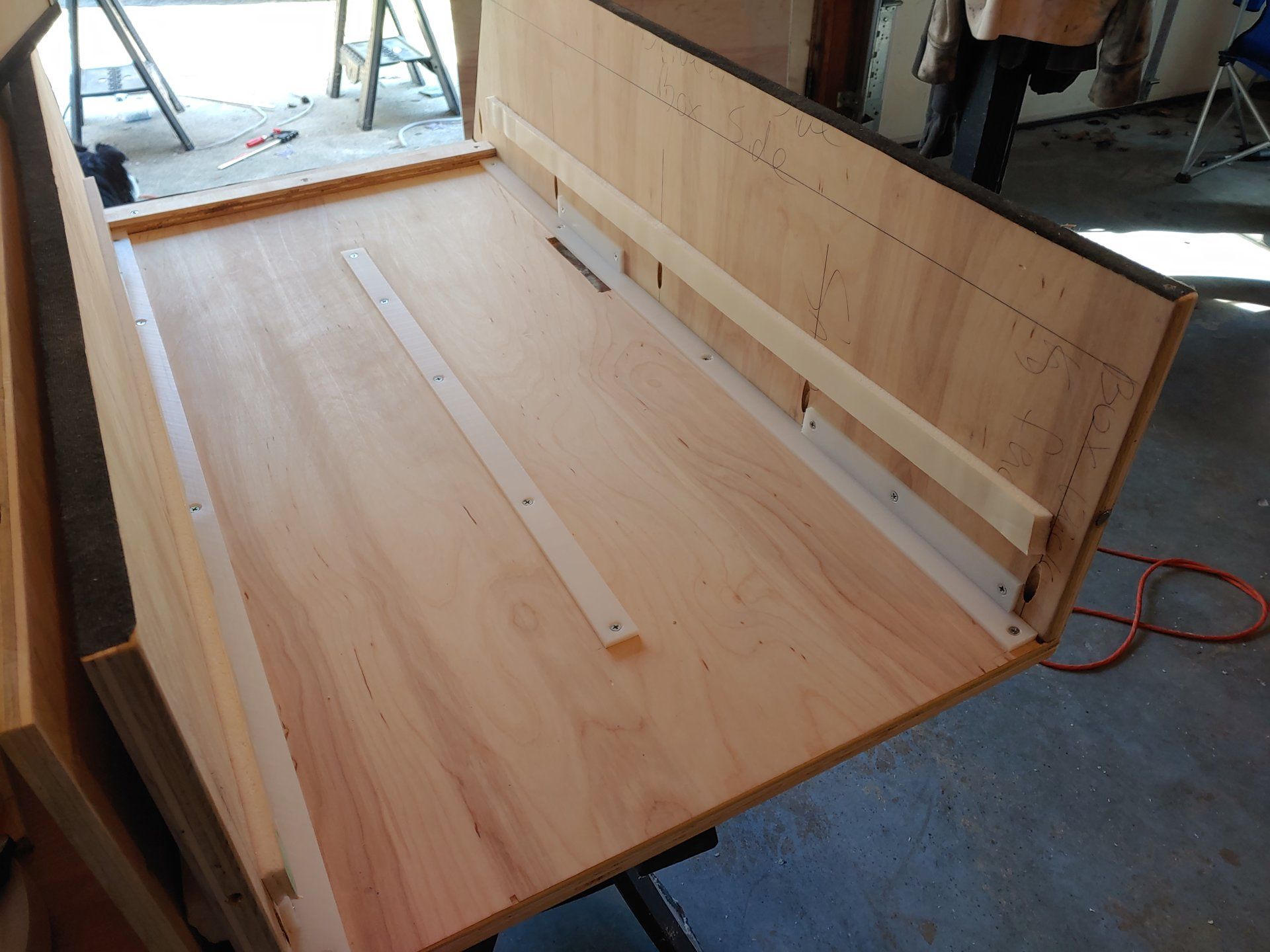

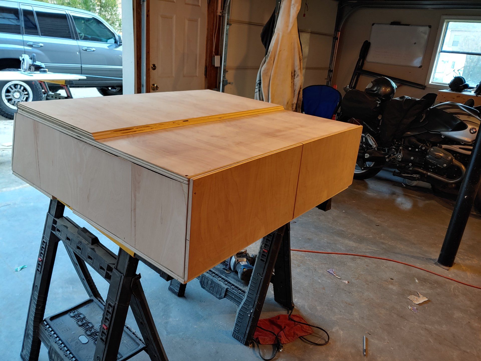

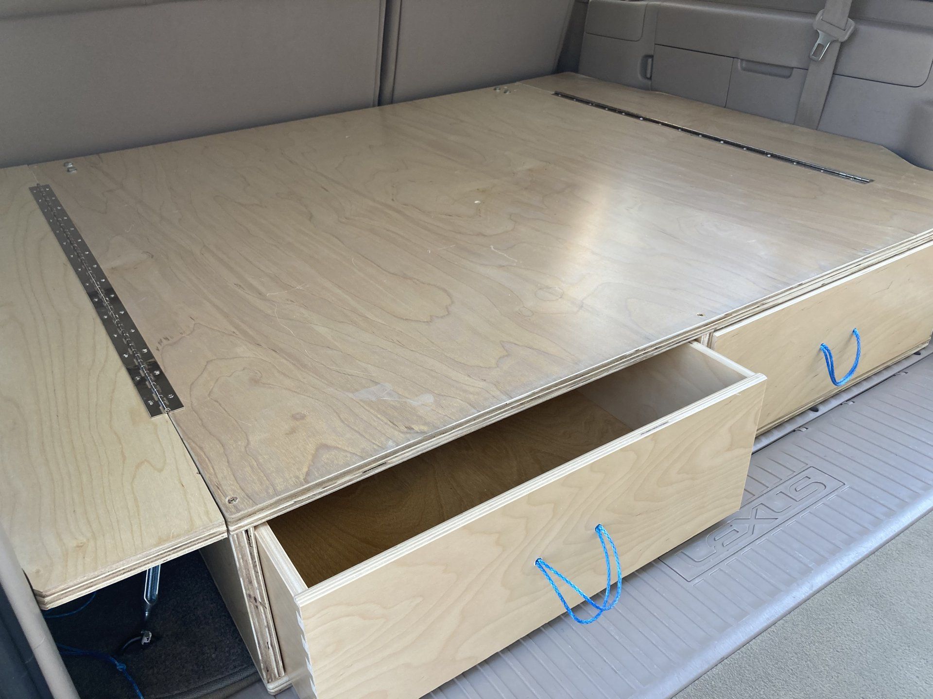

I started on my drawer/platform build over the weekend. It's about 90% done, not including staining. Will ultimately carpet it.
Big priority was strength as the whole purpose for me is a sleeping platform. I used 3/4" birch for the main box and 1/2" for the actual drawers. I took a page from @Magnetic 111 followed his design in mine. I also built in a small space between the drawers and back of the 2nd row for a small cubby.
-UHMW slides
-Felt tape between all wood-to-wood joints to keep squeaks away
-Pocket hole screws on all joints except the top panel and 'rear' panel (facing the back of the 2nd row). Otherwise, no exposed hardware inside the drawers or on the main face in front of the tail gate
-Routed out sections to slide some 1/2" dividers in various sections of the drawers
-Recessed magnets inside the drawer face to help keep them in place. They slide smoothly but shouldn't move without intent.
-One sleep panel is cut and installed, the other needs a trim for width but is already drilled for the piano hinge. Ultimately will give lots of totally flat space inside with 2nd row folded down
-Wings on the side need to be cut, shaped, and attached. Plan is for one side to hold a quick fitting for my compressor and some power accessories.

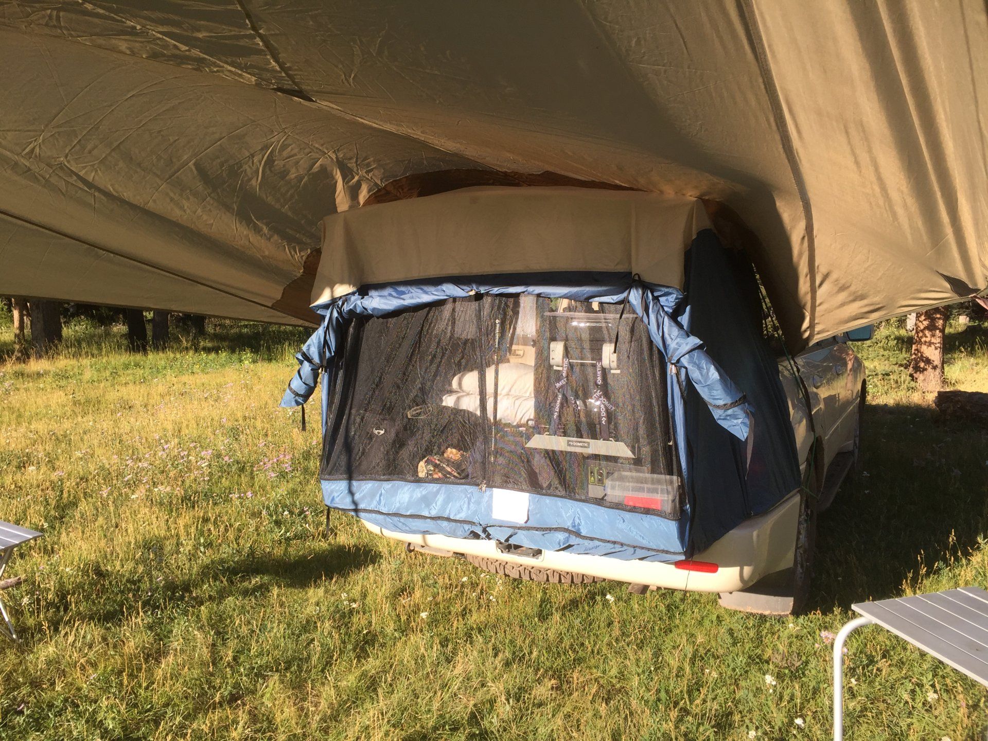

The last photo shows it in action with a DAC tent and Slumberjack Roadhouse Tarp. I sleep with the cooler slide extended to give me more room inside and so I don't have to listen to the cooler buzzing right next to my head. :cool:
@terrapin love the simplicity. Which size DAC tent is that? And does it fit well? (reasonably weather tight)
I've used the DAC full-sized truck tent for 5 years now and it works great and is easy to set up. It fits pretty tight, so I use an adjustable trekking pole to help hold up the hatch. However, it does not seal very well along the sides and especially on the roof where it goes over the roof rack. Bugs are not much of a problem where I live, but last fall I was camping in an exposed area and when the wind came from the front of the vehicle, the tent acted like a scoop and funneled cold air onto me all night long.
The next morning I fixed the roof rack leak by stuffing it with an Army blanket and used a bit of duct tape to hold the sides of the tent to the rear quarter windows. I think a long bungee cord from one rear wheel over the top to the other wheel would hold the sides in place, but something would still have to be used the fill the 2-inch gap from the roof rack. The open hatch fills most of the gap, but the wind still finds it's way in.
I've also boxed in the tailgate/hatch area with 1-inch R-Tech insulating foam and 1/2 inch foam for the windows. It's kind of bulky carrying around all that foam, but it makes things pretty cozy when it's cold. Of course, in the summer I leave all that stuff home!

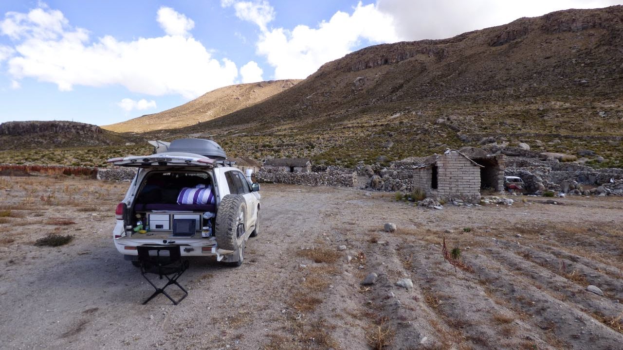

Here is my LC 200 bed, where I did live for over an year, doing trips like transafrica, south america or europe
Pics comes from somewhere in Bolivia: Salar de Uyuni
Possible to live and travel for 2 people (just a 2 seater now) - too with a height of 1.94cm and the need for a big bed...
