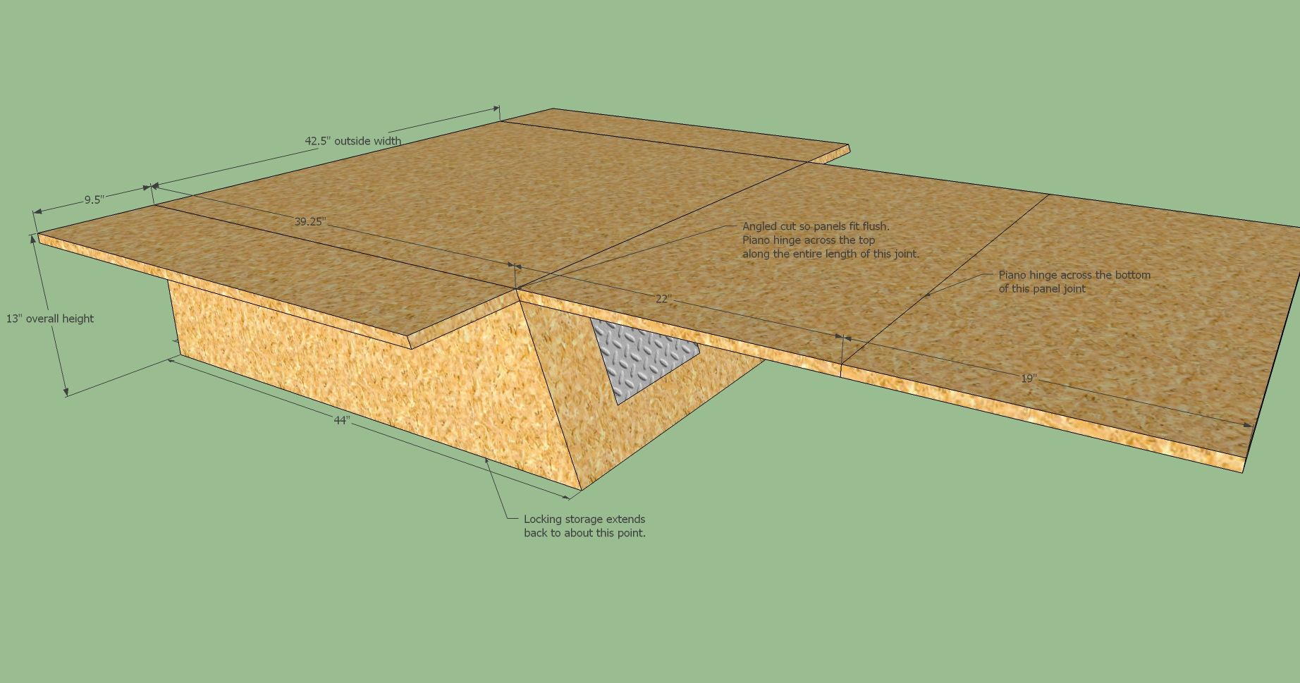

I don't have much for a formal plan. But here's the basic setup. The side sections were just estimates at the time. You'll have to make a pattern to fit the box into the space properly. I wanted a nice tight fit (I know- who doesn't?) to prevent movement and maximize the usable space. The basic dimensions here will take up about as much as you can side to side, but is about an inch short of the tail gate sill. You'll figure it out. Good luck!
Also- you have to watch the overall width of the folding panels. At the length I have below, they just barely scrape the "C" pillar trim panels on both sides as they unfold/ fold.
I realize this is a 2 year old post, but I was wondering.. Is there not a ton of stress on the piano hinges where you'd be putting body weight on these extra panels? This design is identical to what I've got in my head but I haven't accounted for additional support in the gap between 2nd row seats and drawer box.
I think that will work out pretty well. Just realize you need to scribe the wings of the box that extend from the drawers to the sides of the car and you probably want to make the DS one hinged or removeable so you can still use the storage back there. Surprising amount back there... You may also want to think about putting a small rubber spacer beside the piano hinge so the hinges don't rip the leather on the back of your seats if you toss in your sleep or are a bit rough getting the panels folded down. Otherwise, the locking storage is a good idea and I wish I would have done that to mine. Maybe v2... Think about what you want to store in there and make sure you can get it in the hole :) laptop?
I designed it so the hinge between the two fold-out sections is right on the back of the seat cushion when the rear seat is folded down. (I lay a towel down to avoid damaging the leather cover) The weight is fully supported on the back of the seat. Then the front panel lays on the back of the console lid. (on another towel to avoid damage to the leather armrest) The hinge at the box end of the panel is solid, no flex or obvious signs of stress. It's no problem. Plenty of solid support!

I also really like how you kept the panel facing the 2nd row seats angled. Presumably to retain the recline feature for the back seats? That was something I'd wanted as well... Sometimes you just gotta recline the back seats without going full-bore sleeper mode. I've seen the safe mounted there on a few other builds as well, a nice touch for sensitive or otherwise non-public items.
Thank you!
The second row seats are fixed in place once they're locked down for use (no reclining). But since the backside of those seats are angled as they sit, I angled the box to use all of that space back there.
